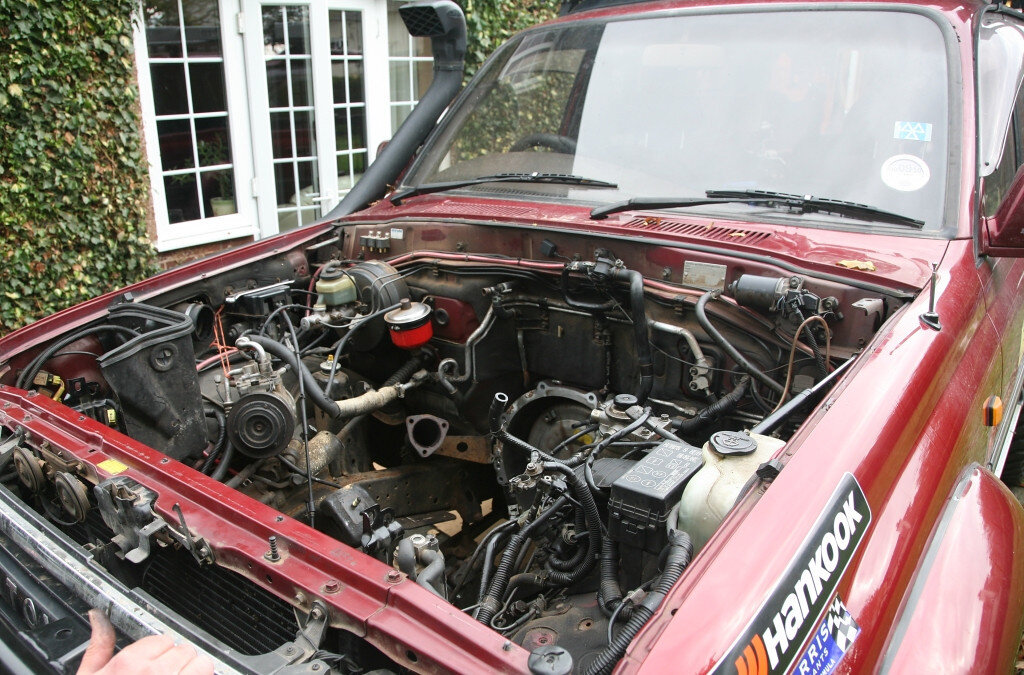

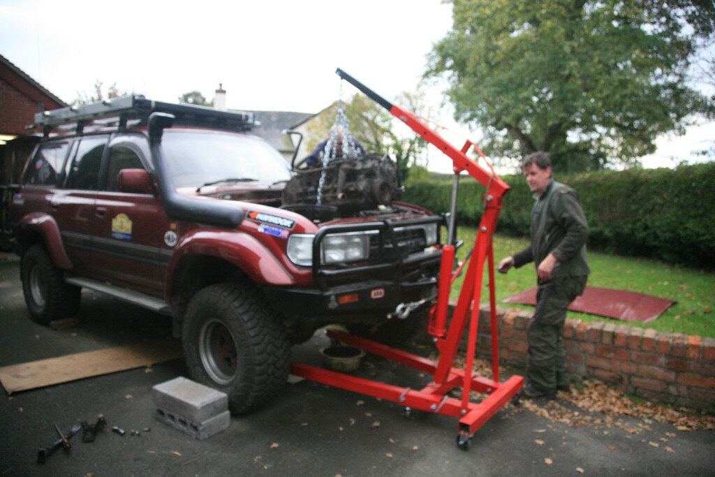

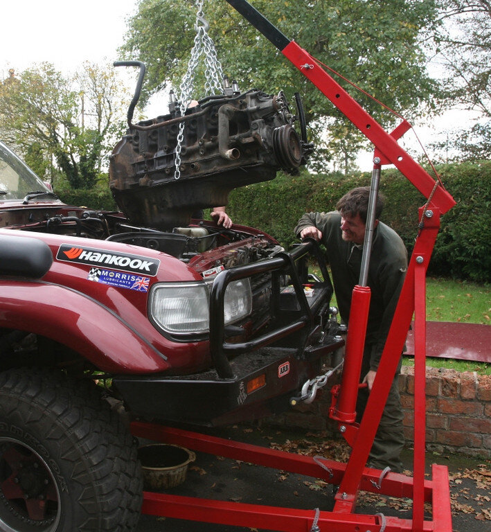

Following on from this thread, today I managed to get the motor out of the 80.
Apologies for the image quality on the first photo, the Mrs didn't realise the autofocus was off on the DSLR
Yup, looks like there's enough clearance there:-
Oh flip, I hope I can remember where all those pipes/wires go back :doh:
I will try and update this thread as the rebuild progresses :thumbup:

Now the motor is out it is clear that the crack in number 6 bore isn't alone :o number 5 pot seems to have the same going on in there.... but worse.

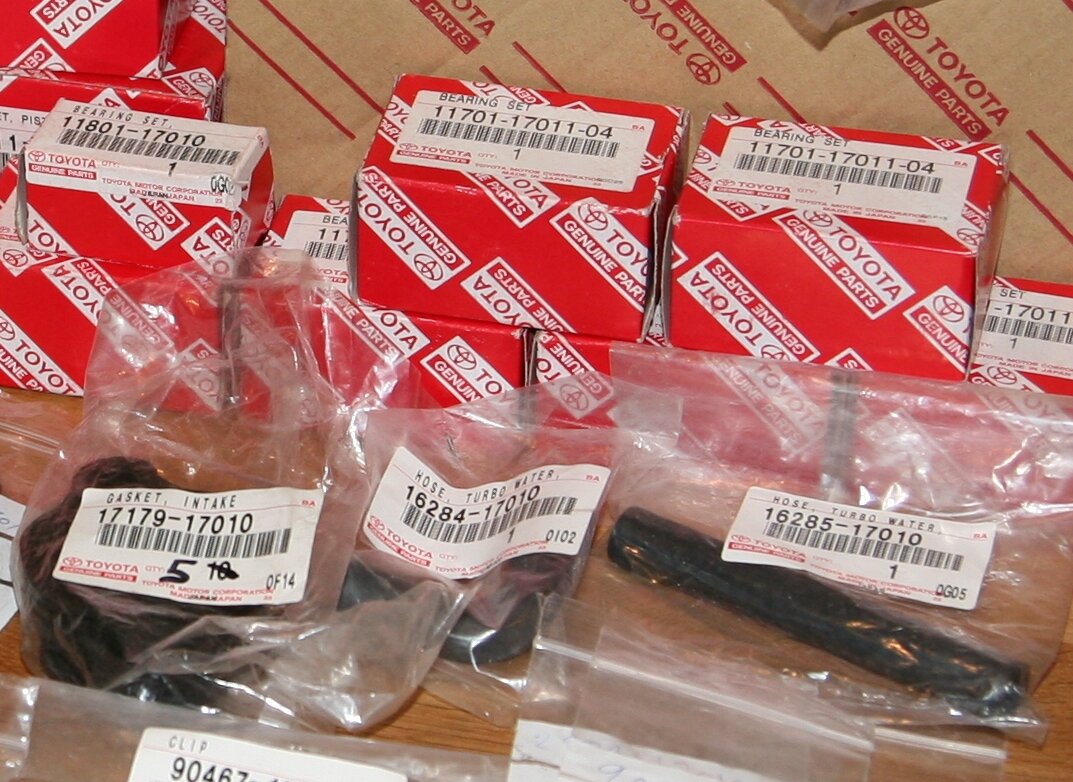

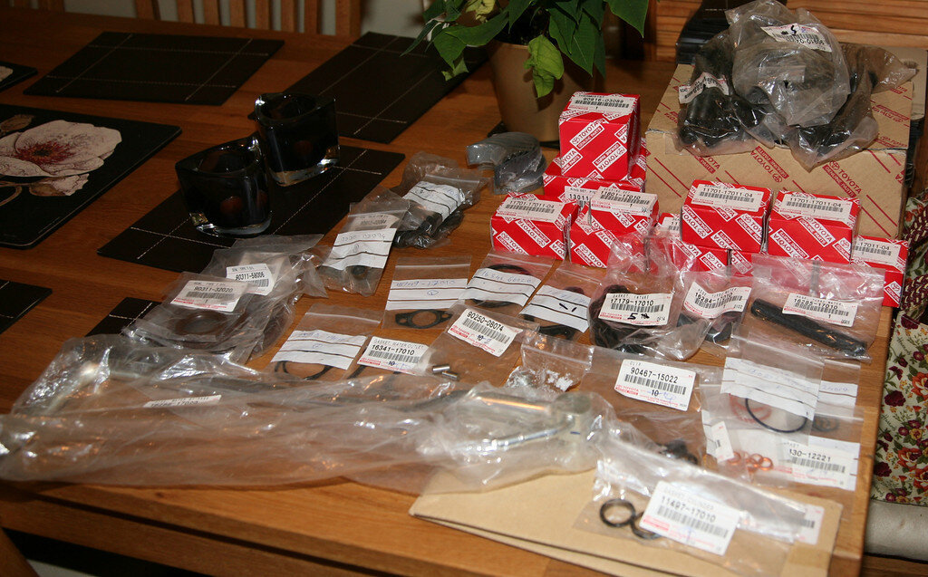

As I'm not cutting any corners with this rebuild I made up a list of parts needed for the rebuild, gaskets, bearings, oil seals, piston rings, head bolts, main bearing bolts, big end bolts, wigets, cuddly toy.... etc.... etc.
£1,138 lighter the parts are ordered and on their way from the land of the rising sun, many thanks to Ian Rubie :thumbup:
When I saw the cost for the bits I thought "oh fek" and went into a bit of a downer...... the Mrs said "why are you so miserable, stop being such a Scrooge and just get them"...... I guess there aren't many who'd say that :D

Santa has come early, thanks Ian :dance:
It's going to be a busy weekend in the garage.

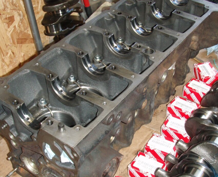

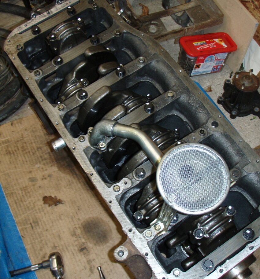

New oil check nozzles fitted and new mains bearings coated in Graphogen
Got the Mrs to put the crank in while I did the hard job of taking a photo :D
Mains and big ends all torqued up and White dots facing forward or back, before the 90 degree bit I always have the dots facing each other :thumbup:

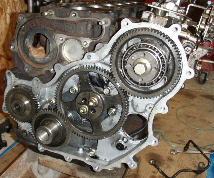

Timing gears and fuel pump fitted.
Tomorrow the aim is to fit the front timing cover, vacuum pump, power steering pump, new water pump, front pulleys and rear drive plate.... the motor should then be ready to slot back into the engine bay. I'm not fitting the head until after the bell housing bolts are done up as the top two are complete barstewards to get to with the head on.
