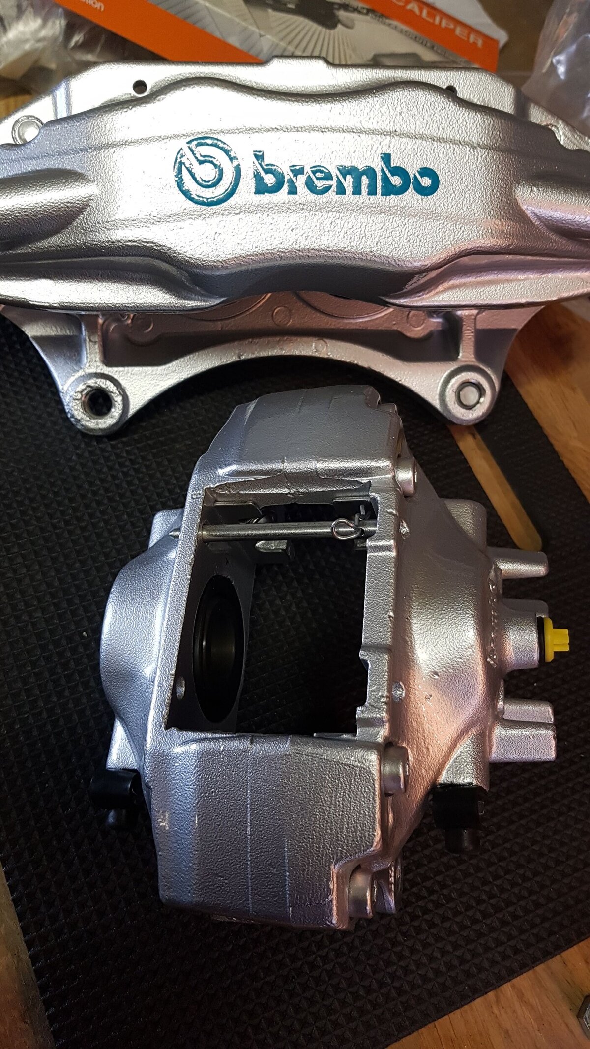

Used Bigg Red so many times for parts and full strip/rebuilds of my calipers, always done a good job.

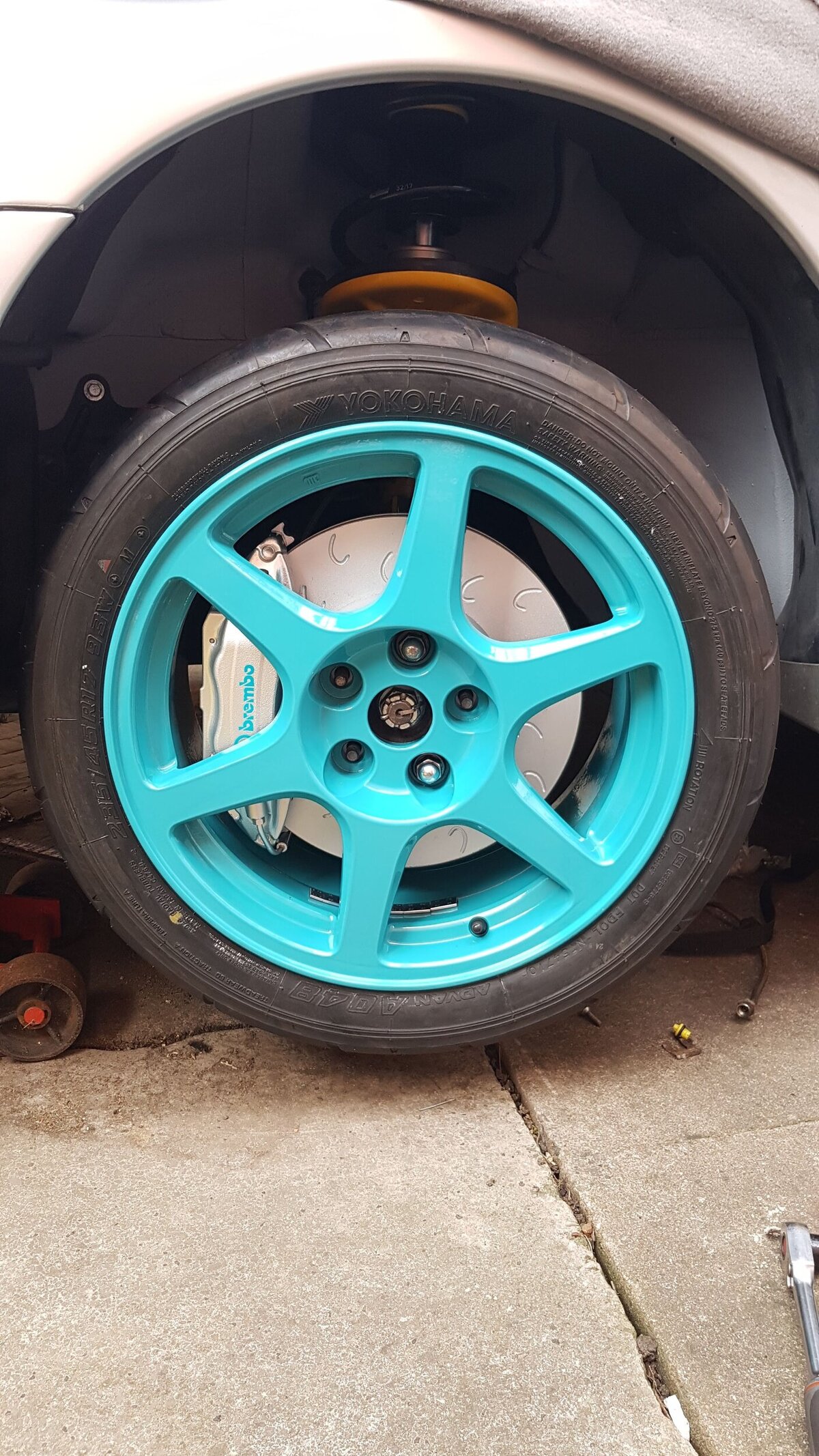

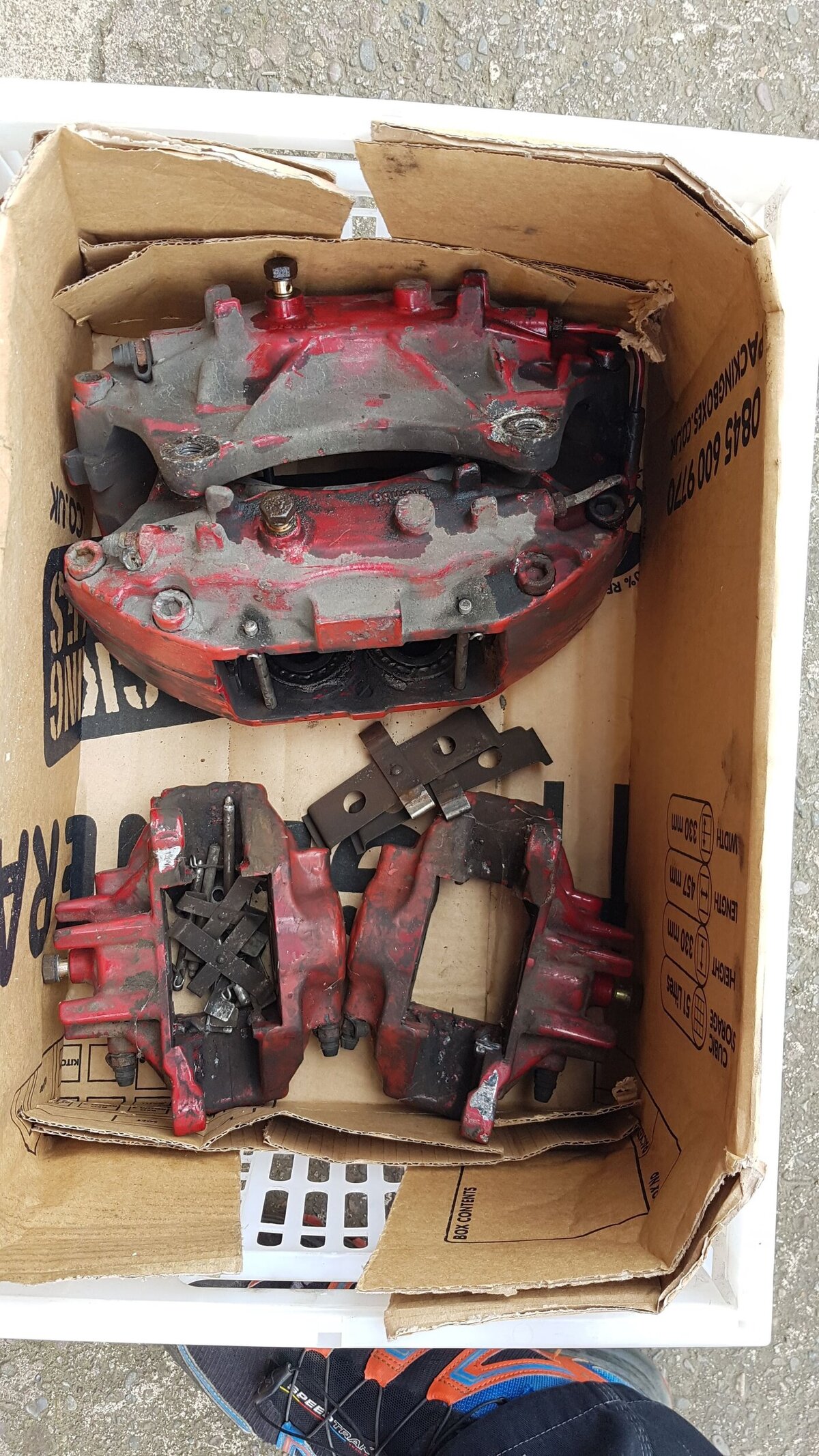

Couldnt find any pictures of the LC ones I had done, so have some off my Evo 5!
