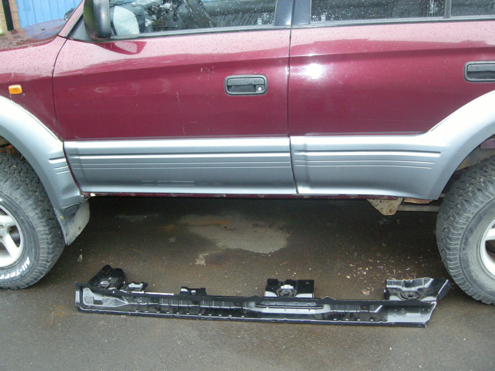

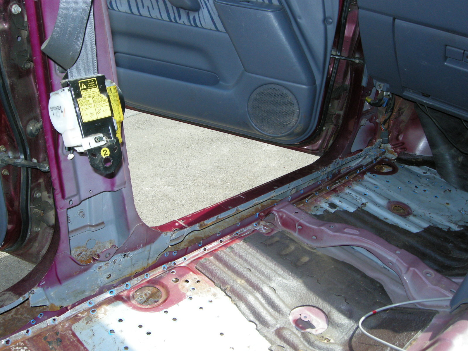

My '90' has been sitting in the yard, on SORN, for three years (where does the time go ?). I have drilled-out all the spot welds on the N/S Inner Sill and the whole assembly is now loose and ready to come out when the body is lifted:
The new panel is ready to be welded in:
After that . . . I have to do the same on the O/S (but I'll do one side at a time to maintain the integrity of the body shell).

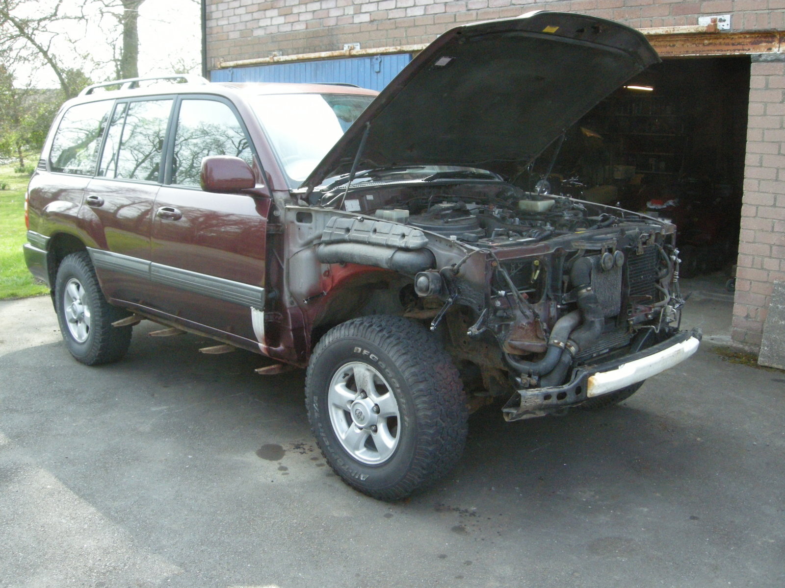

This has to be done this year as my '100' just scraped through the MOT with the same issues - it won't pass another year so the '90' has to take over the towing duties so that the '100' can get the same treatment.
