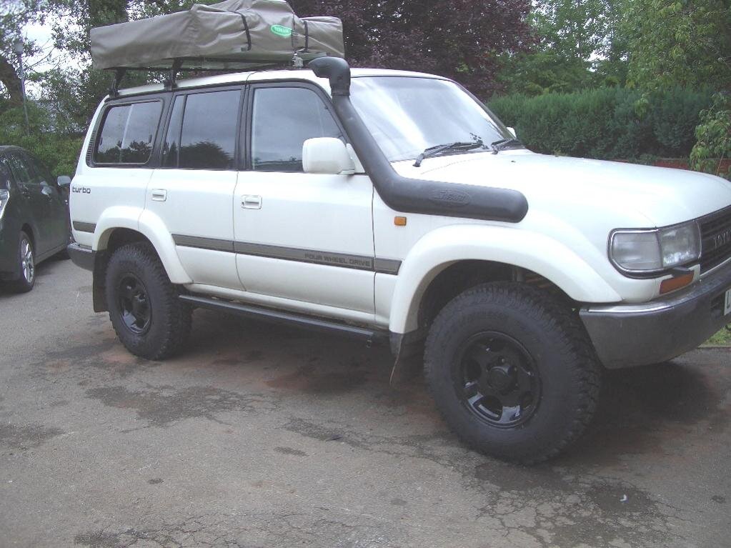

These are 35". They just touch the mud flap slightly on depressed lock but I shall sort that. They're 315's on a 17" rim

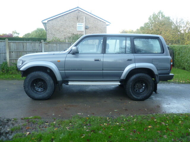

These are 33" Gary has both 35's and 33's too. Standard 8J Yota rims

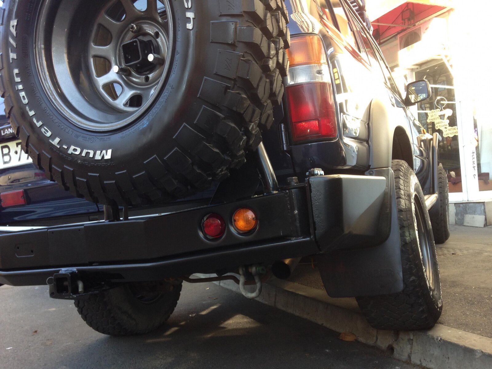

These are 35" bfg mt's have some minor scrubbing on some plastics but nothing difficult to sort out, 2" ish lift
