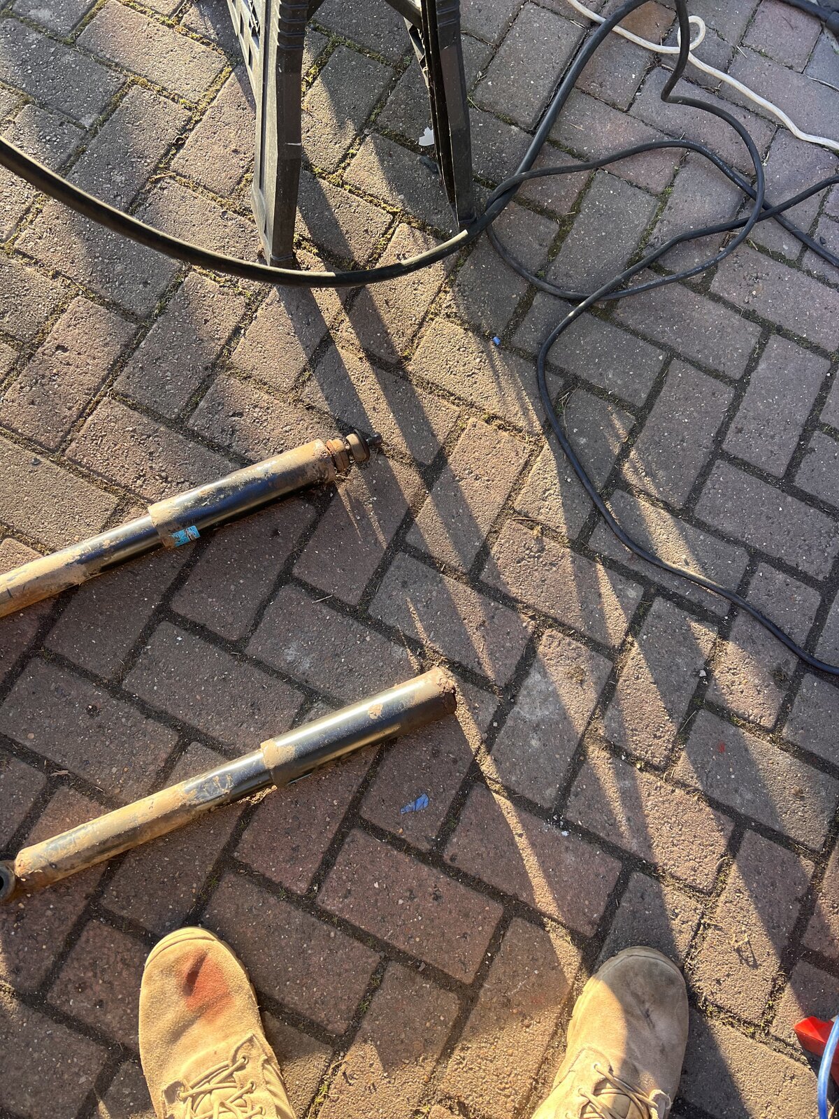

Update … success

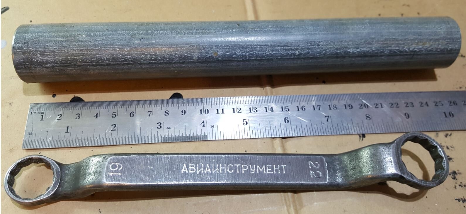

For all being in the same boat, below is how I finally solved the problem before any nuke option:
What did not work:
Sockets - the regular is too shallow. The impact Sidchrome is too tall to get there.
Sirchrome box-end wrench - too long to fit at a correct angle.
Sirchrome open end wrench - too short to exert enough force and the extender won't allow it to fit;
Monkey wrench to hold the shock from spinning - the shock's shell is too soft for a proper grip. Besides, it is problemmatic for a one man gang to operate both wrenches.
What worked:
Old as the world technique to hold large force of shock spinning with friction created by multiple turns of a rope.
Shorter box-end wrench with an extender.
See attached images.

UPDATE:
Was trying to undo another shock with another rope and found it too stretchy to break the top nut on the shock. Used 2.5mm wire instead and that made all the difference. I am sure even 2mm wire would do.
