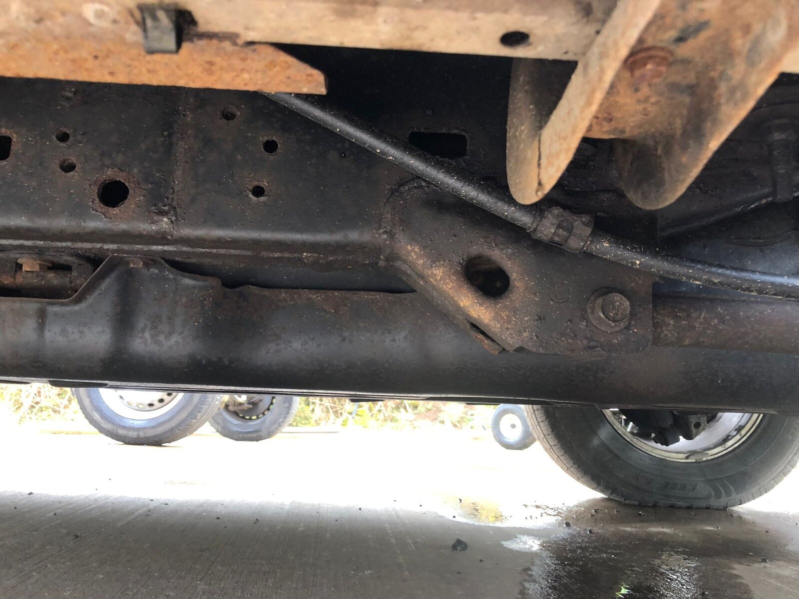

I just bought a 2006 landcruiser and wanted to do some work at the chassis, at the back its mainly the worst were the spare wheel is. It was done with oil every year used engine oil I think. I've got a kit from lanogurad.
Should I repaint it and then go with lanogurad or just use the lanogurad?
I've also some welding to do around the back wheel wells one of the back mud flaps is hanging off.

Put the lanoguard on as the very last step to protect it once you've sorted it out so it's how you want it.
I'd take those plastic flaps off so you can see what's going on - half the trucks here leave them off!
There's lots of threads here about this topic so have a read then we can answer any questions.
Doesn't look too bad tbh, you'll get a better idea once you've cleaned it up a bit and had a bit of time.on it with a wire brush then you can see what you're dealing with!
Get the spare wheel out of the way and show us some pics of the worst bit where it needs welding...
Agree with Karl, not too bad at all with what's shown, and yes, definitely clean/wire brush all areas of rust to get an overall idea at what you're dealing with, especially in the area needing welding.
Hopefully it's not gone further than you think/see.
The pic of the rear wheel/chassis, the wheelarch looks to me like someone applied waxoyl or similar at one time and its doing what it always does flaking off, id remove any loose stuff because it makes excellent water and salt traps.
Chassis from what can be seen looks ok to me too, one of the better examples out there, engine oil wouldn't be my first choice (especially used oil) but it will have seeped in and helped a lot.
I do things slightly different to the others, i've done the insides of the chassis and cavities wiith Bilt Hamber cavity waxes, their large arseoles :D and brilliant probes make that a doddle comparitively.
For the chassis and rear live axle i've hand painted with marine grease and give the whole underside and any nooks a crannies that look likely annual coatings of ACF50 via a pressure garden sprayer on a hot day.
The downside to this method is everything is filthy to work on underneath, but, bolts tend to come undone instead of snapping off and it keeps things like height sensors etc from rotting out.
The other downside depends on wifey or your significant other, if they require a pristine drive/parking area then for goodness sake do all this work elsewhere and let it dry off for several days before daring to bring it home or you'll be in the dog house
Actually your parking area looks ideal for the job, i keep and old large rug and sheets of cardboard for these jobs, which soaks up the worse of the inevitable mess, but then i'm a mucky worker anyway.

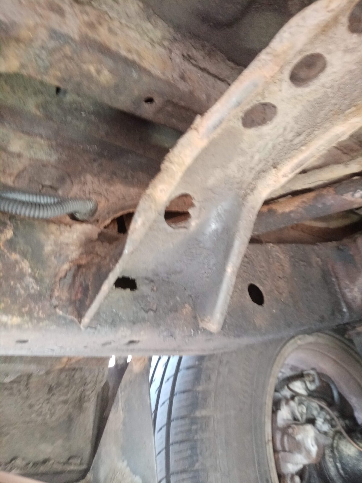

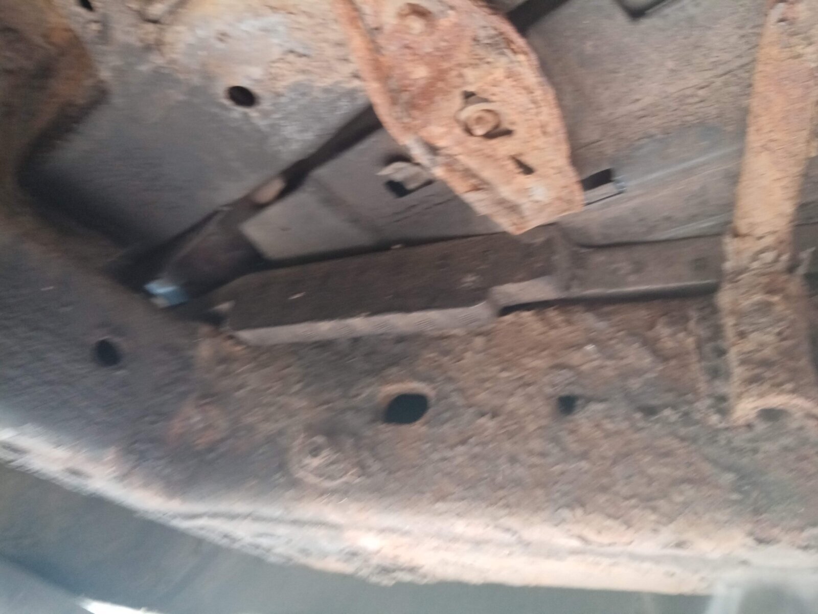

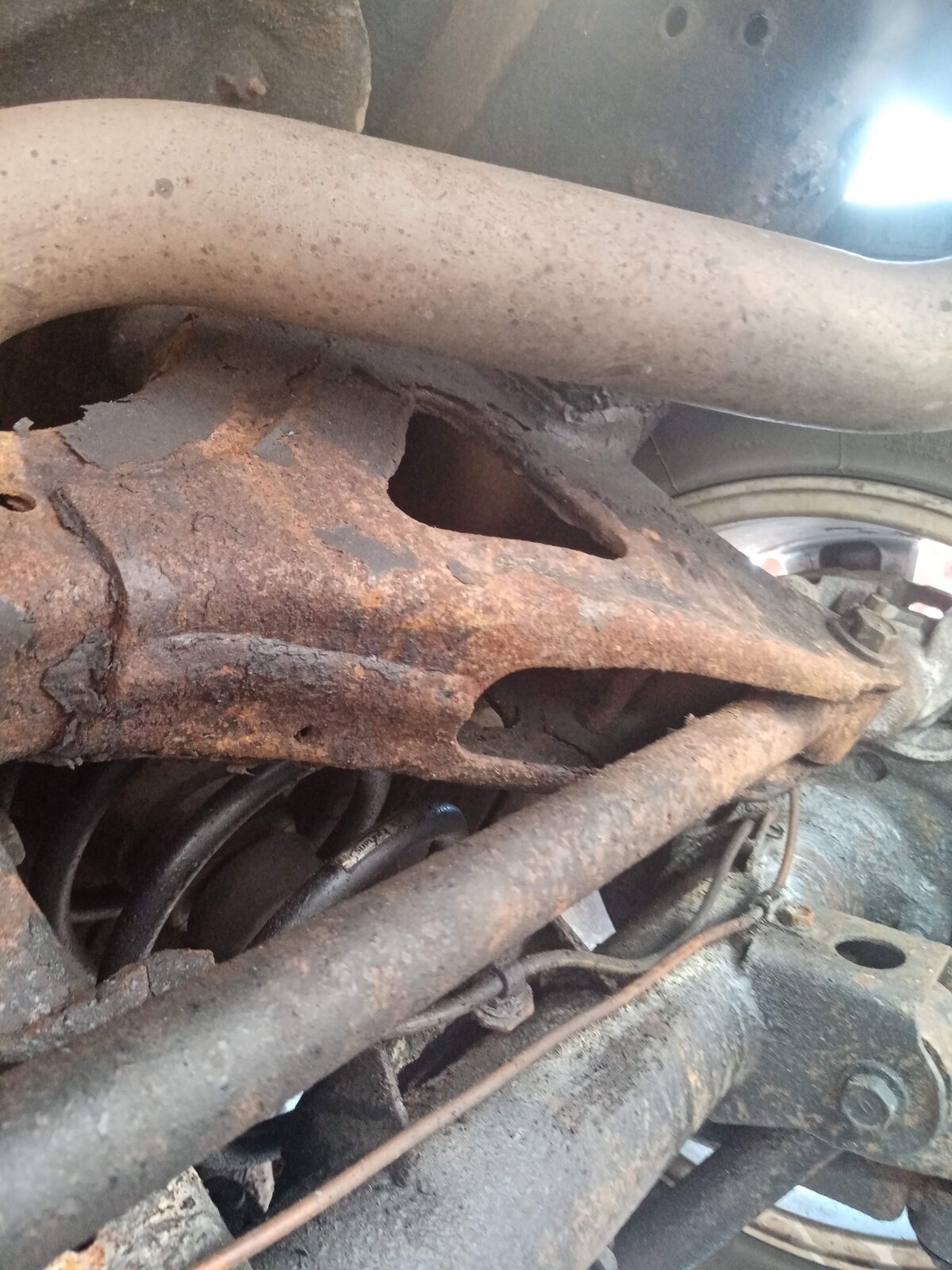

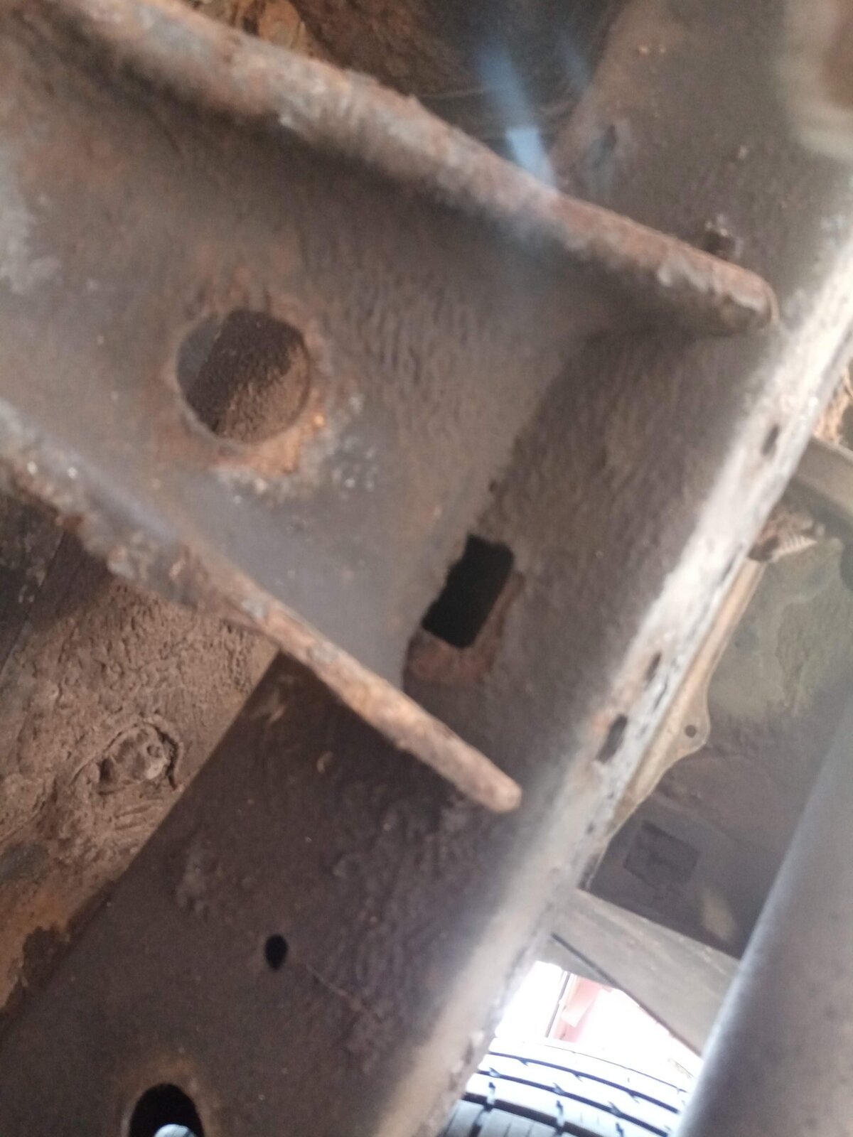

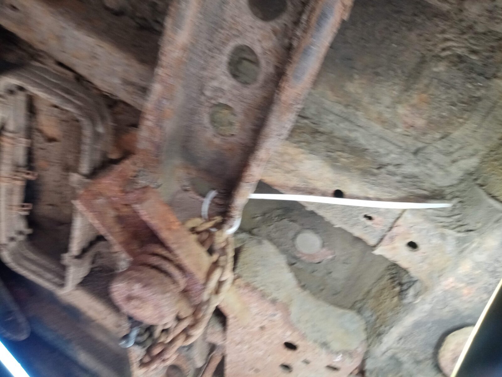

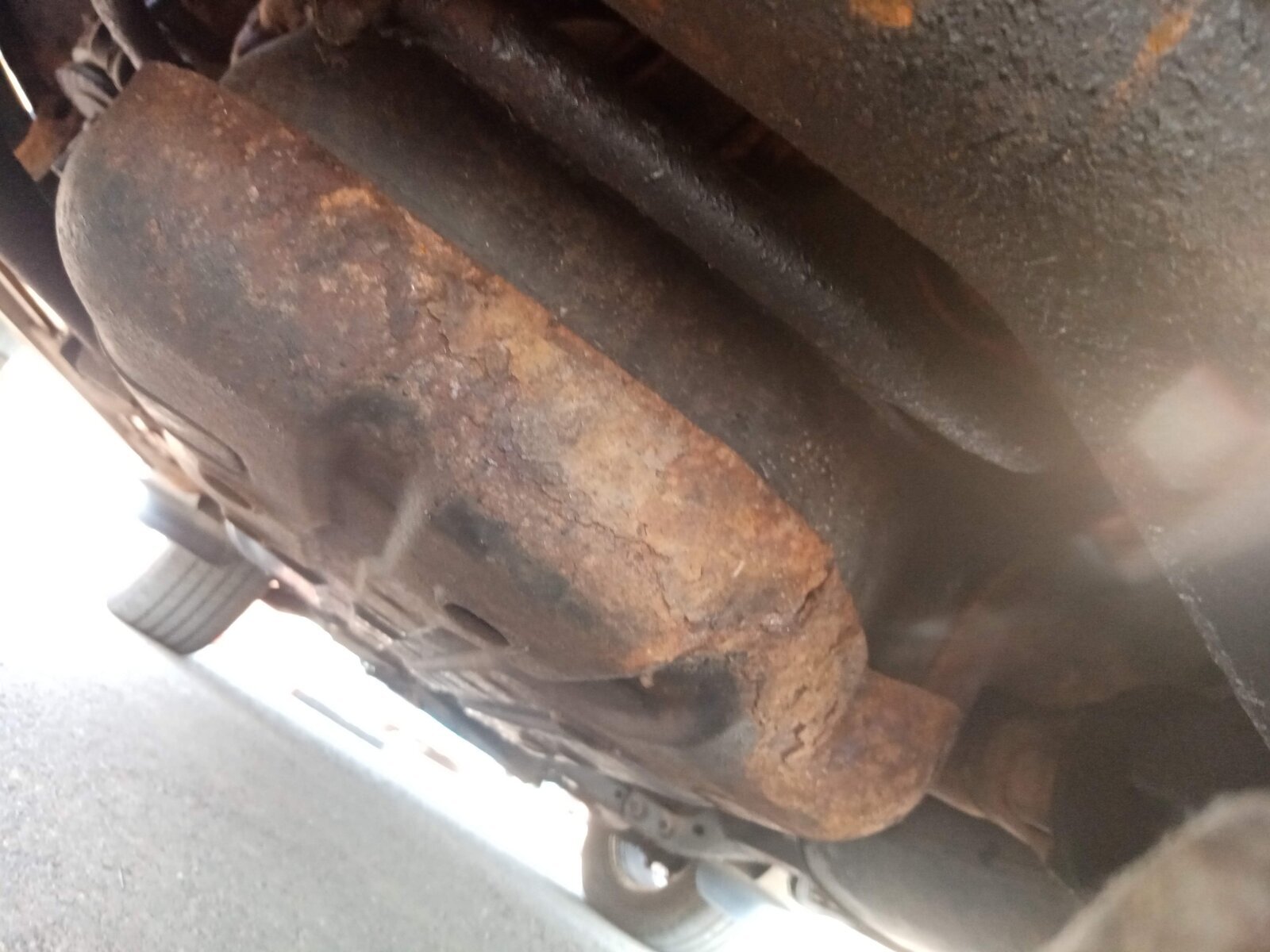

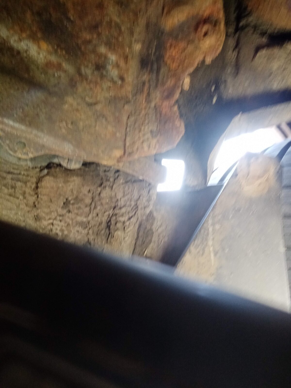

Got the wheel out and had a MOT wash.
This had just passed the MOT
Some rust all right under the spare wheel and around the wheel wells at the back one side is gone.

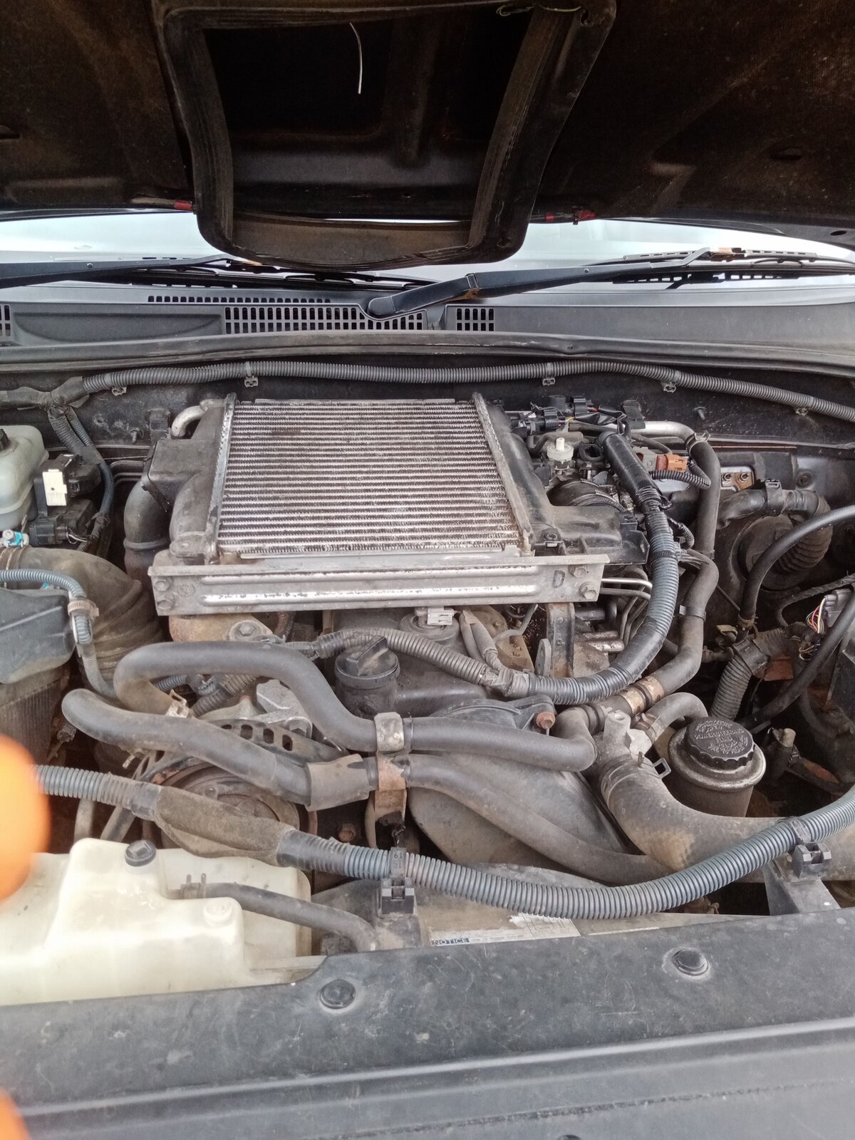

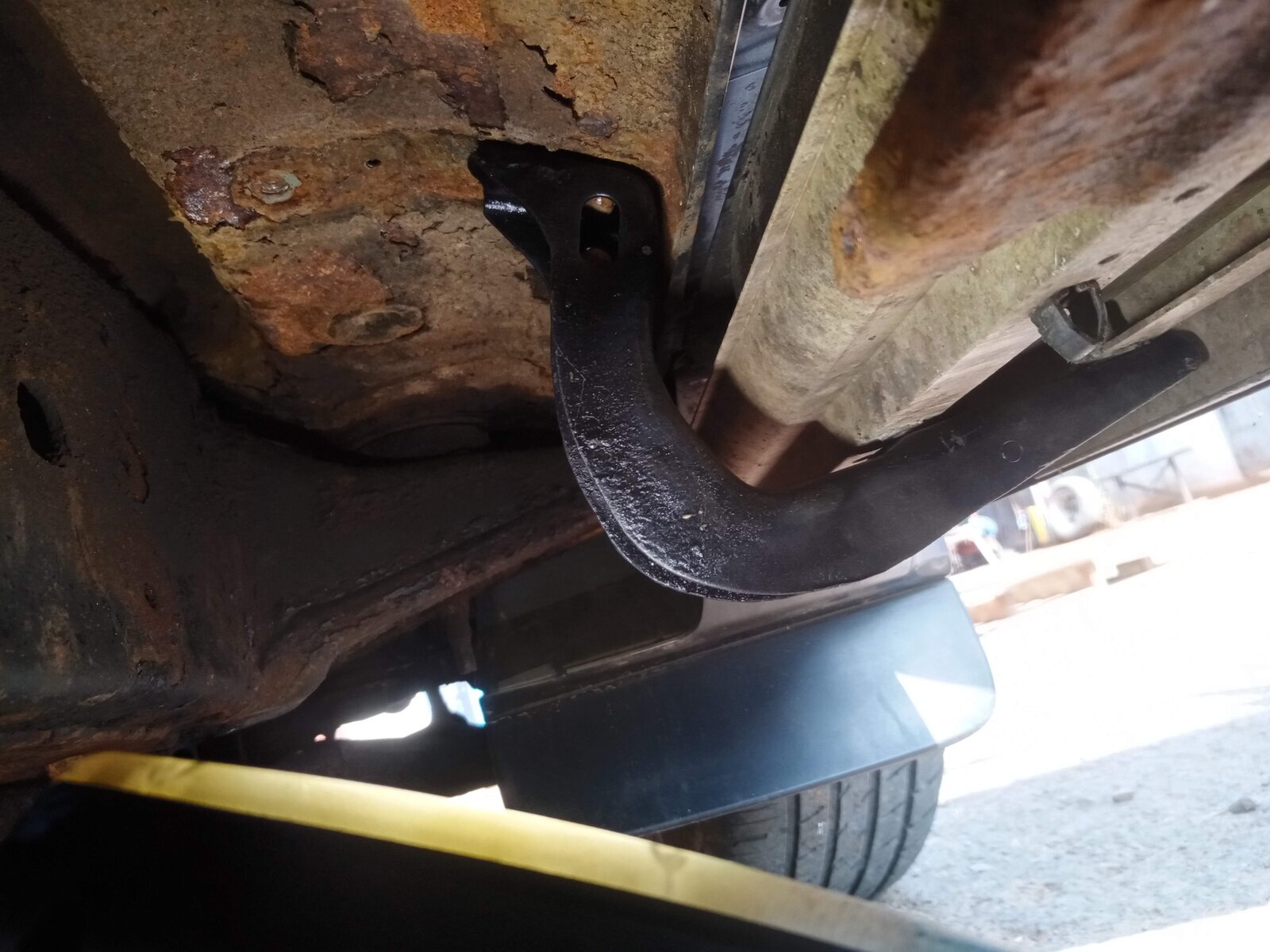

I did get some jobs done today clean the inside of the chassis with a hose best I could do along with wash underneath.
The engine cover was missing so got it sorted with some improvised washers.

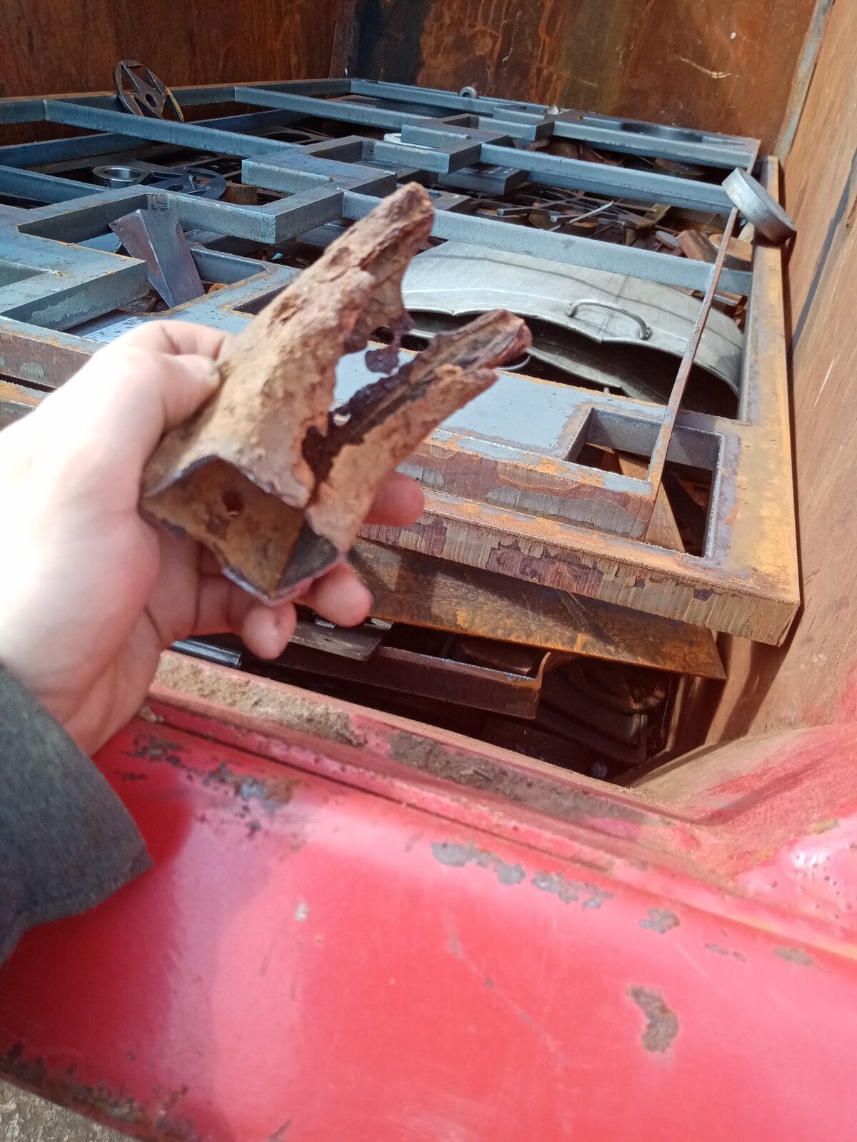

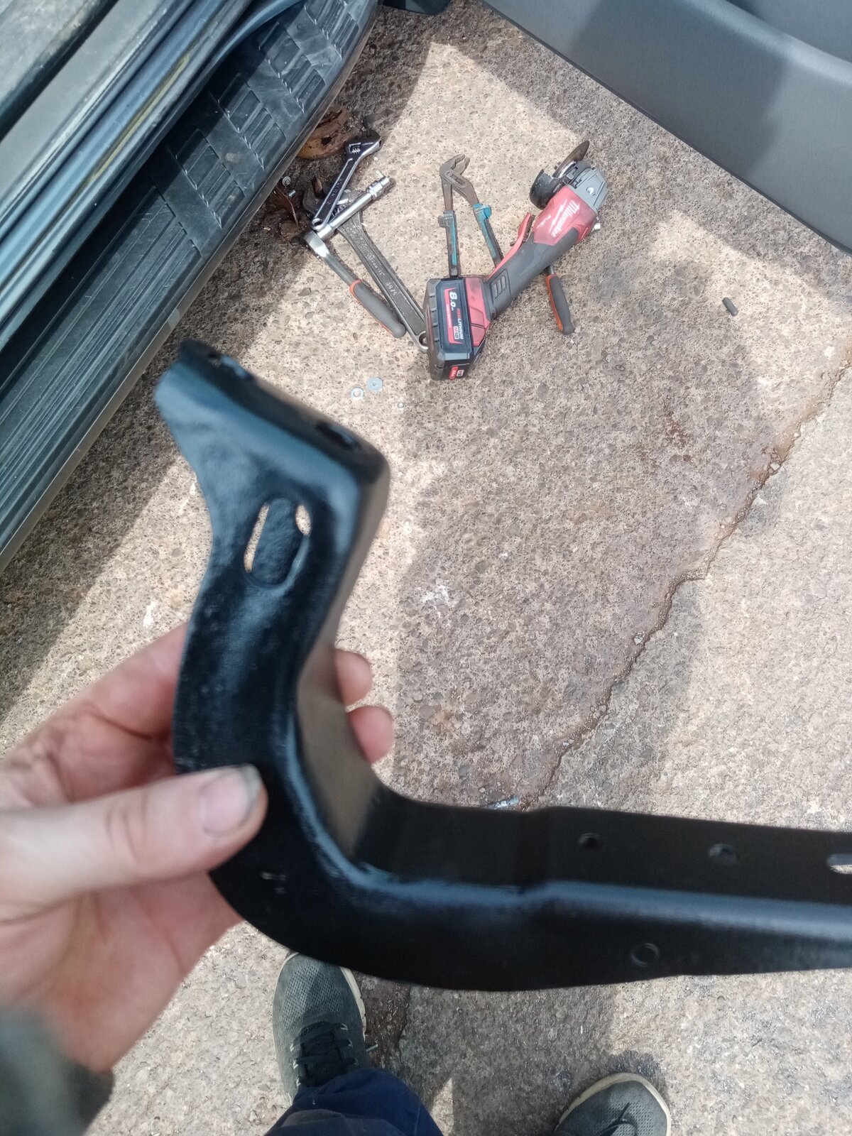

Side step bracket was rotten replaced with something nearly right for time being from breakers yard land cruiser graveyard wire brushed and painted.
Was at mechanics they are going to clean round the back end and apply the rust coating on the lift and fix the wheel wells ect.

The new side step bracket is a lot shorter then the original where it bolts onto the inner sill, not sure I'd be keen on that.
Looks a nice cruiser, lovely colour. With them underside bits your getting done it will be a very good example.
Thats the only bracket I could get my hands on today at the breaker yard when I was getting the engine cover. So it's only temporary I was putting my foot on that step and it was half hanging off with that old rusted out bracket so il get a new set or make a set at work from 5mm plate and galvanise them.

Sidestep brackets are horrendous price iirc around £50 each, and they are not all the same,the reason I did away with mine.
Probably end up making a wee set of brackets and galvanise them.
