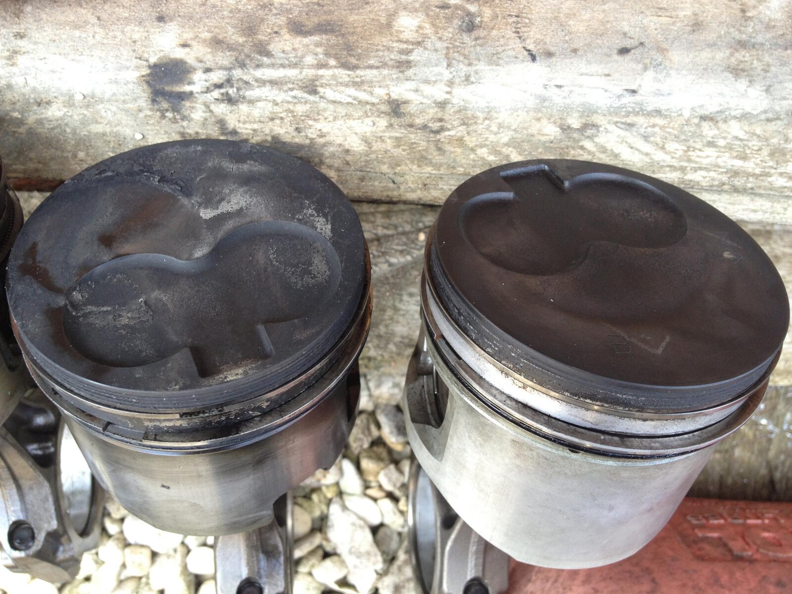

Do you have any photos of the offending carbon?
A couple of the offending pistons, looks to be baked on quite hard.

Id try the scotch wheel first then move onto something a little more aggressive if it doesnt budge.
