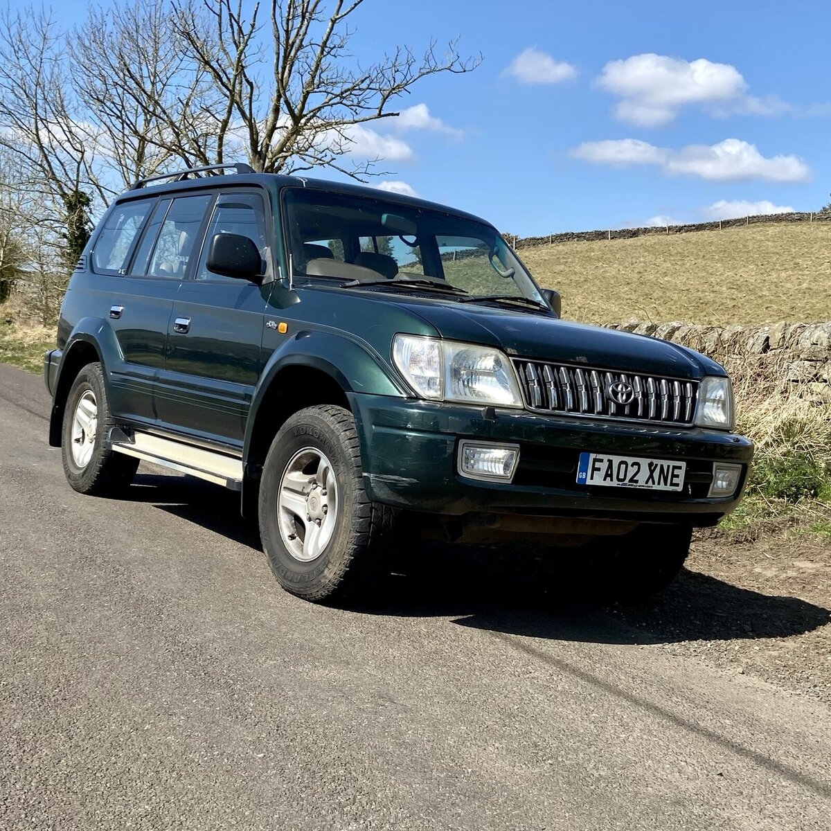

Hi all, my Collie 2002, 3.0D4 has begun getting some starting issues. The starter motor turns fine and everything sounds OK, but it takes longer and feels like fuel is not getting through and I need to pump the accelerator more than I had in the past. The glow plug light comes on and then goes off as normal, so I'm wondering if it is injectors or something like that.
Before it becomes a big problem, leaving me stranded, I thought I'd get it fixed now. Does anyone have any ideas??
