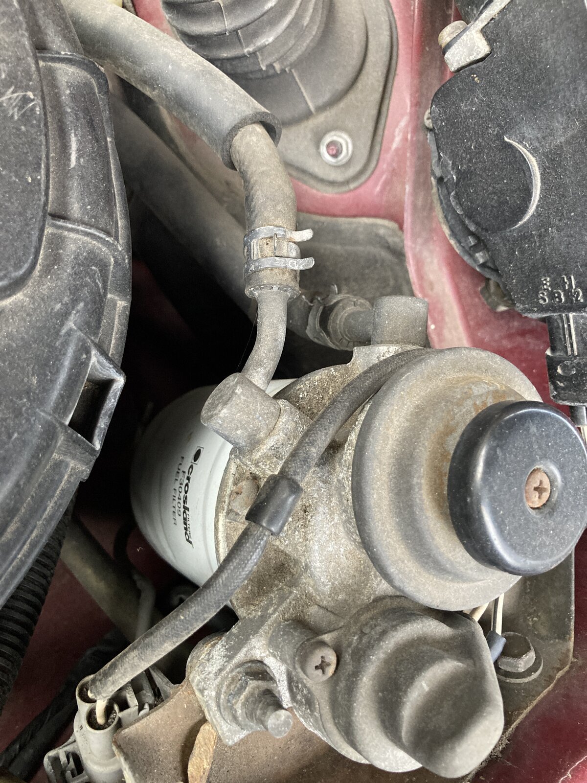

Well, checked the pump and all looks good. In all fairness it started ok this morning, so now I'm scratching my head. I've put 1/2 bottle of diesel cleaner in the tank with £50's worth of fuel. I'm just hoping its just one of those odd hicupps. I'll check the resistance of the back two cylinders over the weekend to make sure.I'll give it a 50 mile run to watch the rugby tonight in Gloucester so hopefully it'll clear the tubes out a bit.
One question, is it reccomended to change the Glow's after a certain period?

Evening all.

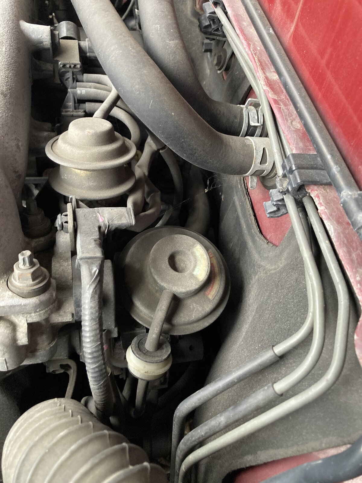

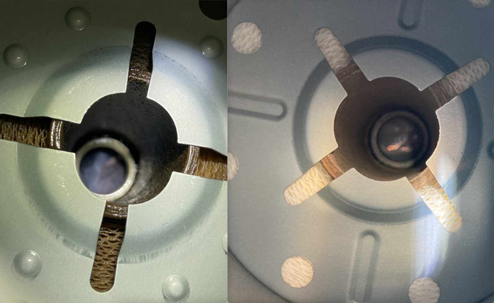

Well, my Coloroado is still struggling a bit to start even after I changed the fuel filter. Attached an before and after of the inside of the old and new filters. I'm thinking it might be a clogged EGR valve.
Has anyone used the Wynn's EGR Cleaner and whats the thoughts on it, did it work or did it bugger something up??
I'm running out of options now before I have to take it in to get looked at. As mentioned the Glow plug voltage is good and all have around 1 ohm resistance.
