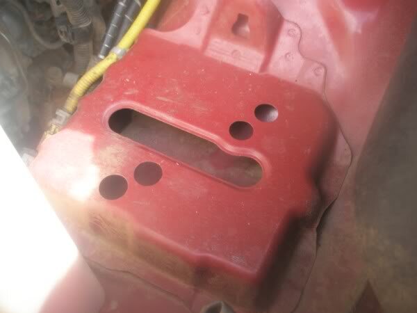

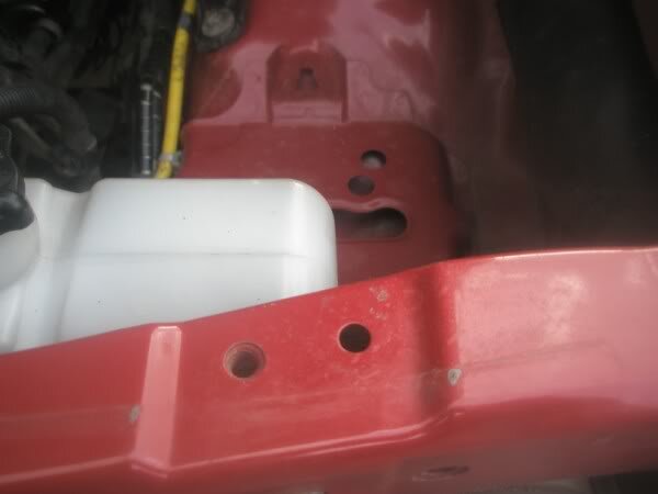

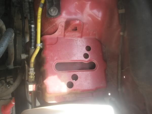

That he was missing this bit that is welded to the top of the inner wing
and the threaded hole on the slam panel for the front of the top clamp

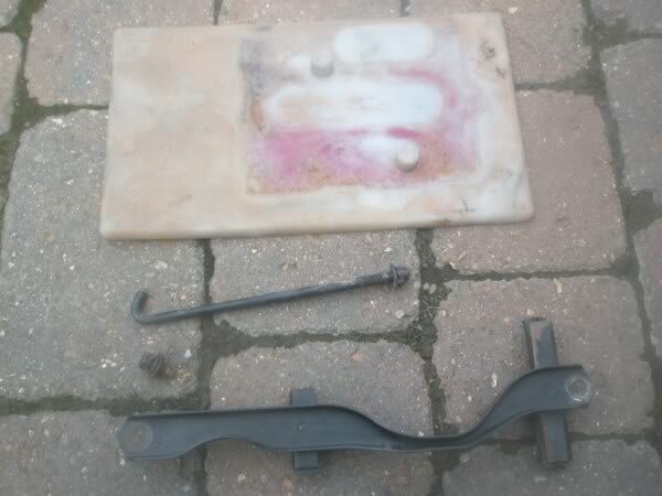

But you be talking about these bits then

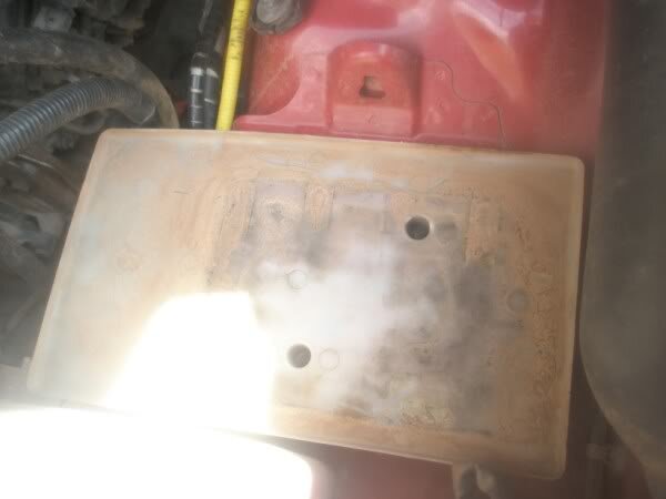

Same bits as above, but plastic tray up the other way showing spigots
Piccy of plastic tray slotted into place on top of metal support shelf

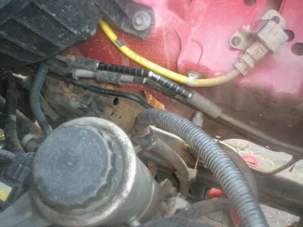

The photos above of my inner wing are all of my near side wing where a second battery would be if you have one, but I don't

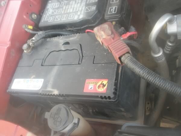

The piccys of the tray & clamp are all from my main & only battery on top of the off side wing (that I happen to have off @ this moment in time).
Piccy of my main/only battery on the drivers side
If you do have the matal shelf on top of the inner wing then the battery will sit fine on top of it without the plastic tray & you can buy generic clamps from Vehicle Wiring Products for about a fiver
