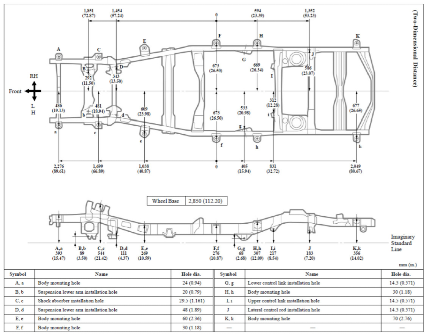

As am i say is it posible to do this? 105s are incredibly rare from my country and have a high prices. So what if i buy a 100 series and find 105s front parts (diferantials......) can i attach them to 100?

Anything is possible but what the labour would cost. I inow the chassis is different on the front of a 100 to 105 so its hard to say.

Would it not be easier (if either is ‘easy’) to mate an 80 chassis and running gear to a 100 series body? Then there’s the uprated 105 spec axle and steering components.
Sounds expensive.

Google would be your friend there
Its no small job but is possible nobody here has done the work so id say you need to do alot of research and please post back and do a build thread to help.other in future.
Youd be better iff buying a 80 running gear and a 100 body and making that work.

Thanks for your advice. I think if i find a donor 105from neighbor countries i can do that. I Will keep looking

Anything is possible when you have a money. If i want i can attach Unimog axles on 100 series. But this is not what i mean. What i want is a transformation project what will be carried out in full compliance with the original of the 105 series. An outside eye will not understand that this car was later converted to the 105 series.
