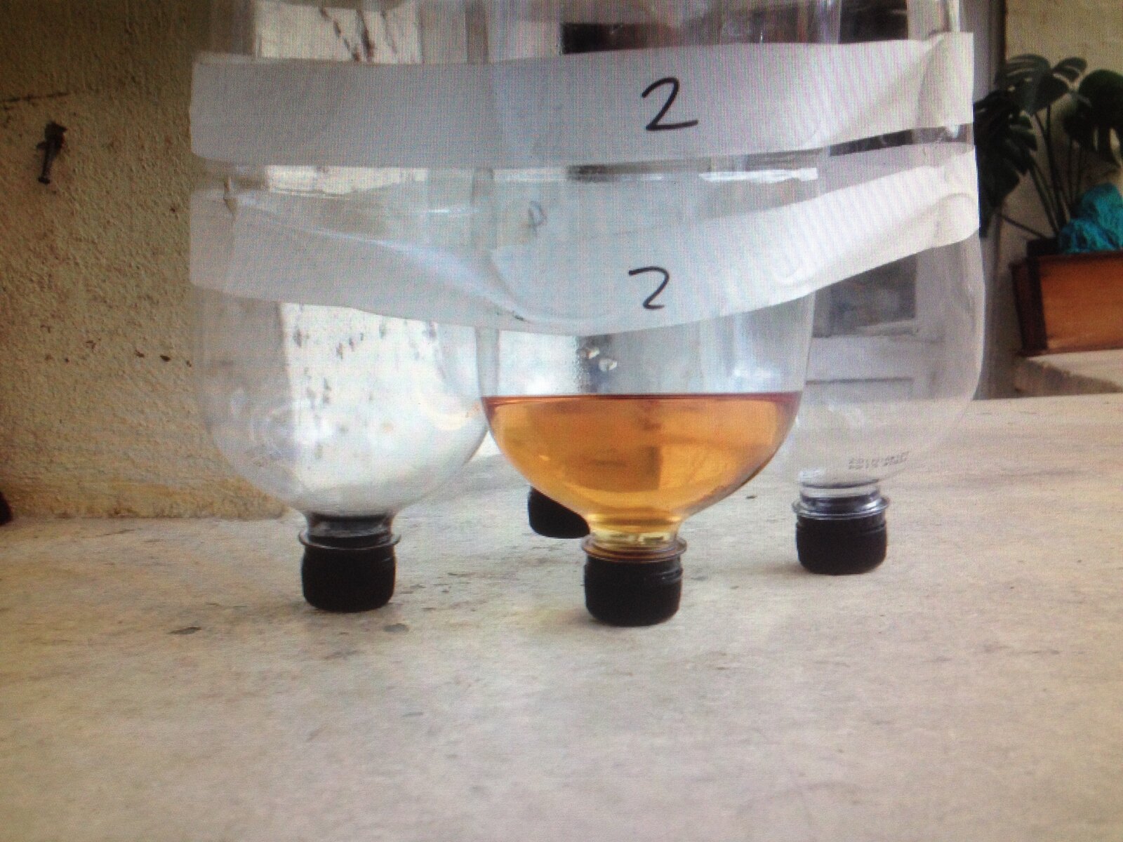

Hi Guys just to let you know I resolved this problem on my 2002 Land Cruiser Colorado 3.0L Common Rail D4D engine.
The problem I had was EML + limp mode then a non starter (except with easy start) in that order - fault code P1226 Low Fuel Pressure.
MY TEST RESULTS 3 X CAP FULLS AND 1 X CUP FULL !!!!!!

- Finally I widened my Google search and looked up general common rail low fuel pressure problems and I found a test to measure the run / leak off at each injector - low and behold no: 2 injector was practically in free flow. I ran the engine for about 90 seconds and three injectors returned about a coke cap full of diesel whereas the problem injector pissed out about a cup full !!!!!
- To test I had to remove the rocker cover and disconnect the run off rail. I took the injector run off fitting to a shop and matched a banjo fitting with a tail and some pipe and made these off on each injector in turn so I could see the relative run off amounts - 4 fittings and pipe = £10.
- P F Jones injector £244 - problem solved
