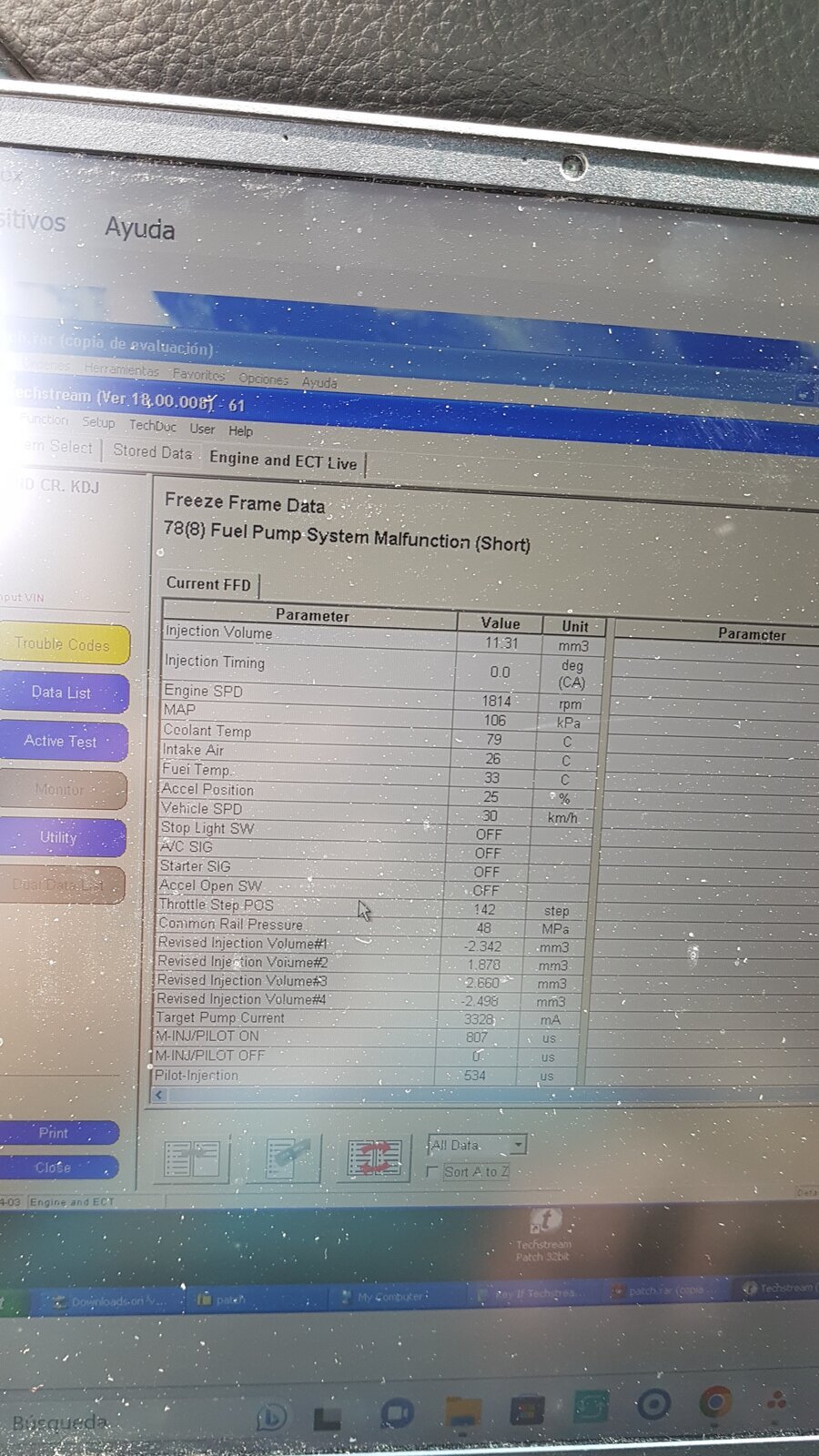

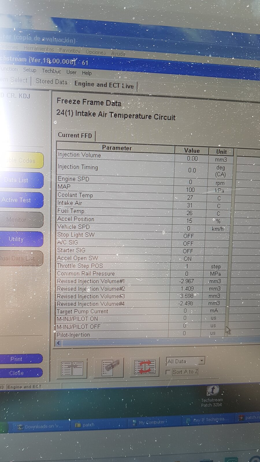

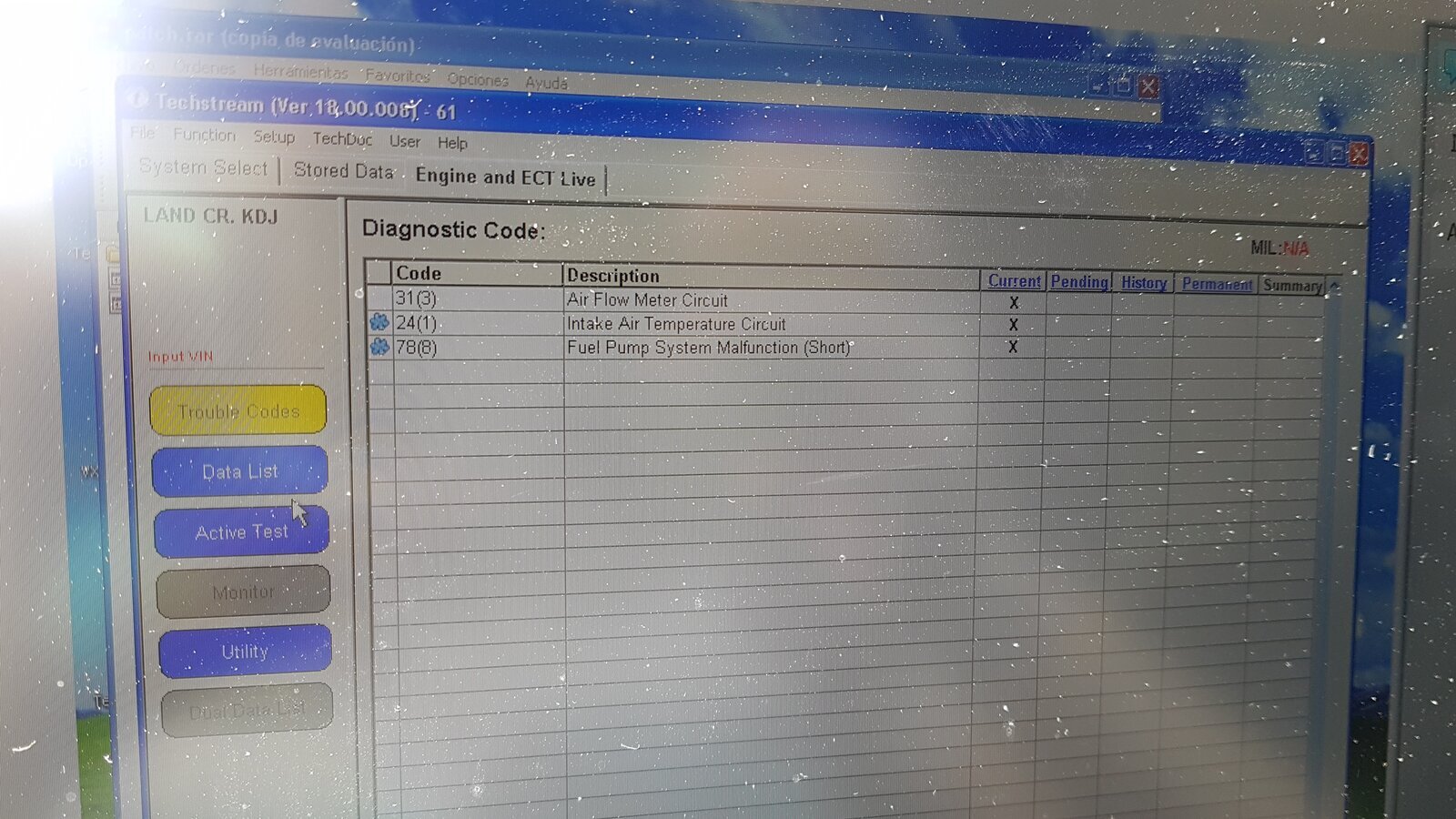

Recently got a VCI and installed Techstream, was able to get into the car and also read codes. It had 31 (air flow meter circuit), 24 (intake air temperature circuit) and 78 (fuel pump system malfunction - short). I am unfortunately not sure if these codes are all new. Today I erased all codes and will be on the lookout for new codes. I also recently cleaned the MAF, after this happened.
I have attached the codes, and a few freeze frames that the system had saved. I am new to this car so I don't have much technical knowledge, perhaps I should take it to the shop, but wanted to ask here previously in case someone could point in the right direction.

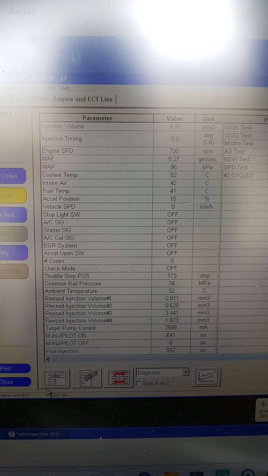

Well done getting us some data to look at. Can you get us some live data when the engine has warmed up properly (coolant around 83-85c) and is idling? That's normally the numbers we want to check initially.
How many miles are on it? EGR clean always worth considering on these if it's never been done.
Please get us that other data and let us know if the codes come back!

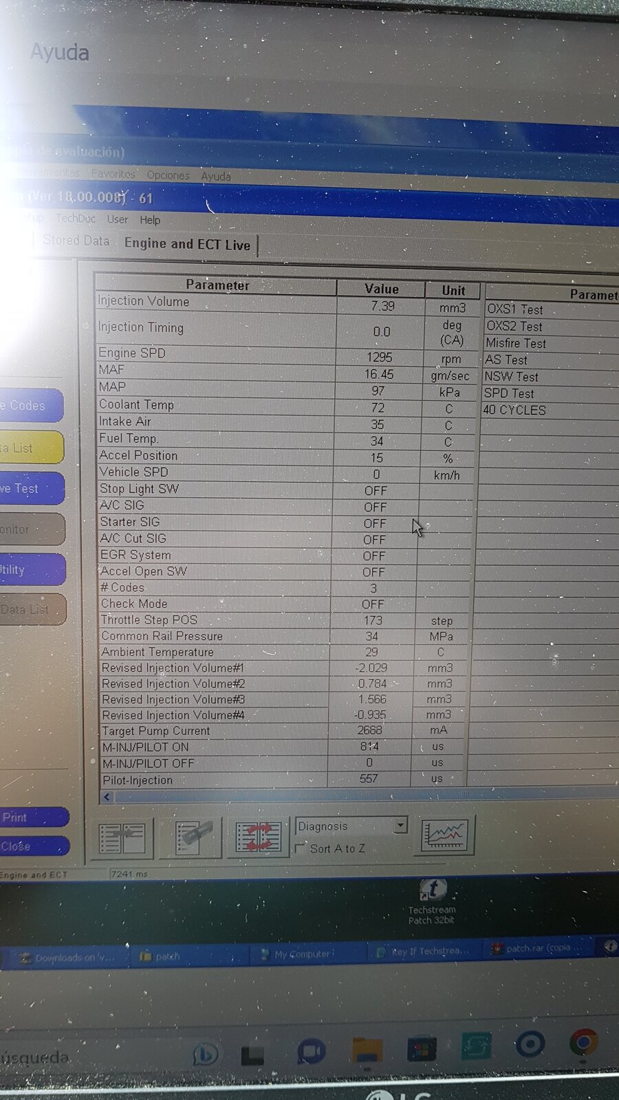

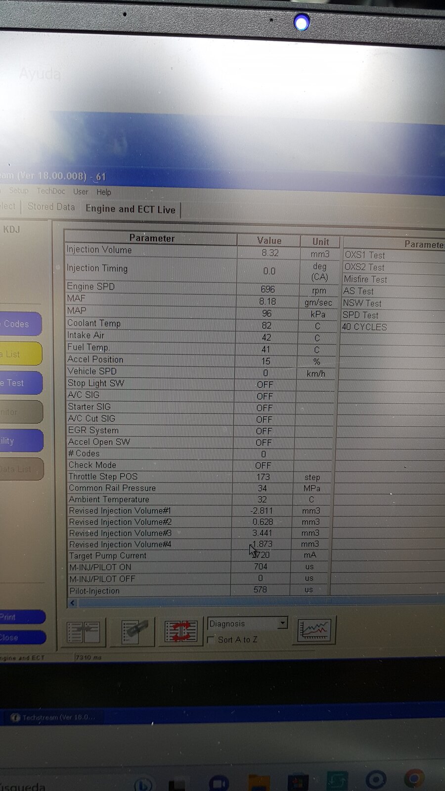

Thank you all for the quick replies and suggestions. I have attached live data with engine warm as requested. I will also check with the previous owner (my father) whether the EGR has been cleaned or not. It is at 185k KM, 115k miles.
I found a thread on how to do the EGR clean and it looks easy enough, I might try that first. If not, perhaps go with the SCV.
Does this work, or do you need a live record? Side note, I read a service bulleting today saying that deviation over +-3.0 on the injection volume might be a symptom of these going out. Thoughts?

Thanks for the data. Injectors are a bit of a minefield on the 120, you probably know there were problems with the injector seats on early ones - theres a thread on here, you can check your VIN to see if you may be affected. By this point, most 120's need to have their injectors changed if they havent already!
I think early models (up to aug 2004) give more limited data on techstream, so theres not that much to go on.
MAF, MAP & Common Rail pressure look about right to me.
Injection Volume and Pilot injection look OK.
As you've noticed the feedback value for cylinder 3 is 3.4, which is outside the widely accepted -3 - +3 range. However, the original range was -5 to +5, so it might point to injectors that need replacing, but I dont think its catastrophic. It's also worth checking the values a few times before making a decision.
Might be worth running diesel purge through the injectors, or something else to clean them and retesting.
1) Did the codes come back? If they did, let us know and we maybe able to help where to look next.
2) SCV are always worth replacing on a 120 if theyre the original short type, or possibly red / green ones
3) The most important thing on the 120 is check the oil pickup when you do the next oil change - make sure its not blocked. Threads on here cover this.

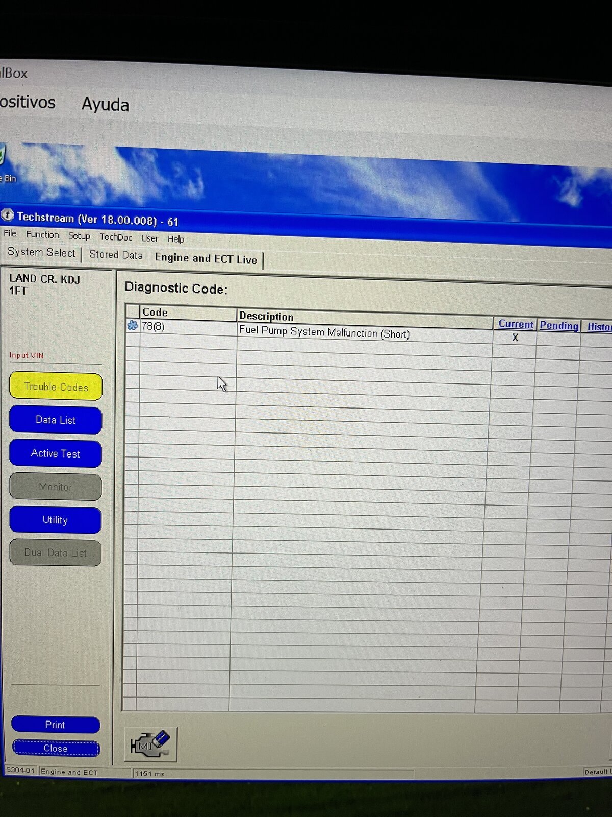

Little late here, just wanted to say that code 78(8) came back! Now just need to look into this. Seems like it could be the SCV.

Can you confirm you've got the red/green SCV's?
I cant find any specific info on 78(8) - but heres the info for 78(2)/(3).
78(2) also identifies at 'Fuel Pump System Malfunction (SHORT)' so the diagnosis steps here may be similar.
On your techstream pic, is that all the data thats available? Do you have a 'Calculated Load%' value or any relating to Fuel Pressure and Target Fuel Pressure? I know they're on post 2004 models, but not sure about yours....
