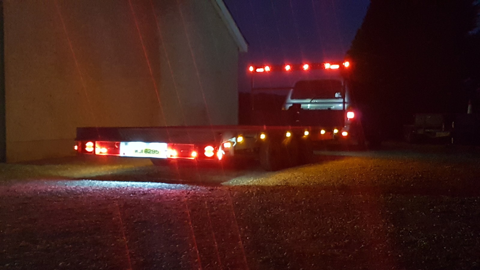

Iv already got enough lights on the trailer without adding anymore. The said lights are goin on the jeep
