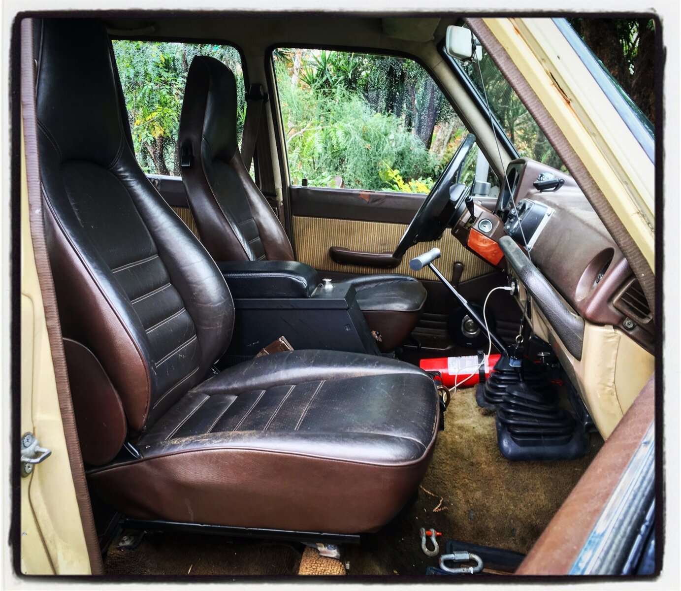

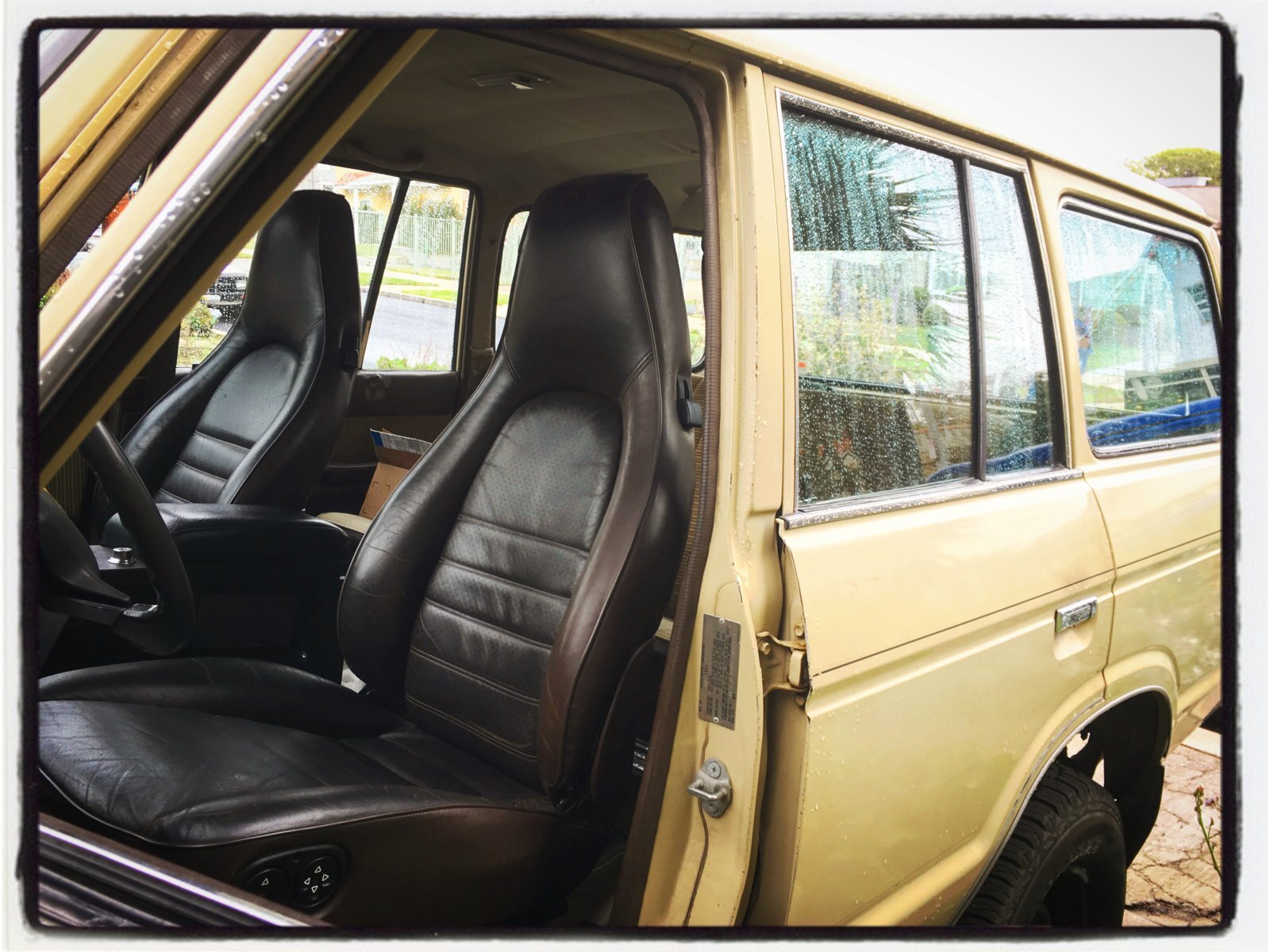

Not sure if this will meet the approval of this group in general. I'm only sharing thiis as a contribution for anyone contemplating options for TLC resto/mods.
A couple months ago I got fed up with the sorry condition of my 33 year old front seats ~ I weighed my options for restoring the seats in my FJ60 with local shops and a few kits available with places in LA such as Specter Off-Road. At the end of the day, I decided to modify some Porsche 944 seats I found on Craigslist for $350.oo . ..I waited to report the outcome until I put in some time and milers with them.
Here is my conclusion: They don't suck, at all.. .not one bit.
I have only one sight twinge of remorse and that for having to destroy the Toyo seats to acquire the proper mounting bracket configuration.
The process was simple. I tac-welded a jig onto the Toyo mounting brackets, holding them in the proper position. Next I cut the mounts off, leaving the jig in tact. I cut the mounting lugs off of the Porsche seats and transferred the jig with FJ60 mounts onto the 944 seats. ..welded them in to place and cut the jig away.
They are ridiculously comfortable, the color match is nearly imperceptible. Aaaand, of course the leather raises an element of sporty, luxury something that my rig didn't really have so much of before.
Here are two photos. Comments and criticisms welcome, of course.
Brave move, and IMO a vast improvement.
I've suffered with my back for the last 15 years or so, and a long journey in the 80 with a collapsed driver seat used to be a nightmare.
I've installed the leather fully adjustable and cleared almost 2,000 km over the Christmas break, and every hour in the drivers' seat was a pleasure.
I hope you get the same benefits. Good call Thom :thumbup:
I tend to agree with Clive on this. However, reading your post, it occurs to me that you are writing it with a big cruiser grin on your face. That means you've done the right thing. Would I personally have cut the mountings off, tricky. I would probably have done all I could to avoid it, caused myself a big headache creating an overengineered solution to a simple problem, and kept the old seats somewhere gathering dust thinking I may restore them some day. Or do that instead.
This is, I'm afraid, the start of the slippery slope called modification, as it can no longer be restoration.
Is that a 4"lift and 35" tyres I see on the horizon? :)
The only thing that matters is that it pleases you Thom. That said, I like 'em.
That's a nice modification.
