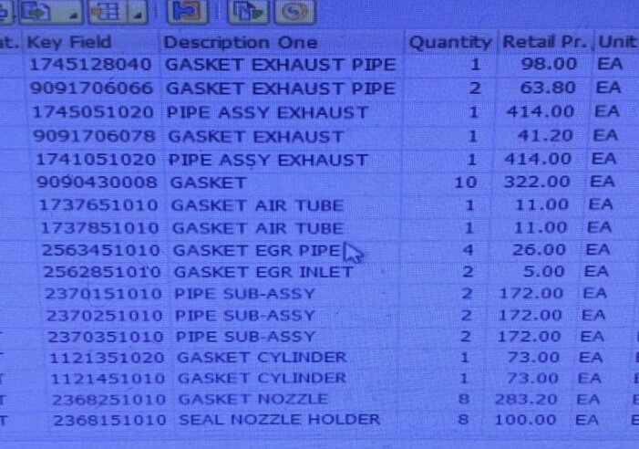

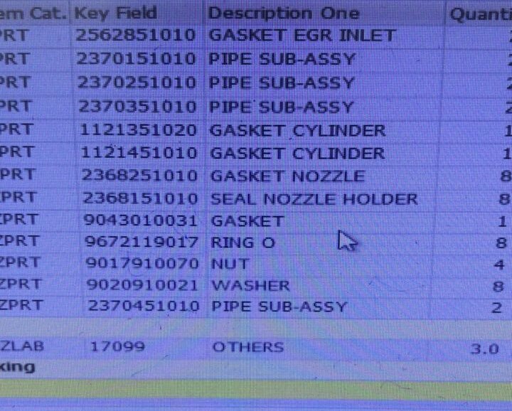

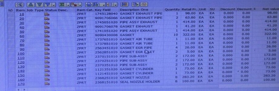

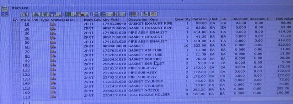

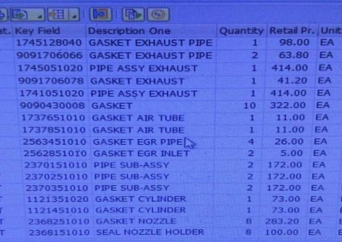

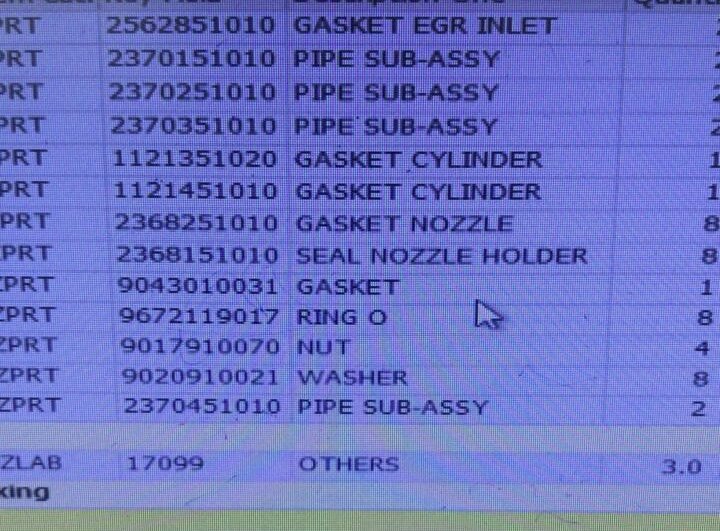

I have Added the list of the parts replaced.

Thanks StarCruiser, it is indeed an eye opener and the reason I am mentioning it here is that many people might benefit from this fix to do it on their vehicles (depends on the legality of the fix where they live off course).
