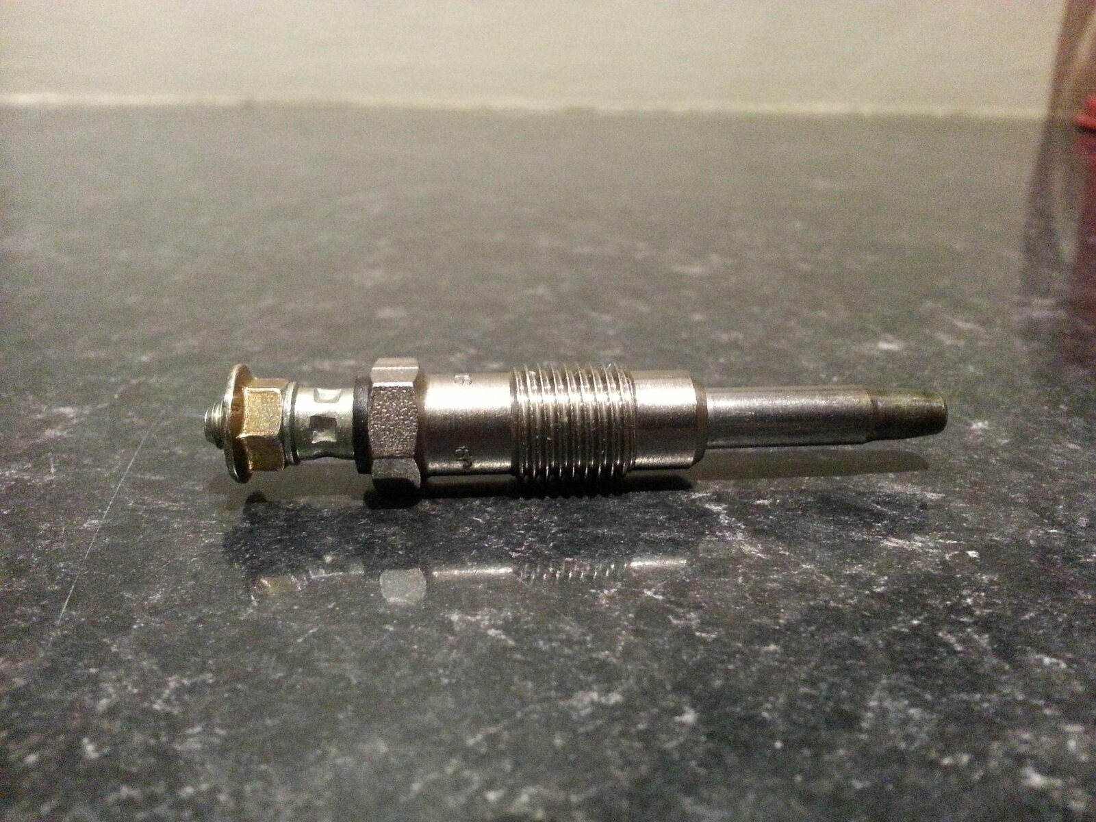

You need a source of heat: £5.00 on ebay and two glow plugs from a pug arrive on my doorstep.

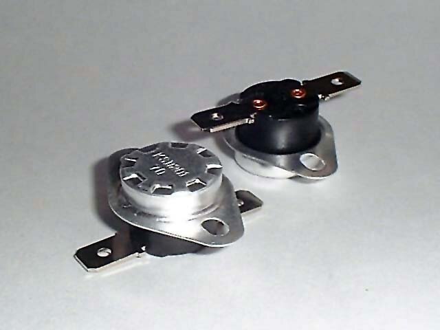

We need something to control the heat: £4something and 20 thermostats arrive home Hong Kong

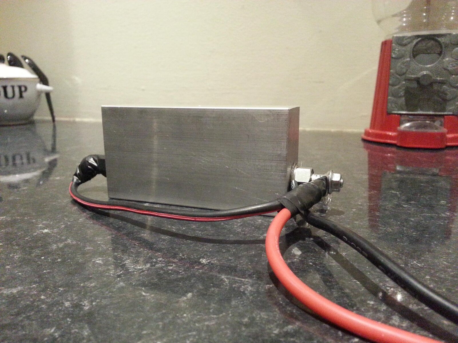

Part-finished product:
With the help of Tony, his drill press, tap set and a shed which would cause an Eskimo to say "FFS it's cold in here", we knocked together the start. (Thanks BTW!)
The two glow plugs are tip to tip. We drilled all the holes as small as possible to minimise the gap between the glow plug and the ali block. While there are parts that are touching, there are air gaps. I was thinking of heating the block (a lot) putting in a drop of molten lead in them and quickly screwing the glowplug back in.
I still need to drill the main channel through the block which will be a ±12mm hole, tap both ends and put a threaded hose barb in.
Another idea I had is to drill two 6-8mm channels next to each other and use it in a U-turn way. I prefer option one as it gives you a small reservoir of hot water.
Electrically, the thermostat switches off at 45c and will drive a relay to turn the glowplugs on and off.
Does it work? Well, the block of ali was left outside and cooled to 9c. Turn it on and it reached 20 degrees in about 10 seconds. Plenty to melt the frost on the window. About a minute later it was 45c.
In under two minutes it was 70c and my desk started to smell like hot paint.
