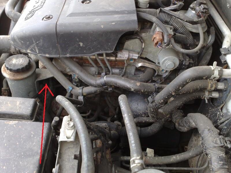

The early one I had was a Lindop Toyota one, amd had long grey plugs, that plug into the injection firing module, like the first image.
This type also needs an input from the accelerator pedal, and a posative and negative connection from the battery.

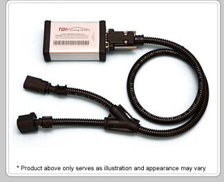

The other early type type I have had, have 2 square square plugs, and these simply connect into the common rail high pressure fuel line, (second image).
I had both of these, but didn't get around to fitting the first type, as I run out of "fitting time"
I fitted the second type, but I really couldn't feel much difference.

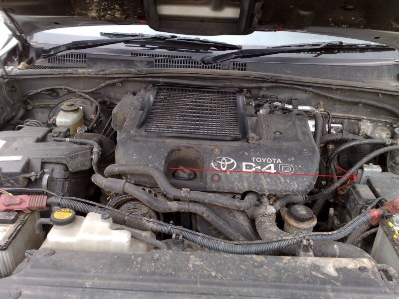

Image 3.
As mine was an auto, any extra power that the engine developed, simply caused the auto box to downshift, and in my opinion, defeated the idea.
It didn't feel any different, and my fuel consumption was unaffected.
I guess it might feel differenct on a manual.
