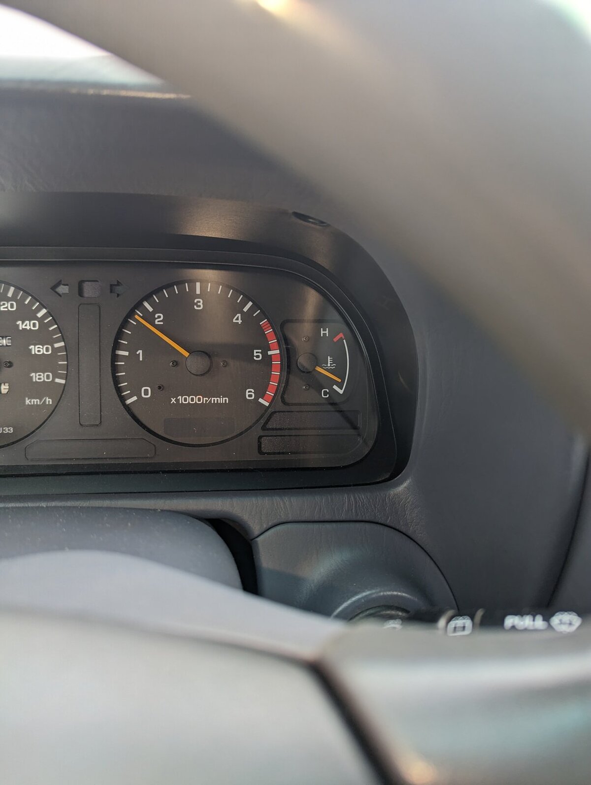

1: engine not going up to normal operating temperature.
When driving for no matter how long on normal roads the coolant temperature barely goes over the minimum. When going highway speeds it goes to the middle about +-90° and stays there. And as soon as i leave the highway it immediately drops again. Also takes ages for the car to warm up a bit. Could this be a faulty thermostat? Or maybe the viscious fan? I tested the fan by turning it and it seemed to work properly.

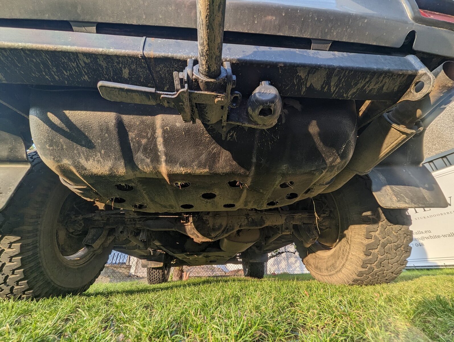

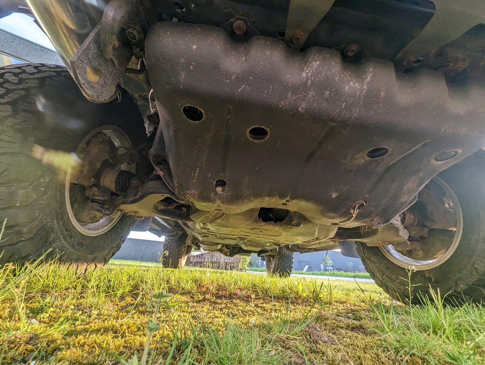

Are these actual "skidplates"? Did they come standard or are these aftermarket? There one in the front,middle and back of the car.
Attached pictures of the skidplates and the temperature gauge of where it sits when driving.

All sounds about normal to me , temperature gauge is very basic on or off but if the truck is new to you then you would be well advised to give the cooling system some attention , removing the radiator for a clean and changing the thermostat costs little .#

Your skid plates are factory Toyota from new .

Would you consider the factory skid plates good enough for going off roading once in a while?

I've done some pretty extreme off roading with just those same plates and i honestly think to replace them with fancy aftermarket stuff is just a waste of money .

As far as the skidplates go they do look and feel very solid. Since there are so many aftermarket ones i thought maybe the original ones arent as good. But u made that clear for me that they are! So ill be keeping those.
