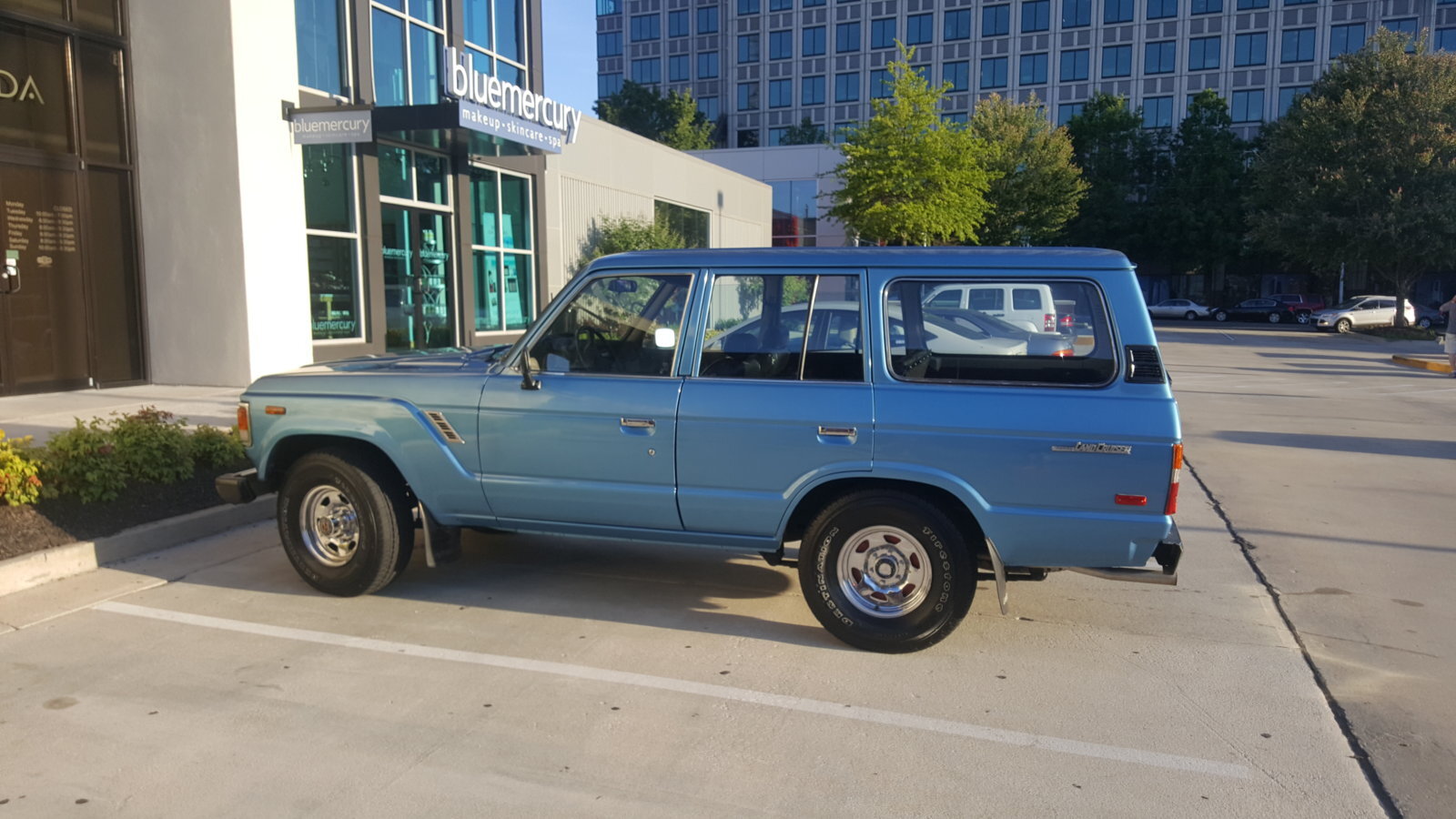

I currently own a 1984 FJ60. The engine locked up after the front crank pulley nut came off.

Wow, what a shame, it's a beautiful looking truck!

Your truck looks great and, although my suggestions send you to another forum, you should let us know how you get on and stay with this forum (because it is the friendliest!).
