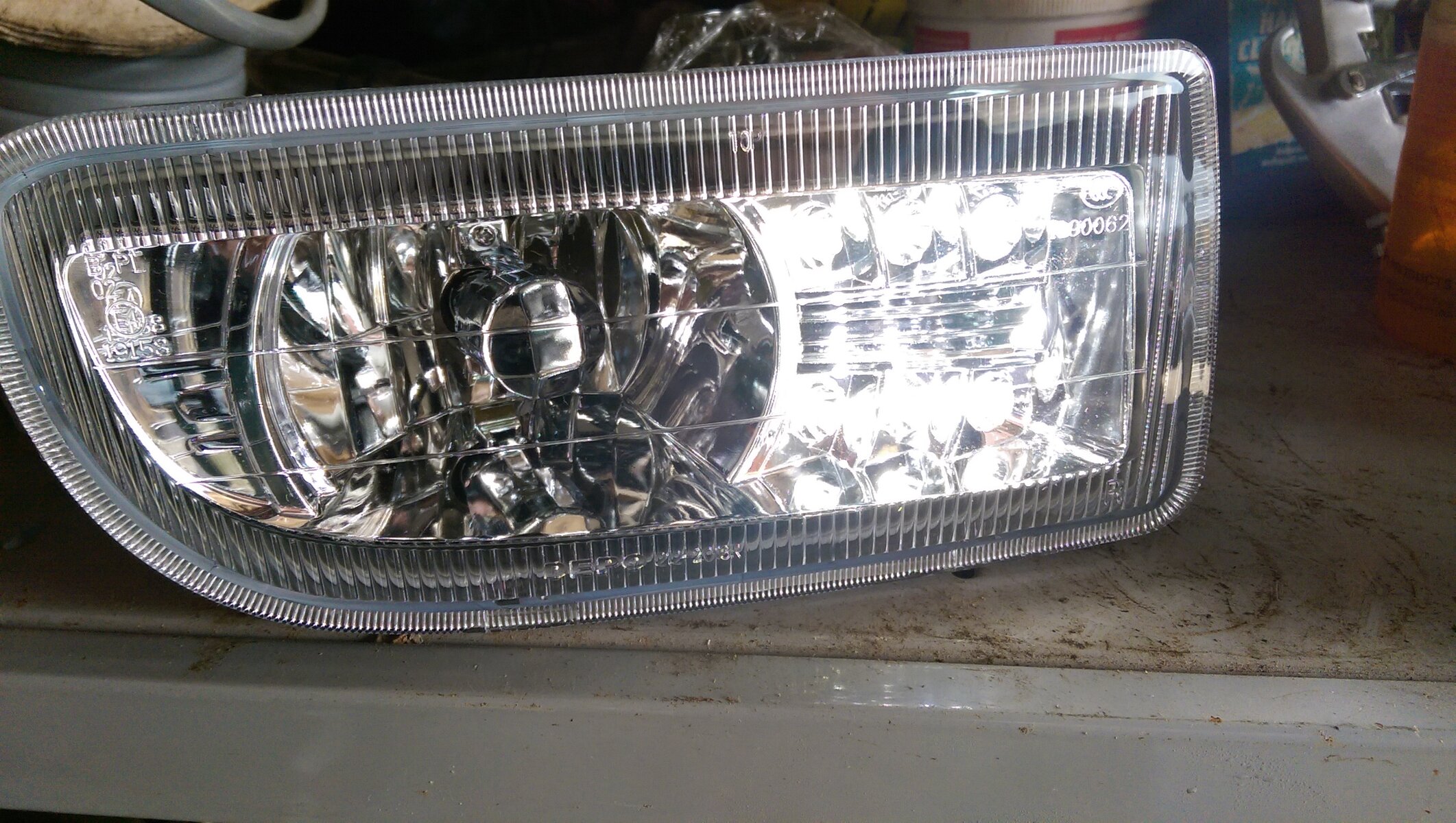

just bought some of those, they have arrived, but not fitted yet, will post pics, out of the box they look really decent quality.
Some one else bought some back in December and we are still waiting for his pics....:cry:
here you go (not fitted them yet) they look great, but impossible to get a photo that isn't just a white blur if it go round the front.
my original two were cracked, black on reflectors and half full of water :-)

There is 6 leds built in with about 1m of cable...I was going to join this onto the sidelight.
The fog light bulb is the same as standard.
