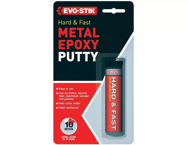

Yours wasn't as badly damaged as mine because it was a low impact whereas mine hit a Cruisers steel bumper wheel carrier . There should also be a behind bumper steel crumple bumper - mine had been removed at an earlier date .
A stapler is only good if you have all the broken off plastics which i'm sure you don't but some sets stronger than metal plasticine might help to fashion new lugs on the headlights etc 1623953231995.png

A stapler is only good if you have all the broken off plastics which i'm sure you don't but some sets stronger than metal plasticine might help to fashion new lugs on the headlights etc...
That's the problem. I don't have any of the broken bits, so will have to get creative and make something. I've got a couple of tubes of Quiksteel knocking about somewhere....
So making up some lugs is an option. I also bought a roll of this stuff a while back, which has proved pretty handy for knocking up wee brackets and the like...
I'm sure I'll come up with something, once I've pulled all that cable tied stuff of and had a good look at what's underneath.
