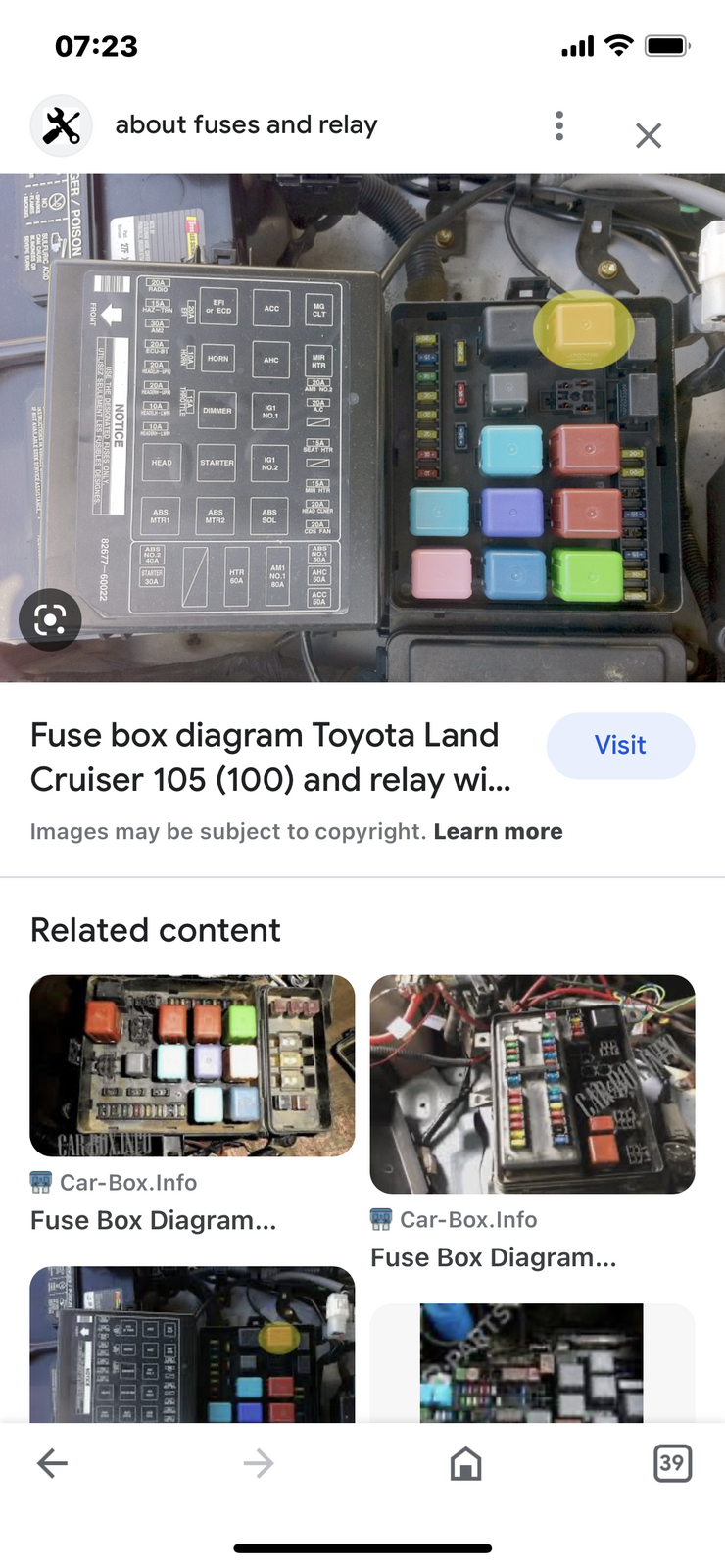

Hi would remember where and which fuse it was as I could manage that . Cheers and thanks for your help

It’s the fuse box on passenger side near ahc tank they are marked it’s red I think

This the fuse box

Many thanks for that ill investigate tomorrow and report back . What are you doing in Vietnam?

Kieron, if that 50A fuse is fubar'd on your vehicle, I can let you have my old one which i know is ok.
When I deleted my AHC recently, I removed the AHC pump/reservoir and that fuse.
When the weather improves I'll be removing all the other AHC components from under the vehicle.
PM me if I can help... the fuse is yours if you need it.

On closer inspection today . I tested the fuses and relays but hey simples a leaking hydraulic pipe and the reservoir was empty . I put some fluid in and hey presto light went out OFF which was flashing. It moved into normal position but the reservoir emptied and I saw some smoke with the bonnet open. It must be a hydraulic pipe passing fluid onto the engine or exhaust
