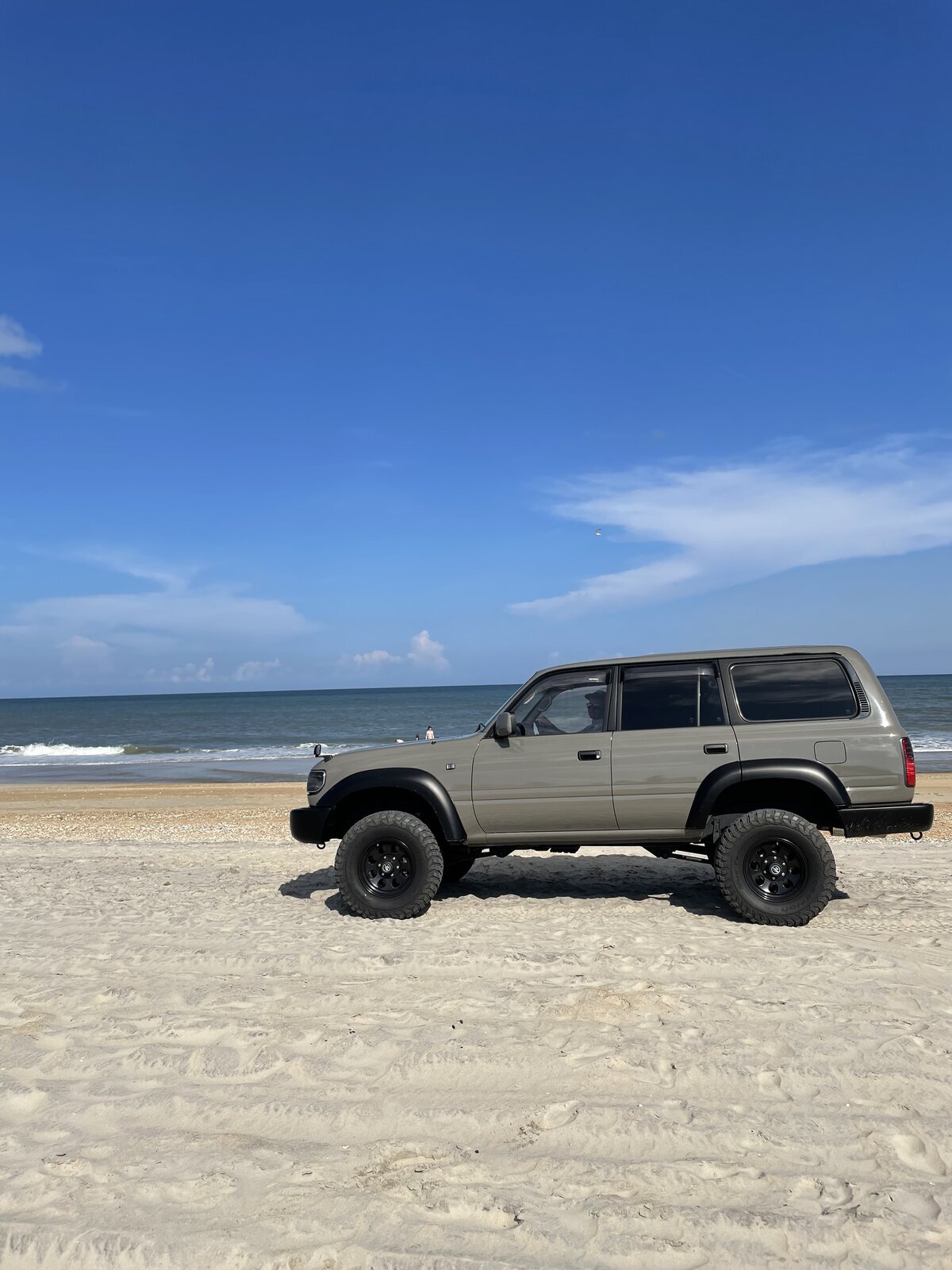

Good evening folks. I’m Will and the proud owner of a 95 RHD 1HDFT Land Cruiser. I purchased this truck while I was stationed in Japan and recently brought it back to the states with me.
now for the HELP part:
I took the truck to get registered and inspected and they noticed the passenger side inner axle seal was leaking diff fluid into the swivel hub. So I purchased a complete rebuild kit and went to work. I did all of the seals, swivel hub bearings and wheel bearings and since then I have had a slight steering wheel shake at 45mph (70kmh) and a loud “whom whom whom” noise that increases as I increase speed. I have taken the hub off and re-packed the outer wheel bearings on both sides and insured that the pre load and lock nuts were at correct torque. I have also had the wheels balanced, new steering g stabilizer, and new lift installed since this has happened. At this point I’m contemplating taking it all apart again and starting from scratch.
I know this was long and would greatly appreciate any help you could give me.
thank you,
Will
