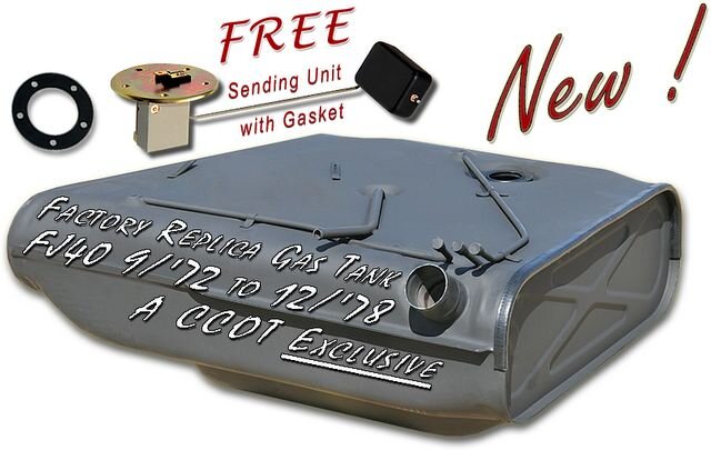

I am trying to find the "caps" to the three lines that are coming out of the gas tank right above the fill tube. Part number? where I can buy them? Thanks all!! -Fenoy TJ40gastank.jpg

Caps are not factory - they are only installed to paint the tank - those should attach to your vapor separator.
