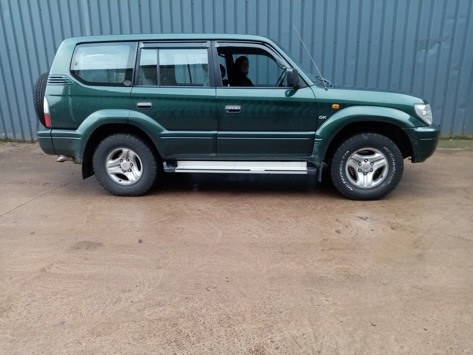

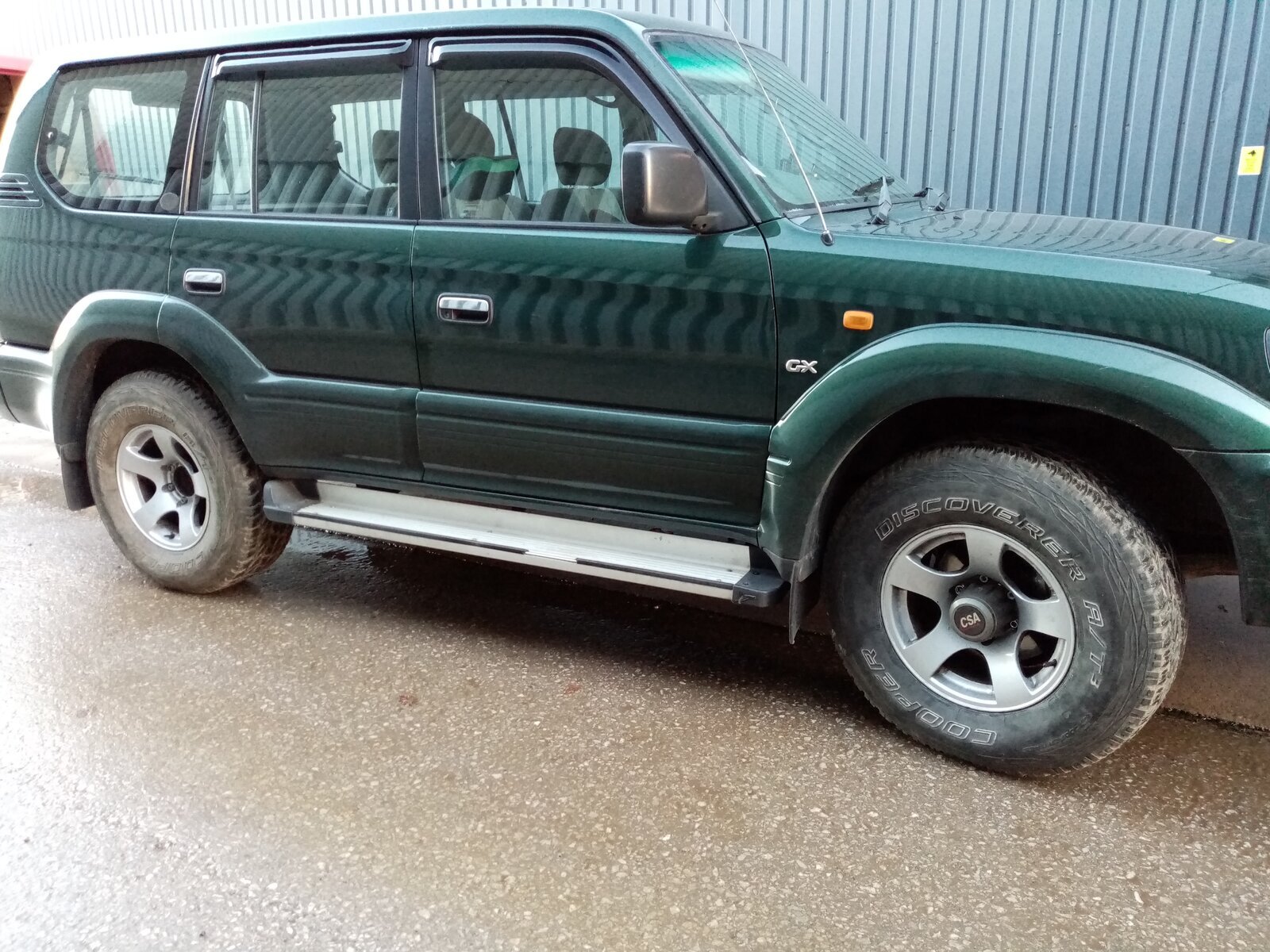

I've just recently purchased these 80s alloys with Cooper AT3s on em, and by the feel they're better in every way to the previous BFs, BFs are good and had them on me LJ70 and 90 land-rover, but the coopers are low in road noise which is a bonus, and yes, I've had 4 landies and an ol 79 V8 Rangie, best thing about that was the sound of the V8, non of them are in the same league as the LC.. Anyway I'm also looking for a spare 80 alloy to go with the 4 that's on it, I have the full set of original 3 spoke alloys for the colorado which doesn't float my boat in looks but hey can't be a chooser....
It's standard ish apart from wheels a few LED bulbs & front Tow bar... Standard VS non standard.

Now then, Mr G. A very warm welcome from the capital of the people's republic. Sheffield S6 if you're in the vicinity.
It so happens J100 my location is sheff & not far from NGH...
Greetings and welcome from S25. Good to see you're a Collie owner, D4D I assume? I had one and loved it. My present one is a V6.
BTW they are not standard 80 alloys.
Hi Andy yes mate it's the D4D, & interesting you mention about the wheels, the chap who sold them had a lifted 80, but if you know what model of vehicle they're off this would help me locate one....
Good to see another steel city mbr here...
Unfortunately these are aftermarket wheels and finding another single wheel of that design with the correct dimensions and offset may be this weeks challenge. What size tyres do you have? I fitted 80 series wheels to my D4D with 275/70/16 BFG AT KO2's which worked fine and didn't catch ( with a 2" lift). On my present Collie I have some aftermarket wheels which have a slightly different offset to the standard 80 wheels with the same 275 BFG's and they don't catch with the standard suspension.
I wouldn't worry in the short term, your existing spare will get you home even if its slightly different in size.
I'm on 265/75/16s which I know isnt standard, the 75 gives a little lift compared to the standard 70s, and yes, i can see this being a challenge finding an alloy identical to the ones I have.
