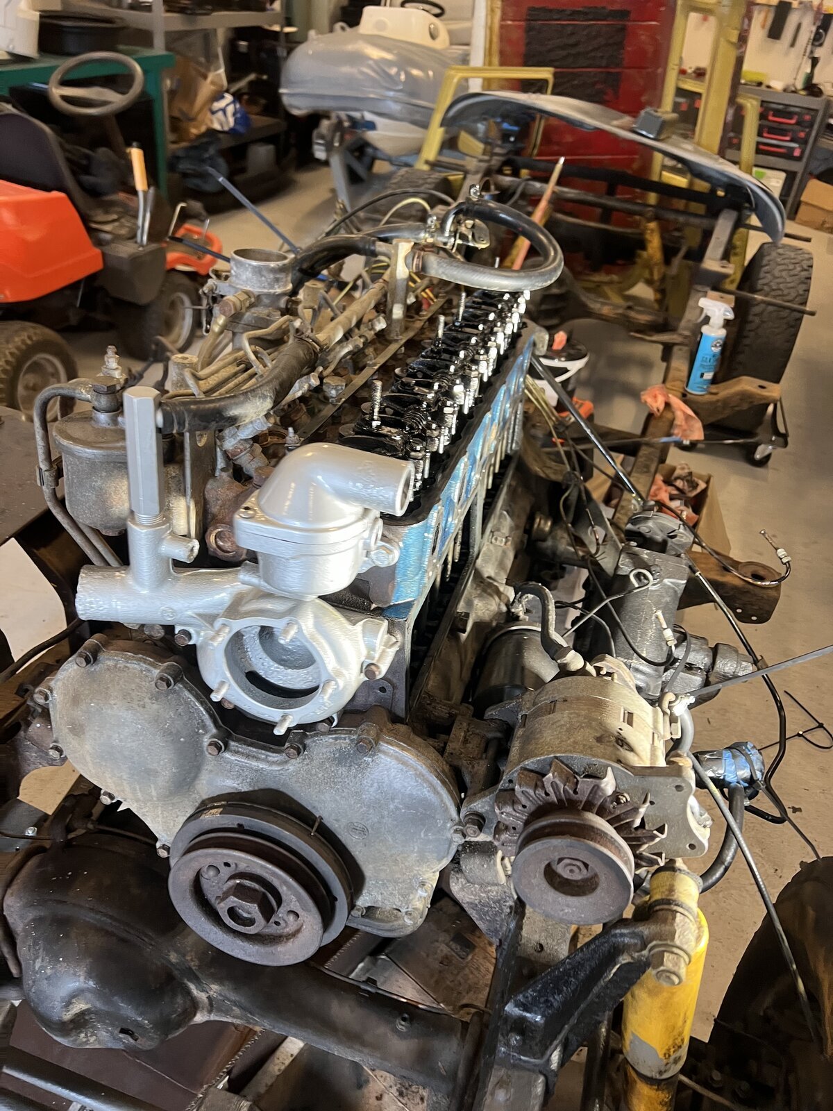

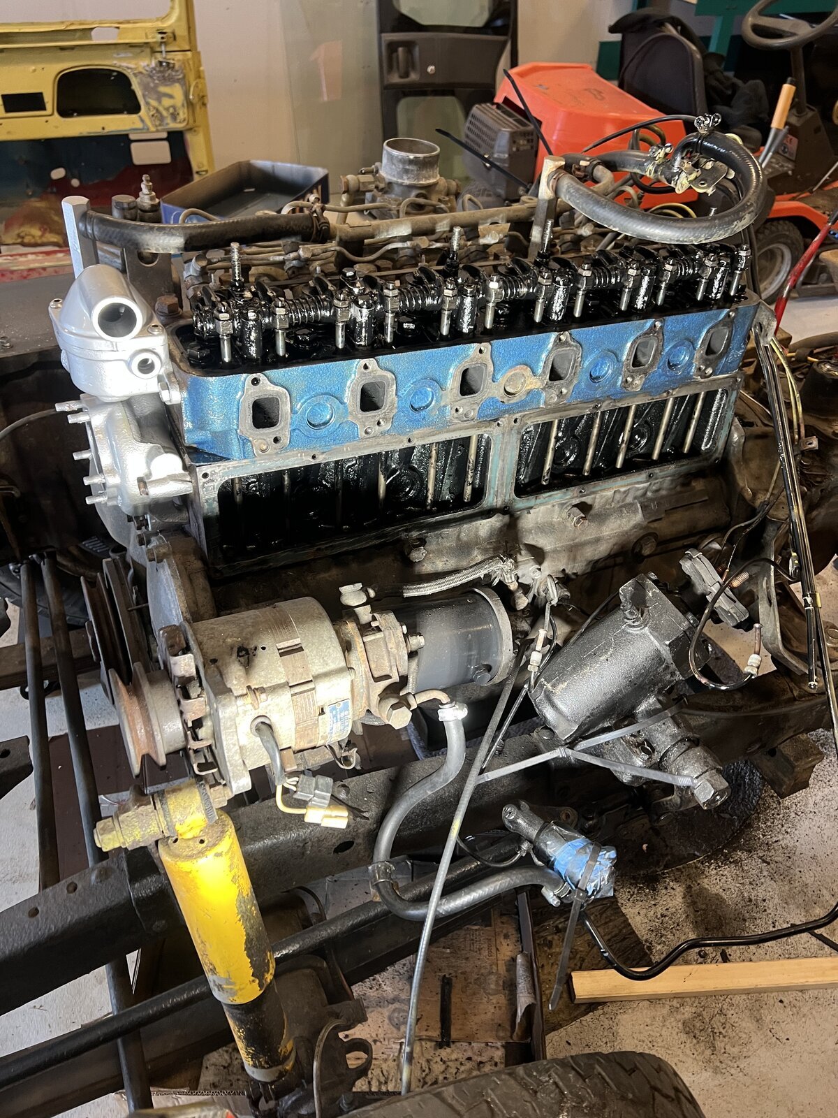

Hello!
My name is jesper!
I live in Sweden and working with my HJ45 LP-KW

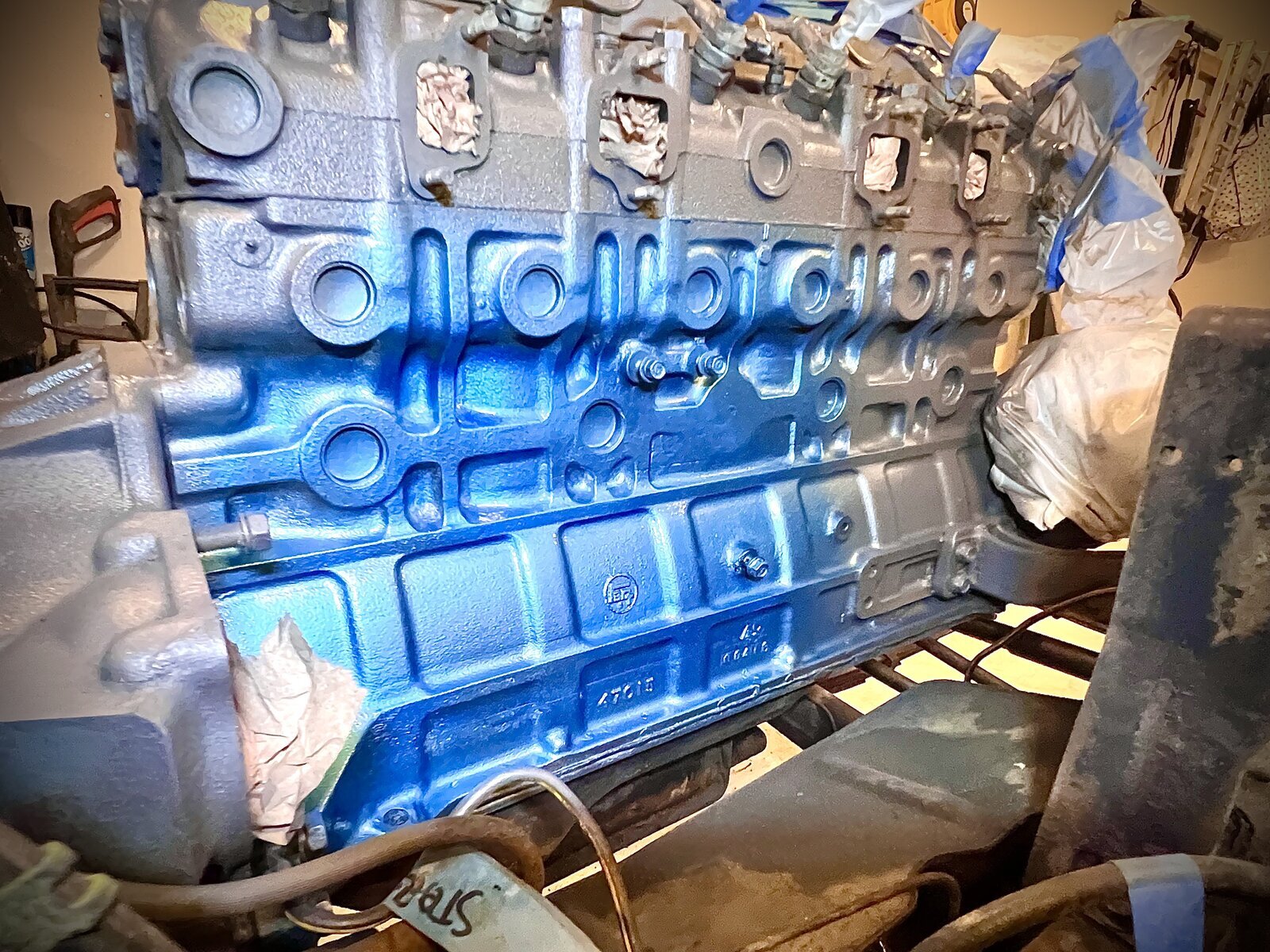

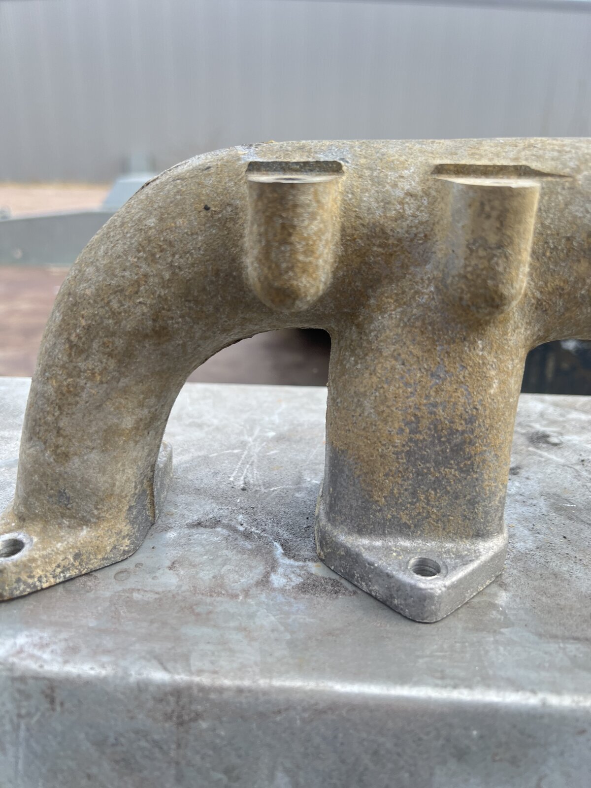

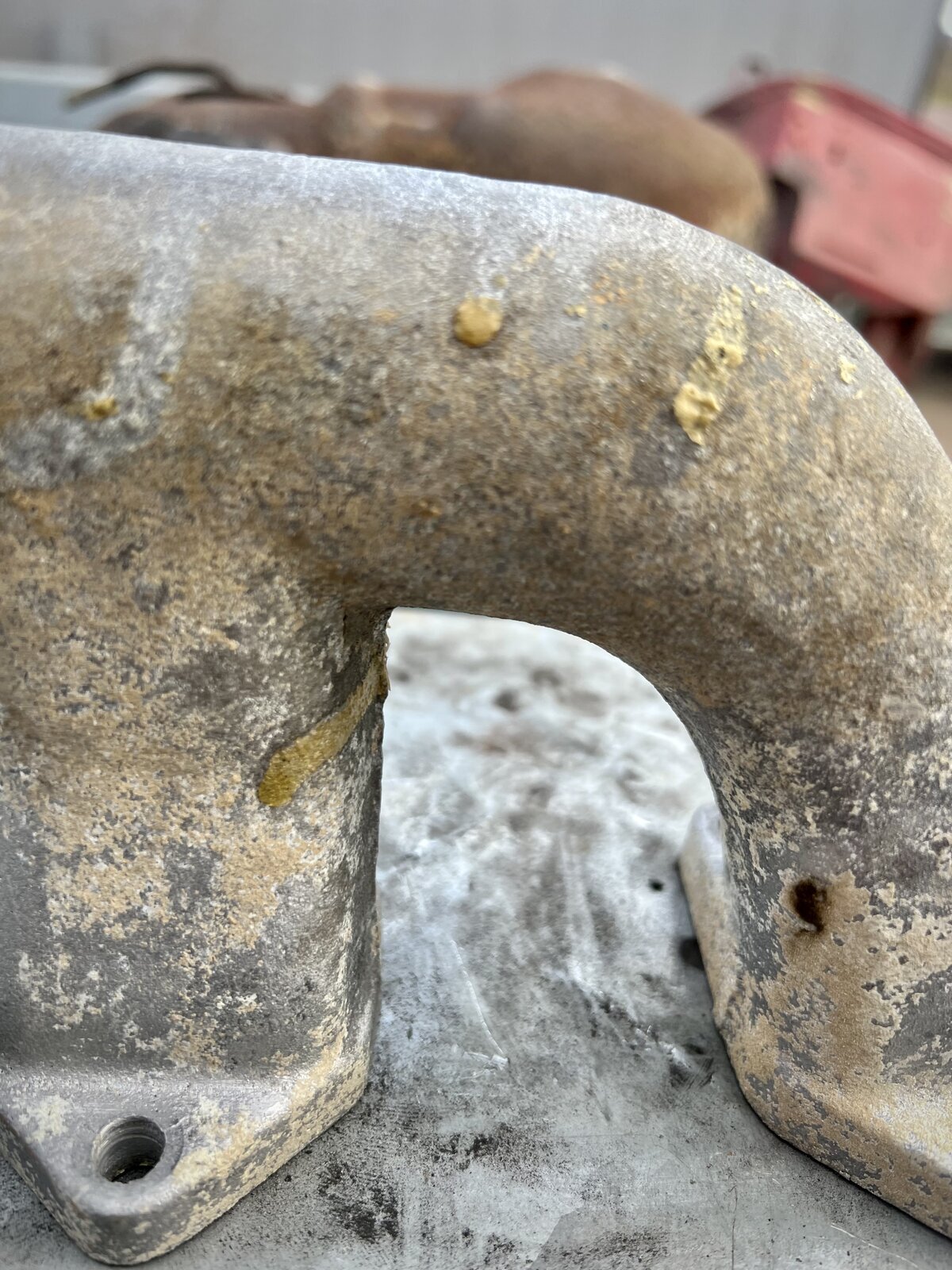

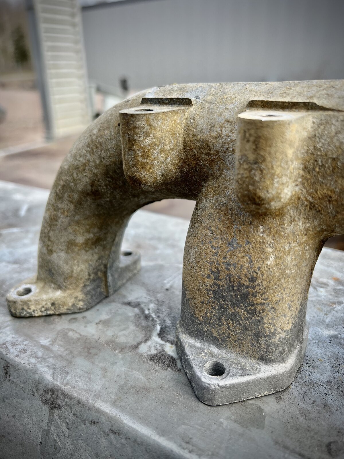

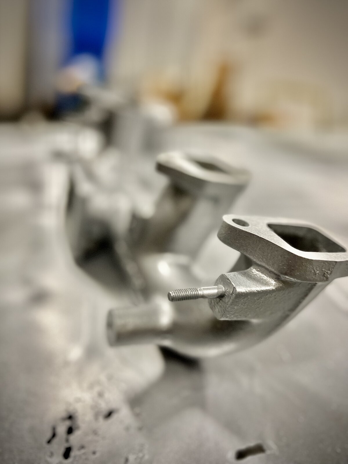

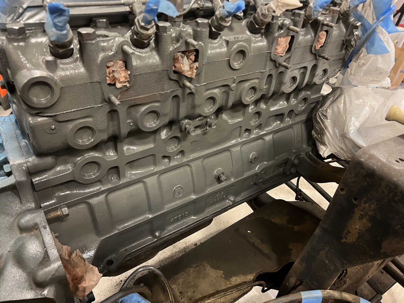

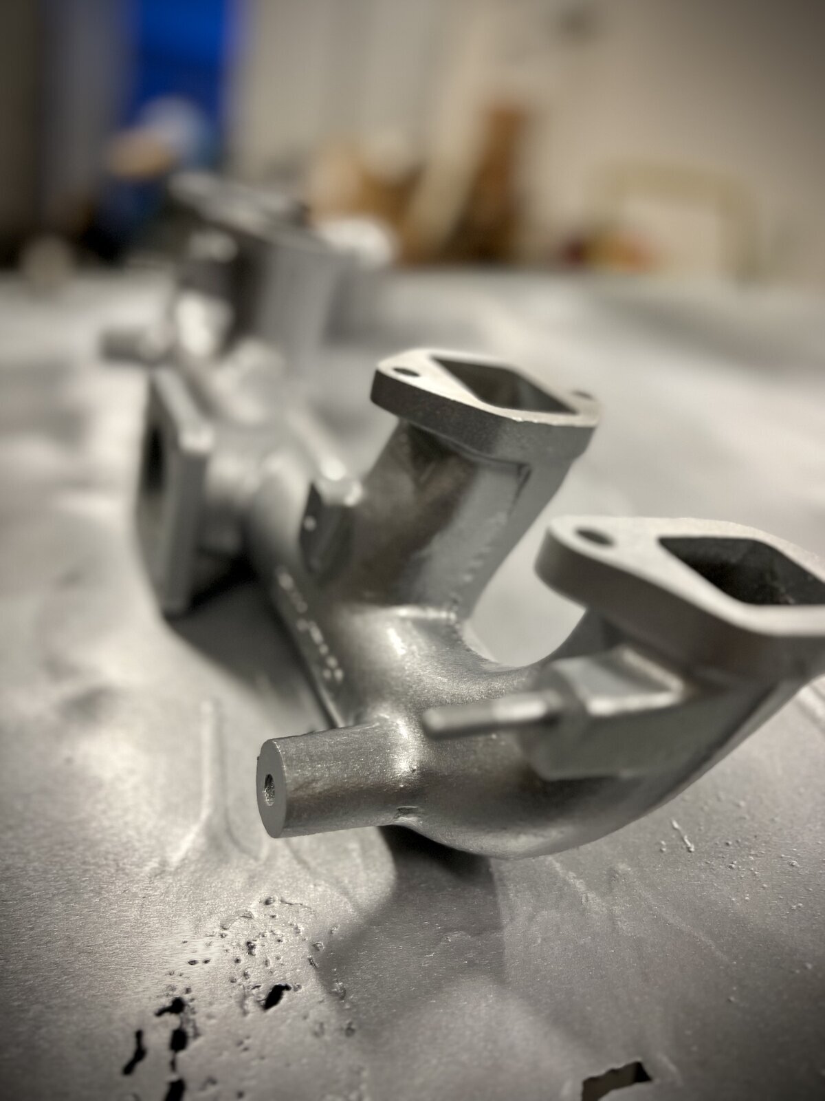

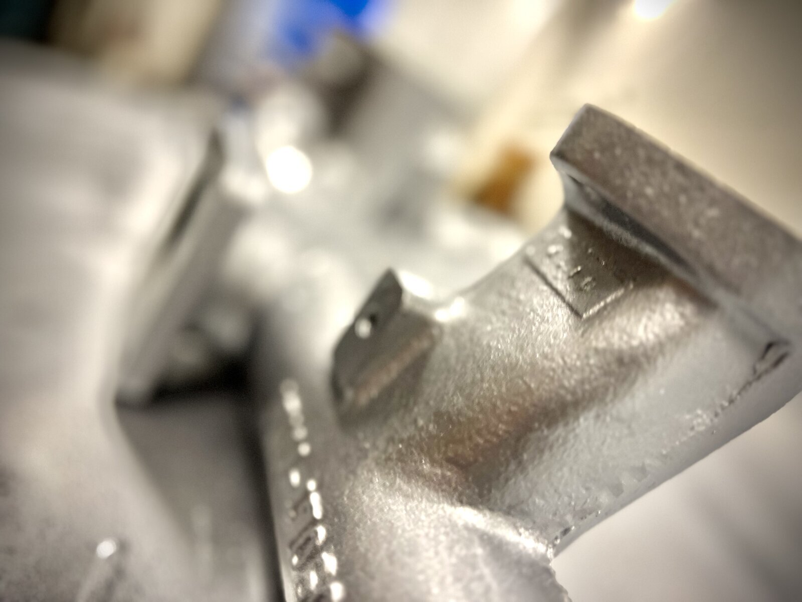

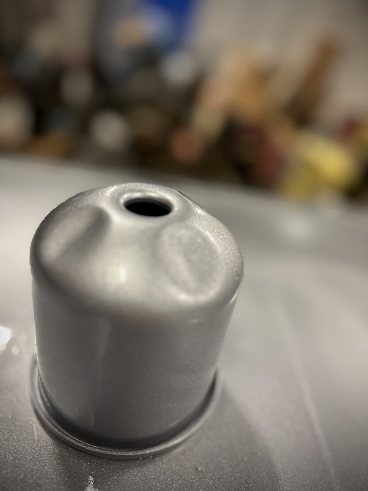

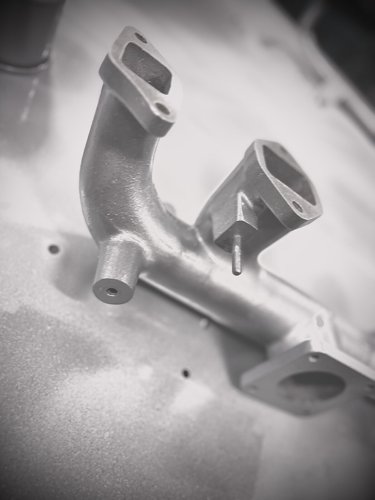

just like most others, sometimes you wish you had unlimited time! but yes got in a few productive hours today after work!
Yesterday I disassembled the fuel pump assembly, intake manifold, starter motor, fuel lines!
have started work on these parts today!
after proper washing in the machine, spare parts washing with heat, I have blasted some of the parts & some of the parts I have chosen to grind!
Also sharing some pictures of some parts that had time to get a visit in the paint box too!
Apologies again for the English, so you need mercy for i have to use google translate!
all good // Jeppe

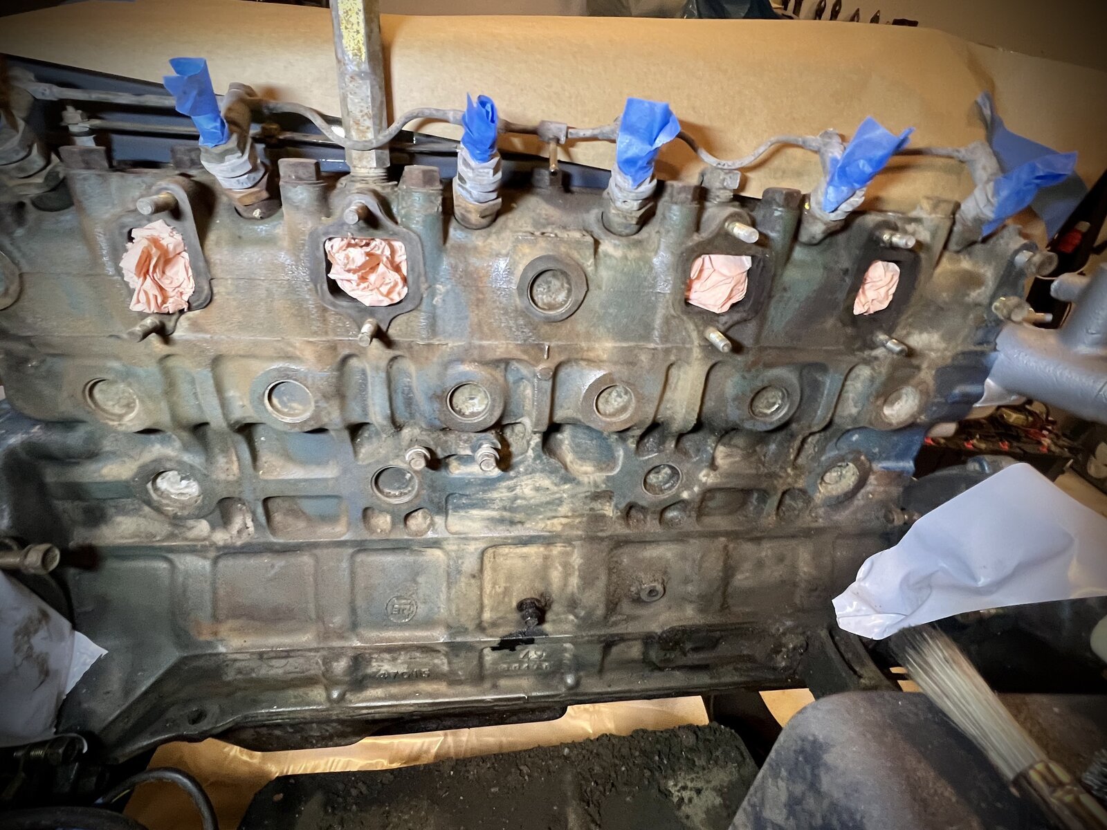

Looks like an H Tony - 3600cc
Jesper, careful how far you strip the fuel pump assembly down as they usually need to done by a professional and need to set up with the timing of the engine. Taking it off, cleaning and reinstalling it without moved the engine internals, will be fine, I think.
Also, don't worry about your 'Google translate' English as I am sure it's a lot better than our Swedish!!
Looking good!
Regards,
Rodger

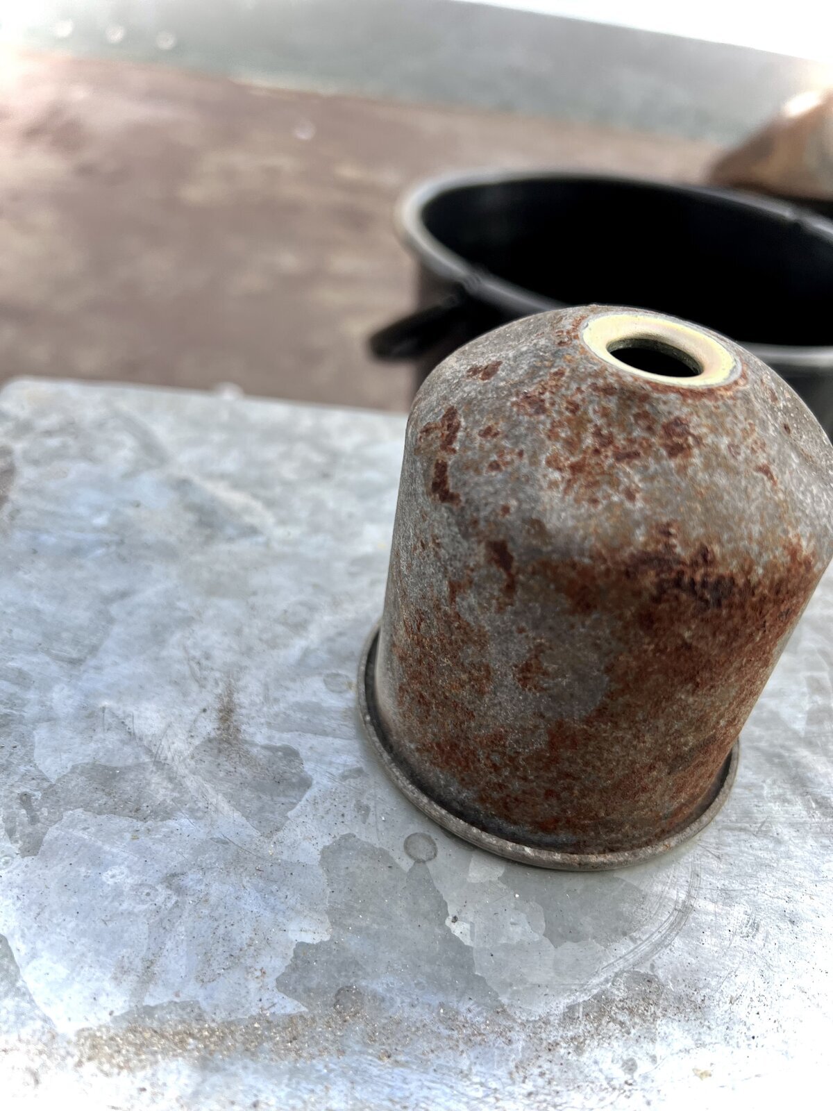

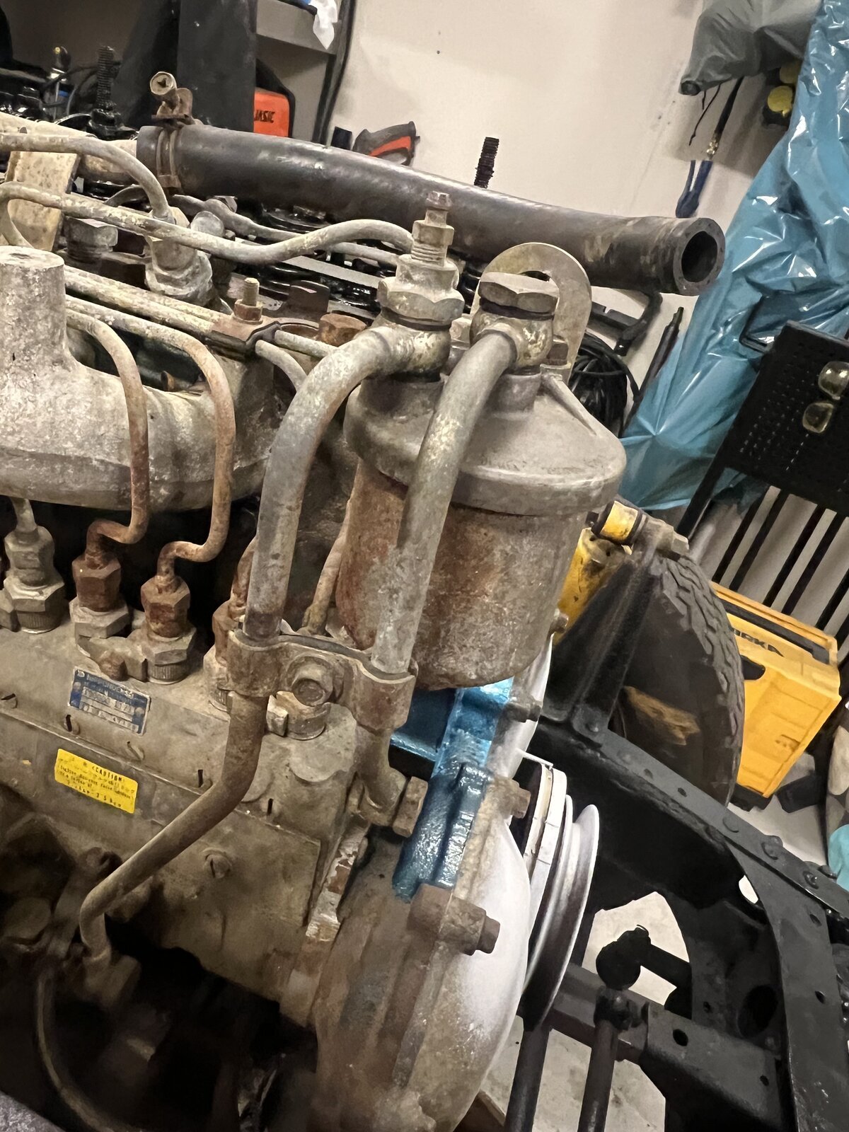

Somebody now where I’m can get the fuel filter house top consol?
Hi Jesper,
For the fuel filter housing try www.megastore4x4.pt as they have some parts for the H engine and they may have good second hand parts too.
It is not one of the Gazoo Racing - re-manufactured parts for Toyota 40 series - but it may still be available through Toyota.
It looks very similar to the 2H filter assembly but does not carry the same part number.
