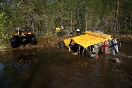

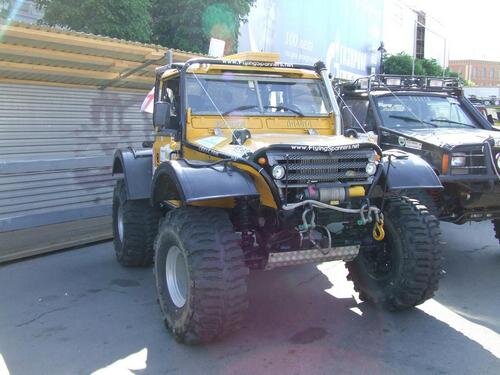

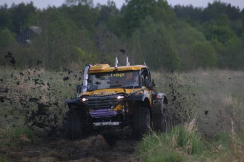

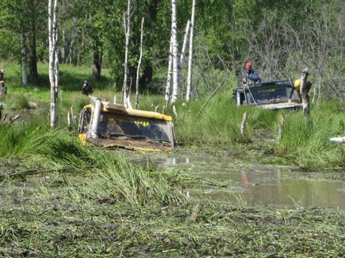

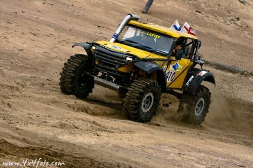

Tony - the one at the top is a Series Landrover cab and about 1.8m of chassis, all very heavily violated, running an Isuzu 2.8 turbo diesel, R380 gearbox, Volvo portals, double beadlocks, 39.5x18 boggers, high speed hydro winches - it was called "Petal" and competed in the Baltic trophy raids in Prototype class. the one underneath is "Mouse", space frame, 450hp 5.7 litre V8, TKO transmission, volvo portals, 4 speed hydro winches etc etc fast as.. errr.. a fast thing off a shovel,
theres a build vid HERE
Everything scratch built by a squad of nutters in a little barn in Hampshire ;)
holiday snaps if you're interested;
Sad to say but theres not much on any standard 4x4 that will live with proto racing Crispin hence having to build it all, having said that the Transferbox on a Landy is almost godlike in its ability to take a kicking and keep on working 8-)
