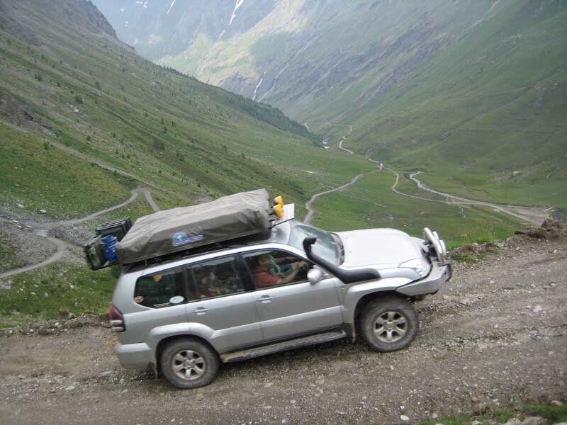

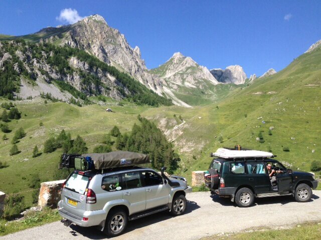

Hi,
the rules are simple for exterior carrying of gas and fuel, basically they need to be in a position where they are unlikely to get crushed in a front or rear shunt.
I use a front runner rack for my gas bottle about £60 and standard racks for cans about £20
I carry the gas bottle and 20l diesel and 40l water
also i slightly modified the front runner rack so I can leave the regulator on and i cable tied the hose down to underneath my roof rack to a BBQ quick connector. But u must always shut off the regulator for travel same as a caravan.
ps mine is the slightly modified 120 ;)
Common sense rules again!
Cracking photo BTW Andrew! :icon-biggrin:
Mr Cooks pictures stolen from his July trip report to the alps :icon-biggrin:

This was a family trip so i needed more water and in europe there is no real risk of not getting fuel. But I always carry extra water in case you have a rad hose failure and have to refill the cooling system, this happened to a disco on my last Pyrenees trip.
Also it is surprising how much water 4 people get through!
Also I made my own roof rack and hence all the mods, the bib at the front stops the roof lights shining on the windscreen and lighting up the dash.
