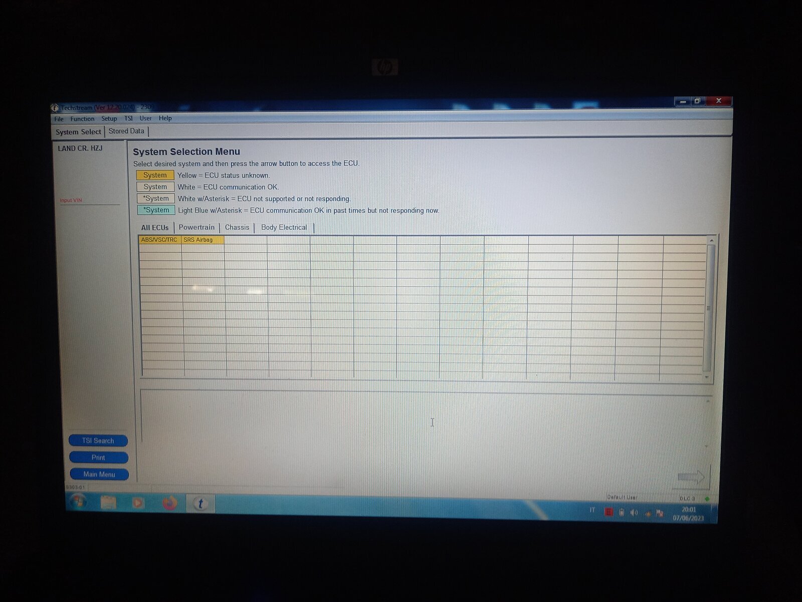

Hi,
I also made the diagnosis with the Teachstream but for me it is unable to communicate with the control unit, as it even sees ABS/VSC/TRC and SRS Aibag ECU that the car does not have.....
I really don't know which tool to use

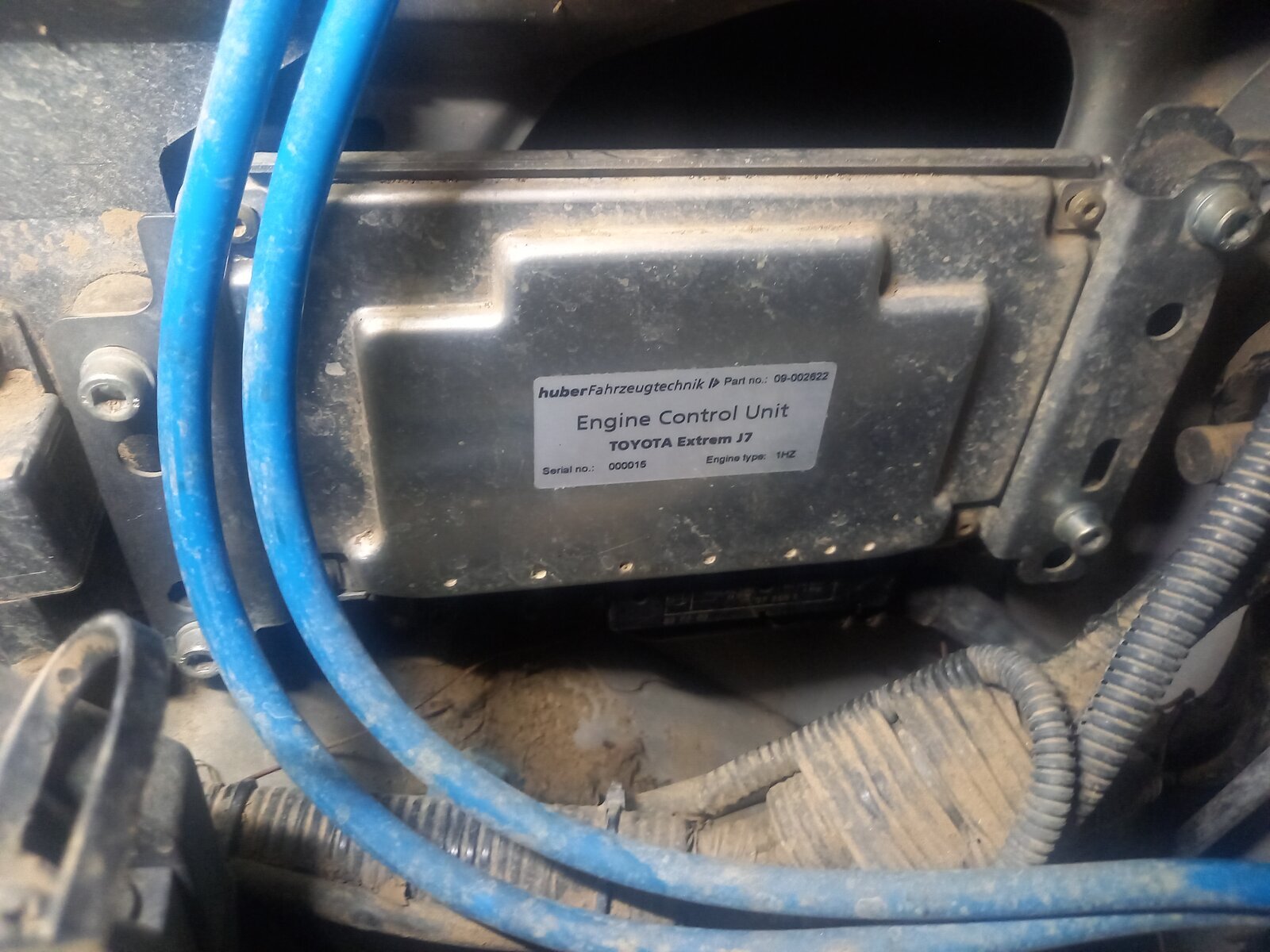

Hi Giacomo, I saw your question on Buschtaxi.net as well, I've answered you there more extensively.
In short: please establish that the unit involved isn't just an EGR management unit.
