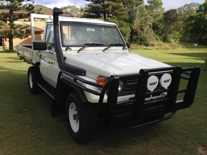

Just joined up wanting to ask a question about rim offsets. I've looked on the Internet a lot and can't find much help. At the moment I think I have 15x8 rims on with 285/75r15 mud tyres. I'm not sure what the offset is but I'm wanting to increase the offset so the tyres are flush or even a little bit wider than the flares and tray. Is there a certain rim with standard offset that does this. Or do I have to try and measure it all up.
Also I will be posting some pics up of my car tomorrow when I get on my computer as I'm just on mobile at the moment.
Thanks for any help and looking forward to all the information and help I can get from this forum in the future.

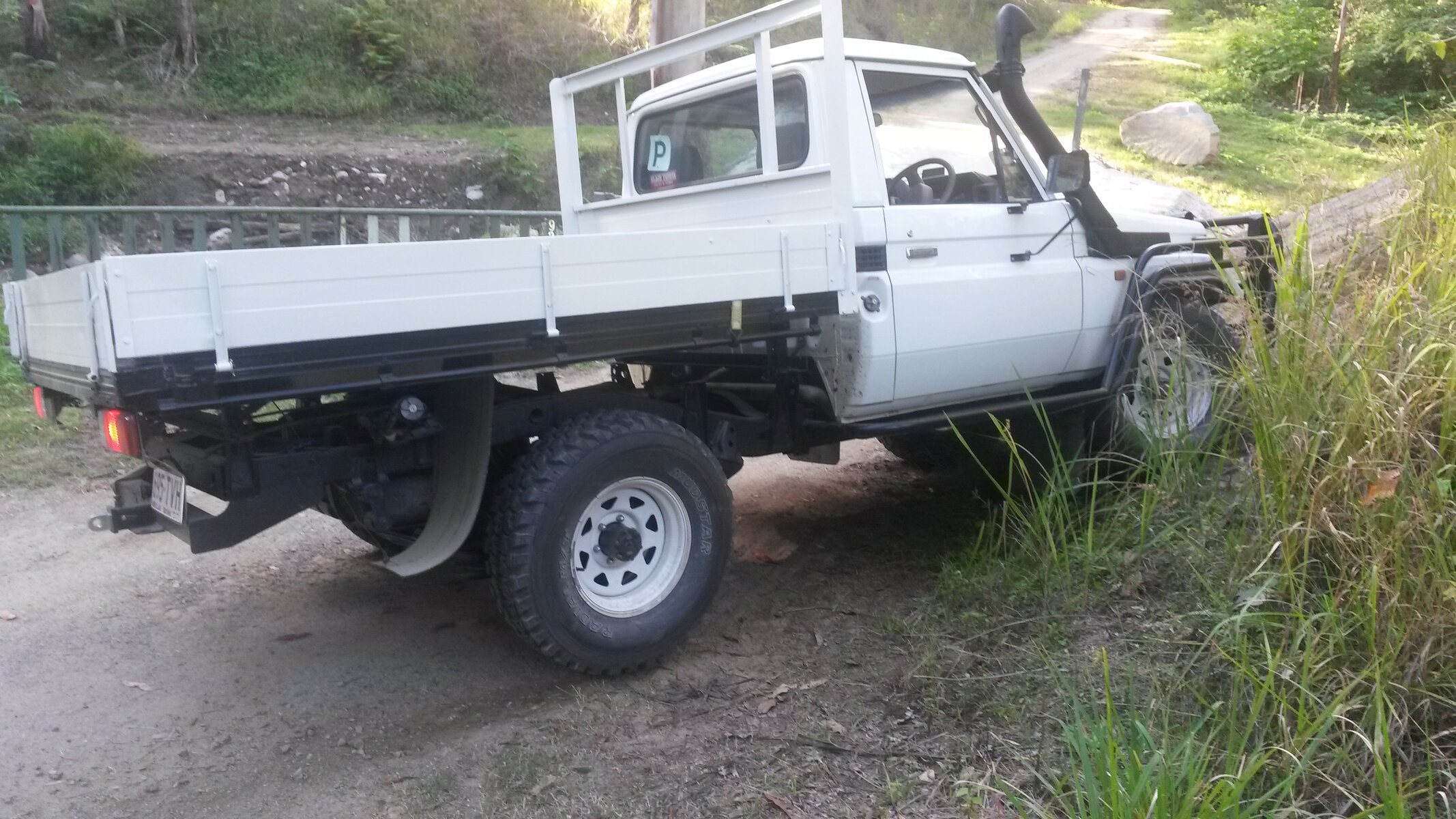

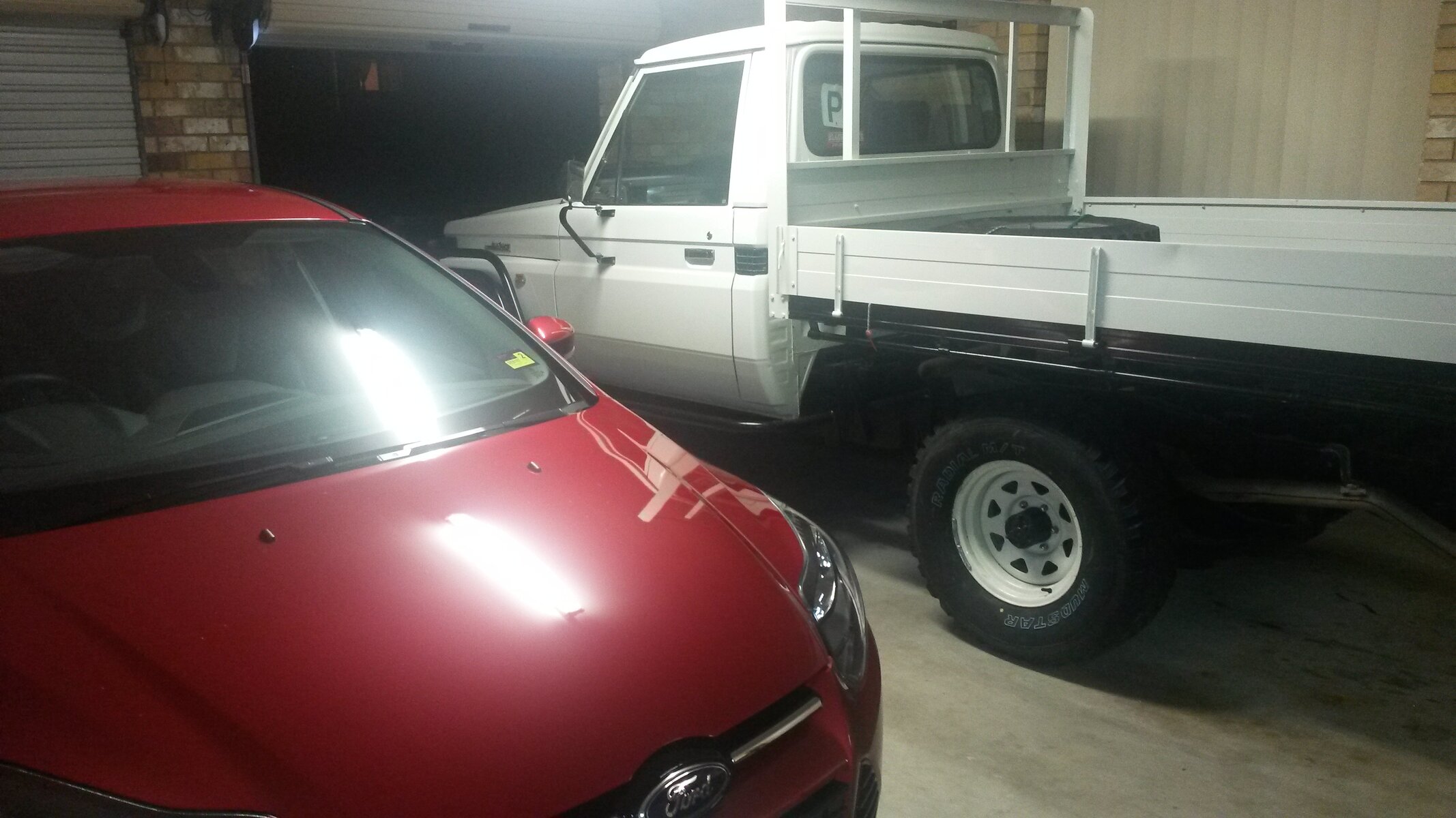

Actually just figured out how to do the pics on mobile so I'll give that a try. The last one should be what it was like when I got it about 3 weeks ago.
20140607_145147.jpg20140607_145204.jpg20140605_201509.jpg2014-06-14 20.30.30.png
Very quickly, you can't have the tyres beyond the flares and under the ADR rules you can not increase the width of the track by more than 50mm on a 4x4 without engineering it.
Now one of those is very quick and easy for the Police to spot and do you for (the tyres sticking out beyond the flares) either defect or fine or both, and they will do it especially as you seem to be on your persecution plates!
I suspect you might be on -22 offset, if you can pop a wheel off and put a straight edge such as bit of steel across the tyre, and measure in mm to the rear of the mounting face from both sides. Add the 2 numbers together, divide it by 2 and then submit the measurement for the outside from that: ((Inside of tyre to mounting face + Outside of tyre to mounting face)/2)-Outside of tyre to mounting face will give you the offset.
Lastly the other problem with increasing the offset too much will place extra load on the hubs and axles, and shorten the life a little bit on some of the suspension components, as well as rubbing at full travel. Ben will be able to probably tell you more on those challenges!
Good luck, and welcome! Ed

Yes I was going to add some plastic flares if the tyres exceed the flares a bit. I wasn't meaning a lot past the flares. Also you were saying I can make the track wider than 50mm. Is this from stock rim offset? If so what does this mean as in maximum offset with respect to staying under the 50mm you were talking about.

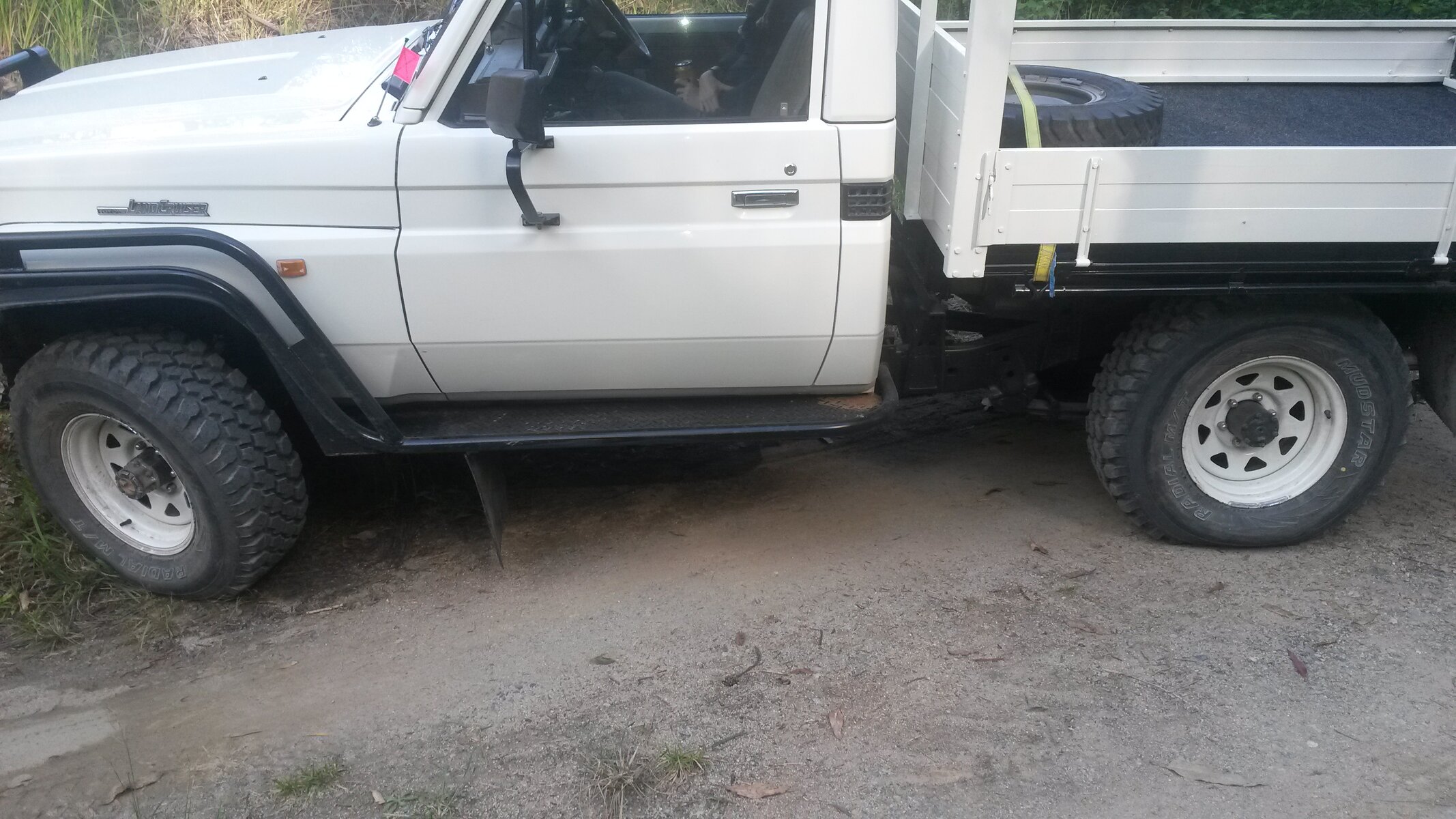

Also thanks for the tips on measuring the rims. Will do that tomorrow and post the results. Which parts will scrub that you were talking about, as at the moment they scrub on the flat steel part of the side steps but that's on the inside on full lock. A hammer will fix that tomorrow. And shortening the life a 'little bit' doesn't sound to bad for me :)

Ok I will try have a look tomorrow after I give the car a wash. Hopefully it's that easy to find the offset. I feel like it could use around another 20 mm offset as they sit in a bit.

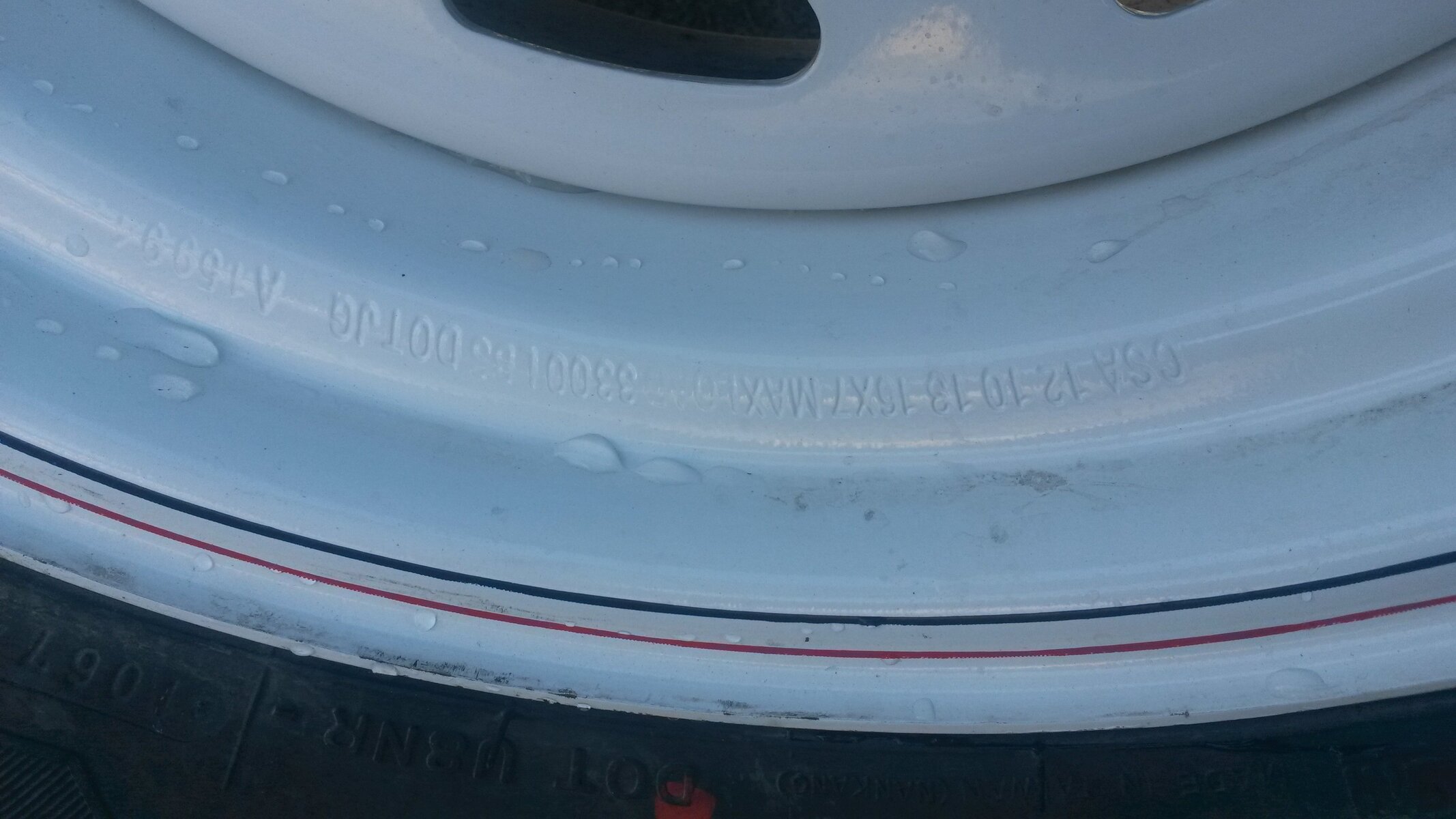

Hey guys, Been a bit busy with Uni exams, but today I finally got to clean the cruiser. I had a look at the rims and there was some writing however I don't understand what it means. Also a correction to my earlier posts my rim is actually a 16x7. I'm posting a picture I took of the writing. If anyone is able to tell me the offset from that. Thanks20140616_145259.jpg

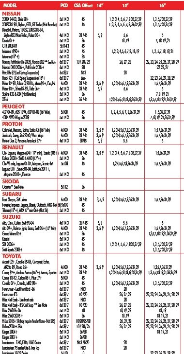

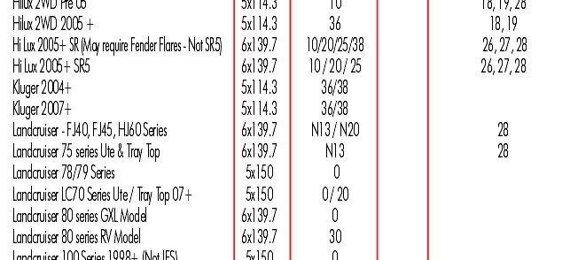

I just typed in the CSA 12 10 13 code into google and found a CSA brochure which showed the offset they have for a 75 series ute is N13. Would this mean my offset is -13?
Nice work. :thumbup:
Yes I'd say there -13.

I note from the chart above that the 80 series is "0" offset. My after market steels are also "0" offset, but 10" wide running 305mm tyres (12" give or take).
I don't know the width of the standard steels that were on the truck originally, but if they were 7", then I gained 1.5" of "protrusion". It was enough to make me have to fit the plastic over-fenders (or wheel arches).
On the car now are new 285/75r16 mud tyres. So that's like an 11" wide tyre I think. Would they fit properly on a 10" rim or would I have to go with an 8" rim? Also where would be the best place to get new black steel rims. As a lot of online stores just show the product and not the price so I have no clue what the cost of them should/would be. For reference I live on the south side of brisbane if anyone knows of a good cheap place to buy them from down here.
