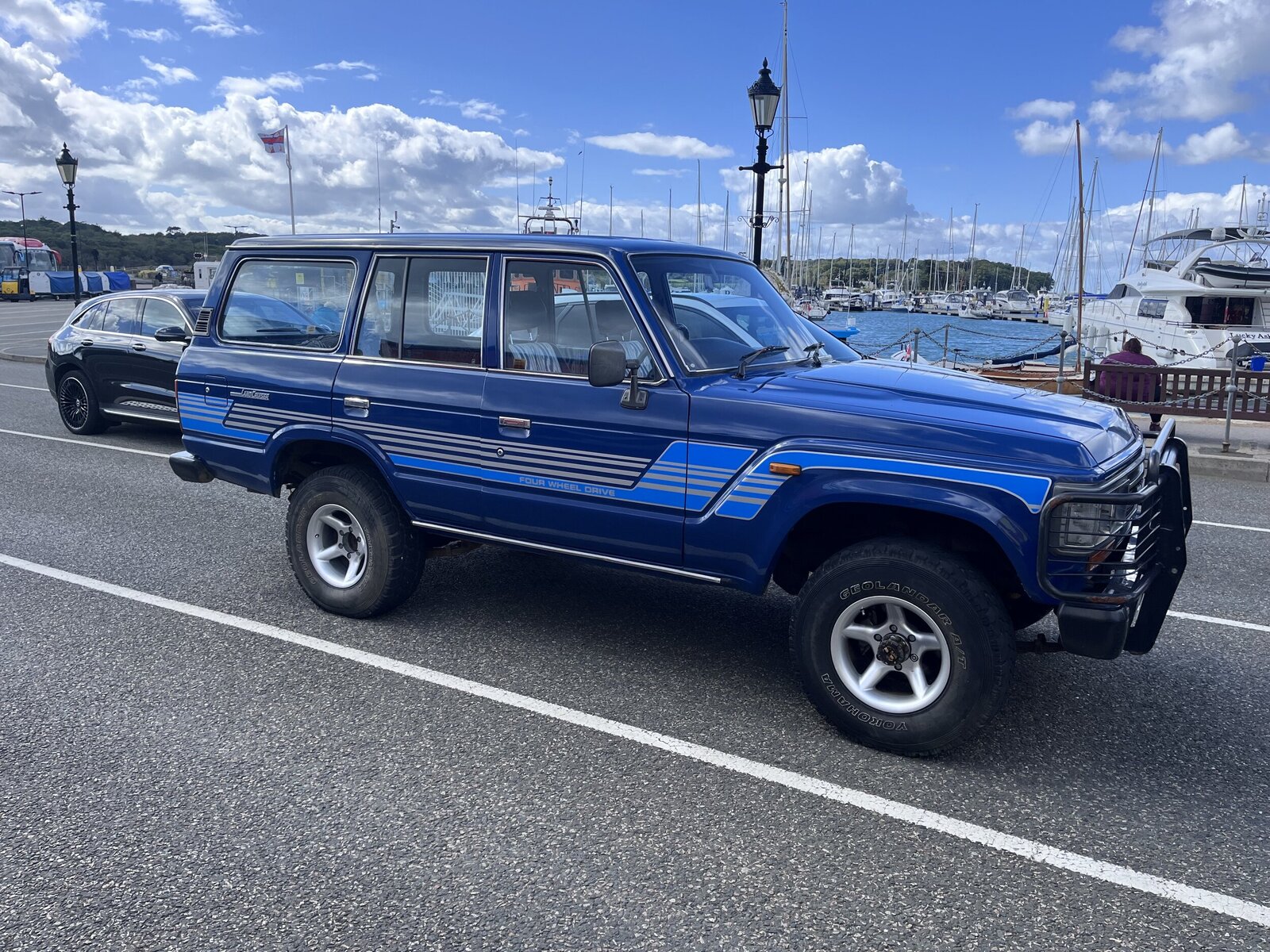

Hello everyone, I’ve recently purchased a 1988 H4 60 series and couldn’t be happier! I’m based in South Somerset and can’t wait to hit the beaches with it next summer.
There are however a couple of issues to keep me busy over the winter, the first and foremost being an oil leak from the front near side hub…
It appears to be the inner axle seal which I’ve heard is a pretty common problem with older trucks as the shaft becomes worn. I’ve seen a couple of aftermarket seals out there which claim solve this problem. Has anyone had experience with this? I’m looking at the Marlin Crawler seal in particular.
