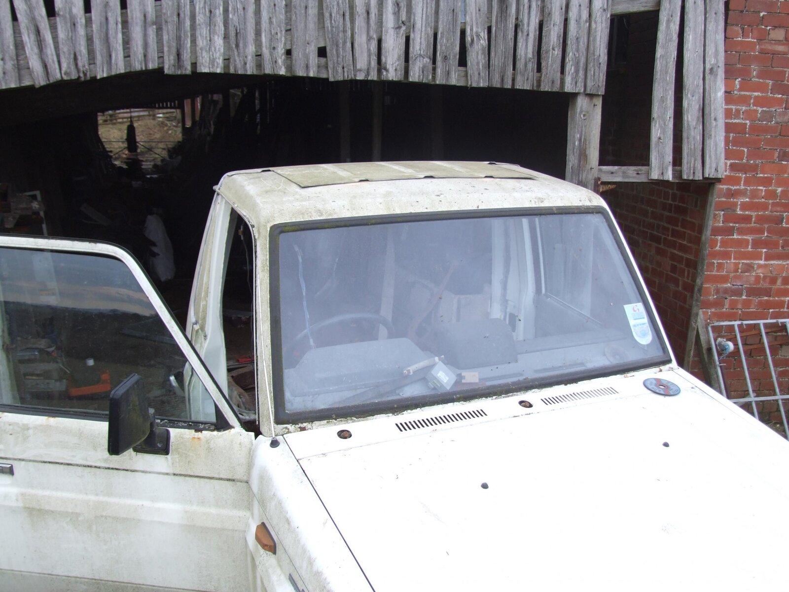

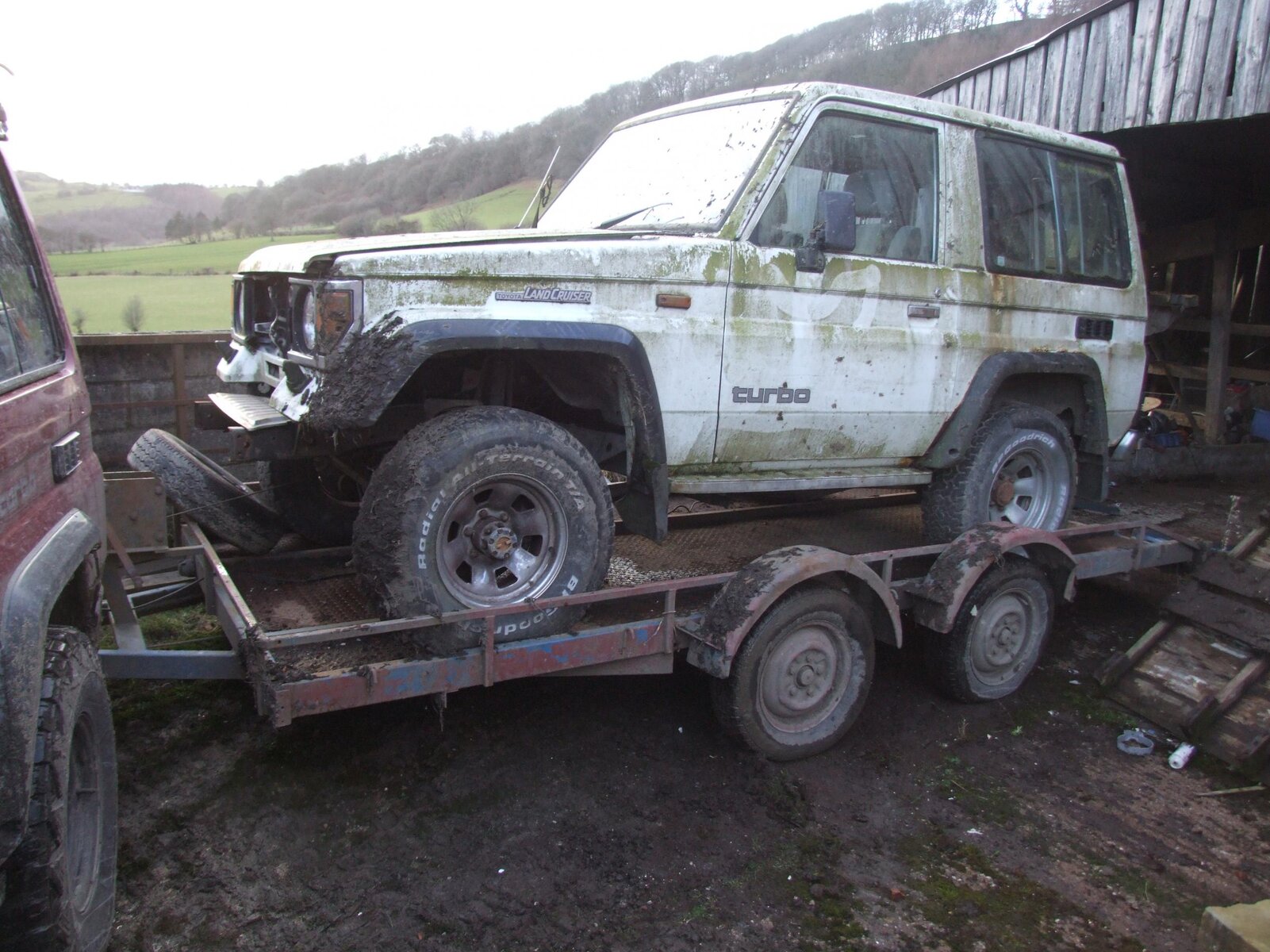

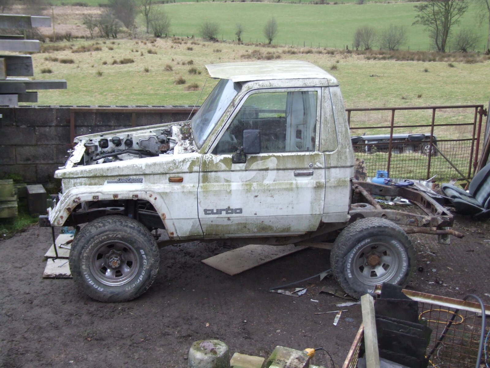

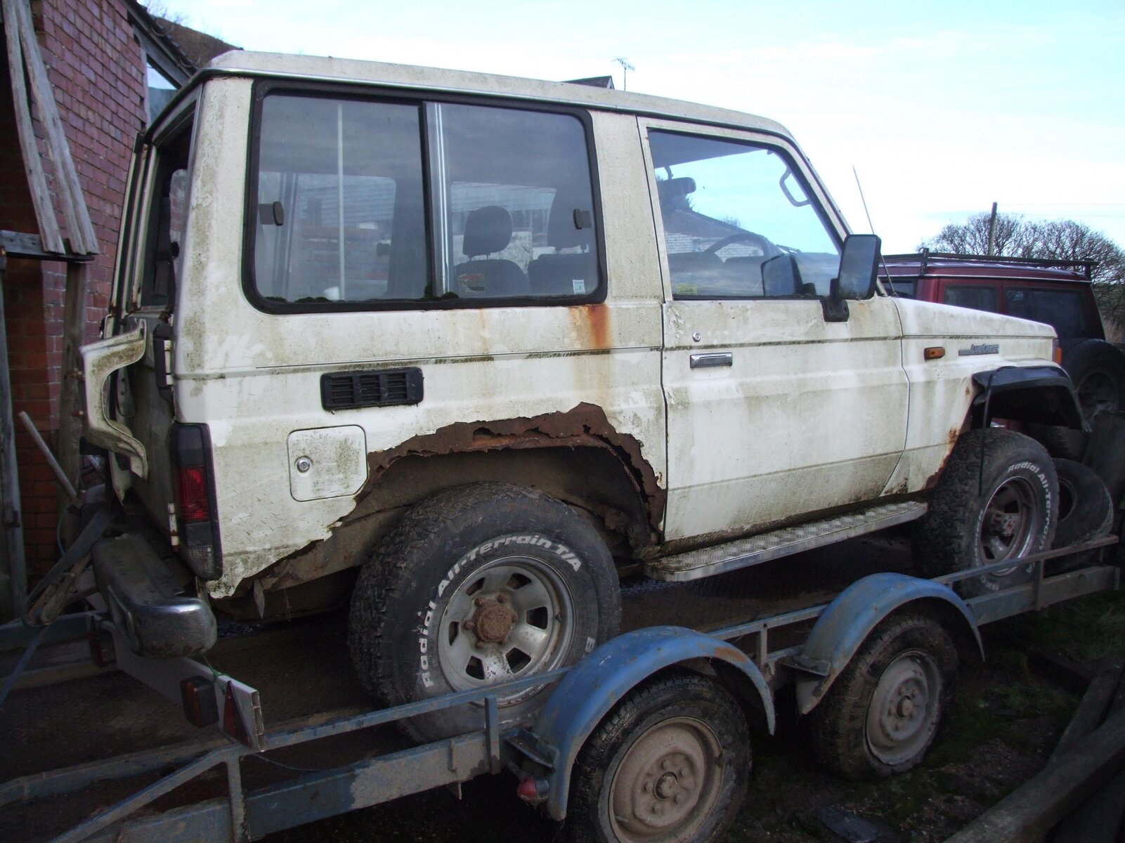

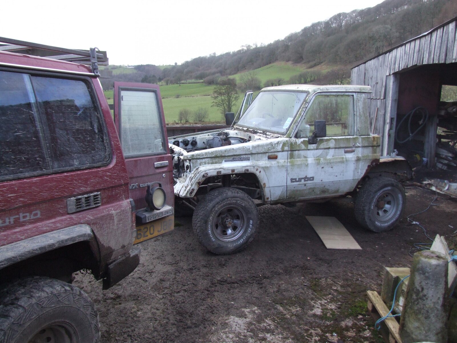

I recently bought this 88/89 lj70 off my mate for £60, reasonably complete minus engine and box. Perfect platform to build something good....:icon-biggrin:
Way too good to scrap! Knowing how capable these are off road.
Basic 1st view of the truck.
Only have limited time to work on this project- friday afternoons and saturdays every other week.

88 lj70 2 002.jpg"Rust like f**k them jap jobs dun they" lol!:icon-biggrin:

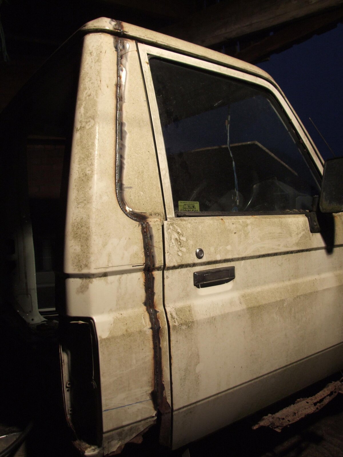

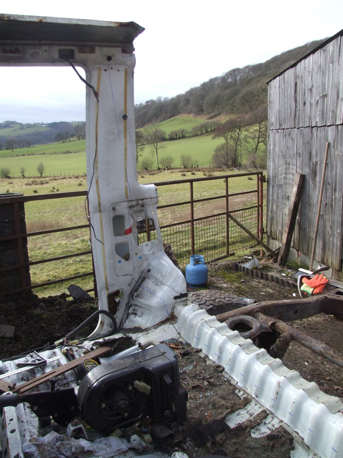

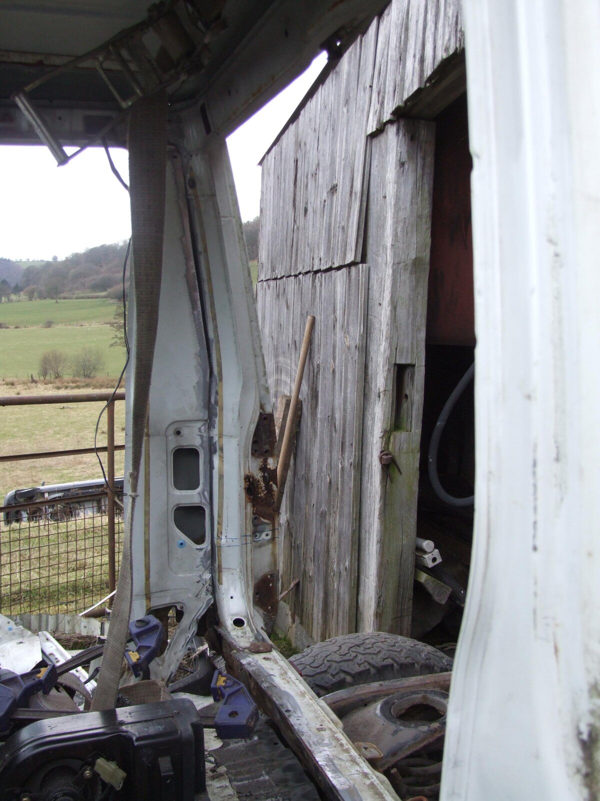

88 lj70 2 011.jpgKept the main part of the roof with the back panel to delete the rusty sun roof
88 lj70 2 013.jpgAmazing what a good wash can do! Not too rusty now, but still a lot to think about.:think: I think at this stage there was still a 30mm scribe left. But a feel for the new look is forming.

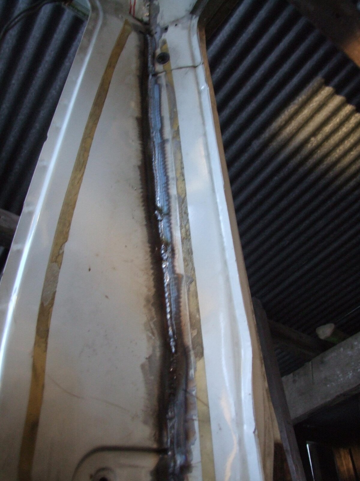

88 lj70 welding 1 011.jpgSweet welds , kind a no need to grind them down on the inside.

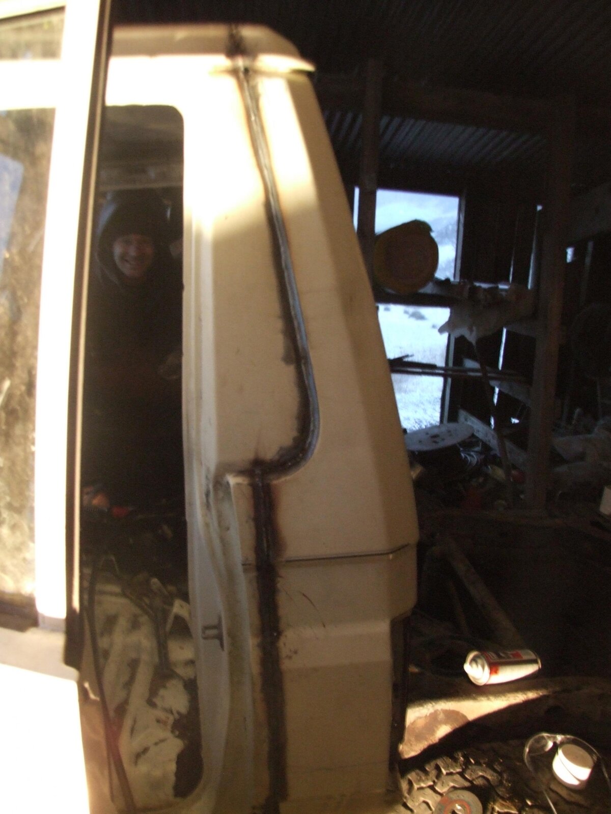

88 lj70 welding 1 012.jpgIts really taken on the feel of a pickup cab,
88 lj70 welding 1 018.jpgAll in all quite a good mission so far. Have a bit of working out with the section of wheel arch and filling in of the rear lights etc. Kinda work it out as it happens, no worries:icon-ugeek:

Just thought I'd add the starting pics again as the 1st attempt failed!
Quite mad looking back the change it has taken with not a massive amount of effort so far!

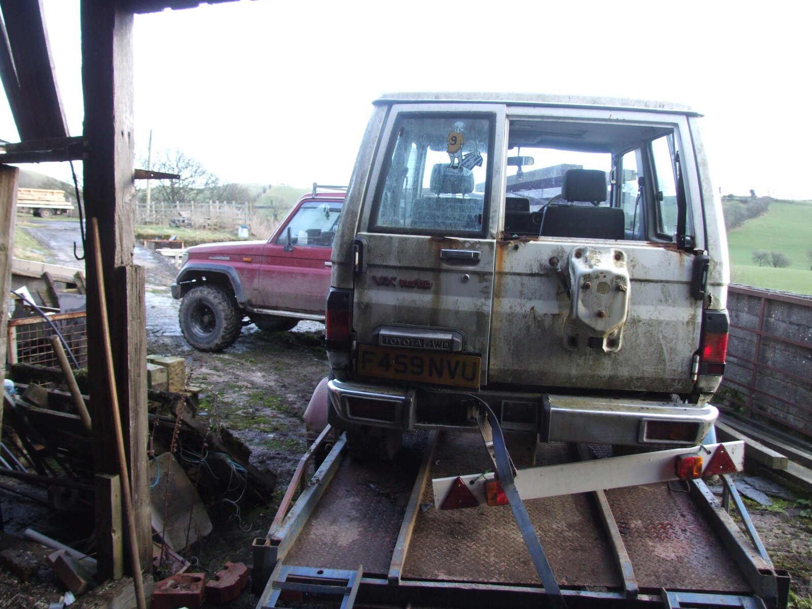

Dug it out of the back of the shed!

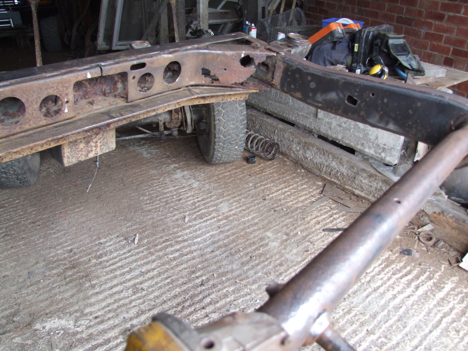

88 lj70 1 001.JPGHave had the urge to do something with this classic shaped Lj70. A plan has been hatched!:icon-biggrin:

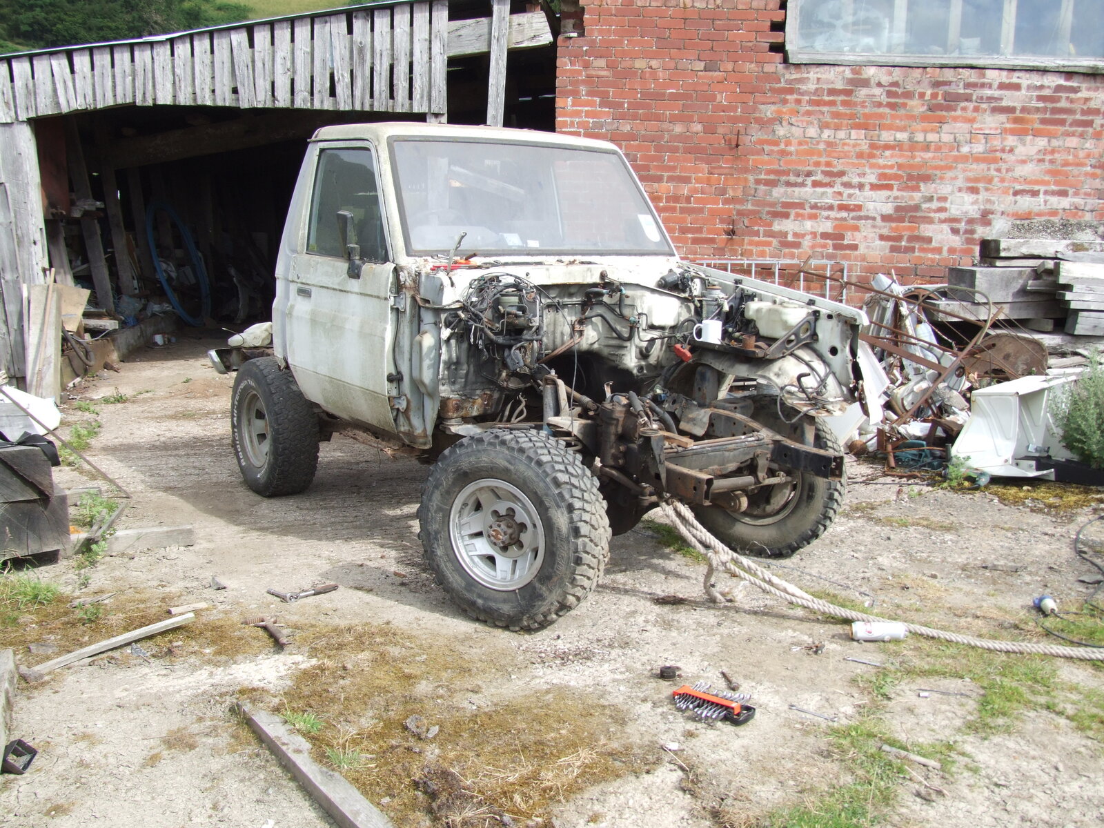

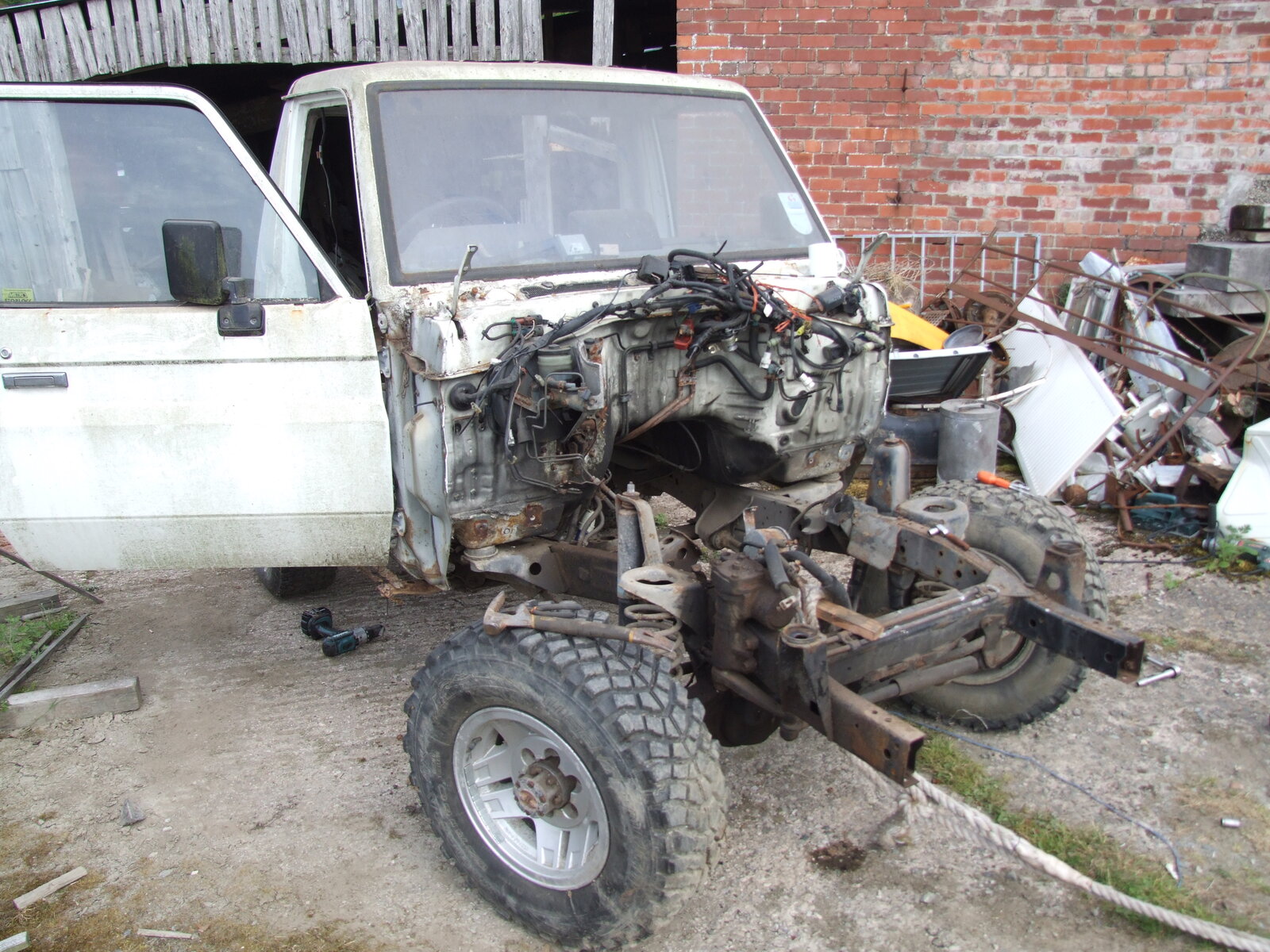

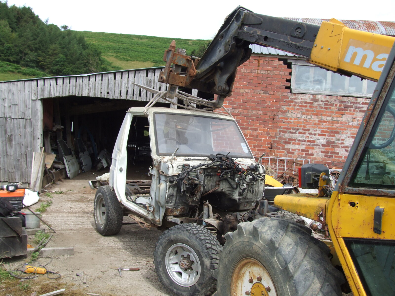

So last night decided to get it out in the open. Started by removing the front panel and Lh/s inner/outer wing..
Ready for lift off!

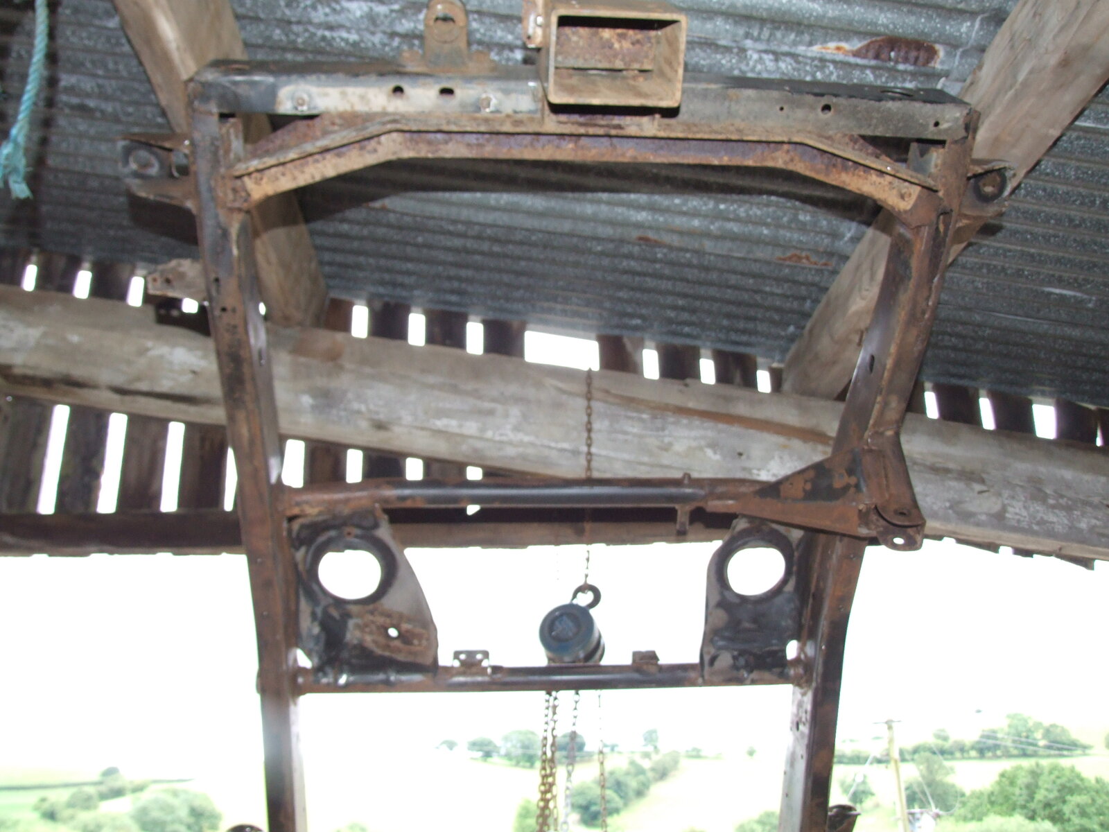

Nice to see it is actually very solid below
My mate "Buddy" is a handy chap to have around!
So got stuck into it with the grinder and wire wheel. Quite satisfying to see it getting cleaned up. There's no sign that this truck has been off road.
A bit of welding on the rear corners, not too much of an issue..

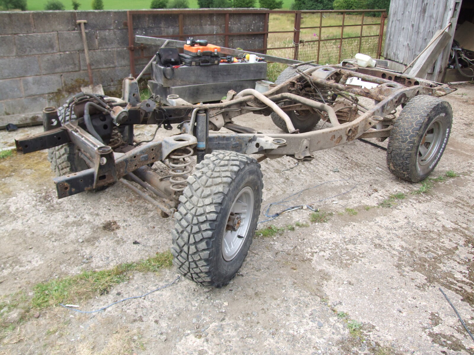

Nice building from the chassis up!

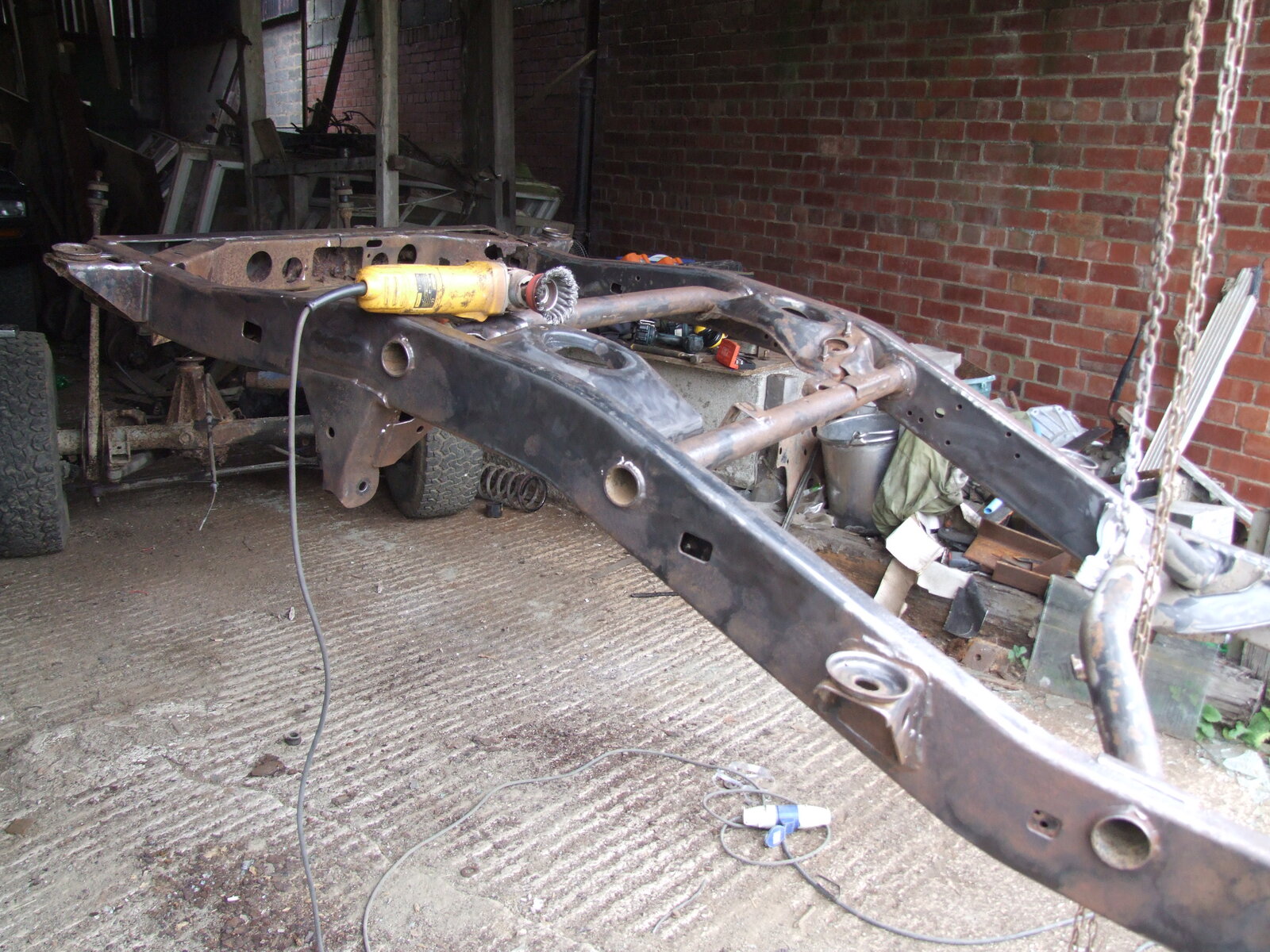

Really happy that the tube work in is fine shape.. A bit more welding needed to the underside of the chassis rails right at the back..

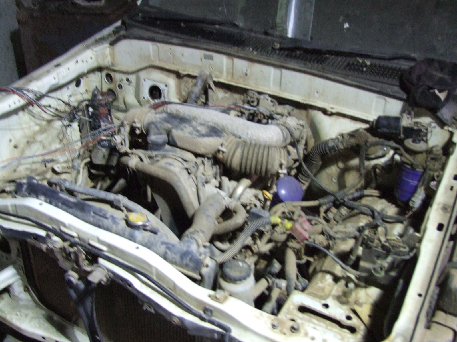

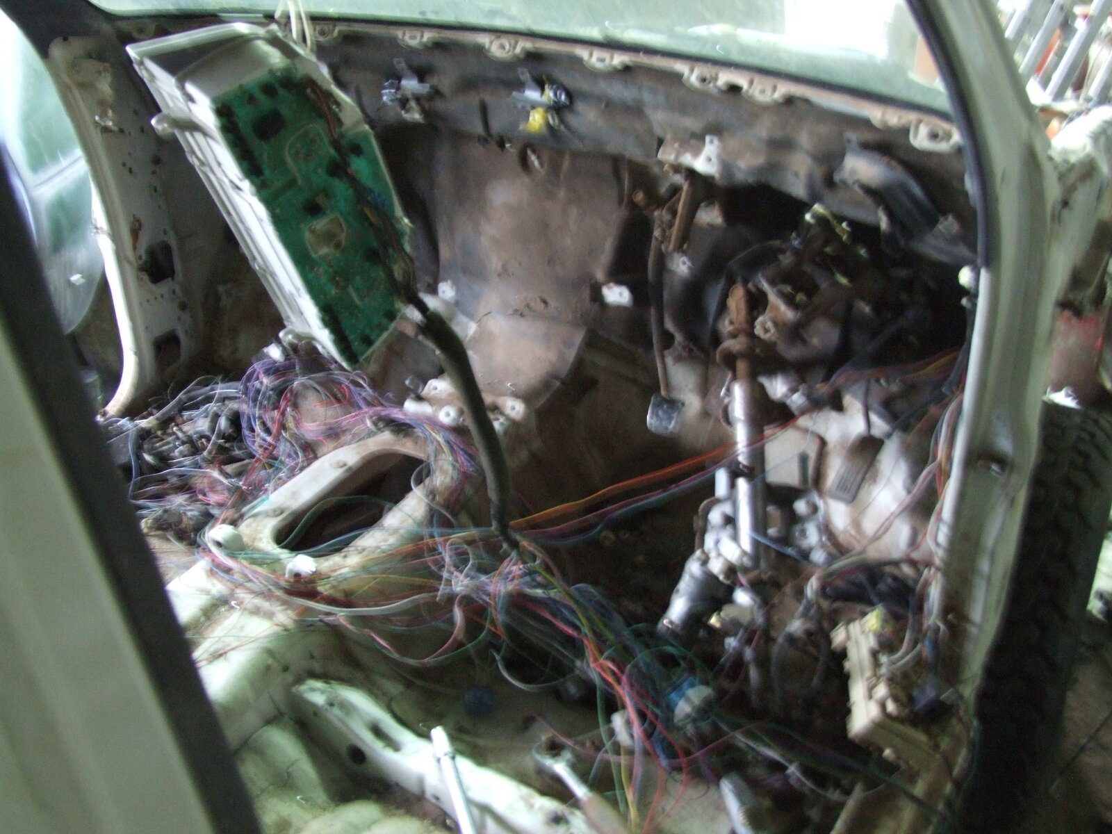

Power plant, 2kd ftv engine conversion
Last September I had the chance to buy this 2004 D4D hilux mk5 with the 2kd ftv engine in it. I had a hard impact to the rear passenger side.

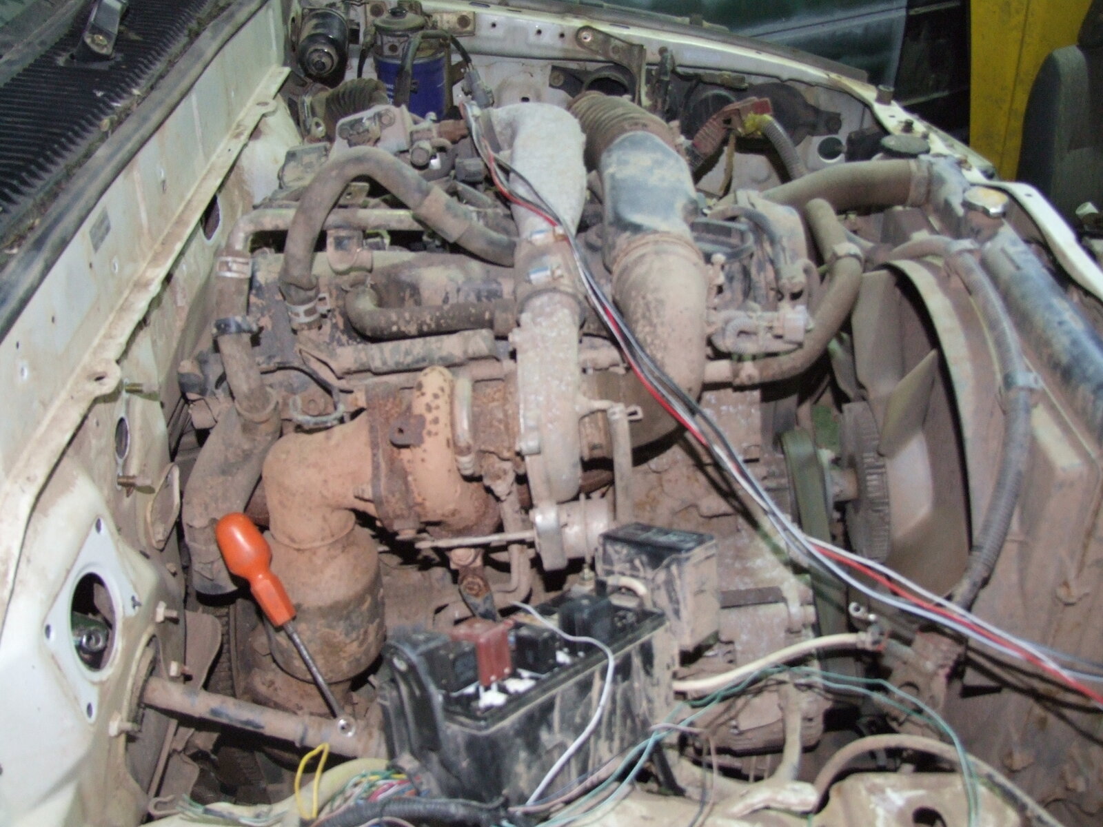

The motor has done 54,000 miles and runs as sweet as a nut.
I am attempting to fit all thats in this engine bay into the LJ70!

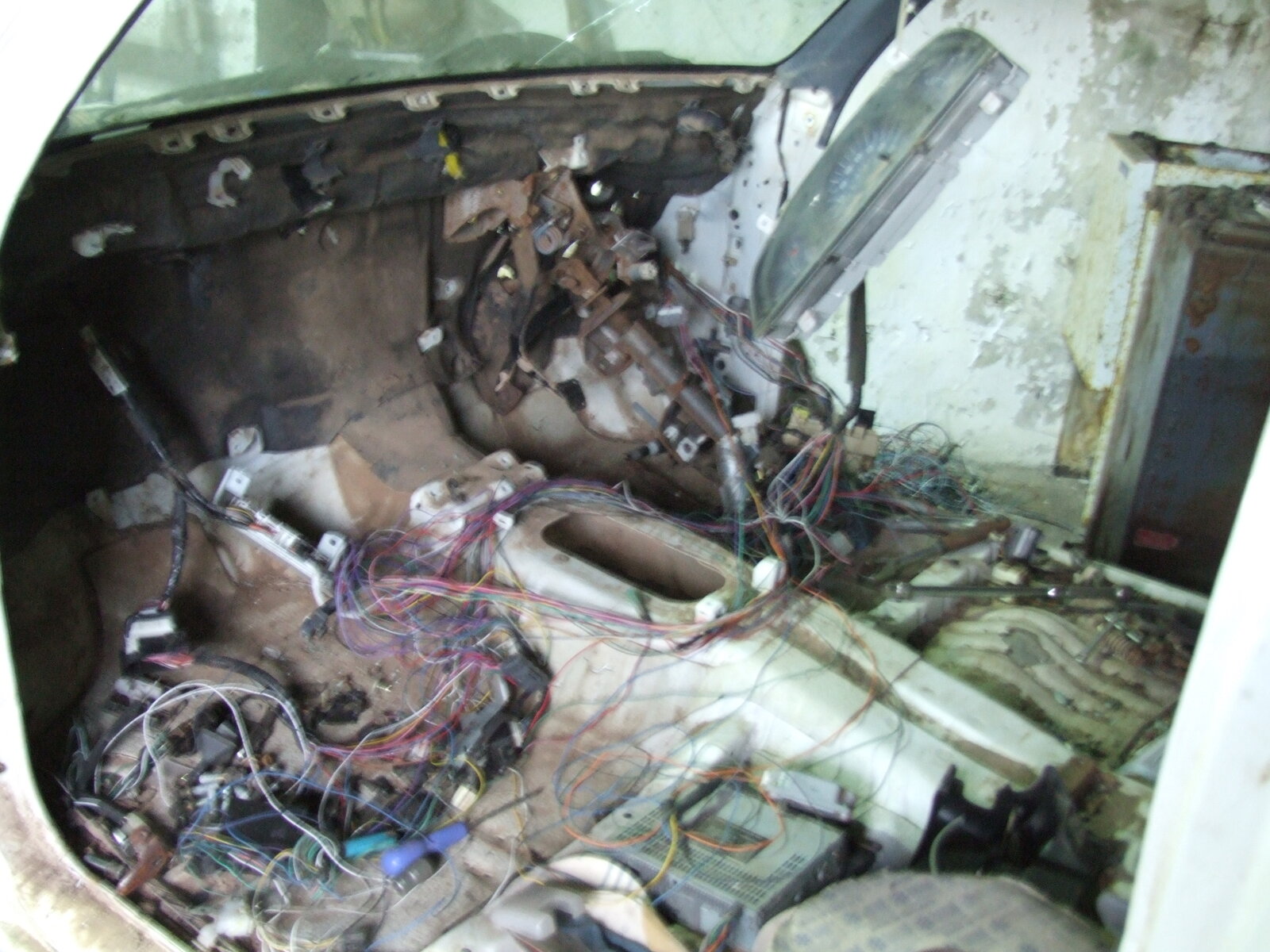

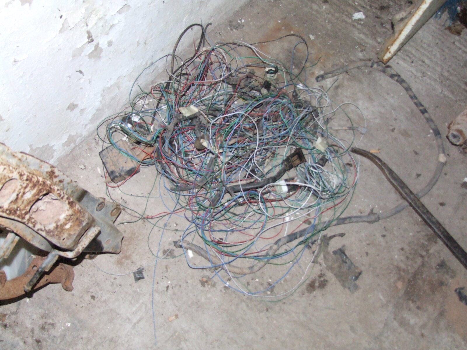

I have been working on removing un needed wiring and can say it has reduced to quite a percentage less!
The engine still starts up from the key!
Luckily my good friend Ed is an ECU engineer... so there are a couple of options.
Firstly to disable the immobiliser from the ECU.
Can either make a vehicle loom from whats left from the hilux in cab loom.
Or
To modify and re wire into the 2LT/E in cab loom.
It's quite fortunate to have sourced the Japanese LJ70 import shell...
All in all I think its worth a go to get this working, if not possible then can sell the engine and buy a 1KZT and fit it in the way I had done previously to my 1st cruiser back in 2009.
Has anyone here done a rewire like this? Any input would be welcome:thumbup:

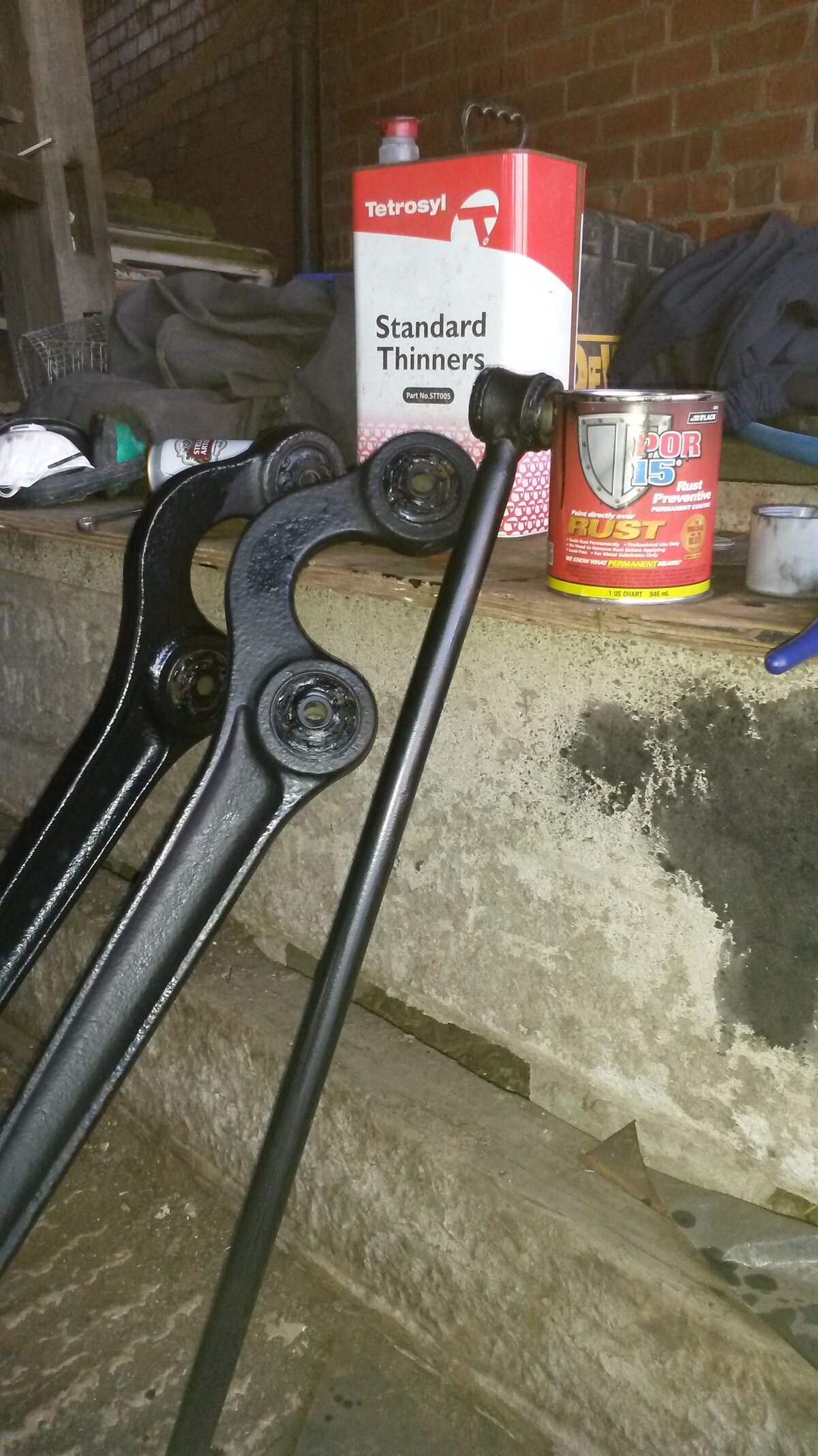

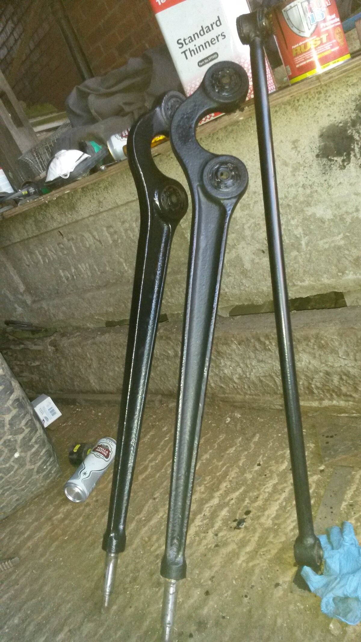

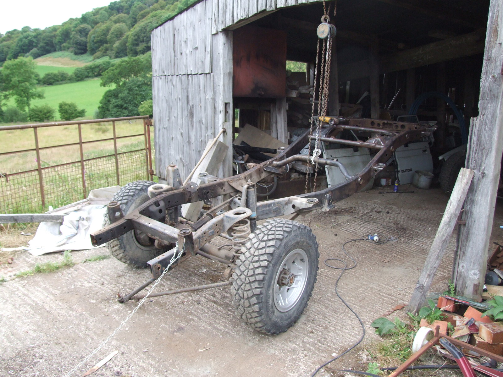

I wire brushed the trailing arm's and painted them up with the POR 15 rust prevention black paint...
So what is the best route for me to take with the worn bushes on these arms??? Where can I get replacments from? Not to keen on the thought of poly bushes. But are less reliant for articulation as the earlier lj70's have pin and nut connection, different to the later square light set up.

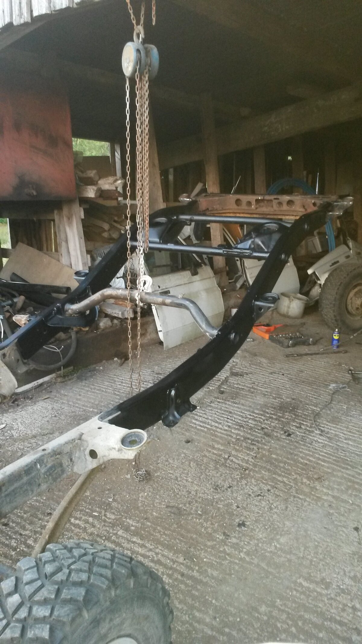

Put a healthy coat of the chassis paint on the frame.. pleased with the result. . Be even more pleased when it's all coated!
Thinking suspension also... rear first. Popped by Gwyn Lewis 4x4 last night. Handy guy.. we saw that LR defender springs are the same size dia as the rear of the 70. So may use the lower mounts off a LR to fit them. He gave me some scrap parts out of the skip to investigate!
