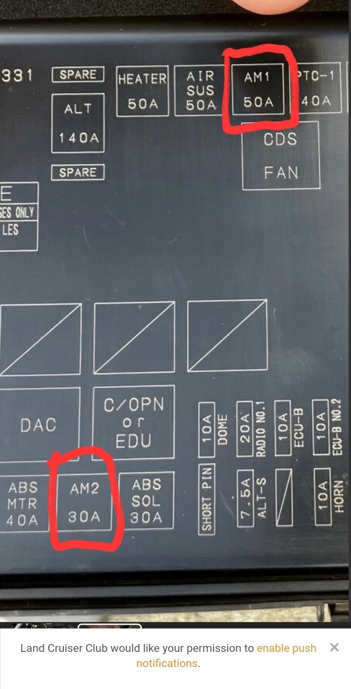

Looks like AM1 (fuse 56) and AM2 (position 62) - located in the engine bay fuse box would be the first ones to check.

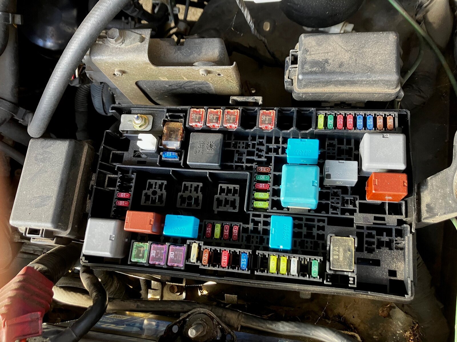

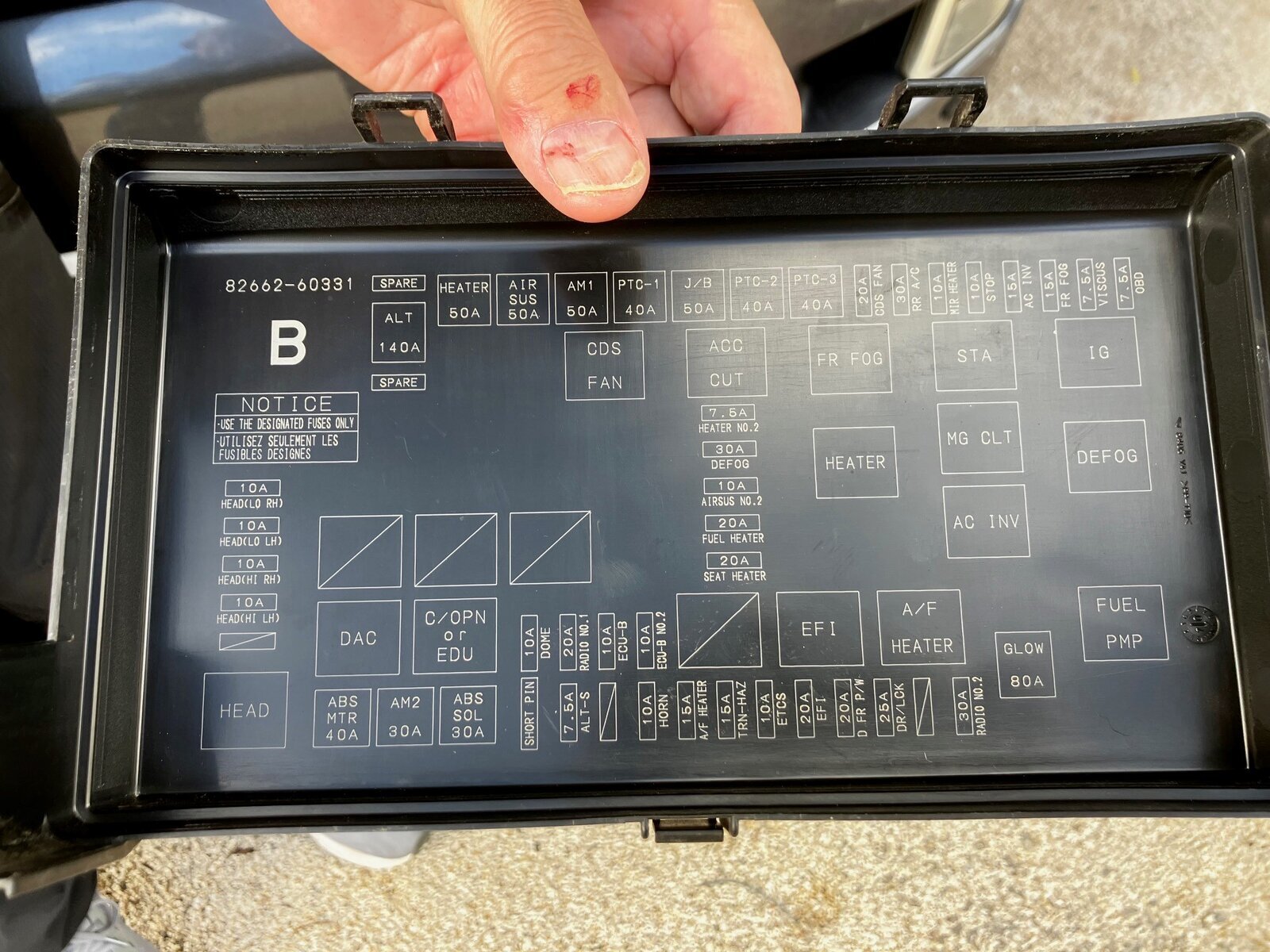

Couldn't find the fuses mentioned, these are photos of the fuse box
The lights work but not the front or rear wipers

Hmmm...

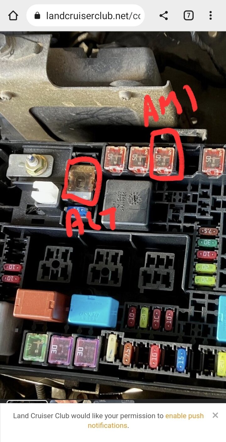

I've circled am1 and am2. Could be any of them that's blown though - can you get a multimeter and give them all a quick check?
I think there might be a starter relay too, it's too dark for me to check now but I think it's in a separate relay box next to the fuse box.
But check all the fuses first if you can, including those in the drivers side fuse box

Hmm, wipers! Front and rear are on different fuses, but from what I can see on the wiring diagram, they get their feed from the ignition switch.
Which gets its feed via ALT and AM1. ALT is a big 140A fuse - its on your diagram, looks like its yellow/orange'ish in the pic, top left.
Check AM1 first, because a load of other stuff goes through the ALT one, and you seem to have some things still working!
