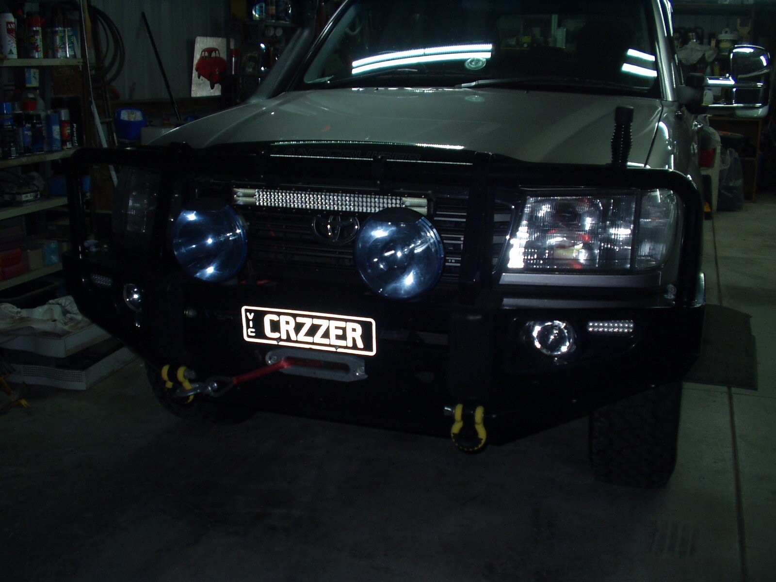

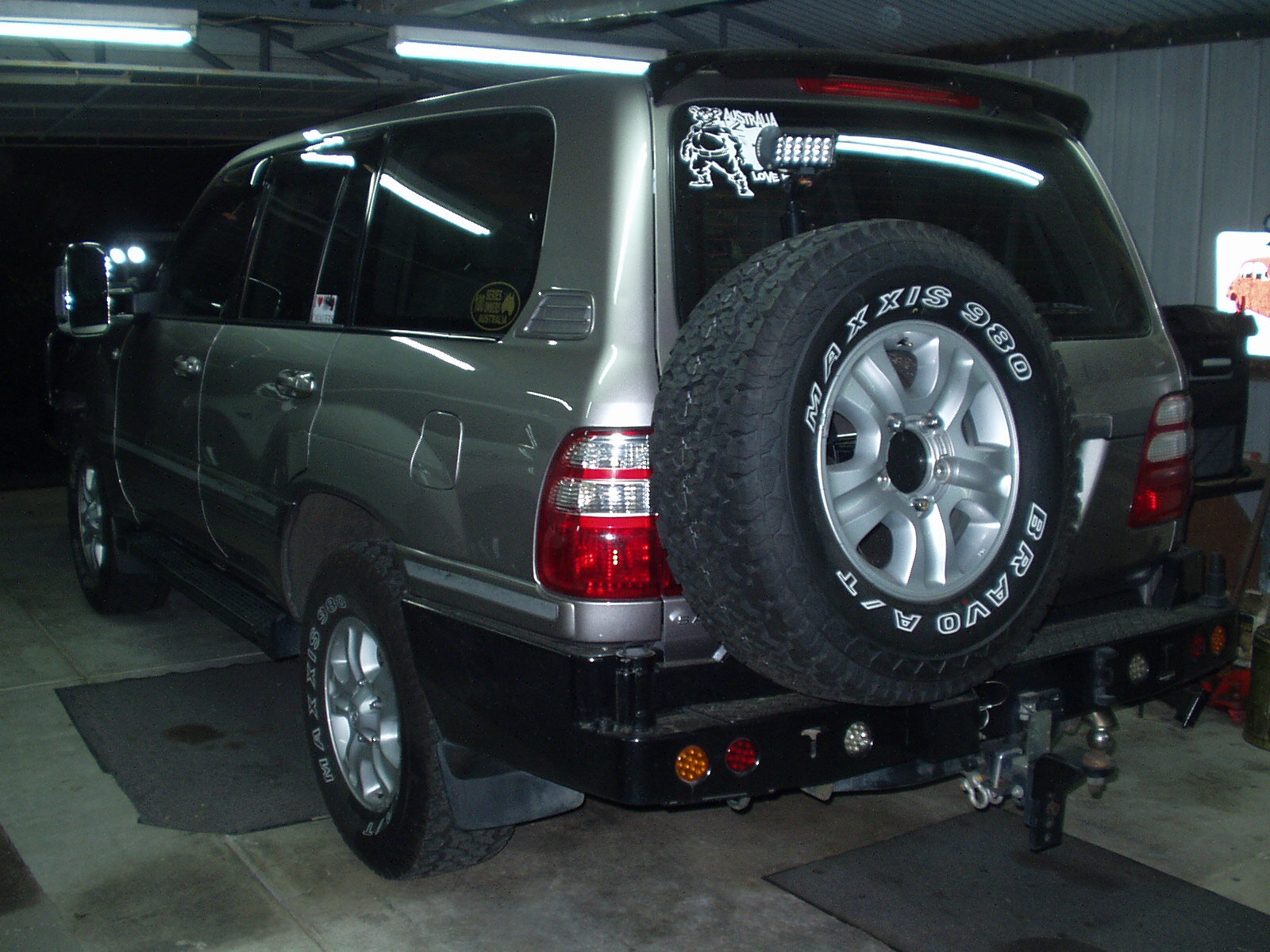

just went out to me shed took a couple of happy snaps its night time here and morning time over there

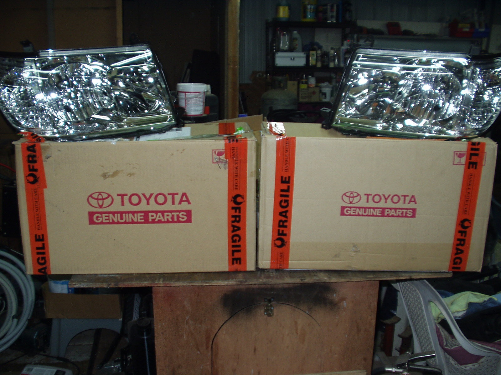

Hi Jibberjabber stage one will begin soon got my headlights to day hope fully tail lights in a couple of weeks then some more bits and pieces, Jabber apart from the switch and motors that go on the headlights for leveling of the lights is there a relay control box some where as well thankyou Gazza

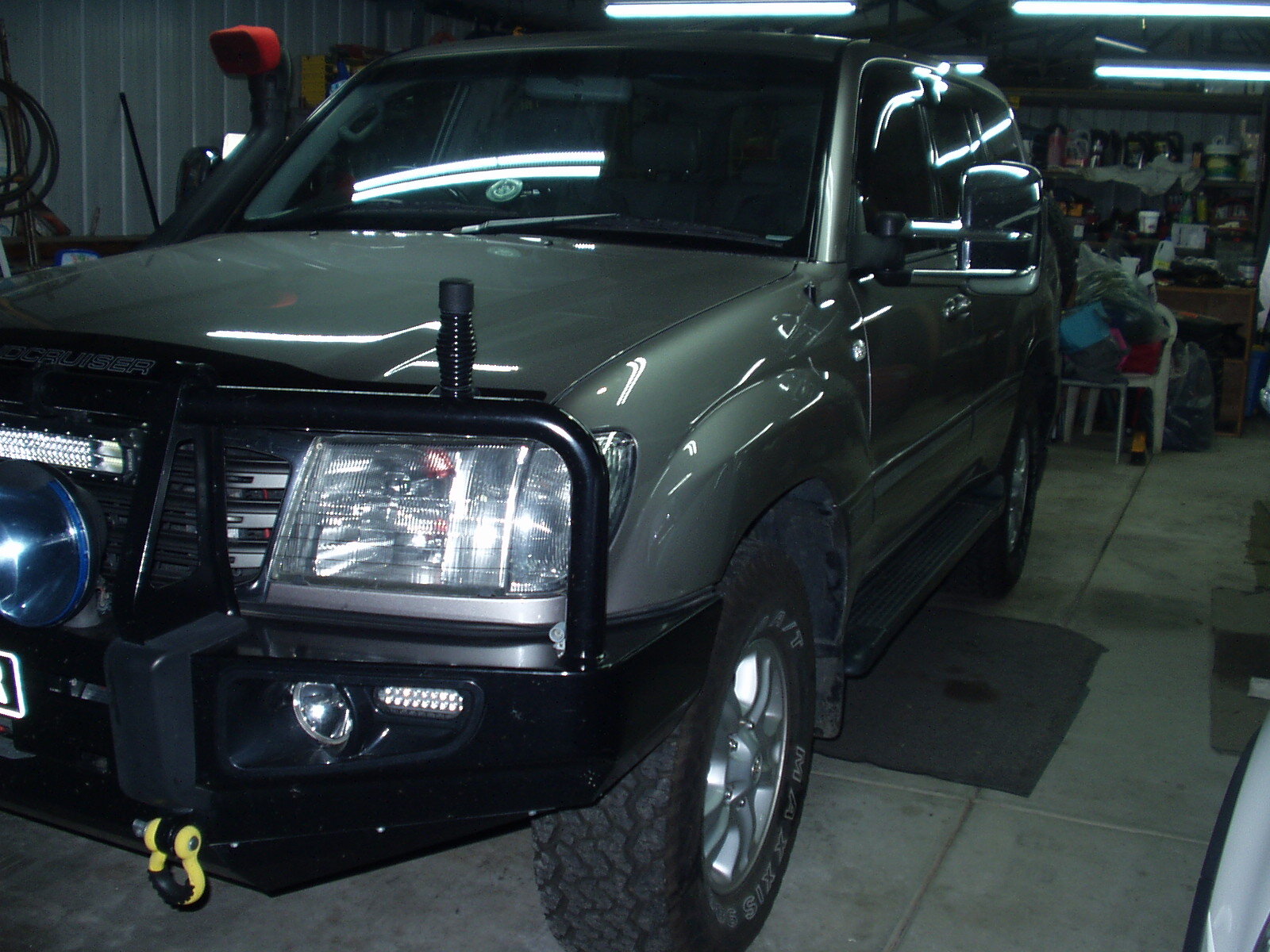

Hi Jibberjabber mate when you got the guards to make room for the blinker to fit was it the top or bottom of the opening around the blinker thx Gazza
