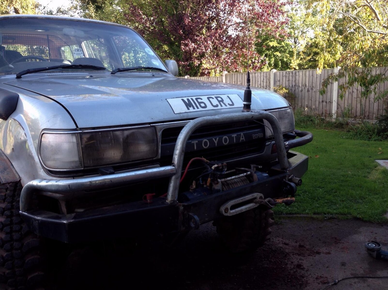

Well my point exactly mate. Push it back, you can't get a winch in. I still need to speak to Gary about that. Toob. Well to be honest, it's a little bit small I think. But it's all I have. Just under 50 mm. 48. whatever mm. This is my off roader so I ain't proud. Bish bash bosh really. Body lift really not helpful on this winch tray.

I spent some time today Sorry that should have read, I wasted a day trying to bend some toob. That Clarke bender is pretty poor for this application. I broke it, mended it, broke it again - actually that went on for some time. And in the end all I really did was mangle some decent tube. But hey, I got it into a lash up of what I'm after so I could at least have a look to see if it would work. Yes I know it looks rubbish from a distance, but really you should see it close up!! I just need to find someone locally who's a right proper bender. :wtf:
All done in black it would be quite promising I think. OK OK, I know it's not pretty, but it's £120 as opposed to £1000 for an ARB. I have to say one thing - it's bloomin strong now. With the top hoops and the bottom diagonals I can't see this one bending.

nice one. still what diameter tube did you use. i am thinking of slightly higher side bars then that. bit like the tjm
ones. although i cant get over how much needs to be done to make it fit. if you dont have fabrication tools its not a bolt on job.

Tube size? Same as I posted yesterday Stu. 50 mm. Come on keep up. Remember I have 40 MM body lift. If I went over the lights the hoops would be huge. Go lower and they block the winkies. I had to pick a line between the bottom of the main lights and top of the flashers. I didn't have a choice in other words.

I find it strange that its such a pig.Daves is on but we still haven't dropped a winch in. Ill get the Chasie rails measured up and get one order. I Dont dare buy a load like I was going to until we have a product that can simply bolt on.
Looks good Chris. Are you haven't it coated then now ?
I'll probably coat it Karl, but not til I have made some proper hoops. Honestly they are a real lash up and hideous. Looks alright in that pic, but trust me, it's shocking.

i really cant get where you put 40mm tube. must just scan over looked a couple of times.
come on chris show me where???
Like err, here?
I think that 60 would be better for the main hoop. But as I said, it's what was on the scrap heap.

I think that roll cage tube might be the best. It's designed to be bent and welded. I don't need much. It's not cheap but then it's easily available I guess.

i found on eblag somebody doing 50mm bends in seemless roll cage tube. they are £10 per bend and you would only need about 1m of tube so it will work out fairly good value. saves buying a long length and getting it bent.
i am thinking of 2x 50mm 75deg bends for the middle and then 2x 90 for the side hoops. not 100% yet on the middle one yet.
not sure if to make it taper into the top or not.
