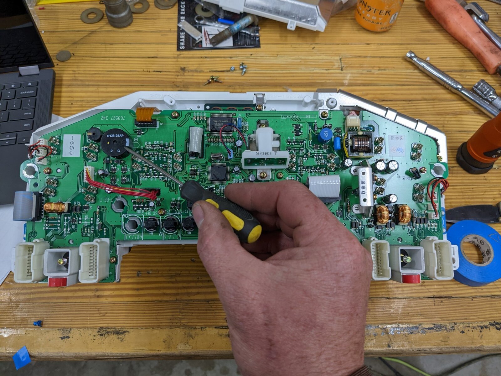

And maybe even the "key in ign. beep" has a switch in there as well - can't remember.
I can't remember what chimed in the mrs truck but its chimes no more since i found the mini speaker and cut a wire .

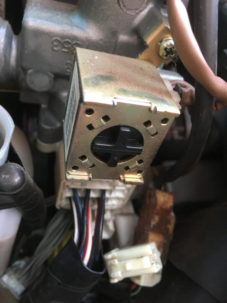

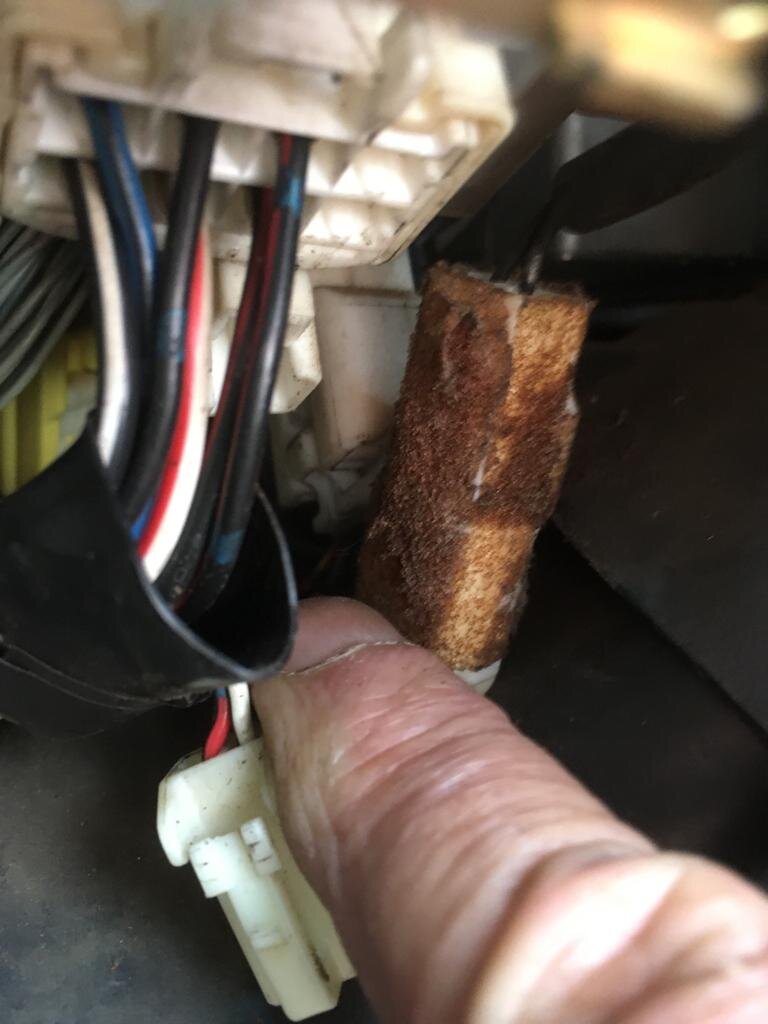

Unplugged this small white plug from the bottom of the ignition barrel and no more annoying chime. Lights on chime still works and best of all the "easy entry" steering up and down is also disabled but you can still adjust it with the joystick on the side of the column. Win win win I'll update if I find any down sides but so far so good.

Disconnecting the chime has eliminated the easy entry system so the steering wheel can still be moved with the joystick when needed. Although the gear on my forward/back motor has already worn out..
