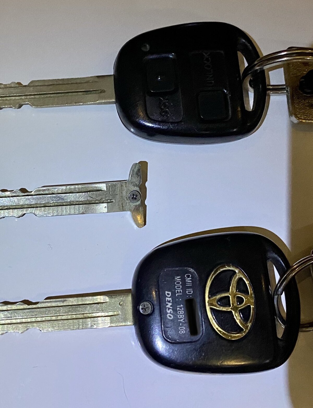

Well, I find myself needing a new key case again as my replacement knock-off case is starting to crack. There’s a surprise...
However, there was something I found out whilst fiddling with the thing that I thought I’d share with you. You can actually take the metal key out of the casing and put it, along with your working electronic insides, into the new case. This saves going to the locksmith to get the new key cut to match your old one. Who knew...?
Shouldn’t have been that difficult really, there is a clue in the form of a screw in the key case. You need to unscrew the case to open it to do the electronics swap, guess what, you can swap the key as well as the screw goes through the head of the key to allow removal too
