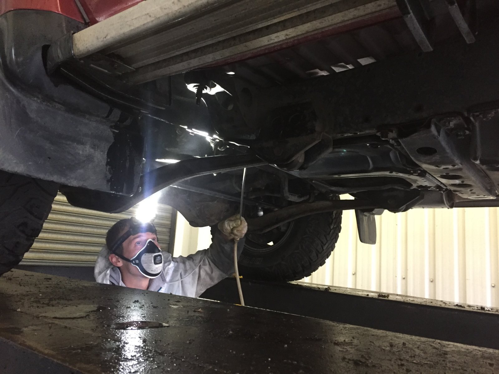

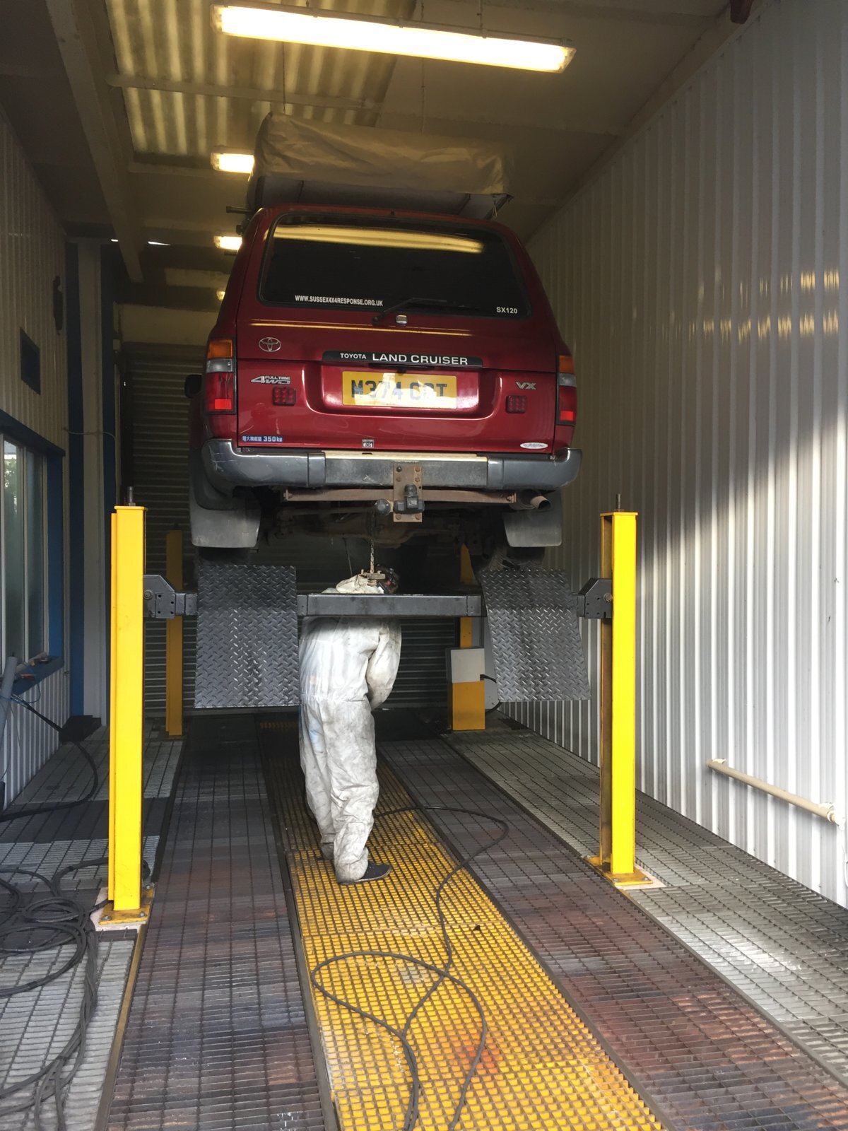

Firstly Rob cleaned off the underside of the truck with it up on the ramp.

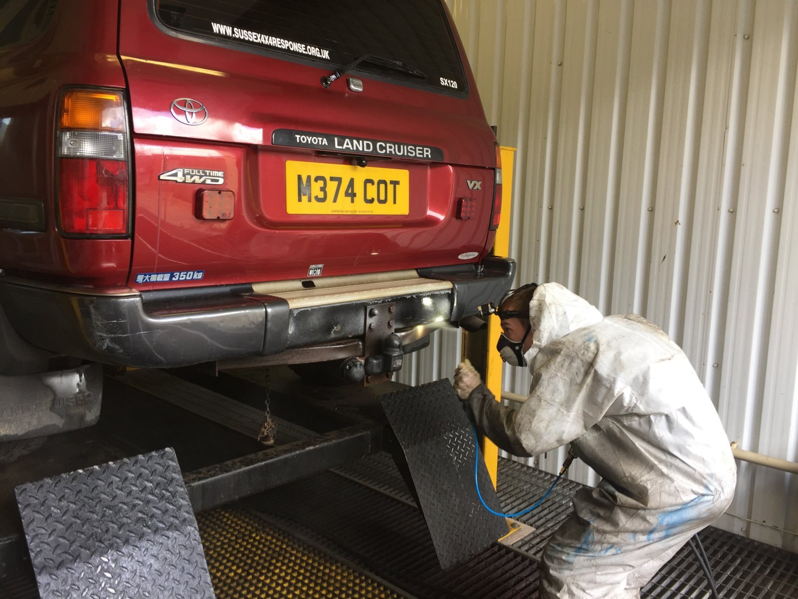

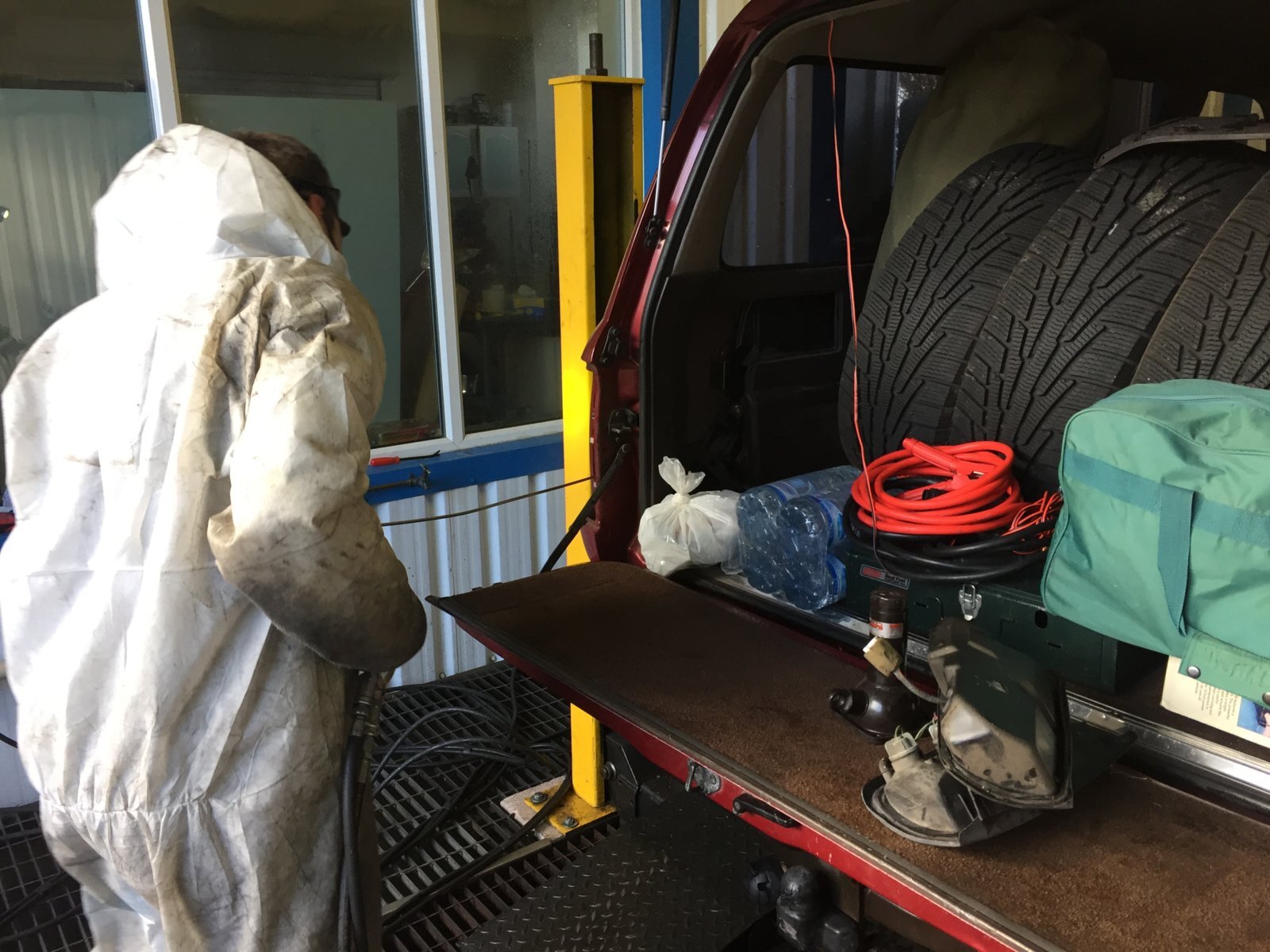

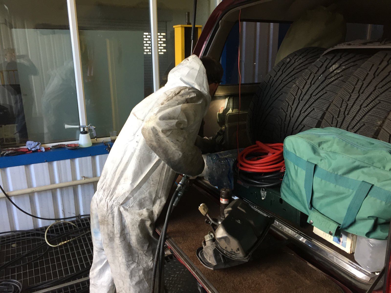

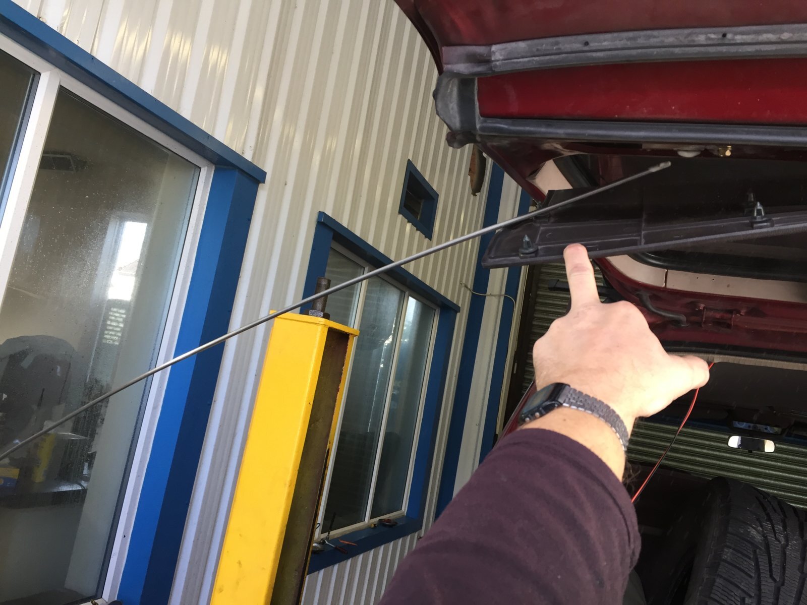

Next, he gained access to top and bottom tailgates, inside rear quarter panels by removing the lights, doors and inner wings and using a metre long ally lance/tube with a sideways nozzle on the end, he admitted a fog of the Krown rustproofer while turning the lance this way and that and slowly withdrawing it.

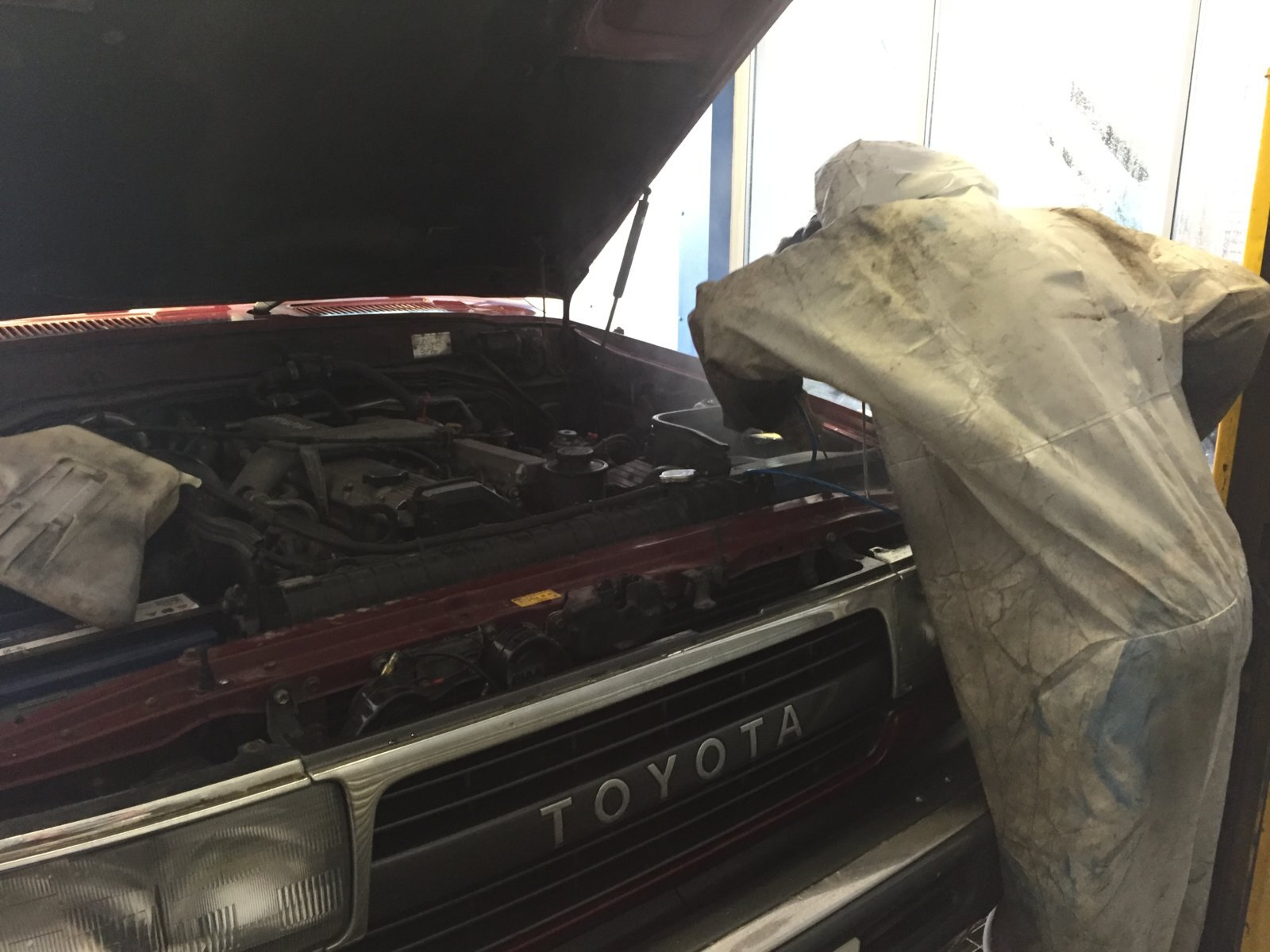

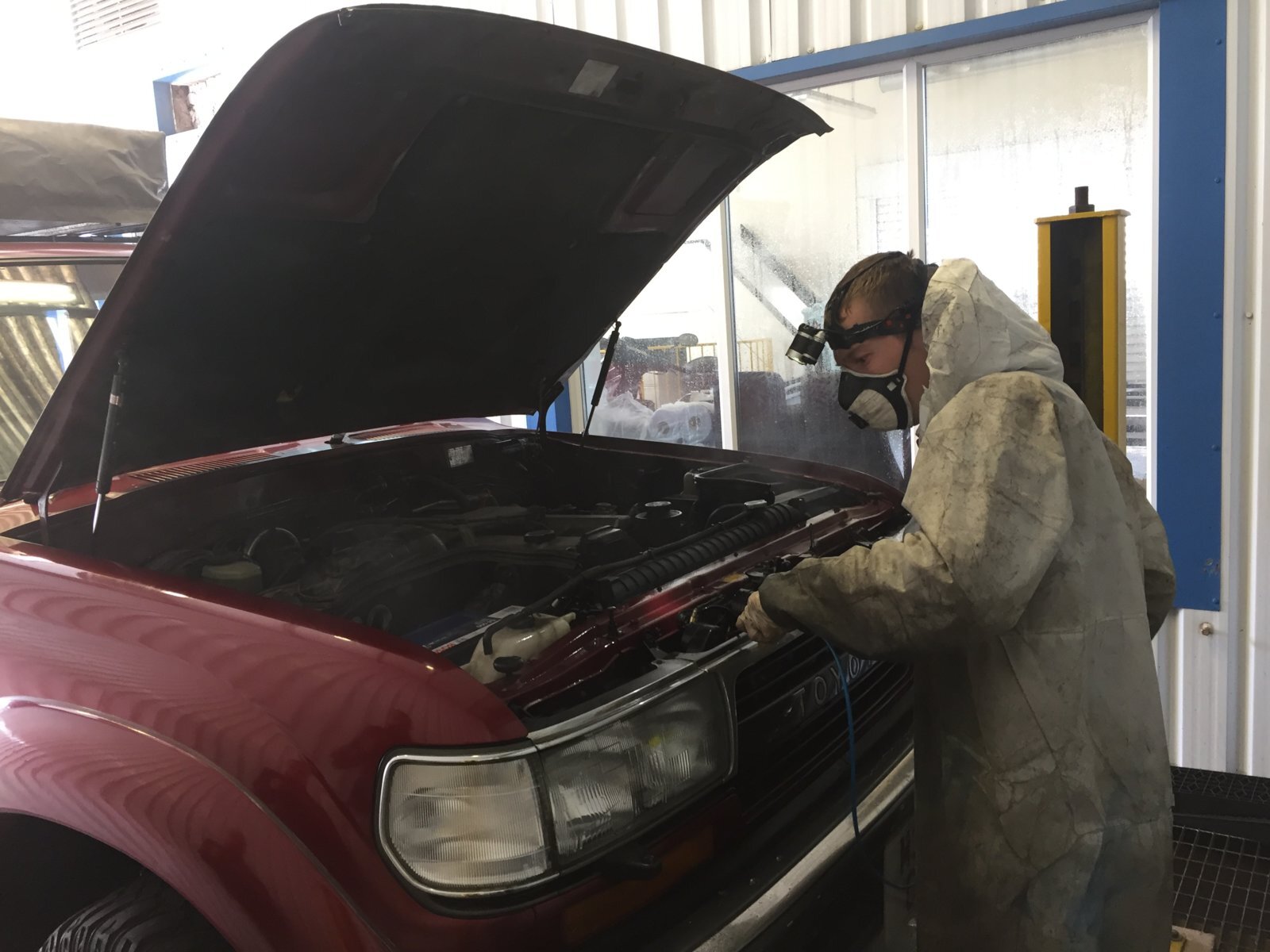

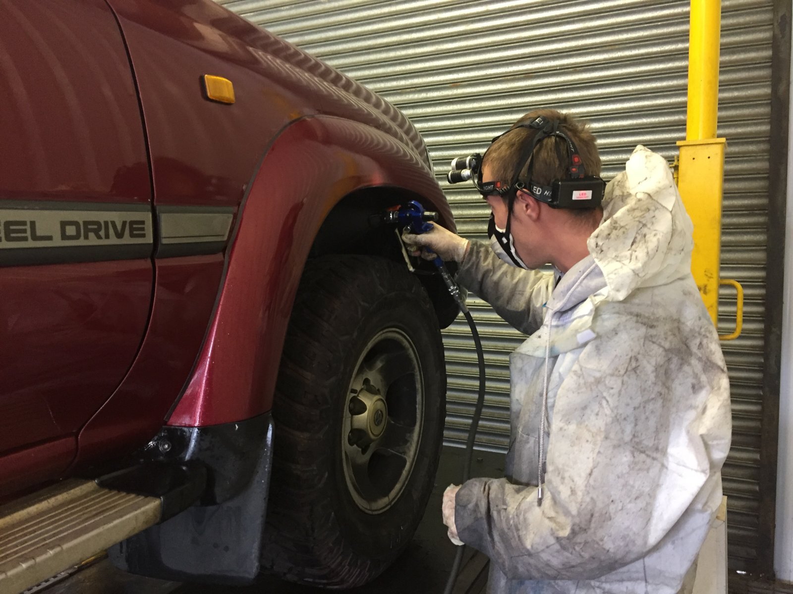

He took his time, 3hrs in total, and with various guns, lances and attachments repeated the process around every door handle, body moulding and protrusion, before coating the entire engine bay in minute detail (not an allover spray and that'll do).
He wasn't impressed by the fibreglass sound deadening in the engine bay saying it could hold moisture but sprayed in behind it as best he could.

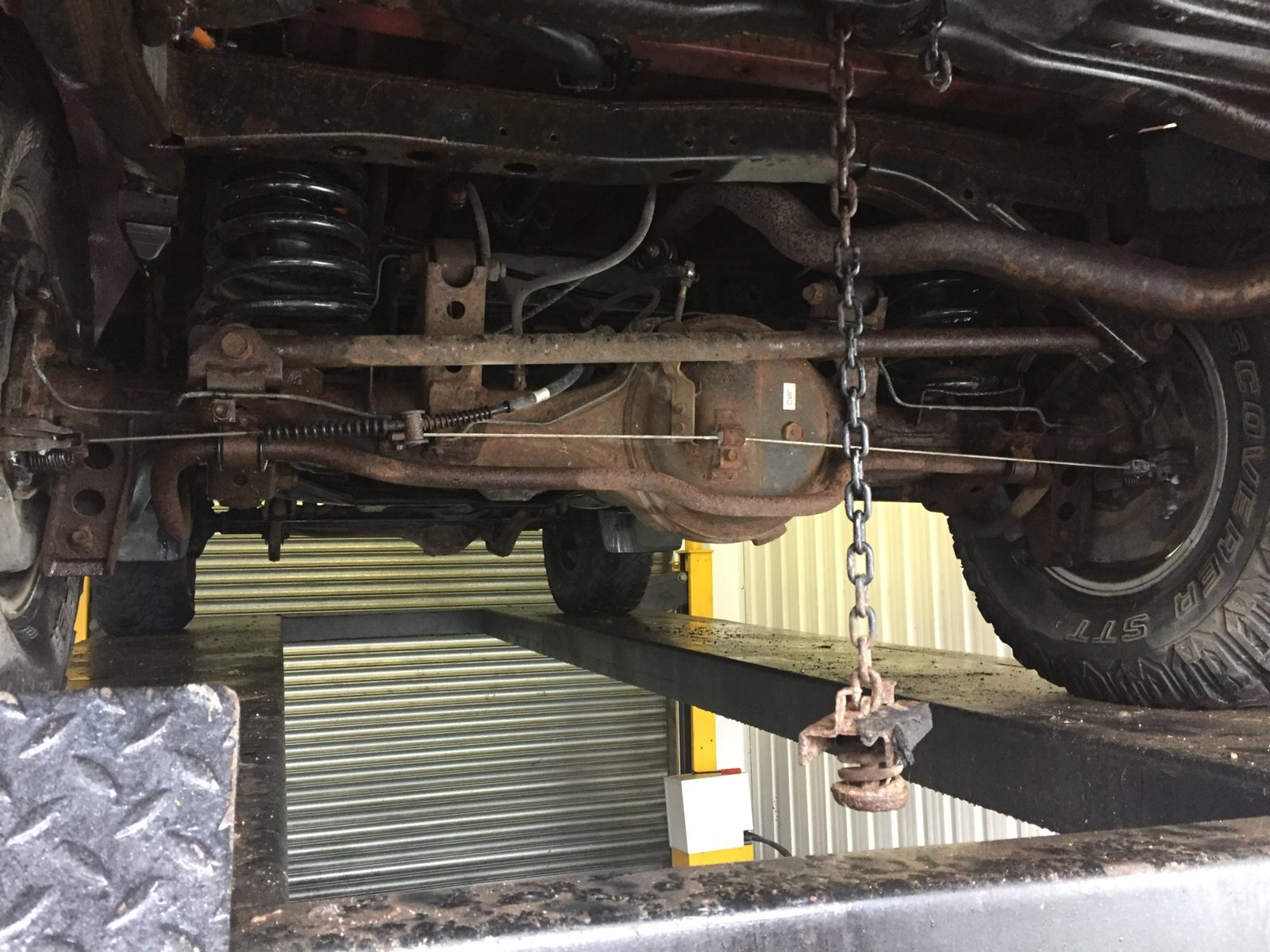

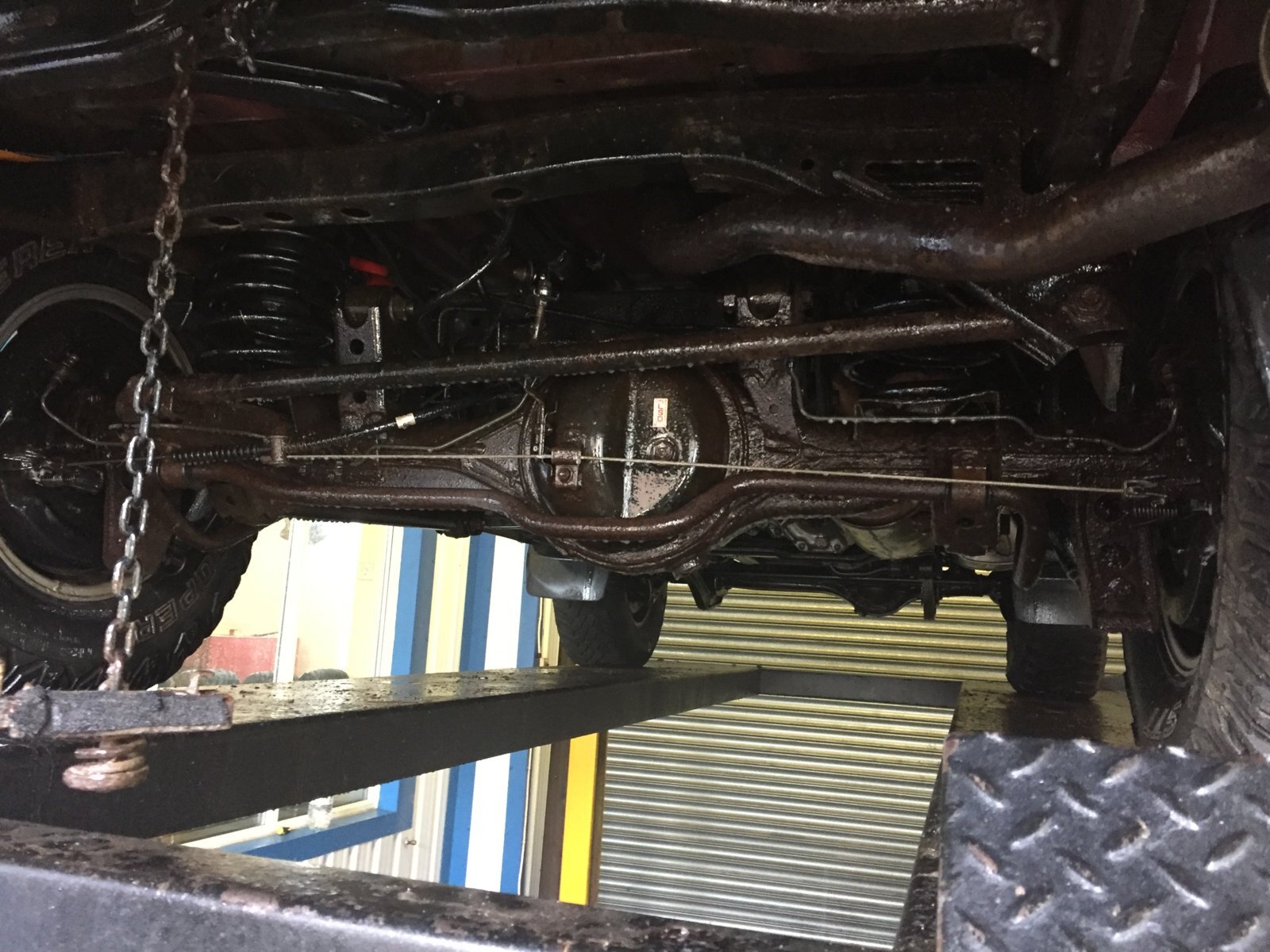

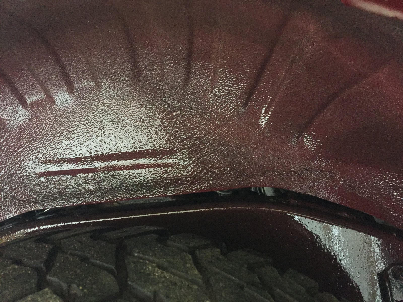

Then he went on to the underside, and with the same attention to detail he sprayed into every hole in the chassis rails, cills, fuel tank guard, everything. All this time I was able to watch at close hand. Rob is an ex bodyworks guy and still sprays cars in his spare time. I got the impression he knew every inch of a vehicle's bodywork.

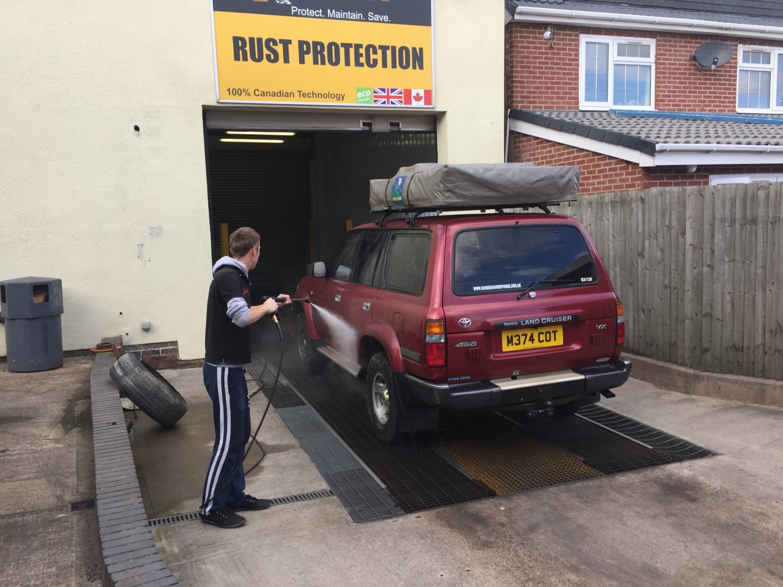

I was given a demonstration by aiming the jet wash at the back axle showing how the water beads and runs straight off.
After all this was done, off the ramp came the truck to be washed off.
The rustproofer is clear, slightly oily to the touch, mildly fragrant and apparently environmentally friendly (unsurprisingly knowing the Canadians). It turns slightly gel like, not waxy, after a few weeks and will drip from every orifice on the vehicle until this process is complete. Regular wiping is needed, but it is not a problem as long as you know it's there and needs wiping. Brakes and exhaust can be dropped upon and they warn of this, but again it's not really a problem as long as you are aware that the brakes may need to boil off the odd drop. I didn't notice any difference or problem.
So far, I'm impressed with the application. I don't think anybody could have found anywhere on the underside of the truck not covered. If the product is as good as they say, and I've no doubt it is good, then all should be good.

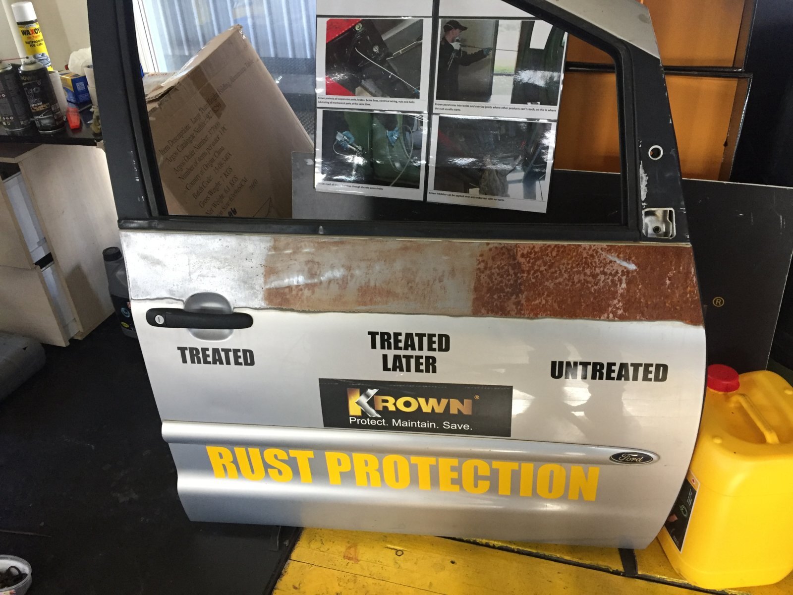

Edgar showed me a video of a 2004 car up on a ramp that had failed MOT and been advised not to be put back on the road. It was undersealed with something solid from the factory. The guy reached up and pulled it down in sheets complete with the whole floor pan completely rusted out. The sealer had trapped moisture rotting out the floor.
I wonder what its like on an already rusty chassis ? Does it 'convert' the rust thats already there?
Interested as mine is pretty yucky underneath :(
I don't think 'convert' is the right word as such. I think, judging by the door, that it stops the rust at the point it is at. Quite what it would do for thick layers of heavy rust I don't know but I would expect anything loose or flaking would really need to be removed so the stuff can get to the surface to do its job. Having said that it would probably creep in over time in between any layers that were hard to reach and remove, for example.

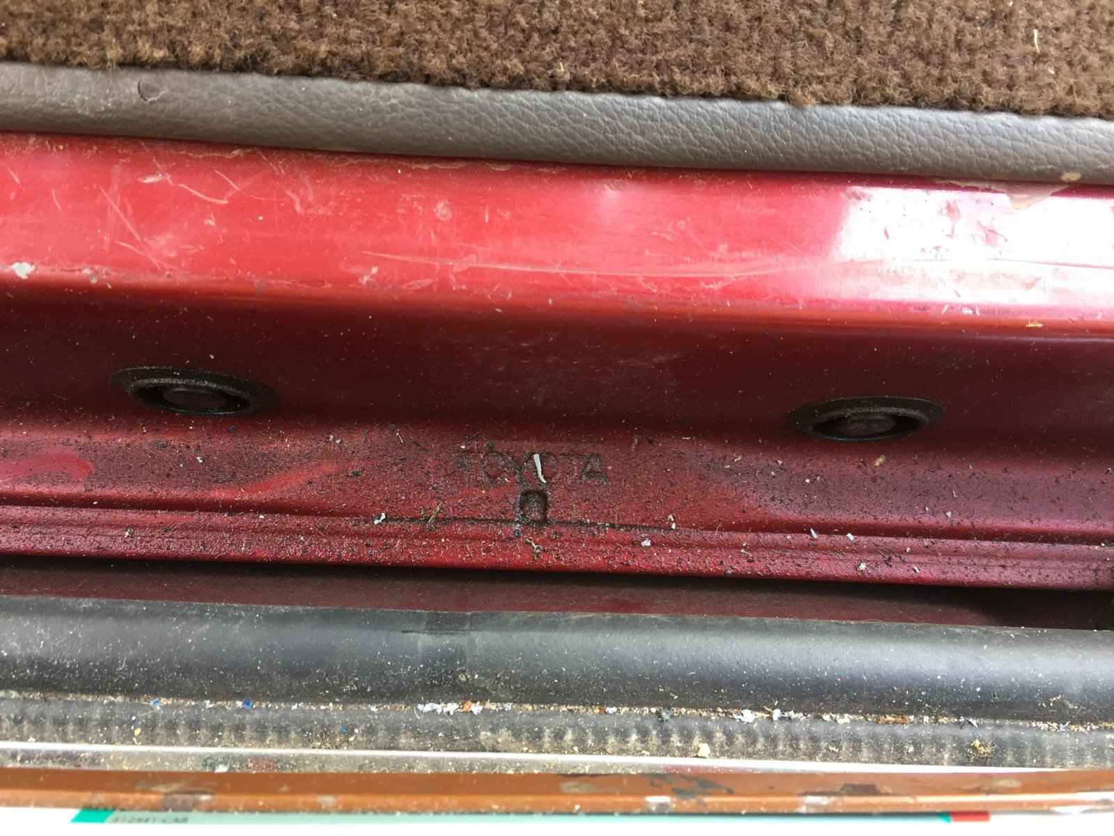

Through the winter there wasn't much to report really. When the weather got a bit warmer however it was noticible that the product had started to 'creep' from some of the panel holes.IMG_1355.JPG IMG_1357.JPG Not much, but noticible and being a feature of the stuff I expected this anyway. Dust starts to collect on it which again, I expected and is something I'm not overly bothered about.
The tow bar is the bit that shows best, not being under cover, and that is still well coated. IMG_1352.JPG The hole to the right was quite rusted before coating and it's certainly coated now. The rest of the underneath is well coated with a fine layer of damp looking dust,IMG_1359.JPG IMG_1361.JPG again indicative the Krown is present. It all looks dark as if damp and has a few very thin splatter marks from muddy splashes that have adhered to it. In the wheel arches, it shows quite well how the stuff is creeping from the panel edgesIMG_1364.JPGIMG_1363.JPG
