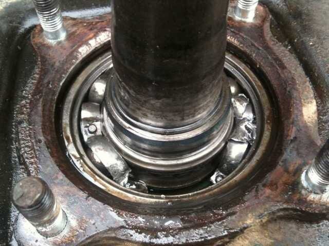

Got the hubs off this evening.... Mmm think the bearing has seen better days!
Hope to get them to the workshop tomorrow and then all back together on Friday :)

No sign of rust or overheating. Probably caused by catastrophic ball failure, and that could be attributed to rear wheel imbalance creating a brinelling effect.
