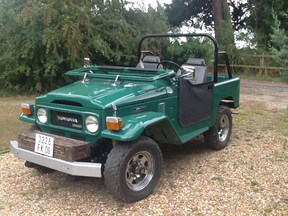

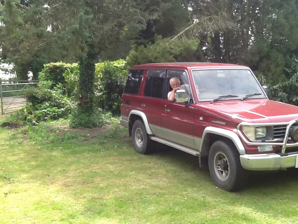

Hi, just joined and need advice ,anyone? My LWB monster has just decided to get confused as to when to change up a gear. ( revs 3000 clocking 40 mp).. Plan to change the auto gearbox oil but my garage tells me to first buy a gasket and filter. Does anyone know what this is on my Prado ( perhaps a workshop manual picture?) Thanks . I do have a 2 year restoration project on my Toyota BJ42 written up on IH8mud if anyone is interested.
