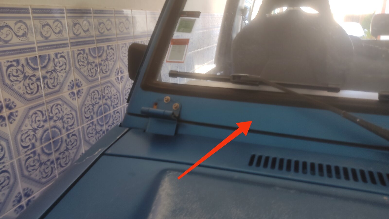

Guys, after seeing the YouTube link they posted here about changing the diesel filter, I did the change on my BJ and it was super easy.
I installed the hardtop belts and already put the hood support for the front glass.
Unfortunately I couldn't take great pictures because it started to rain
