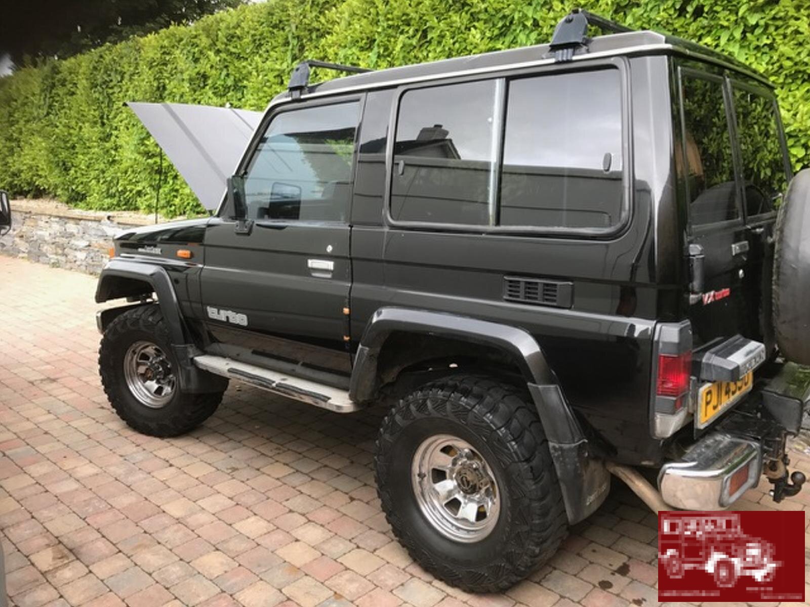

Can someone help and tell me if these are standard rims and if so what size width are they? The tyres on it are 33 x 12.5 x 15 but id like to fit smaller tyres that are better for the road use at the moment, something like 31 x 10.5 x 15.
I could buy a set of rims and tyres from milner but I do like the rims just not the tyres.
View attachment 128377 Can someone help and tell me if these are standard rims and if so what size width are they? The tyres on it are 33 x 12.5 x 15 but id like to fit smaller tyres that are better for the road use at the moment, something like 31 x 10.5 x 15.
Hi.
Those rims are not stock to the best of my knowledge. However I could be wrong. What series is your cruiser. I know that the stock size for your vehicle usually is 265x70x15. That roughly works out to be 29 point something in hieght. Going for good dunlop AT's is not a bad idea. Dunlop Sp RV majors are good aggressive all terrains . And work out to be around 31. 10.5. 15.
The ones you have now dont look like 33's.
Above is my opinion . I could be wrong. Btw nice ride. Do post more pics.
Cheers
TL

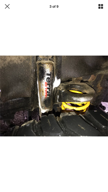

Its an LJ70 1989, no pictures of it in action yet as main focus has been cleaning it up, tyres on it are def 33 x 12.5 x 15 but its on Raptor yellow springs by the looks of it and 2" lift so maybe the tyres look small. Im assuming the spray on the shock absorber is sealant as was told on original paint but of course i could of be lied to.

The stock wheel size on your lj is supposed to be 265/70/15.
Yes your current setup is 33 inches. Since you already have a lift of 2 inches why don't you keep the 33 . What is your main reason to change. If you must change then the 31/10.5/15 like you want is a good option. Btw good vehicle nice pics. What are your plans for the lj
At first my plans were to pull people's cars away that park outside my house with the winch, they are allowed to do it but it annoys me, i think a couple of times of finding their car stranded in the road will teach them to park outside their own house :) and pretty much not worry when people park right up my arse, i can just back straight into them and push them back a bit or just go up their car...... Now its turned up I'd like to try a bit of green lane driving(is it called that?) but not much of that around West London itself... will have to go further afield.
I'm not sure the tyres will pass the next MOT in November but who knows, a tyre more suited for road than the mud tyre currently on it and i thought a smaller tyre will give better handling and road noise. Maybe ill keep to a 33 as have a better motorway car and will look good with spacers.
My AT options for 33 seem to be
BF Goodrich AT KO 2 and a K0 or a Yoko Geolander? Any experience?
:) I must confess I have pulled some one out of my Parking lot ...but later I felt bad. I think the 33's right now are looking good on your beast so keep it that way for now. I also have added spacers , they do look nice. Both the Geo lander and the BF Goodrich are both good tires however I incline slightly the Geo lander way. While you are at it do consider the Dunlop SP RV Majors , I have had those on my Pajero and they are noise less and very aggressive AT's . I have had a good experience with them. I think they are not as dear as the other two. How is the clean up job coming along on your LC , what engine are you running?
