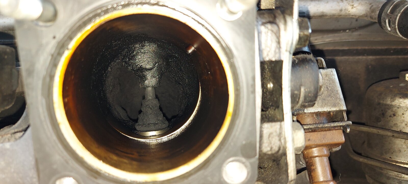

Did you clean the inlet manifold and throttle body out as well, and you may consider doing an egr delete, as per TONYCY11 who has made various posts and write ups in the 120 section to do with this.

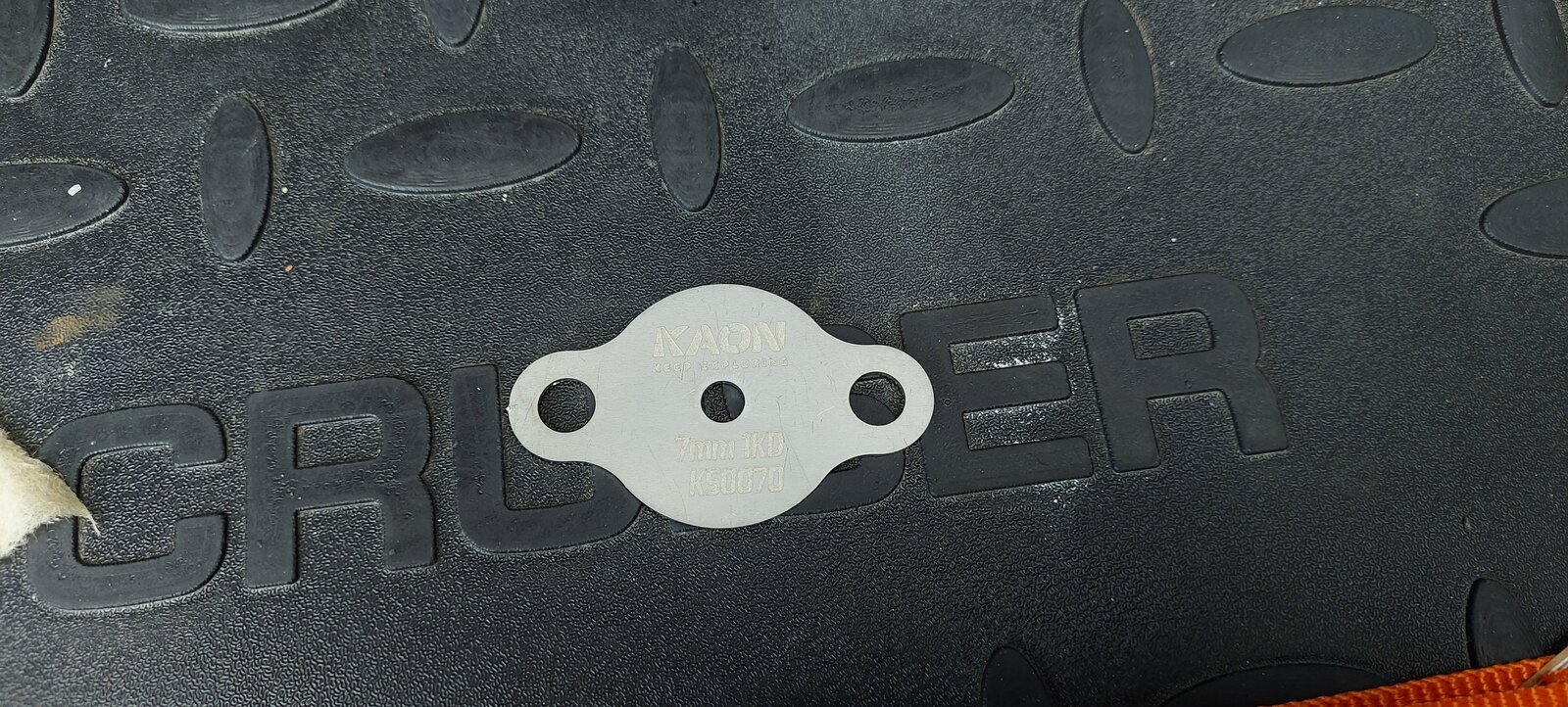

You can also block off the EGR system which should stop it from clogging up again. I blocked mine off, and the general theory is to drill a 7mm hole in it to prevent the engine management light coming on.
None that I could tell. No issues with emissions tests either

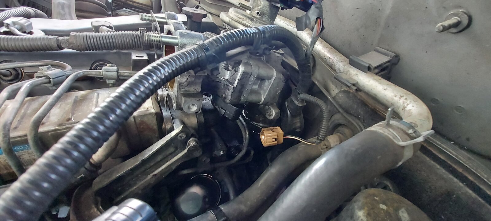

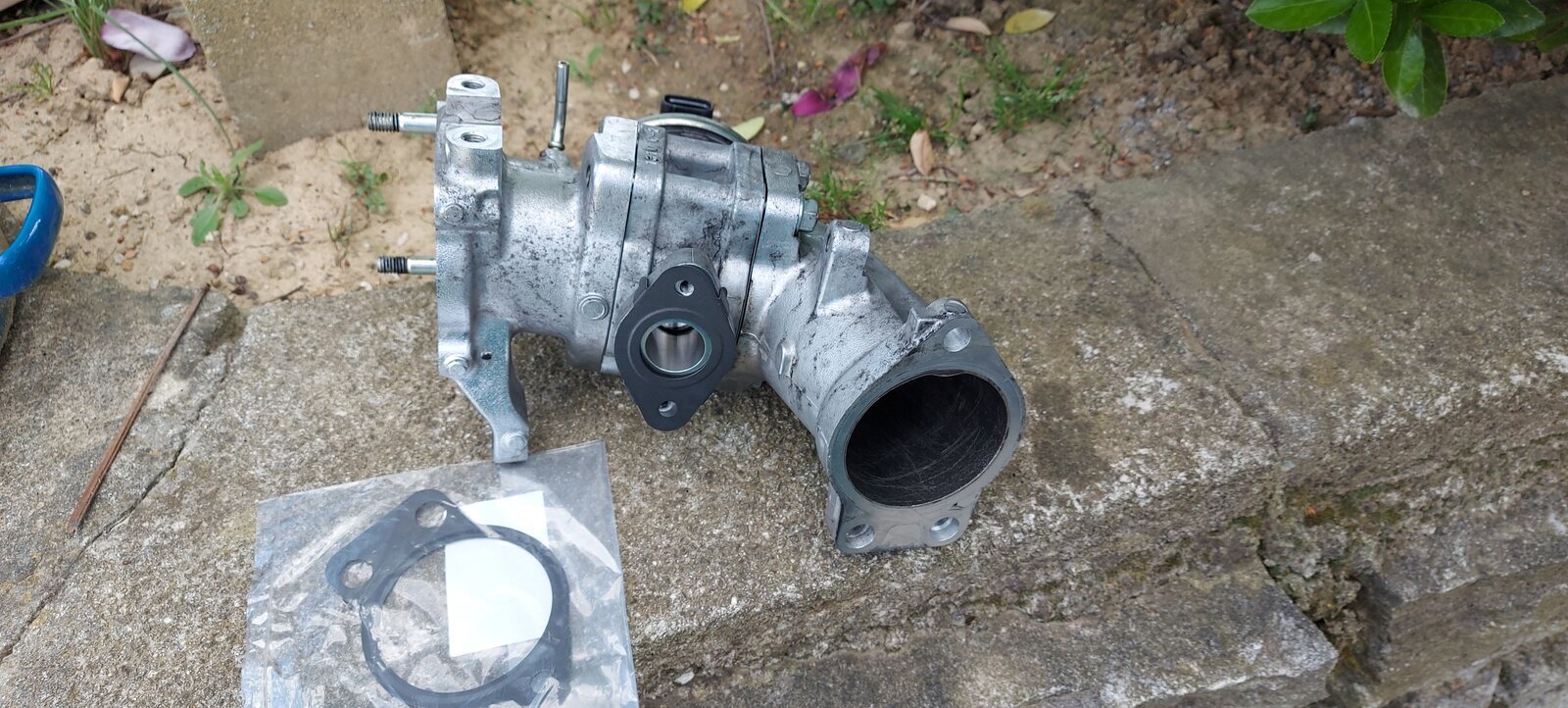

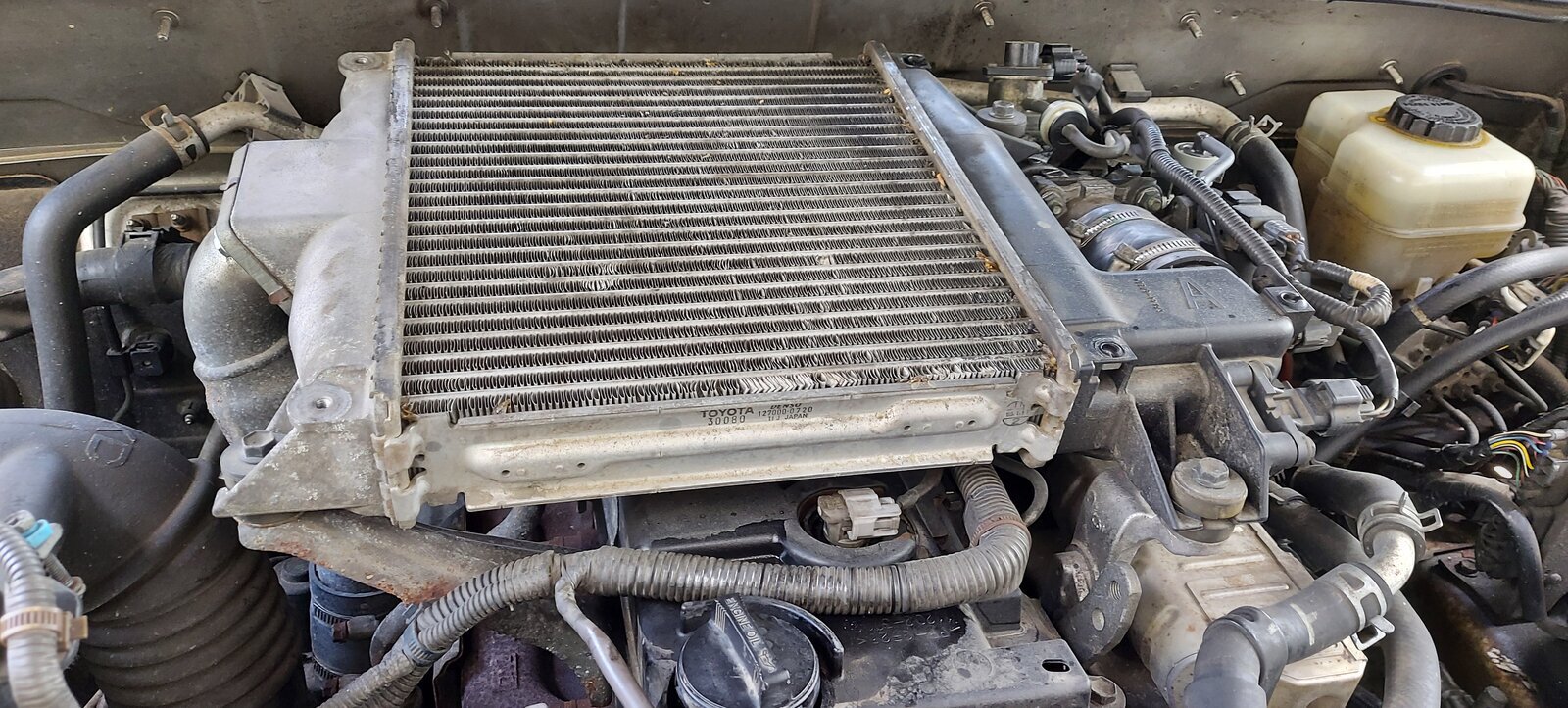

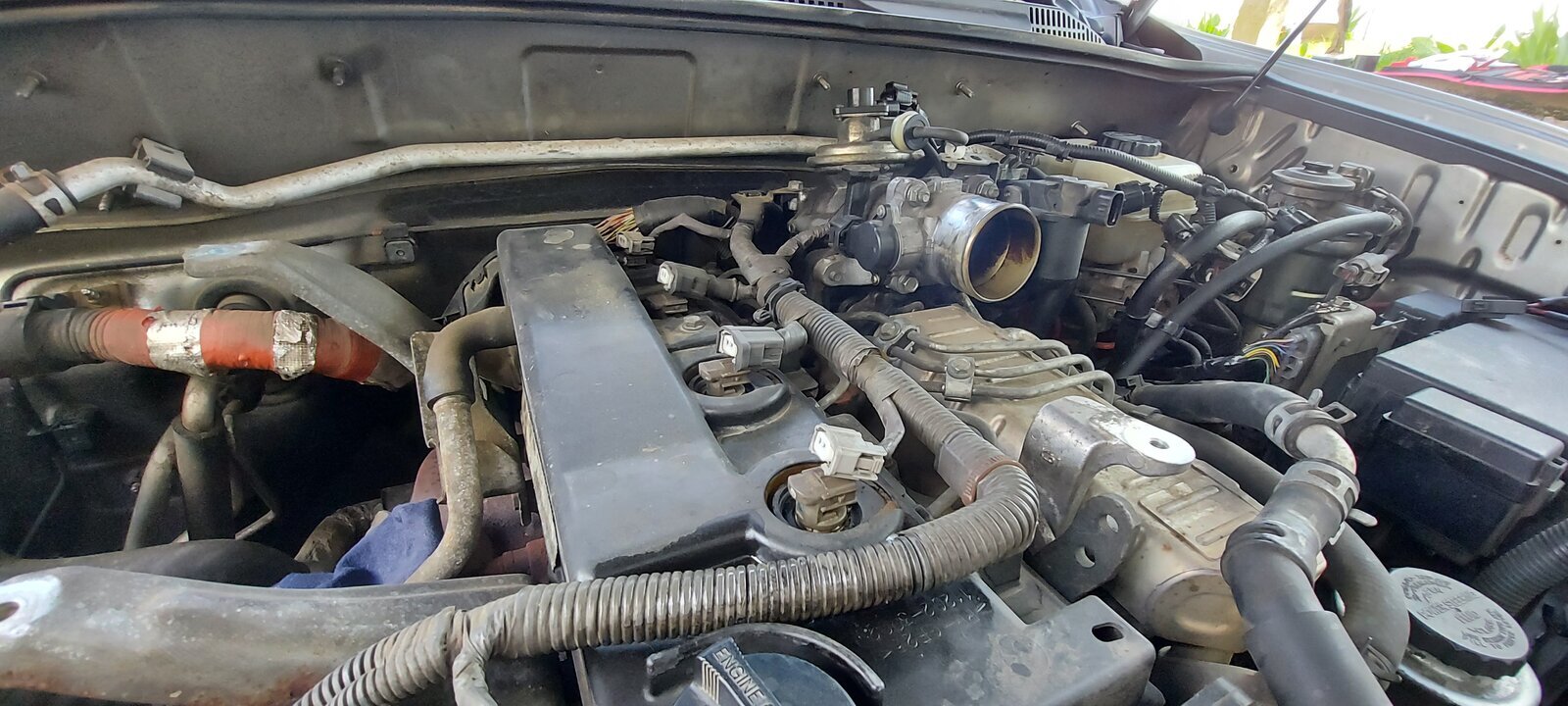

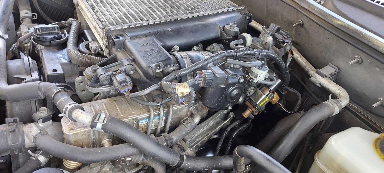

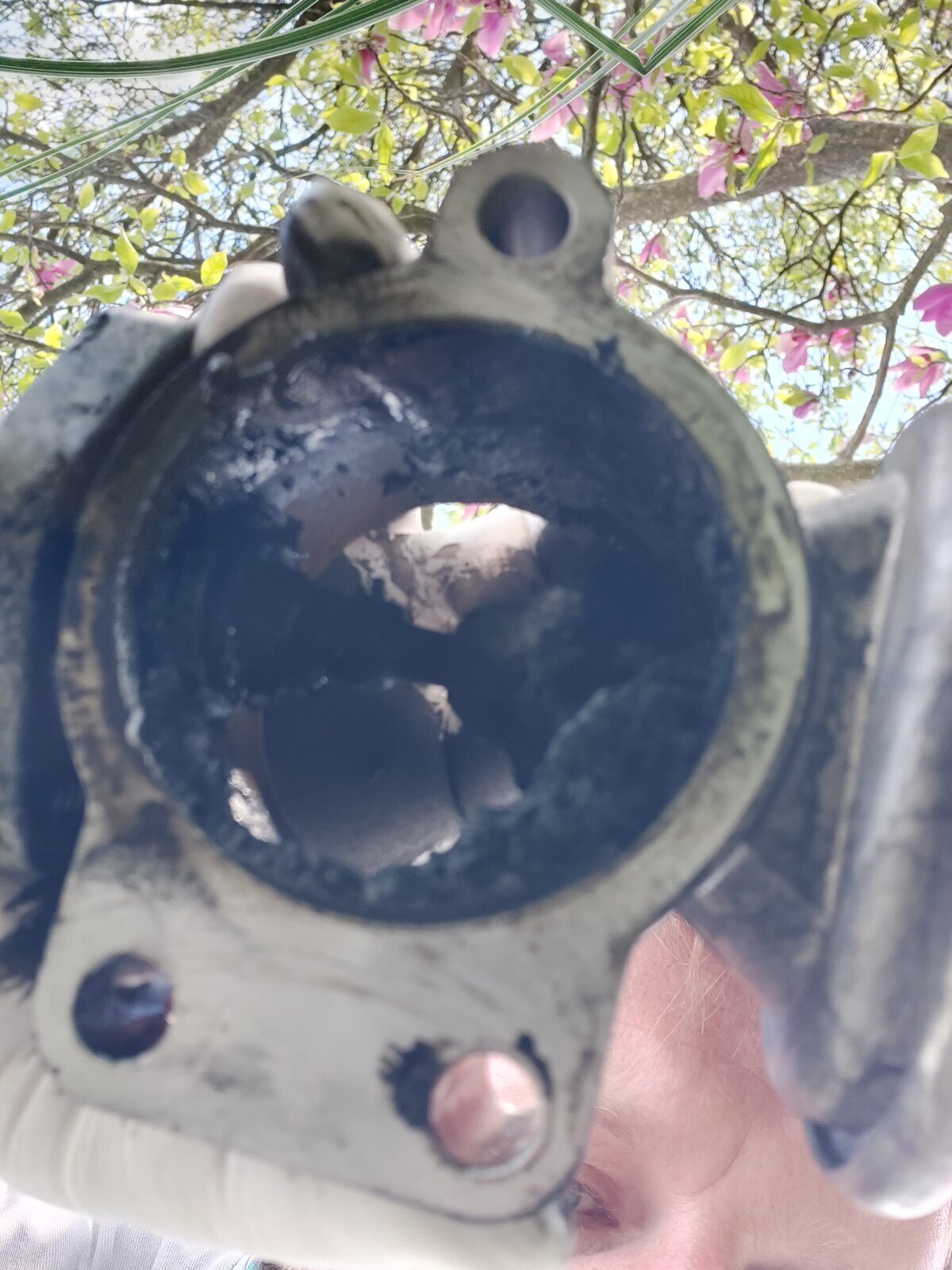

After doing oil change I bite into egr cleaning. There was an oil leak after egr,so one more thing to check ~ on one side there were 2 gaskets together, on other side none..

I even have egr blanking plate ready, tried to put it in before cooler, but had some difficulties and decided that will blank next time with injector removal.

No one could disagree that needed doing, it will be so much better for it.
Good job, well done !!
