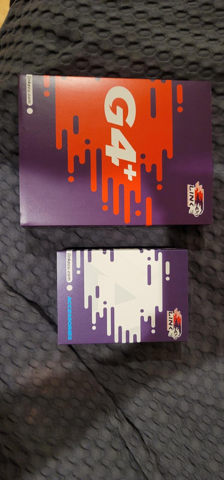

Hi,
I have a LC100 FZJ105 with a 1FZ-FE in 5 speed manual and 33s. Car is weighing in at 3200kg with all the gear in it. Engine has had complete rebuild 15,000km ago. Fuel consumption was 24L/100km Replaced injectors and fuel consumption is now 38L/100km. Ignition system is new and fuel system is new. Most of the engine bay has been replaced radiators etc. Electronics have NOT been touched.
9 days from now I will have a Link G4+ ECU and wide band O2 sensor installed and tuned in the hope of fixing the terrible economy.
I will keep you updated on the results and hopefully this gives some direction on how to fix this issue.
Brendon
  • Wow
Reactions: Naz
ECU installed and car tuned today. Fuel injectors that were installed are 400cc the original injectors were 250cc. Car was making 40kw at the wheels and now makes 75kw at the wheels. Car has not been released to me yet as it needs to have it's cold start tuned. Fuel figures to follow.

Hi @hks200s15 what are the updates on consumption after the tune?
