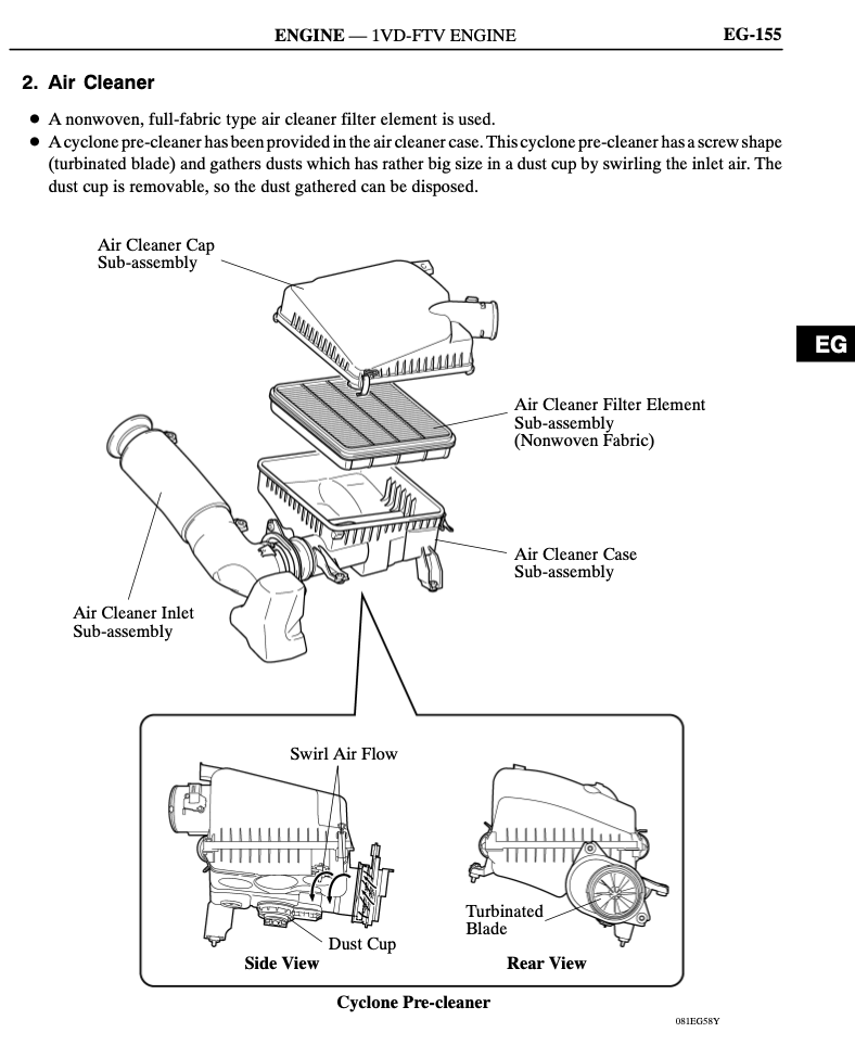

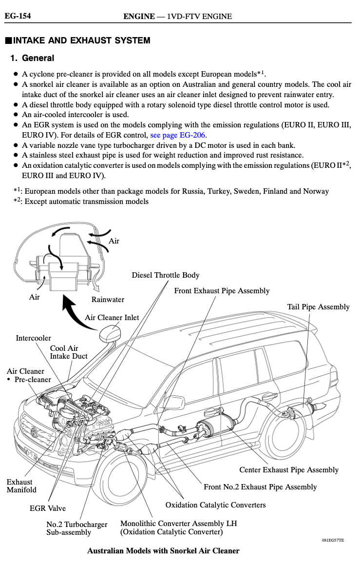

Hi Shayne,
I am not from Czech Republic and I also don't know but many of the listed 200s for sale there are specified as 265ps or 195kW.
From the official literature of the engine is clear that there is really such an engine but equipped with "pre cleaner" system:
Which few pages later is described as follow:
So if someone can explain would be nice!

This is for sure specifically for other Europe model, I don't think the ones in UK has pre-cleaner, I didn't see anything attached to the air filter box when I took it out.
I am trying to find out if my car is with somehow "reduced" power so to say.
I'd really like to remove any interventions software or not and bring it back up to 286hp.
For sure, there is nothing attached on the air filter as shown on the graphs above.
