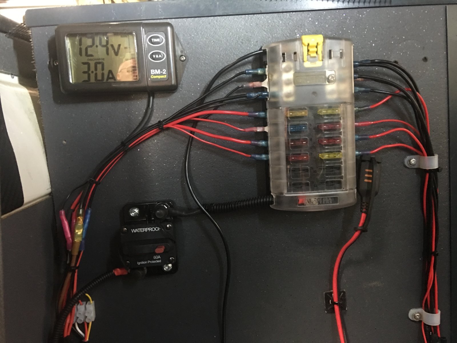

I've built my own in a tool box using a 130Ah AGM battery, Projecta IDC25 (which can do 24Volt Moggy). At the moment it only runs on solar input, but I will set it so that there is an Anderson plug for an alternator input.
This is everything before I put it together - I can't find a completed picture. I mounted the IDC25 to some MDF with an ali panel between the IDC and MDF, along with all the circuit breakers and a bus bar for the negatives.
That does look a good setup, and IP rated which is handy

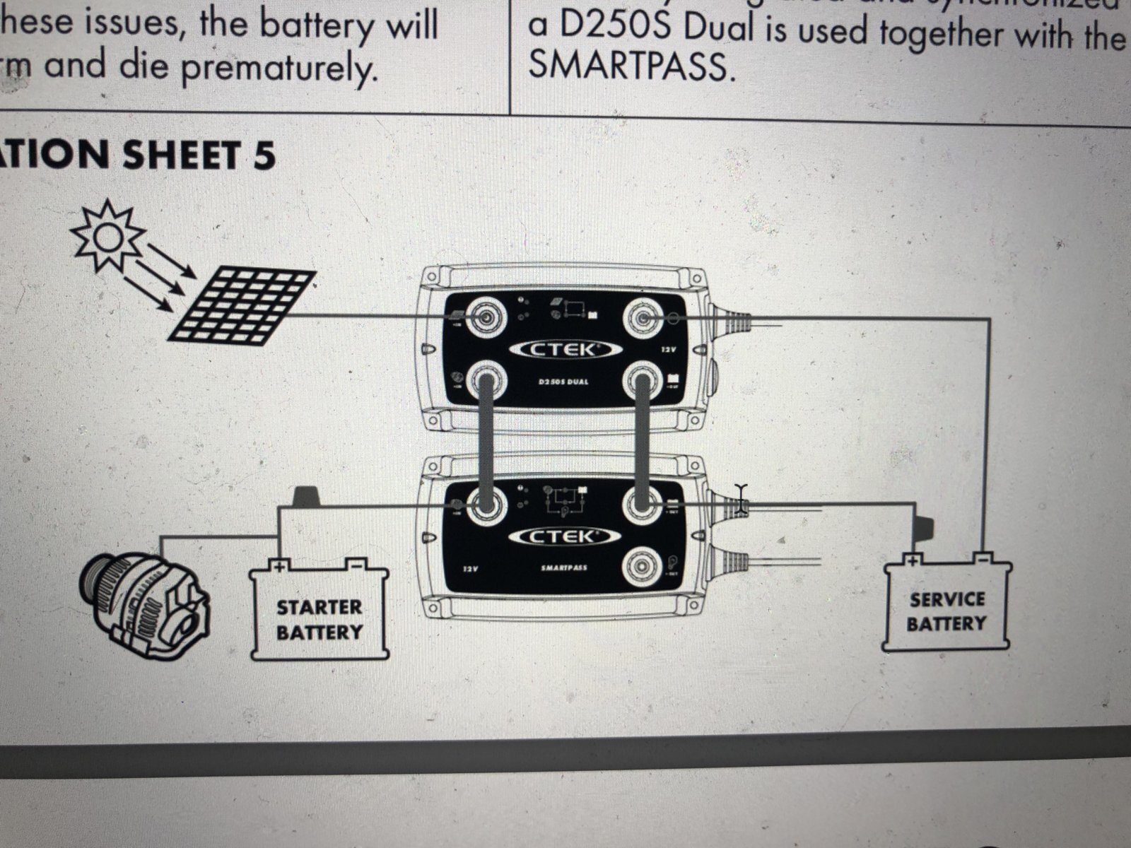

There is also the ctek dual 250 with smartpass that may do the samething and accept additional solar input when svailable.

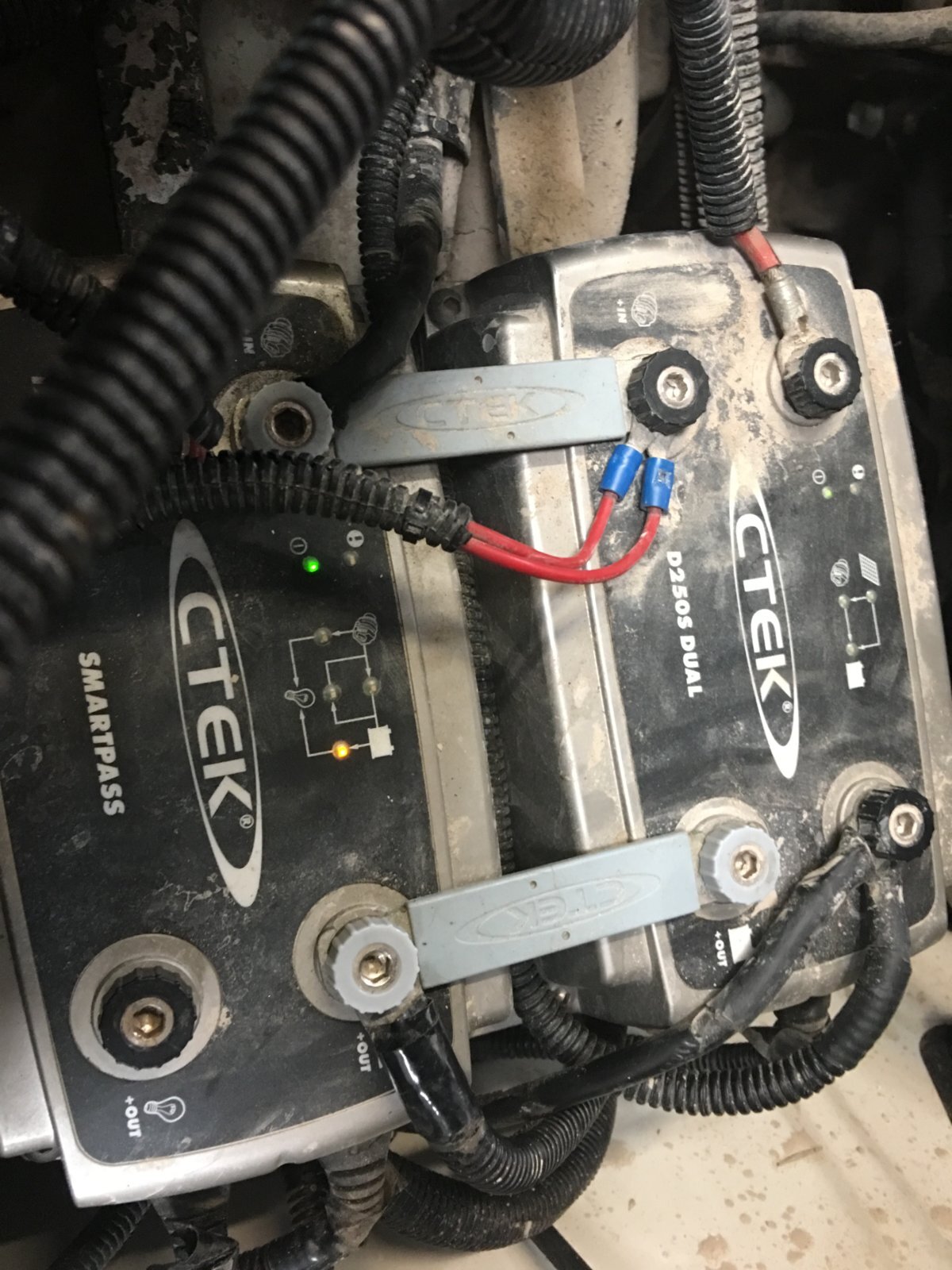

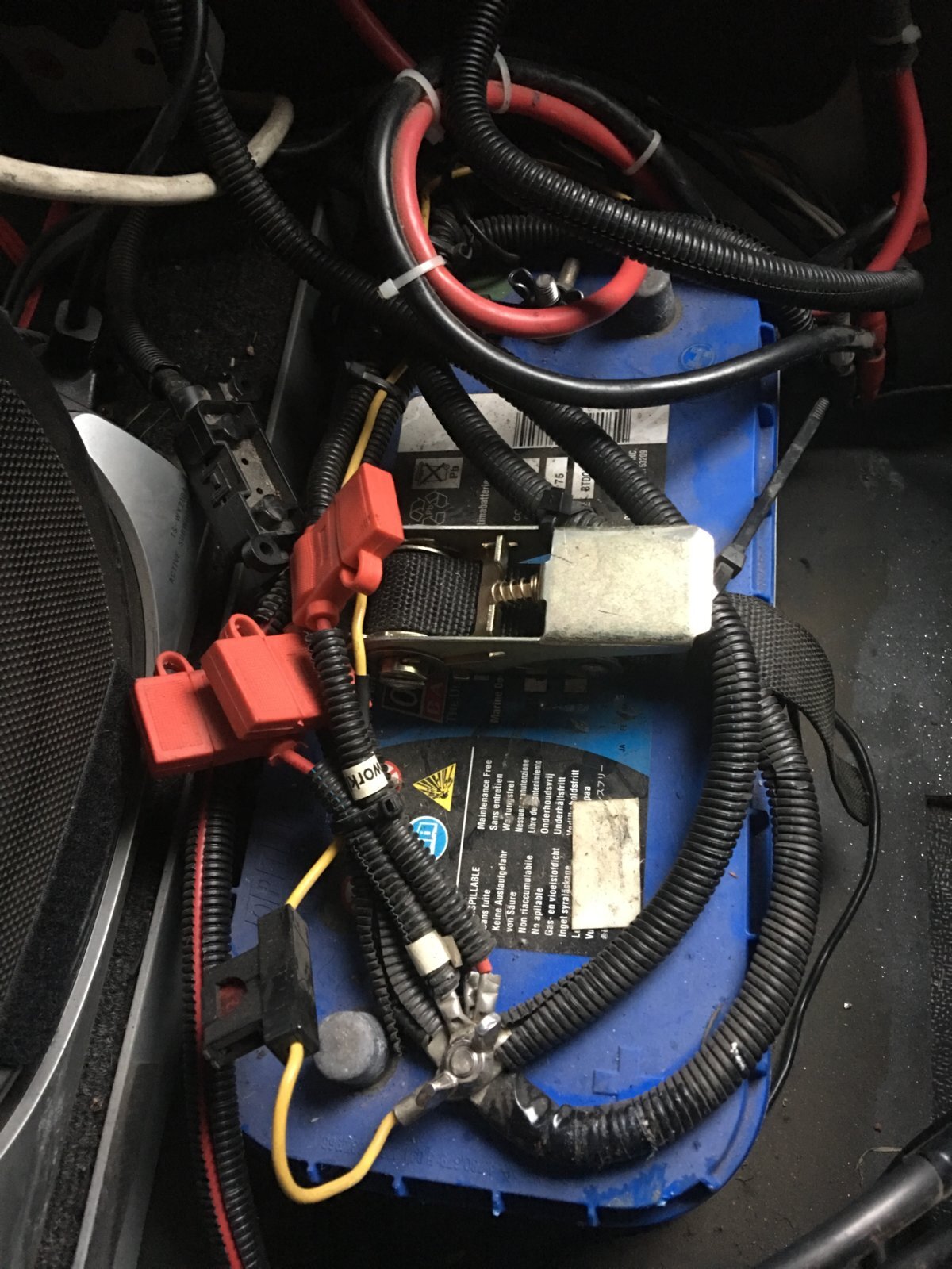

I have a Ctek 250 and Smartpass not clue what it does tbh it just works, It charges 2 75 amp Optima Blue tops. But I do use a lot of power for some reason. I rewired it all a few months ago as the wiring done by the previous owner left a little to be desired
think he had just about enough coming of the battery, I now have only 2 wires coming off it IMG_0300.JPG IMG_0306.JPG
think he had just about enough coming of the battery, I now have only 2 wires coming off it View attachment 138752 View attachment 138753
Looks much tidier now David. Is it fed straight from the starter battery or is there something in between?
