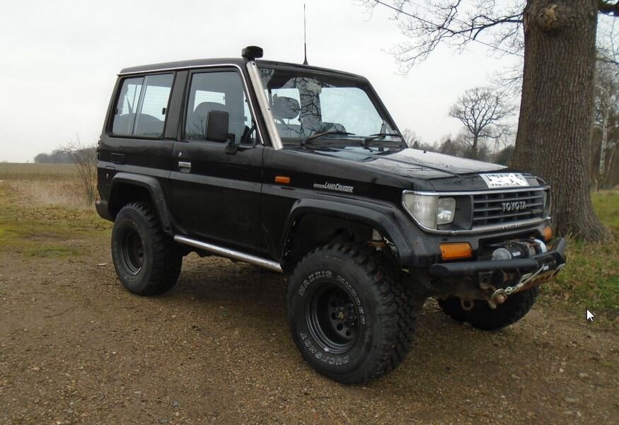

Here she is, I bought it, needs a bit of love, but generally seems solid and drives great!
Well done - saw that on eBay and thought she looked good. :thumbup:
I like that, nice looking 70. Reminds me a bit of modelmakerman's old one.
Looks very smart! :drool:
Congratulations! :thumbup:
O, o, o, that's the one that I want! But with steering wheel on driver's side not on passenger's... :icon-biggrin:
