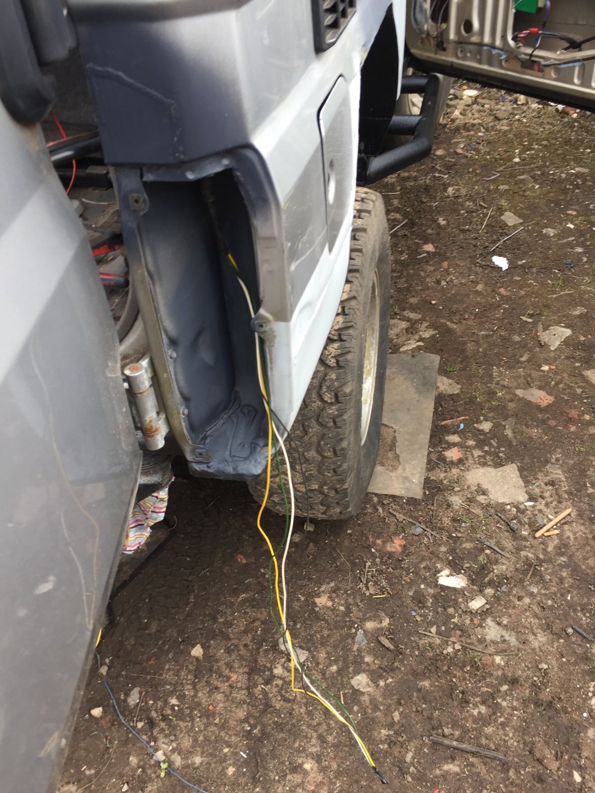

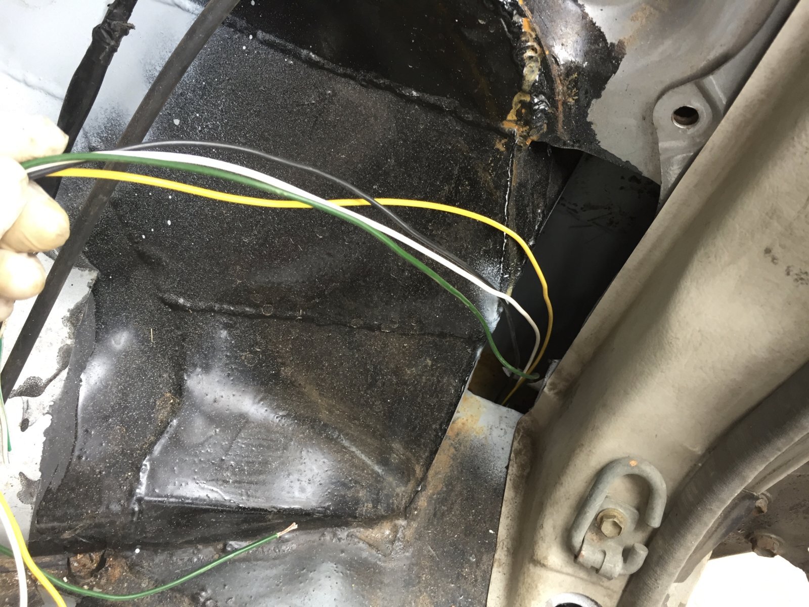

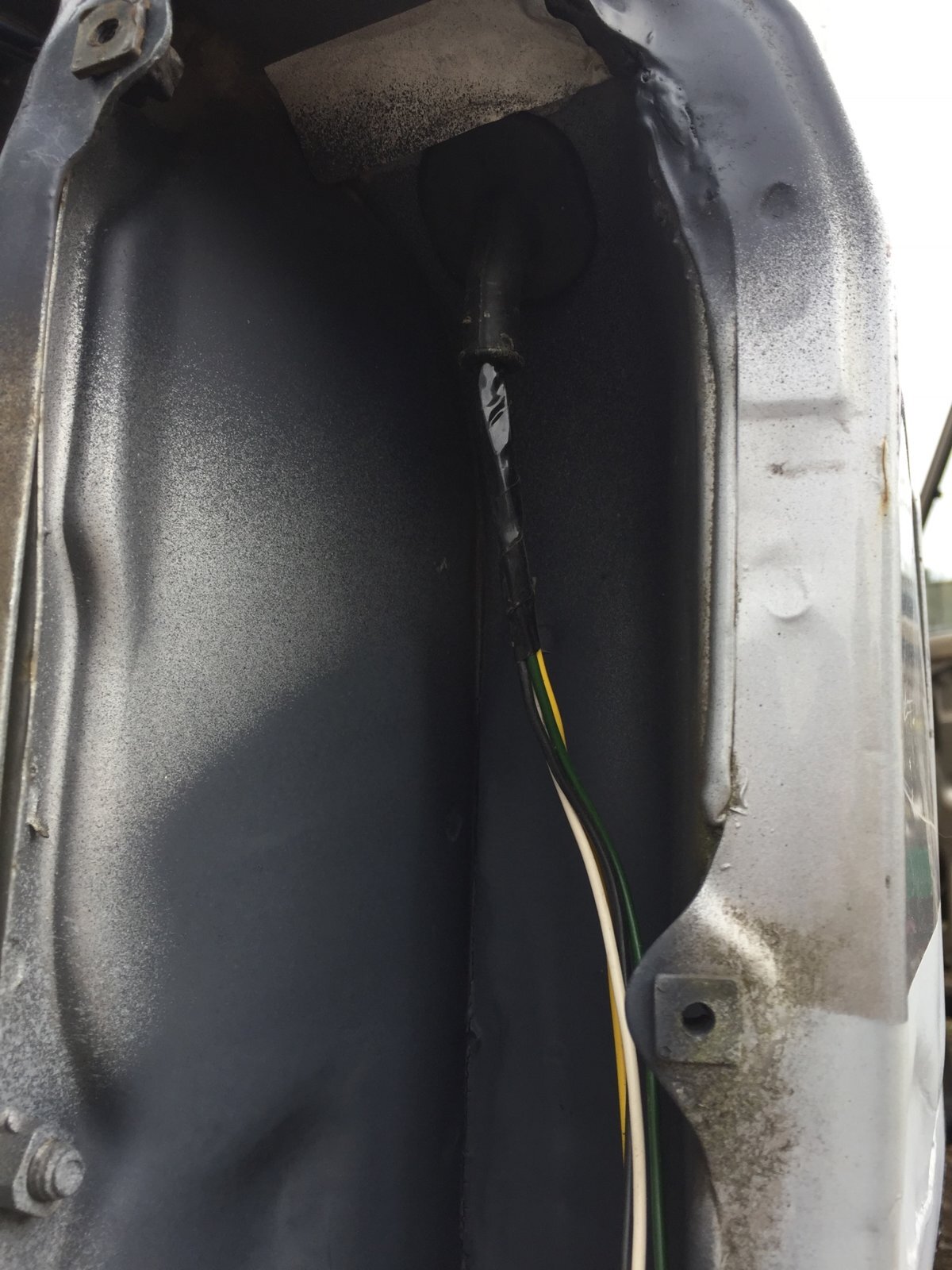

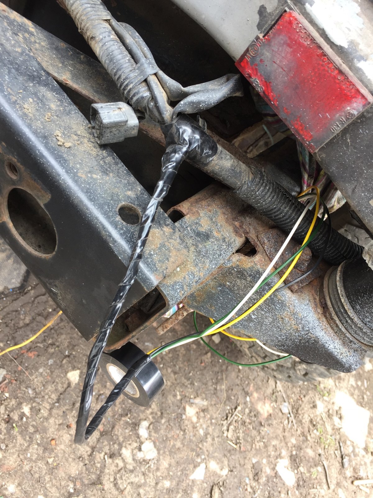

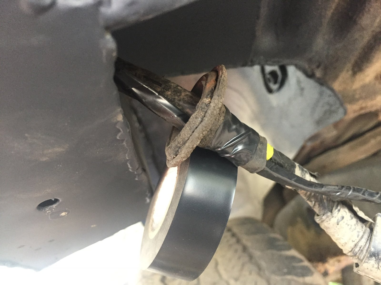

Taken the wiring from the lower lamps that where originally in the bumpers.
So using an orange bulb in the reverse light for indicators and a stop tail in the fog light.

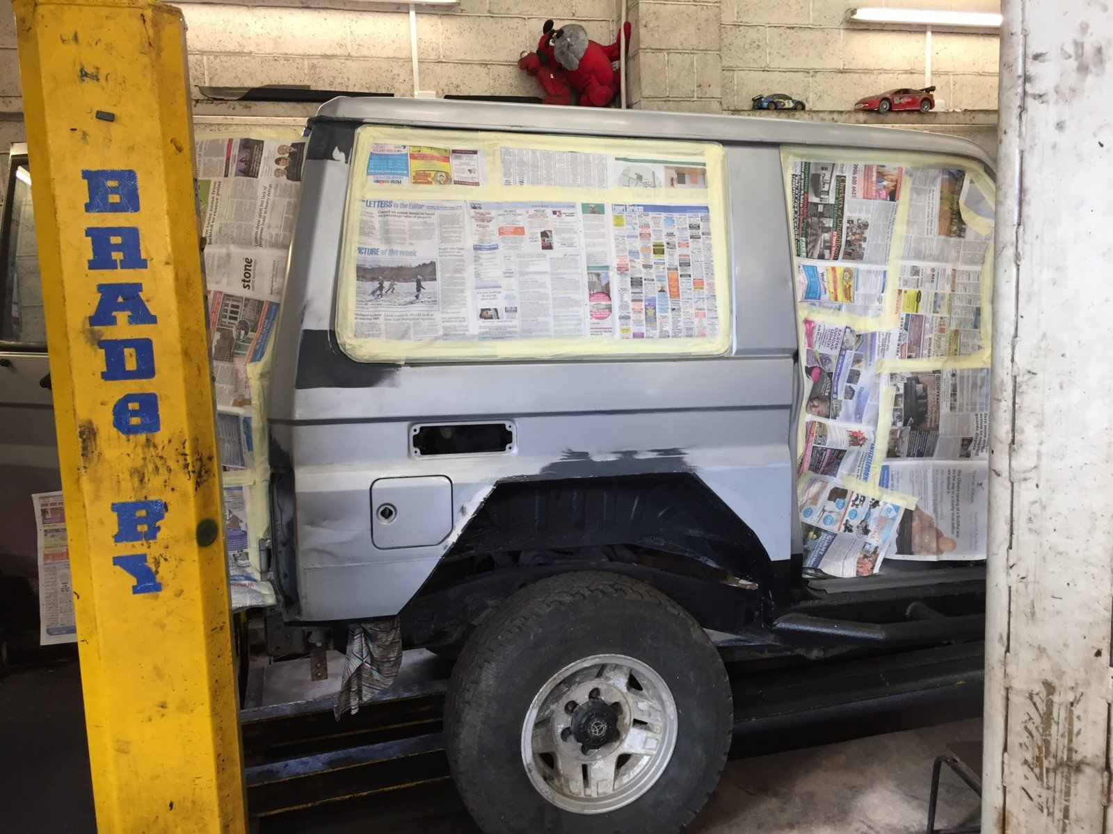

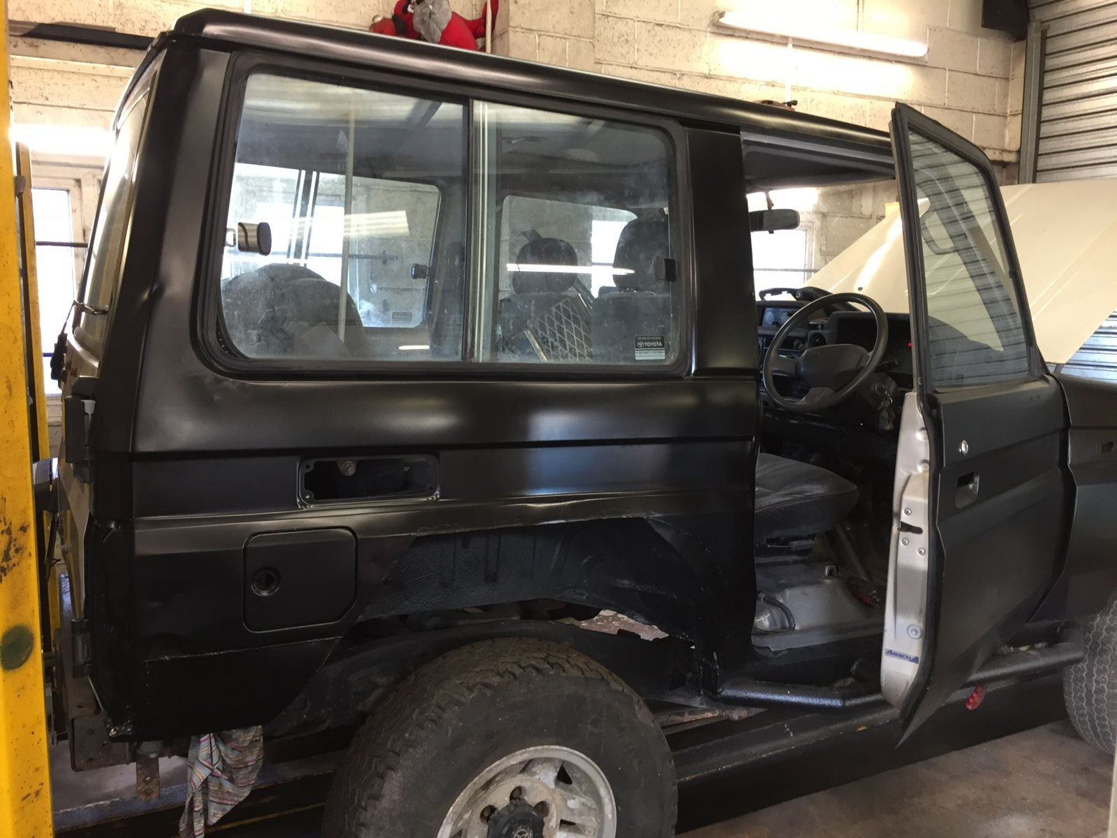

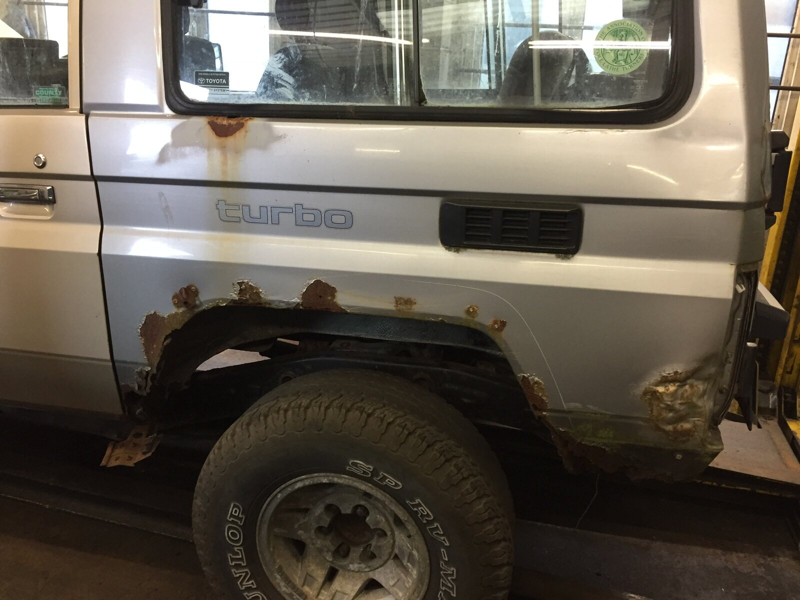

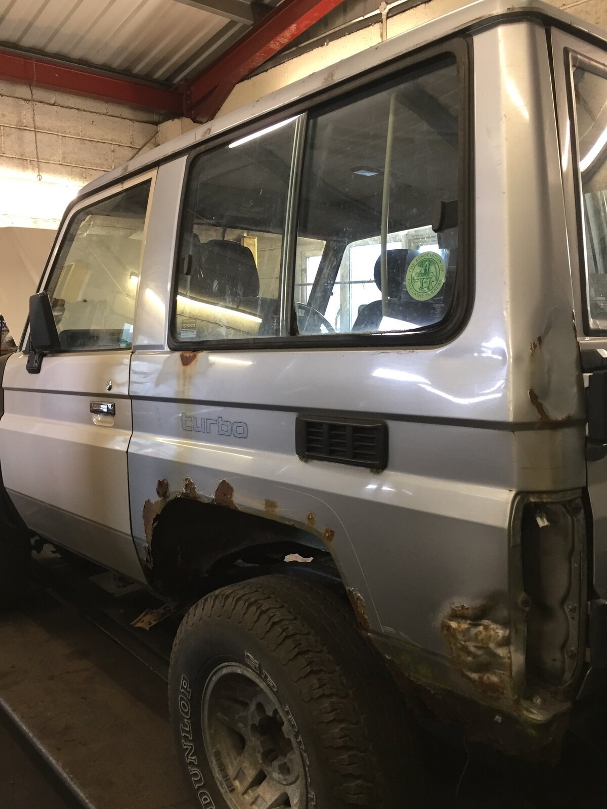

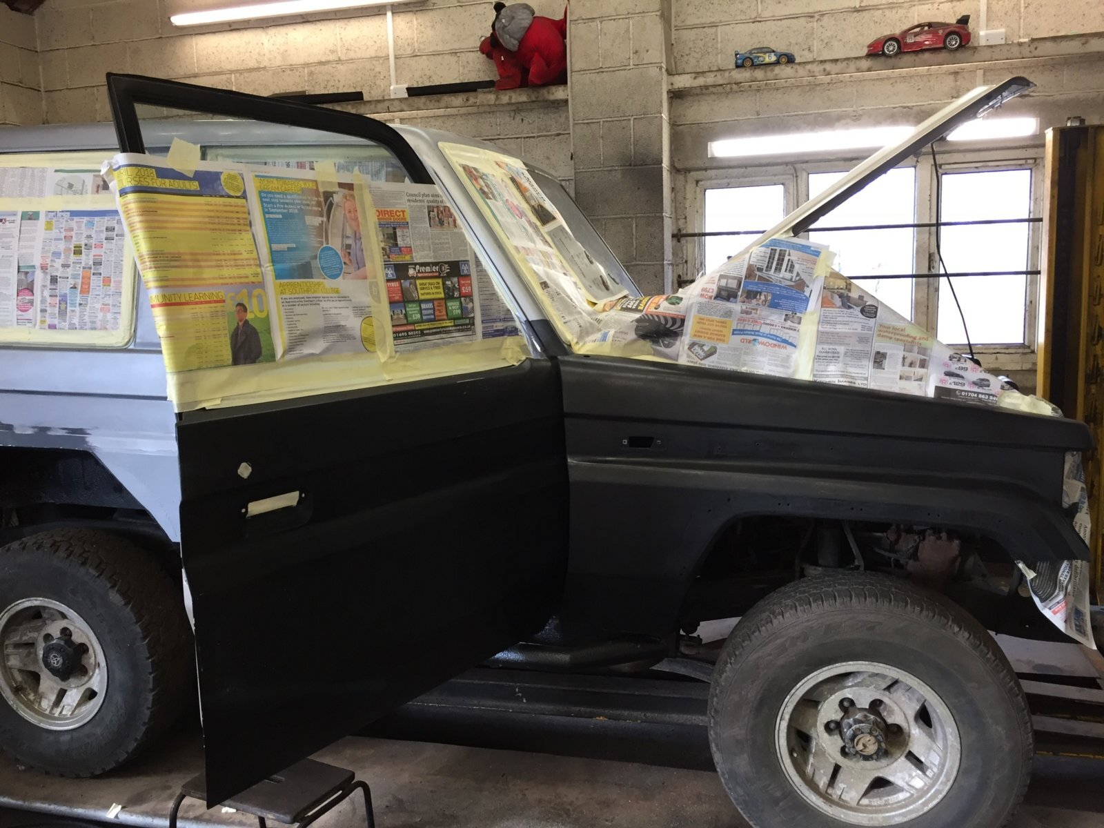

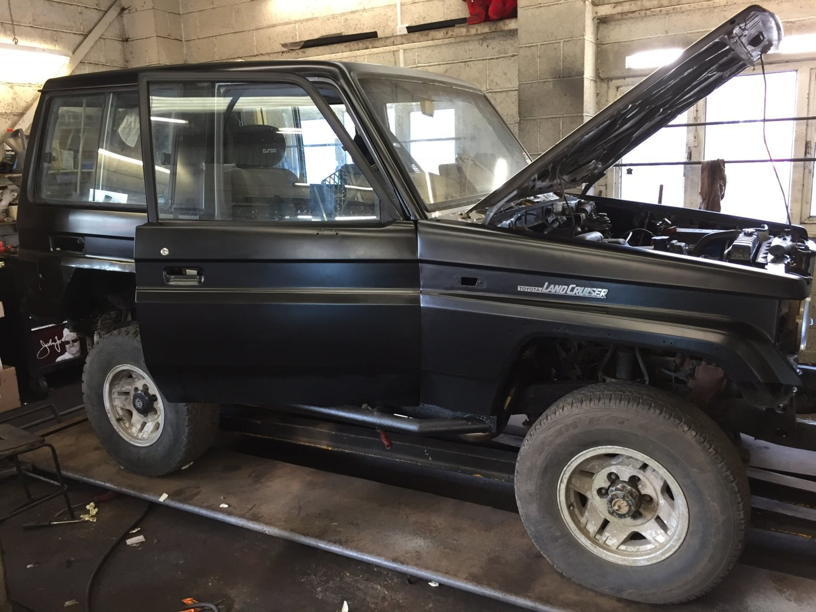

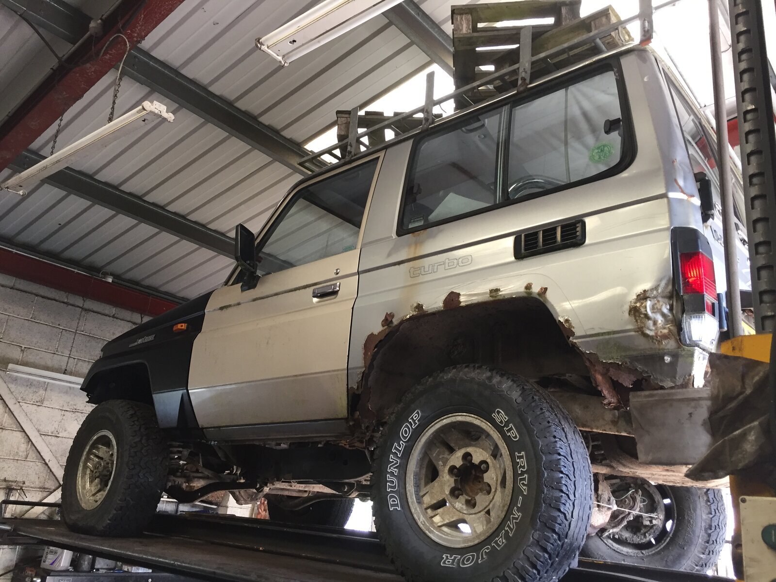

It’s been a while and thought I’d give an update, even though I’m way behind compared to what stage it’s actually at.

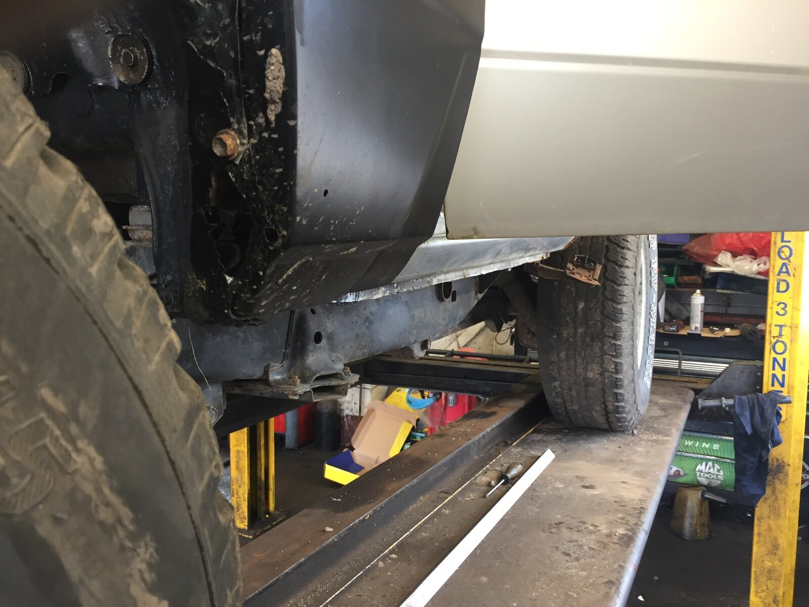

Time for the passenger side...

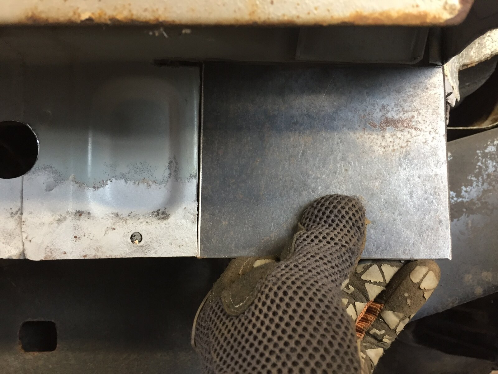

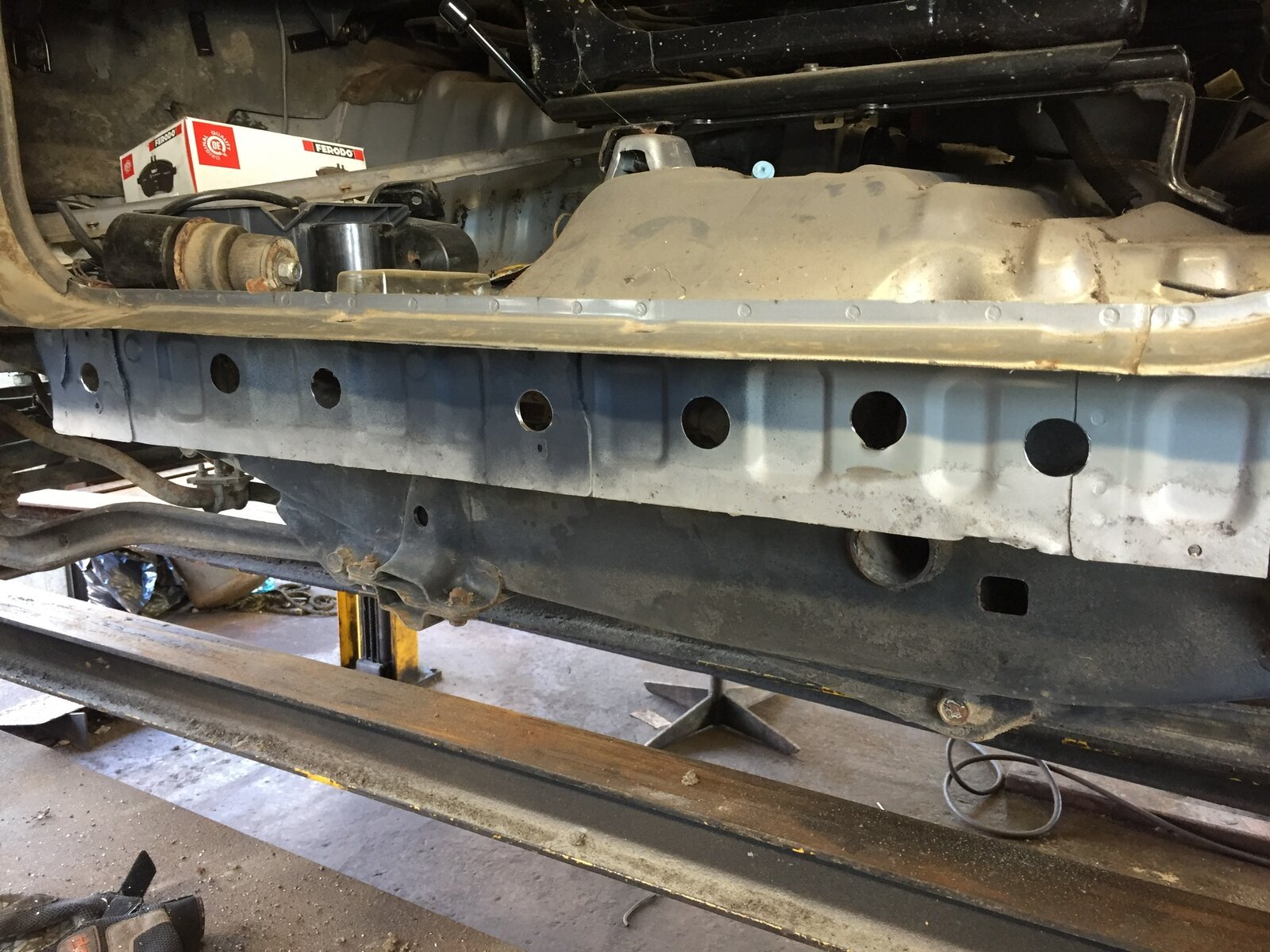

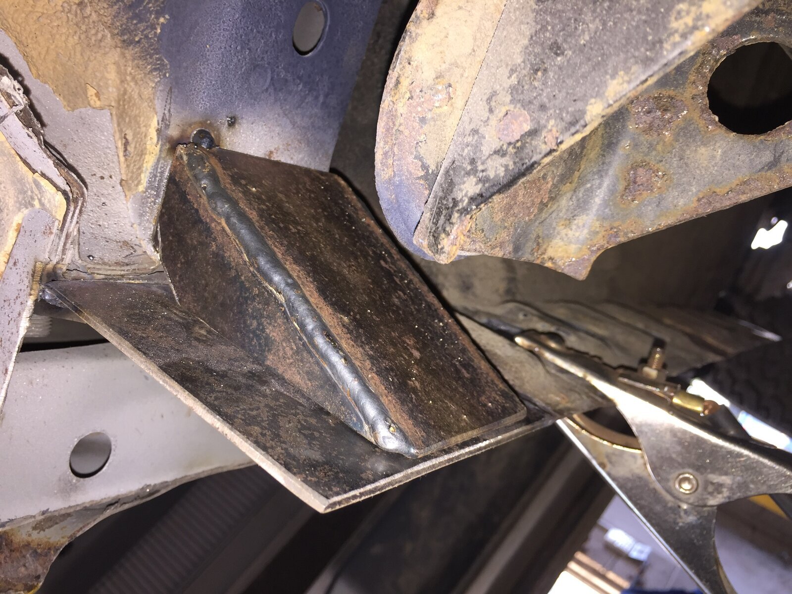

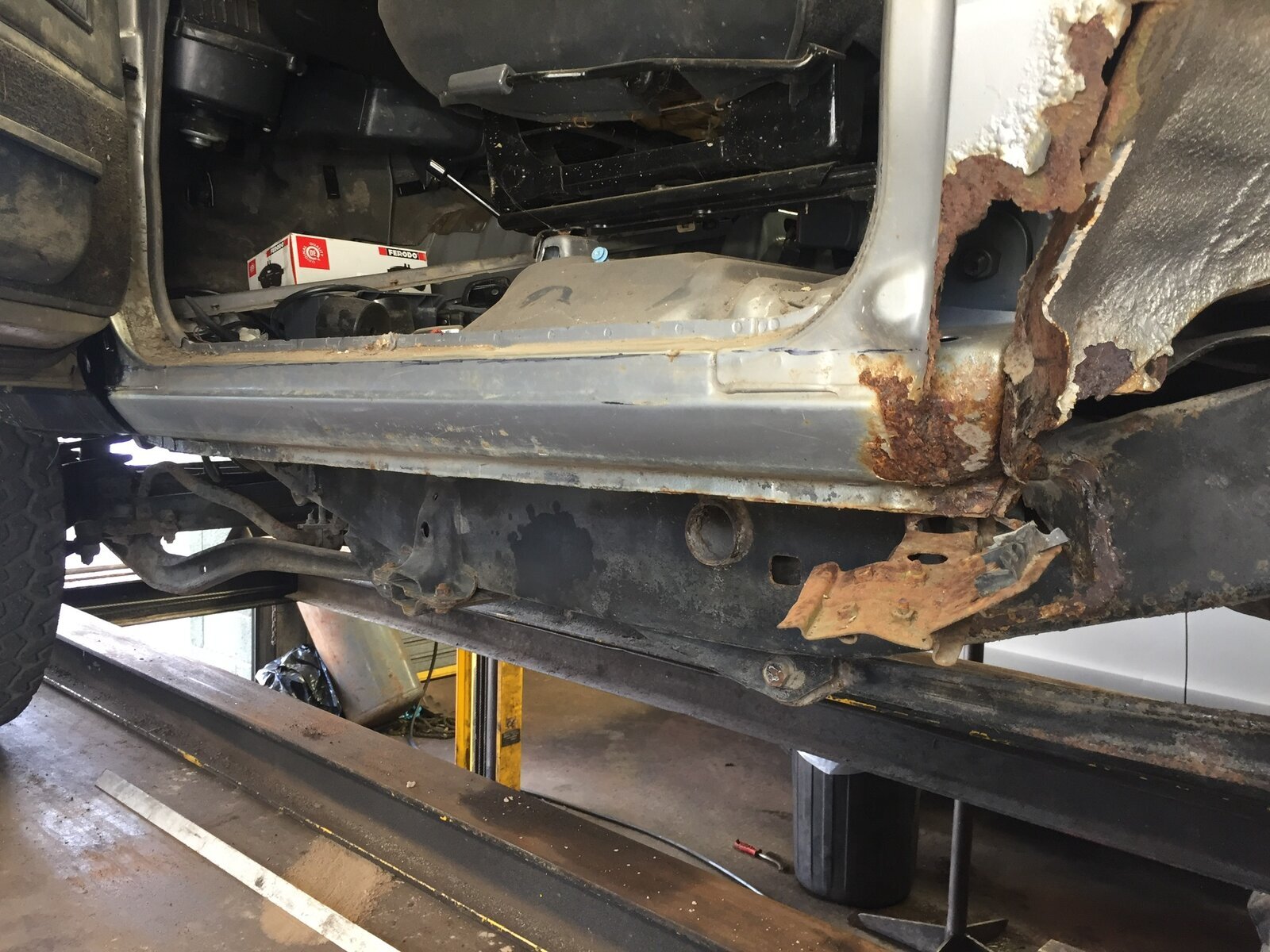

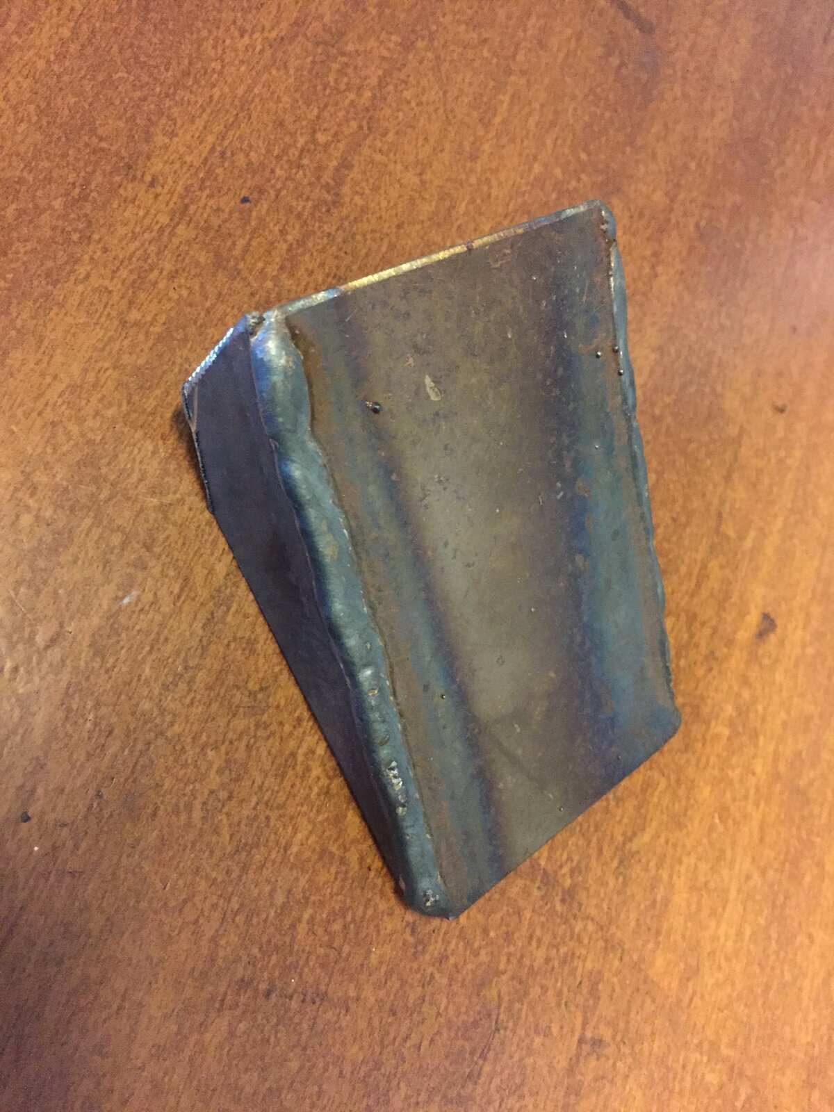

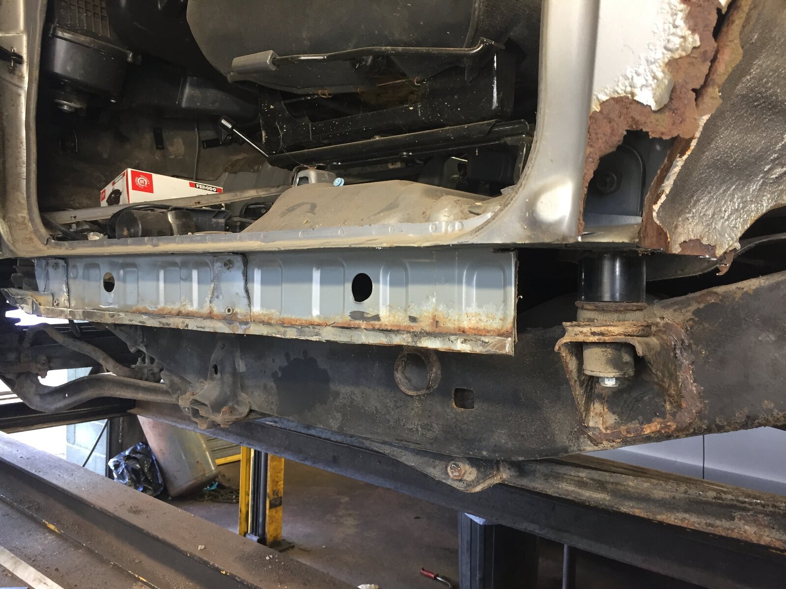

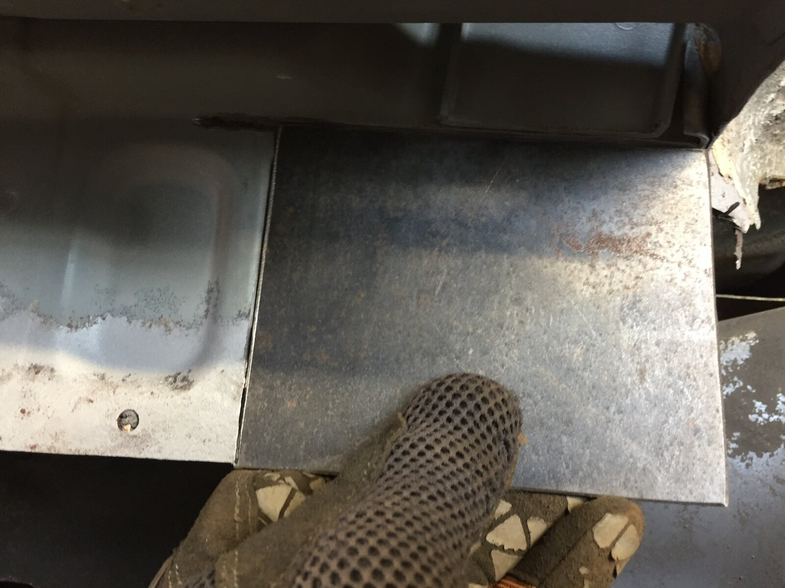

Cut the sill out and rotted part of inner sill.

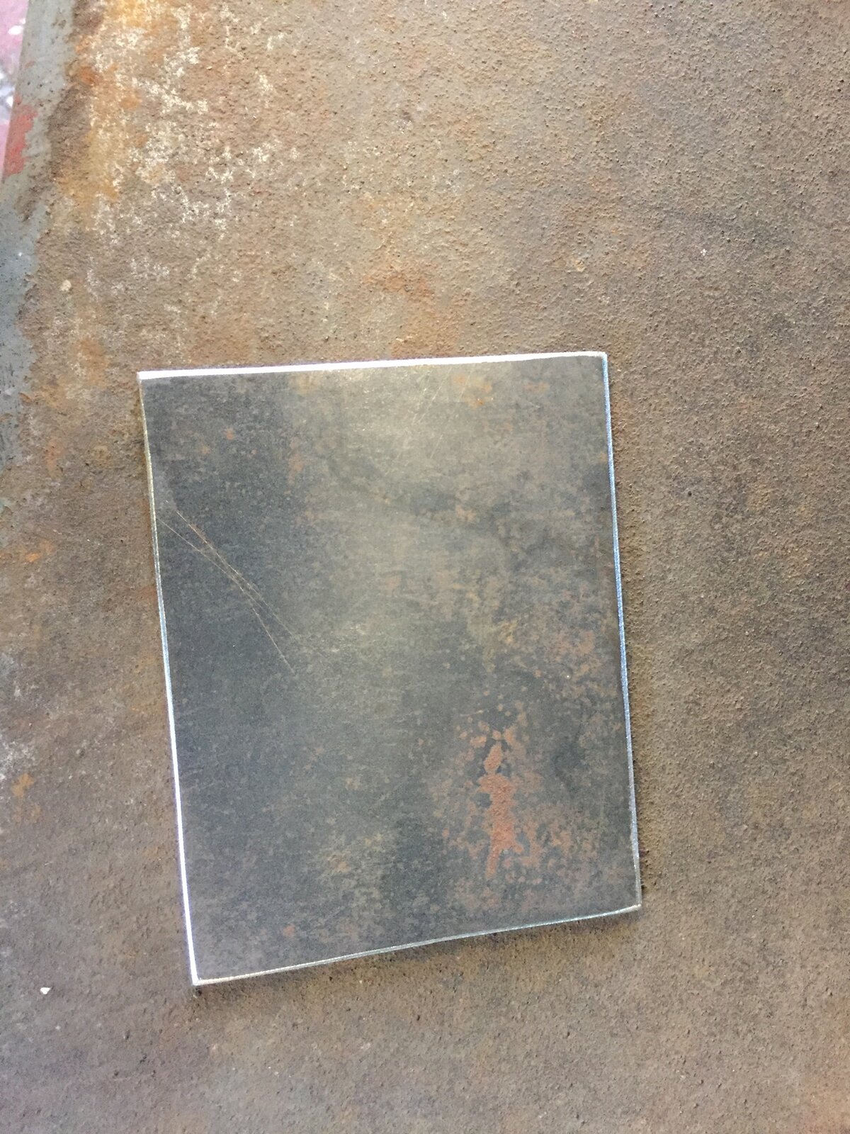

Then made and welded in a plate for the rotted part of the inner sill

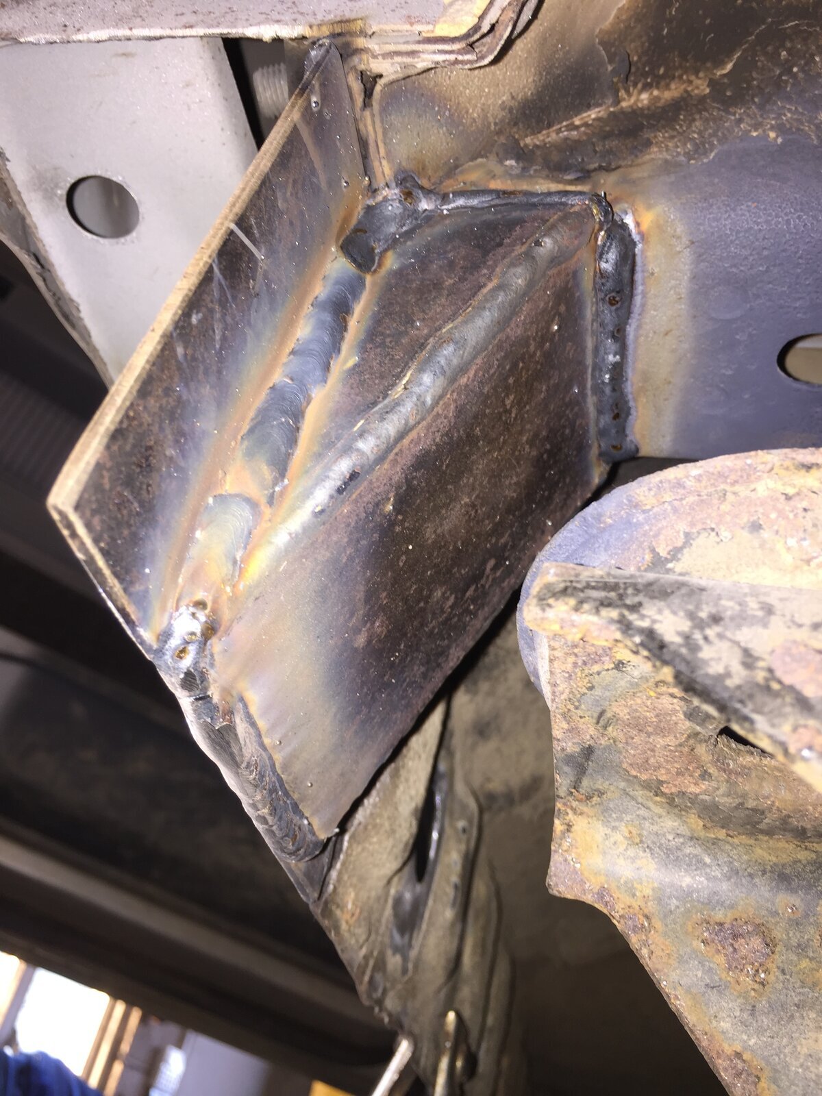

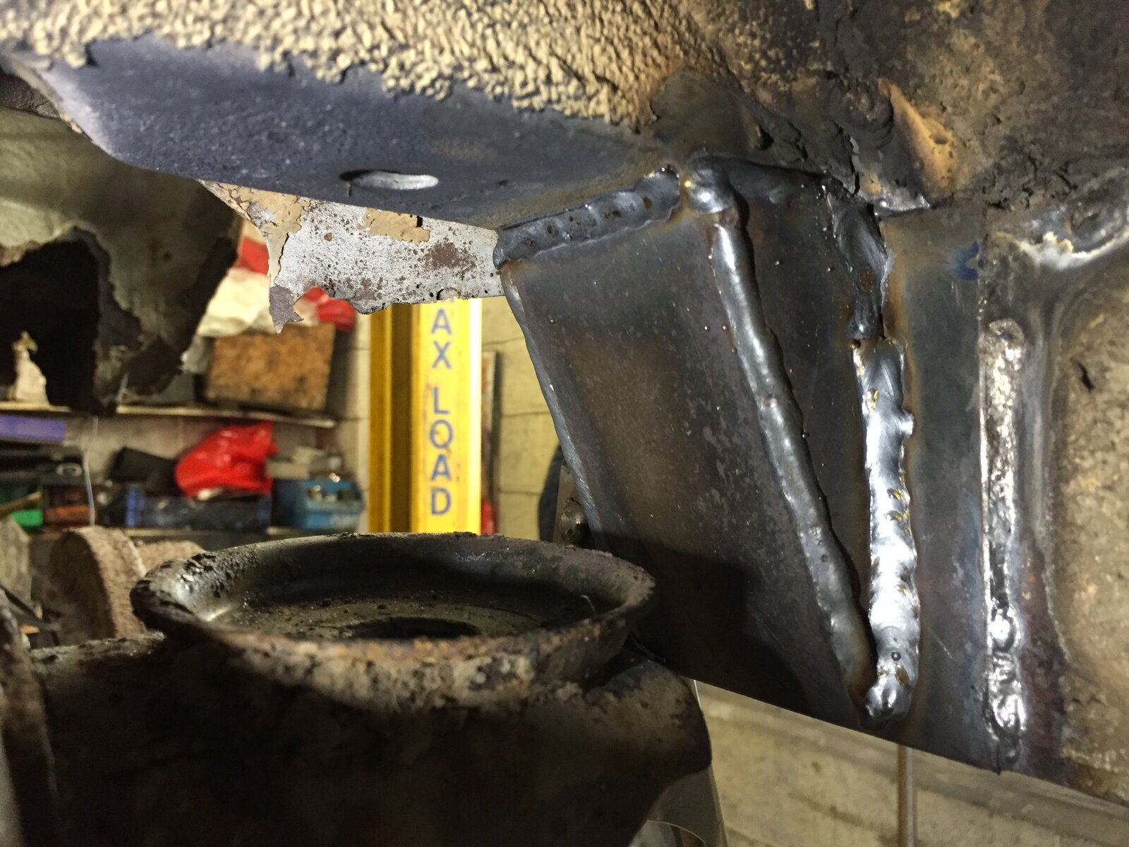

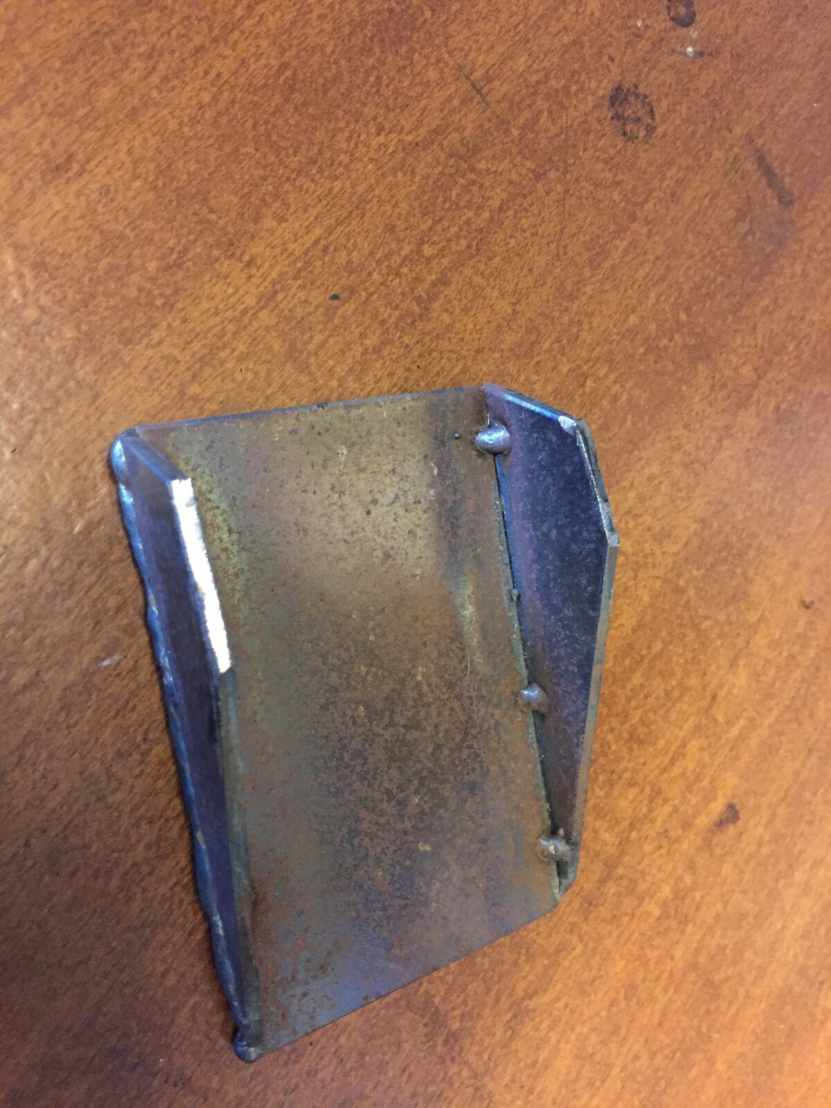

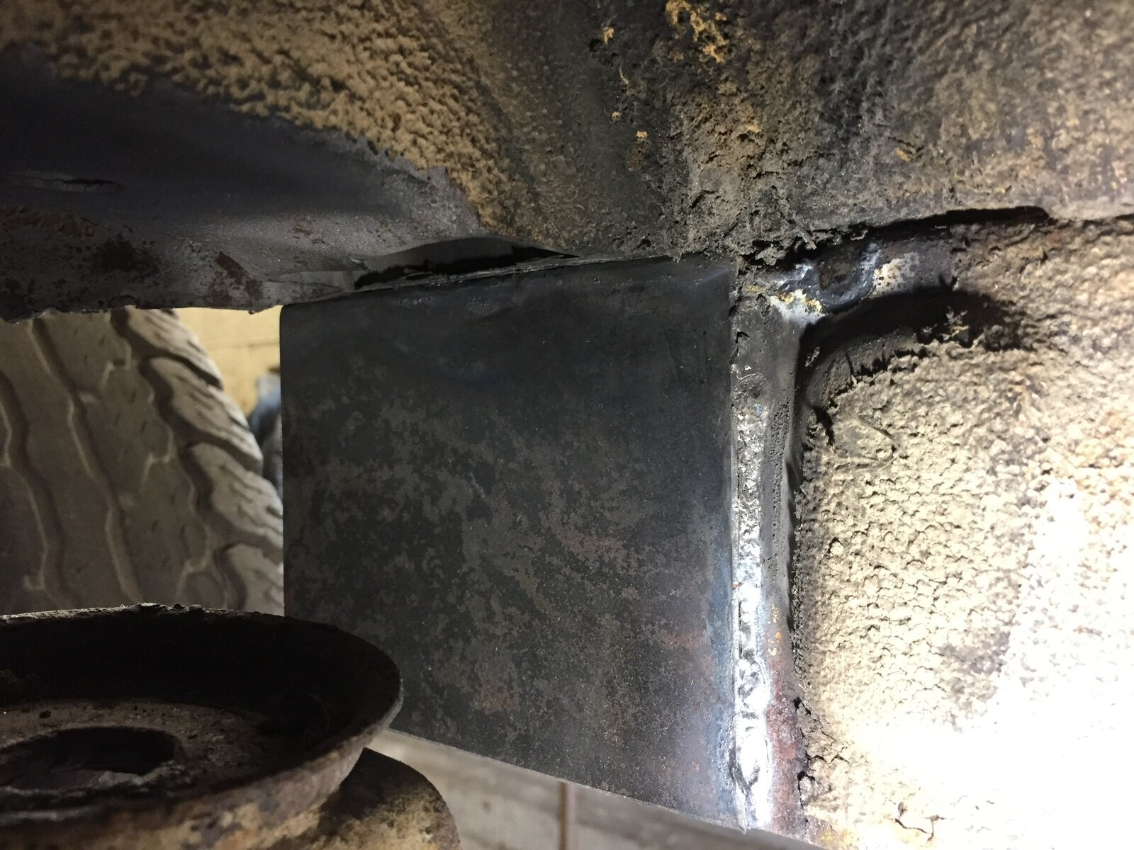

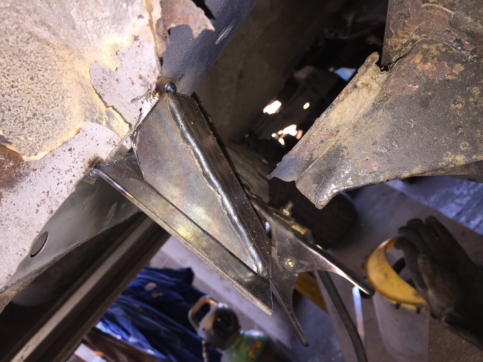

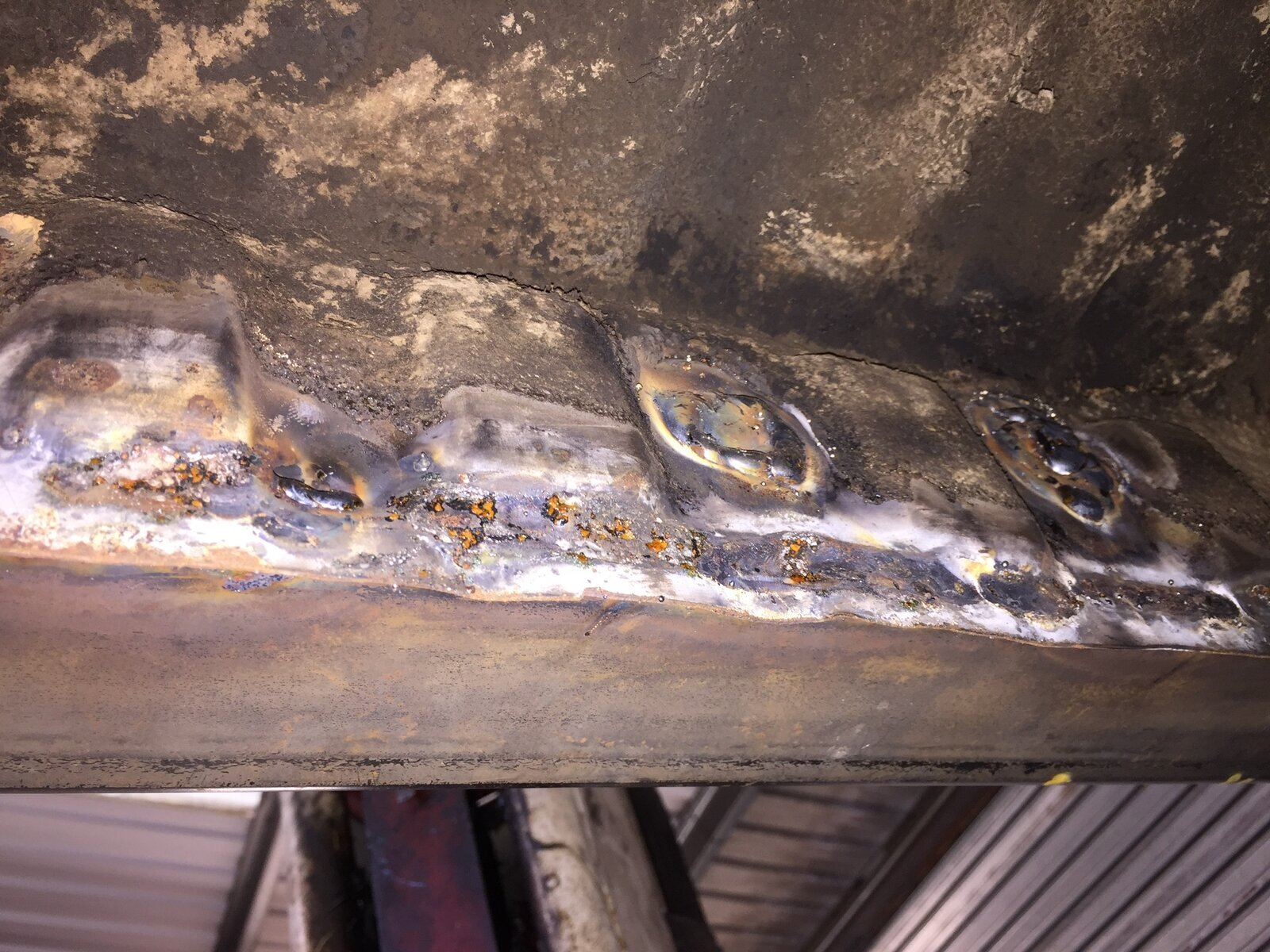

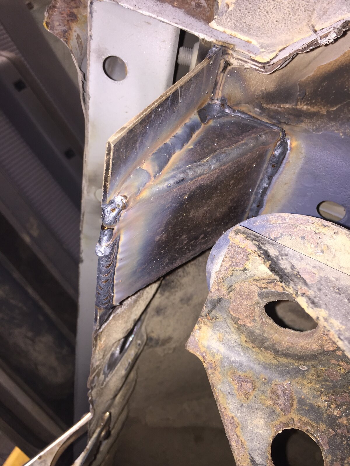

Then made and welded in the gusset that had rotted away.

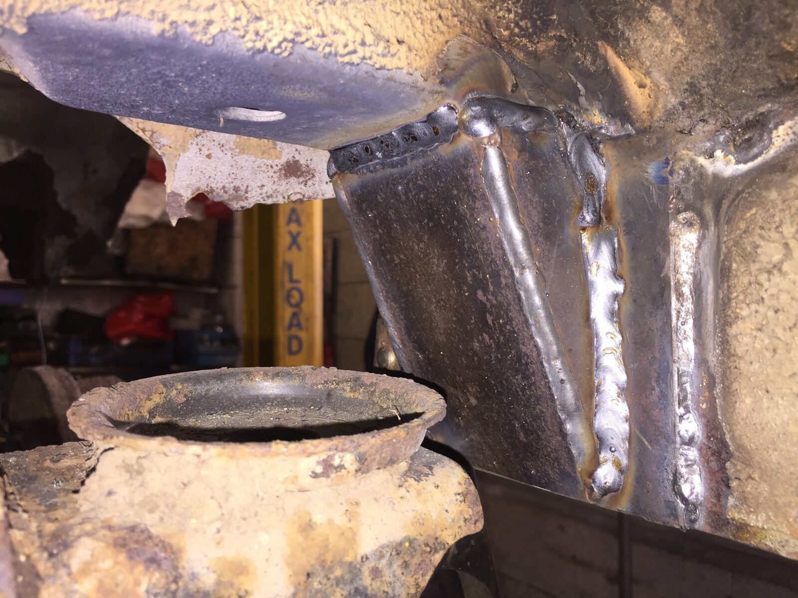

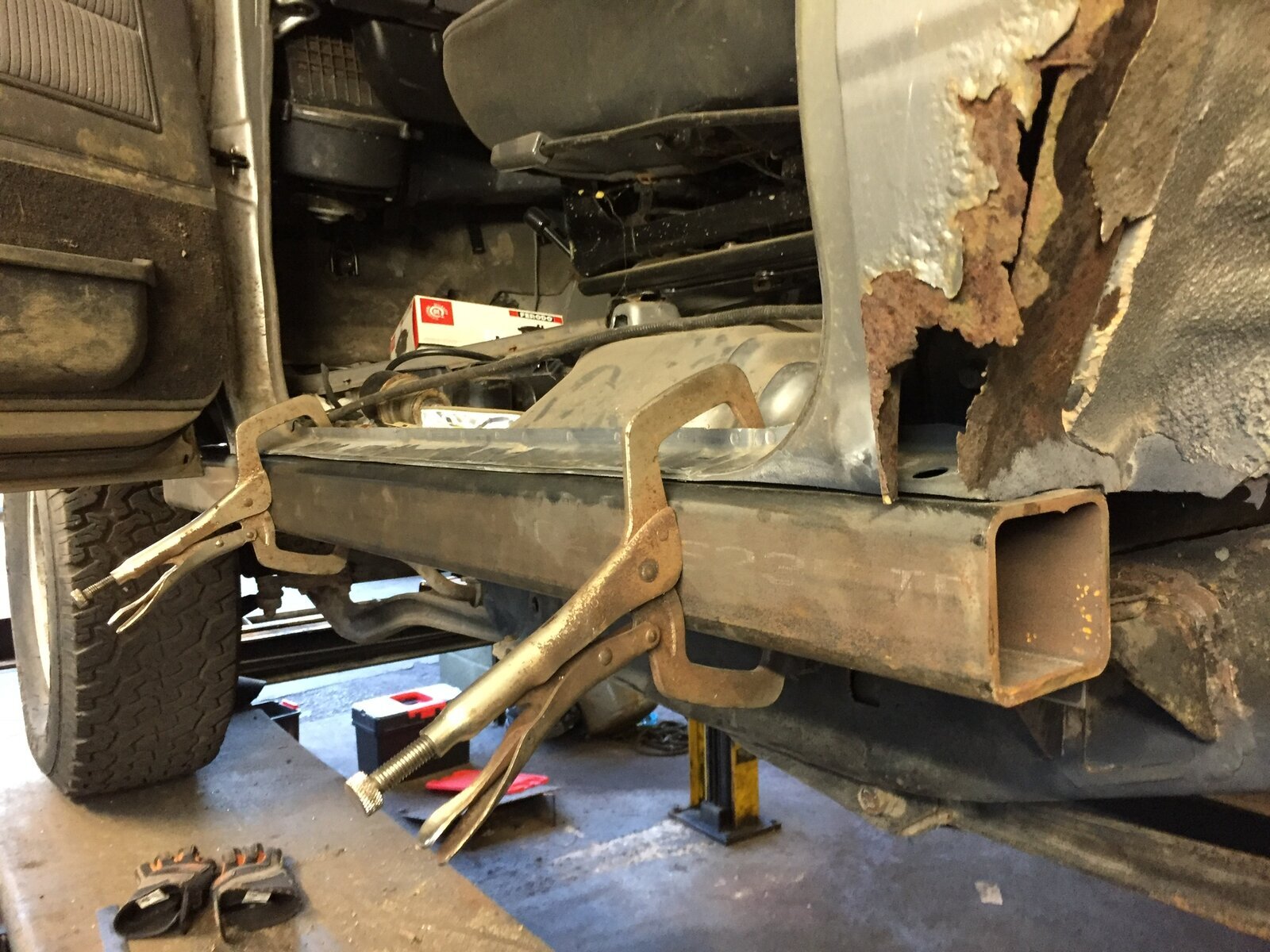

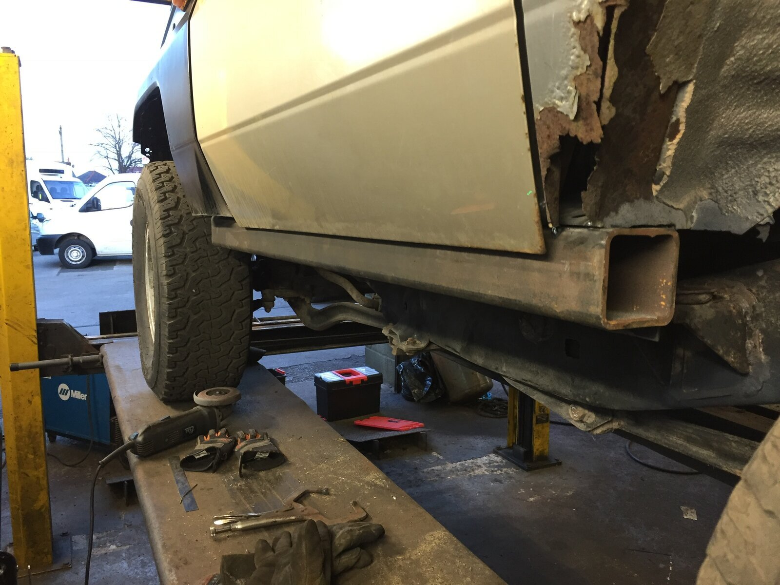

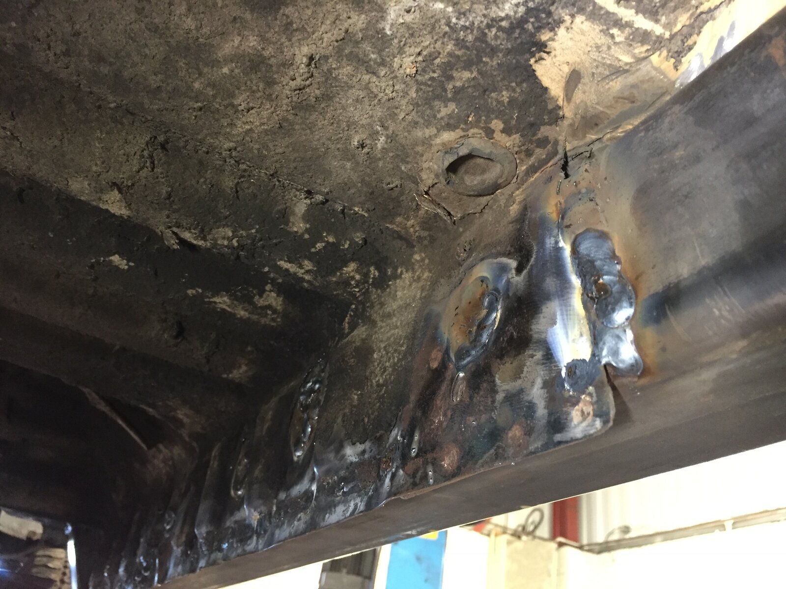

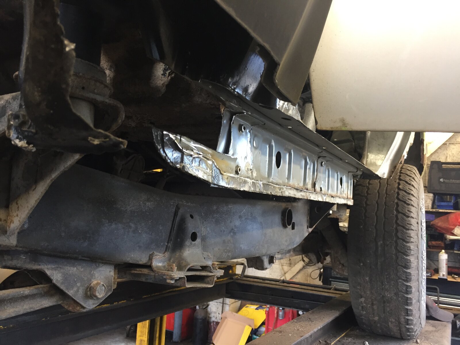

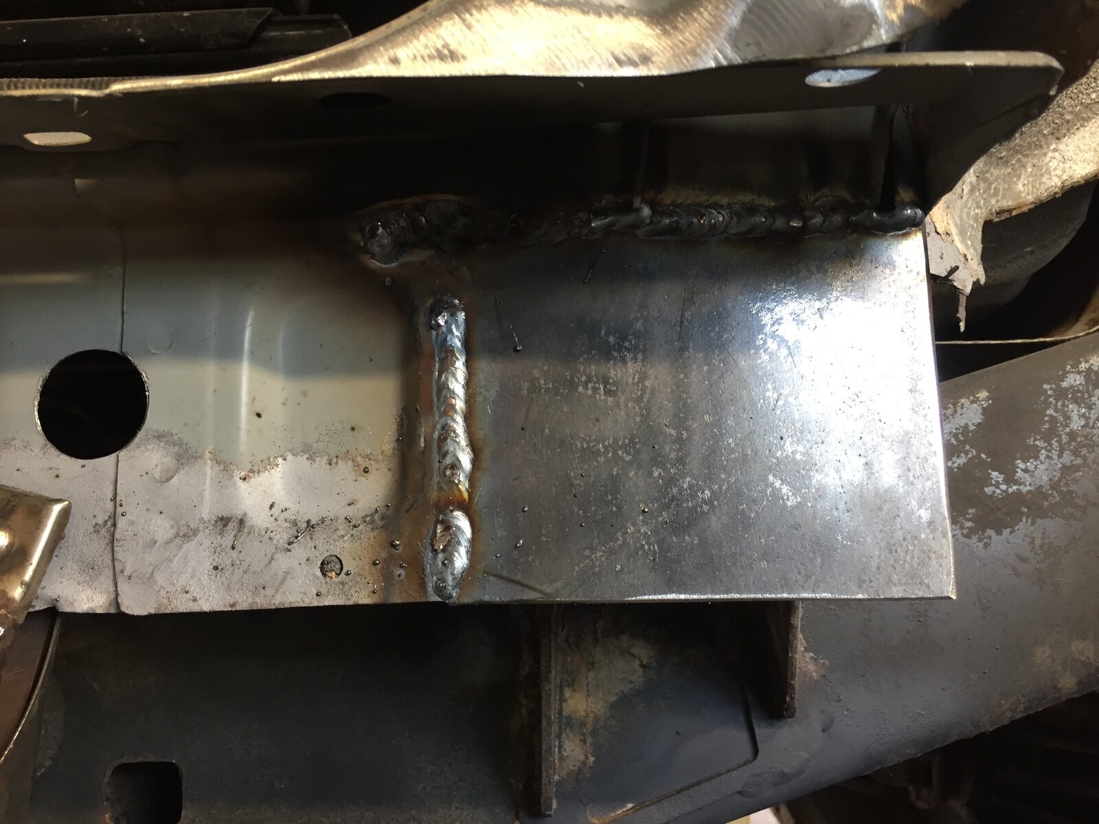

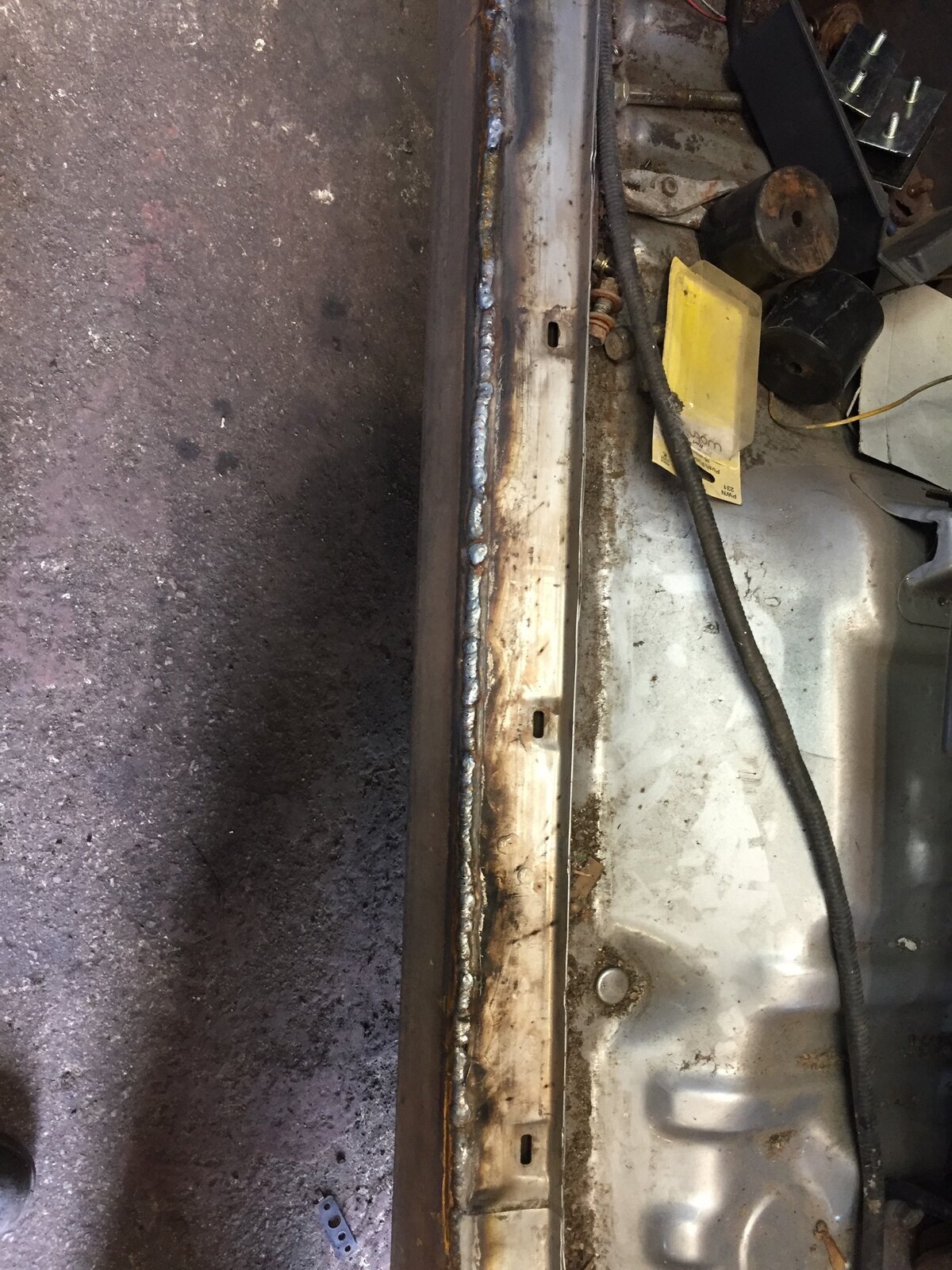

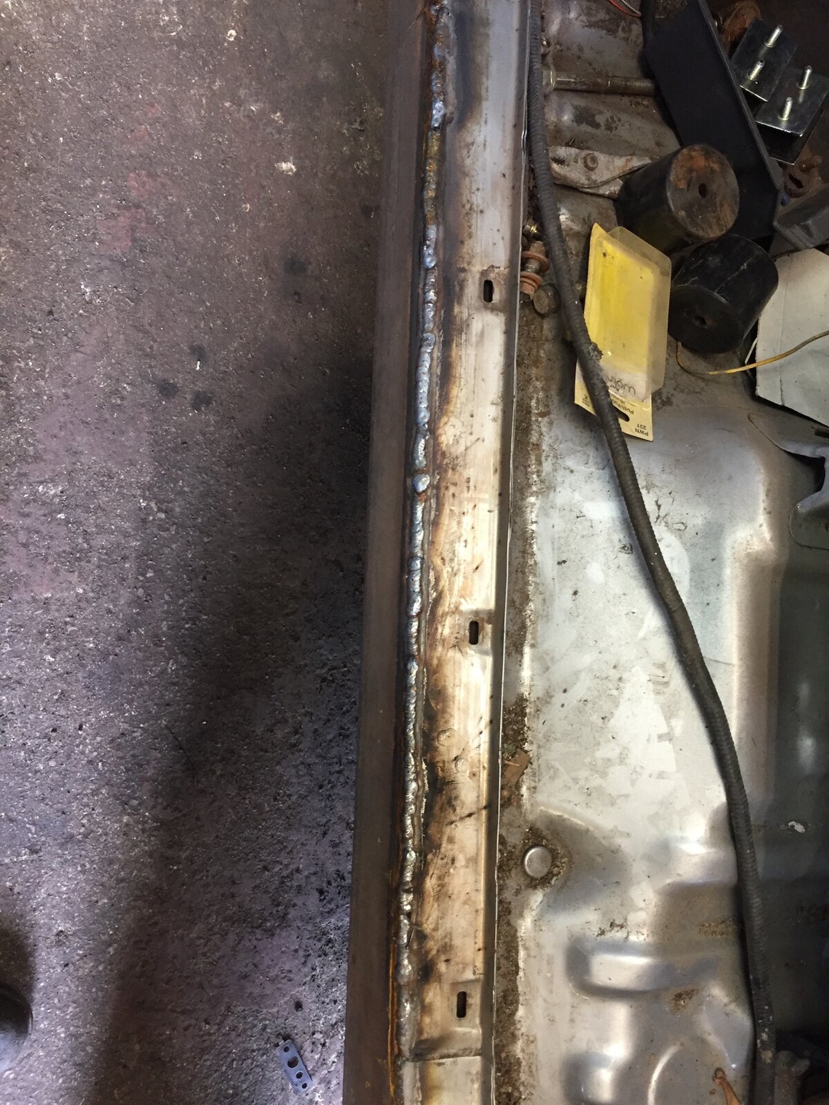

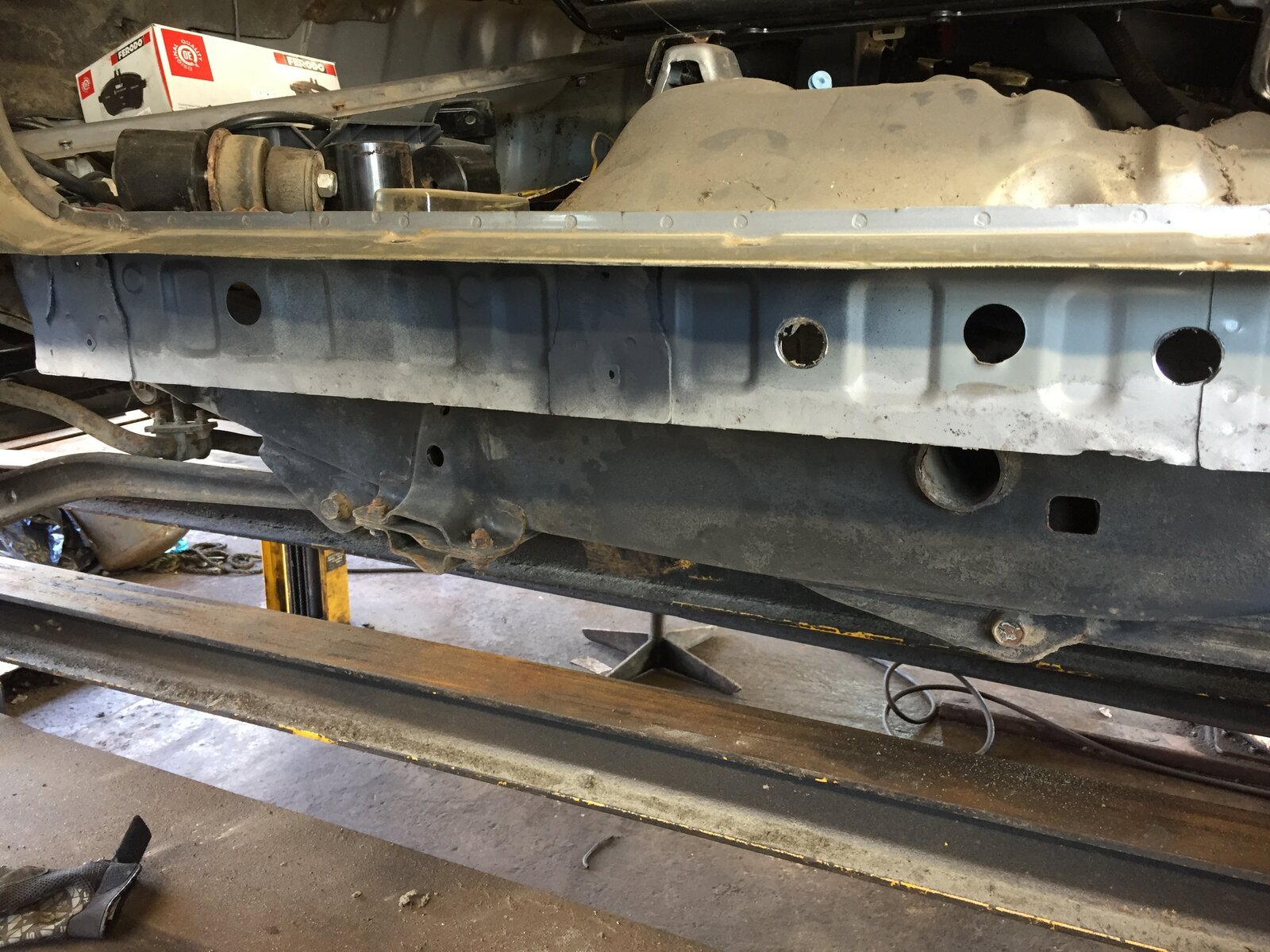

Then welded in the box section sill

Good work Shaun. Glad mine is not so bad! As you say there are some nasty water traps/poor design.
