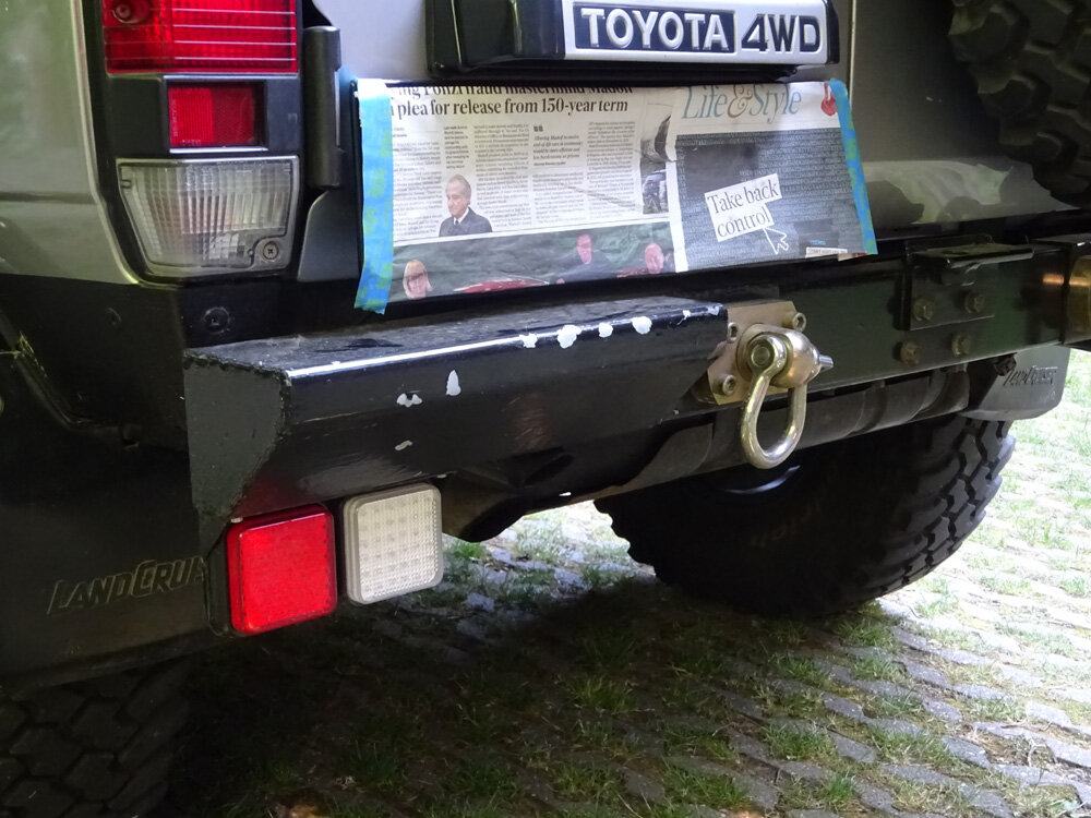

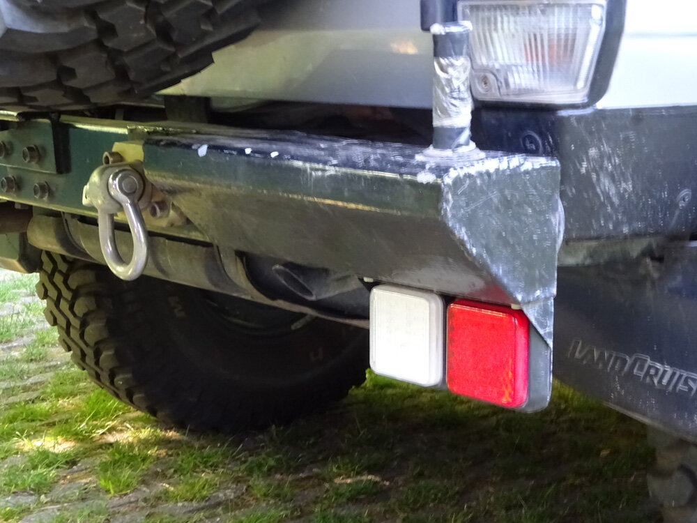

The trouble with those bumperettes at the back is there are so many little bits and pieces to get rusted, bent and buggered, especially if you go off road, that several members on here have replaced them with custom made ones. Maybe you could get a local sheet metal workshop to bend something up to your own design.
Too many fiddly little bits. Here's what I have done instead. Zero points for style but they are strong and simple and give a much better departure angle once the fog & reverse lights are unplugged for going off road.
